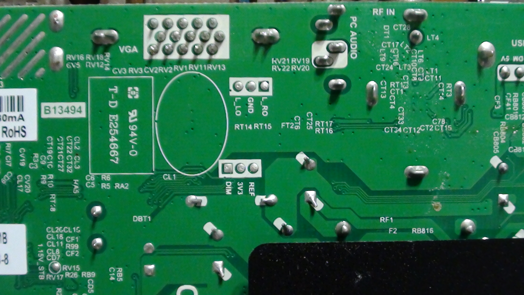

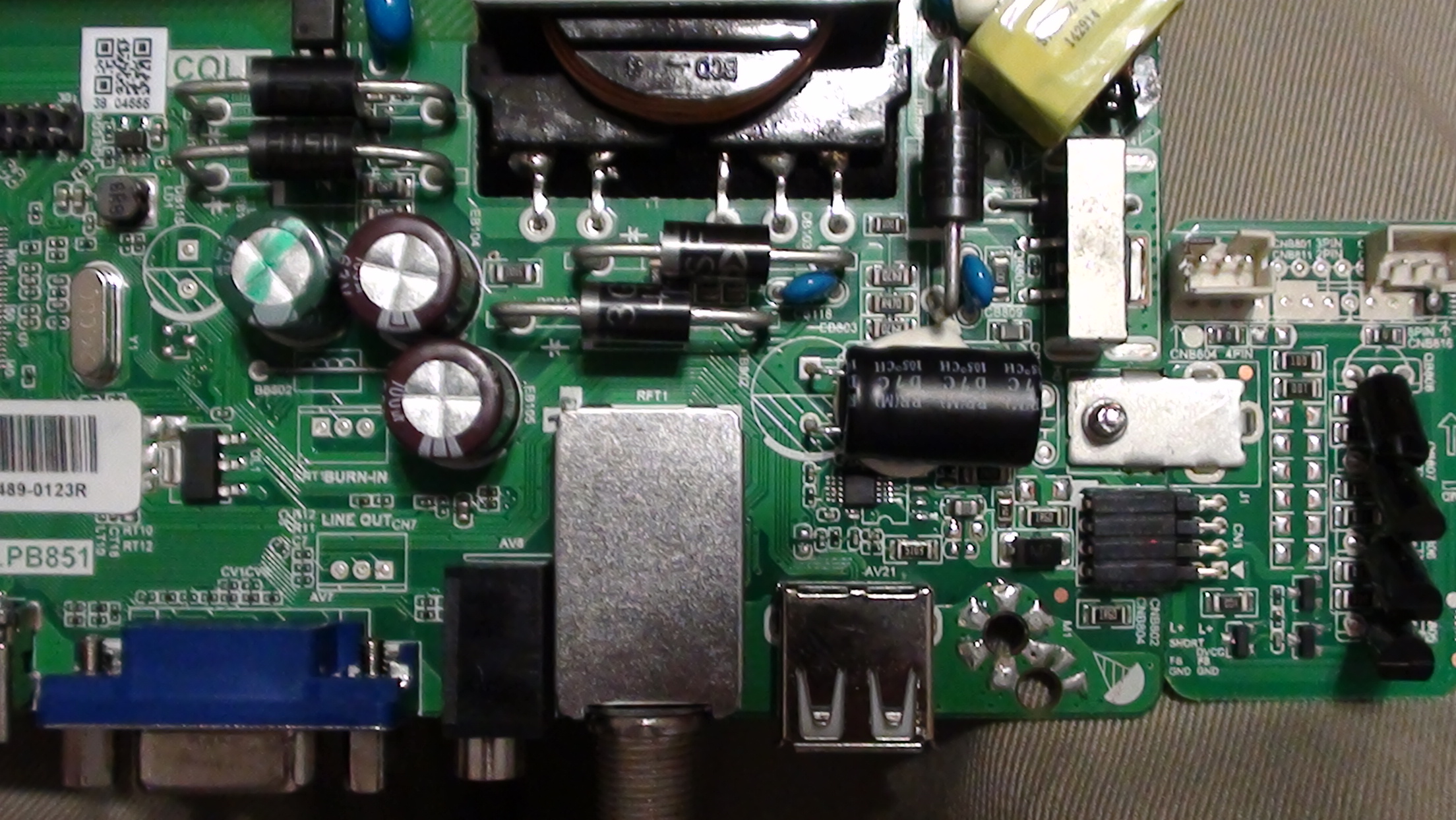

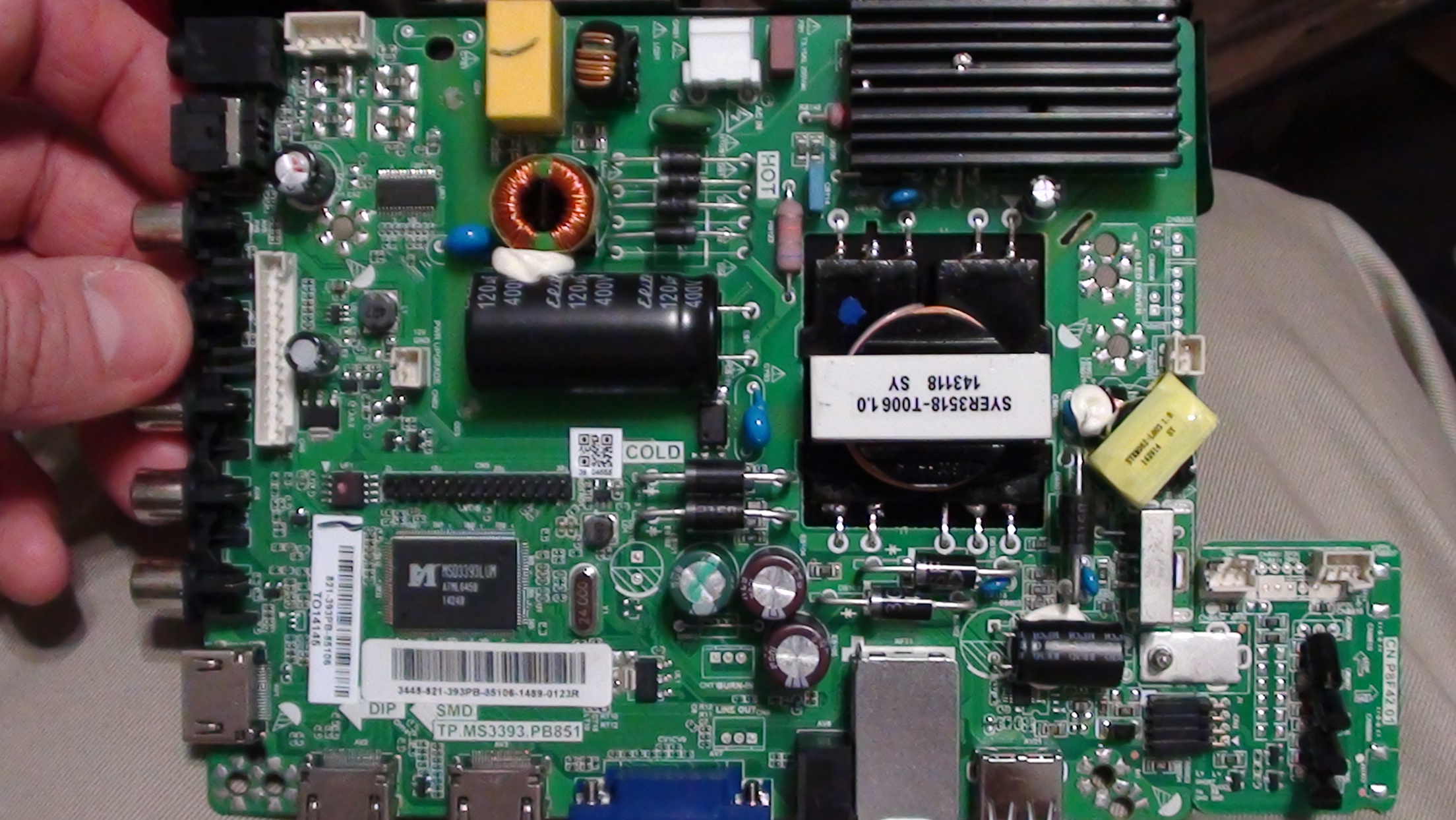

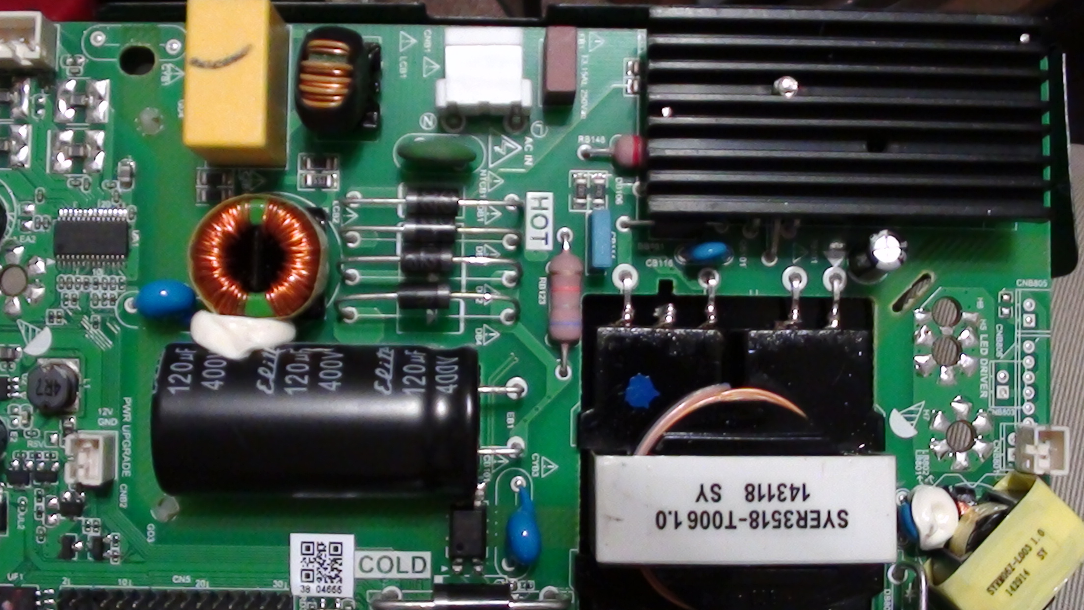

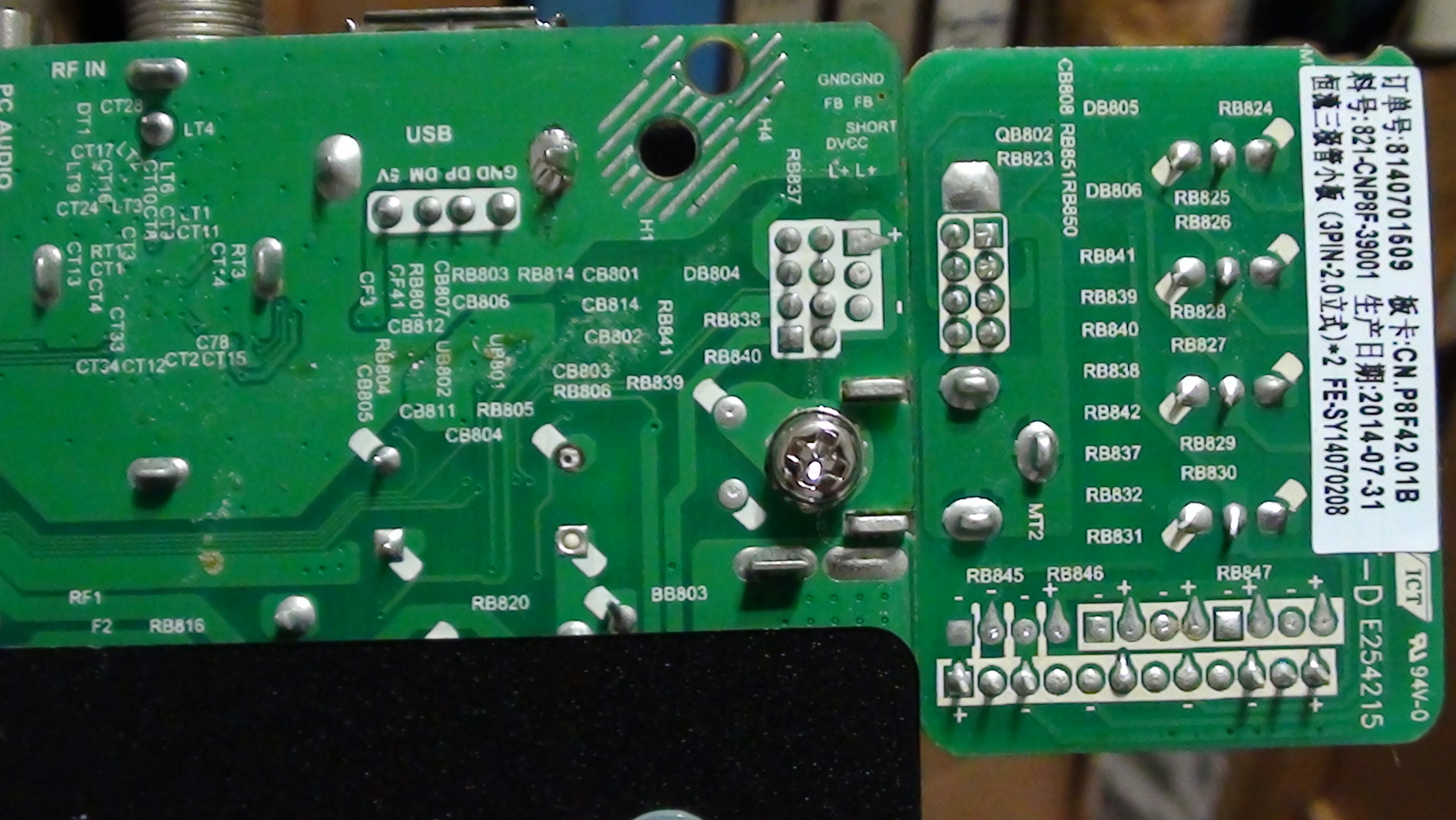

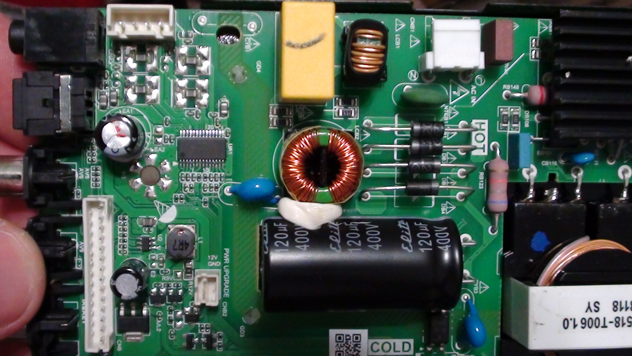

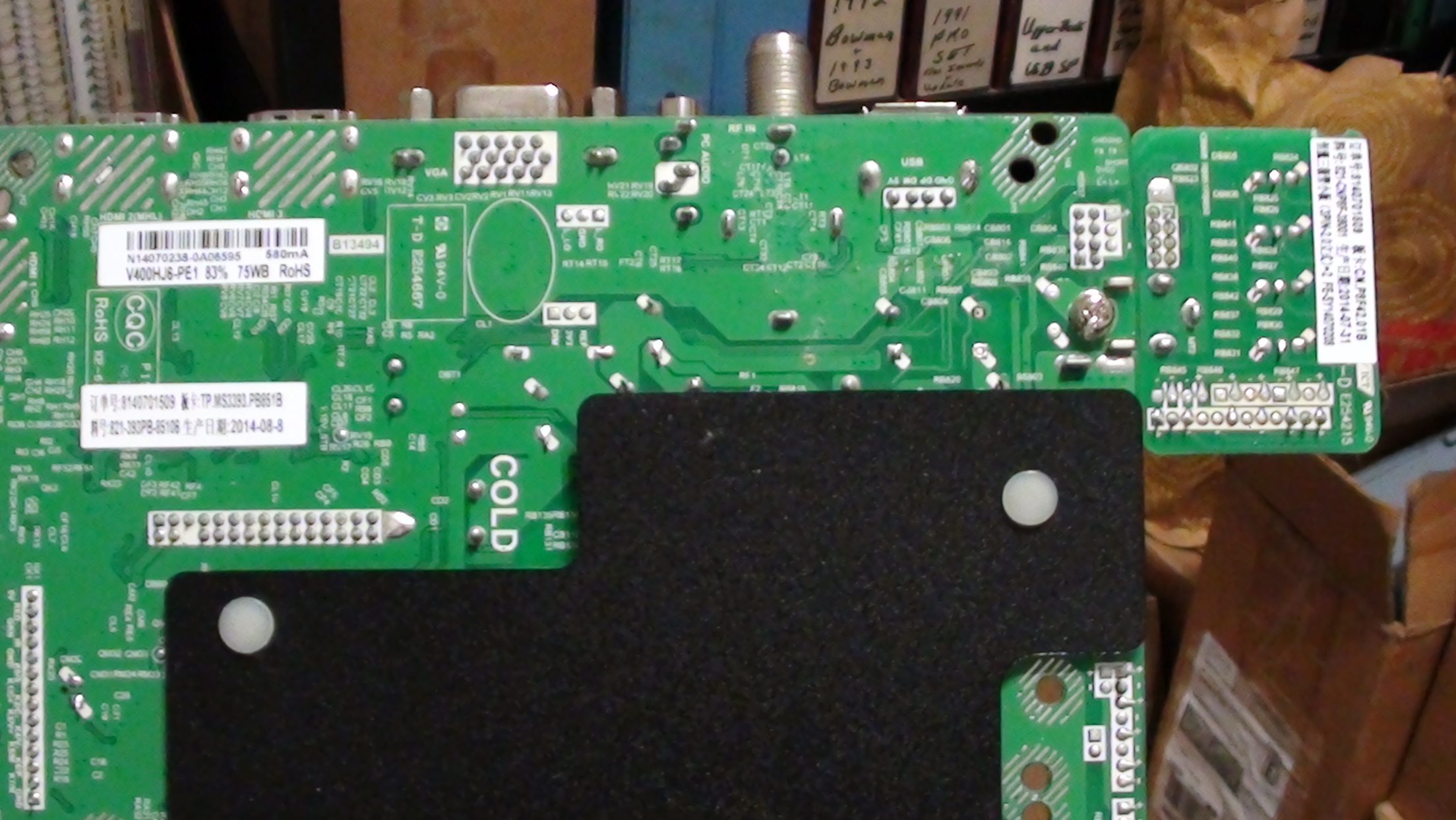

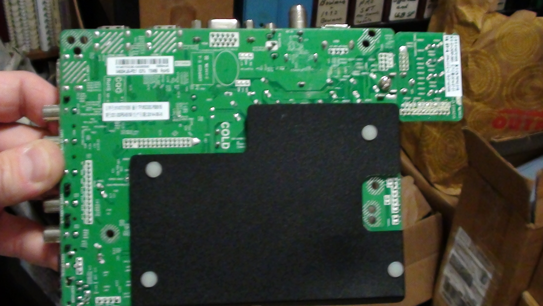

    Hi. I have an Element ELEFW40C that won't turn on. There's a solid red power light and if I hit the on button on the side of the television or use the remote control, it doesn't turn on.
    I pulled the cover off and the logic board and power board are all one. I've uploaded some pictures, if you need clearer pictures of a certain part, please let me know.
    I was going to try and jump start the TV but there's no PS_ON pin. Does anyone know how I can try and force this television on or does anyone have any suggestions on what might be wrong?
    I'd like to add that the board bit me when I had the TV unplugged. I removed the case and was trying to remove a connector when I rested my hand on something that had juice. Not really sure what it was though. I'd have thought the 400V capacitor wouldn't hurt because TVs have bleeder resistors and everything. But it felt like a high voltage. It made me swear a little bit. I don't know if that's important or not to mention, but I felt I should say something in case it was.
    Thanks!

      Slow learner I guess! I thought those bleeder resistors were supposed to prevent people from getting zapped by these things. Can a 400V capacitor really kill a person though? That sounds a bit hard to believe! This capacitor is a 400V 120uF cap. We can figure out how much energy, in joules, that capacitor has, using the following formula: 1/2 CV^2 where is the capacitance, in Farads, and V is the voltage. So, if we input our numbers we get:
      1/2 * 0.00012 * 400^2
      1/2 * 0.00012 * 160000
      0.00006 * 160000
      9.6 joules.
      I believe a defibrillator will zap you with around 100 to 400 joules of electricity. So, I'm going to (and possibly falsely) assume that 9.6 joules just isn't nearly enough to kill me.
      It's not the cap that I touched. It's one of those diodes next to the caps, one of the big ones. I just touched it again on accident, but this time it wasn't so bad! I really must be a slow learner!!!!!
      147VDC on that cap!!!!! Each of those diodes have less. For example, the first one is around 87V, then the second might be half that, then the third might be half that, then the fourth (and last one) is around something low, like 2VDC if I remember.

                                Yes I am just learning. I haven't tested what will kill me voltage/current wise. I always check voltage. I have had several smps with 125v on them several hours after they had been unplugged. I am learning and was surprised there was such high voltage. Maybe because I am new I am just overly cautious.
                                Because I am just learning I would also like to know how to test pson on an integrated power/main board.

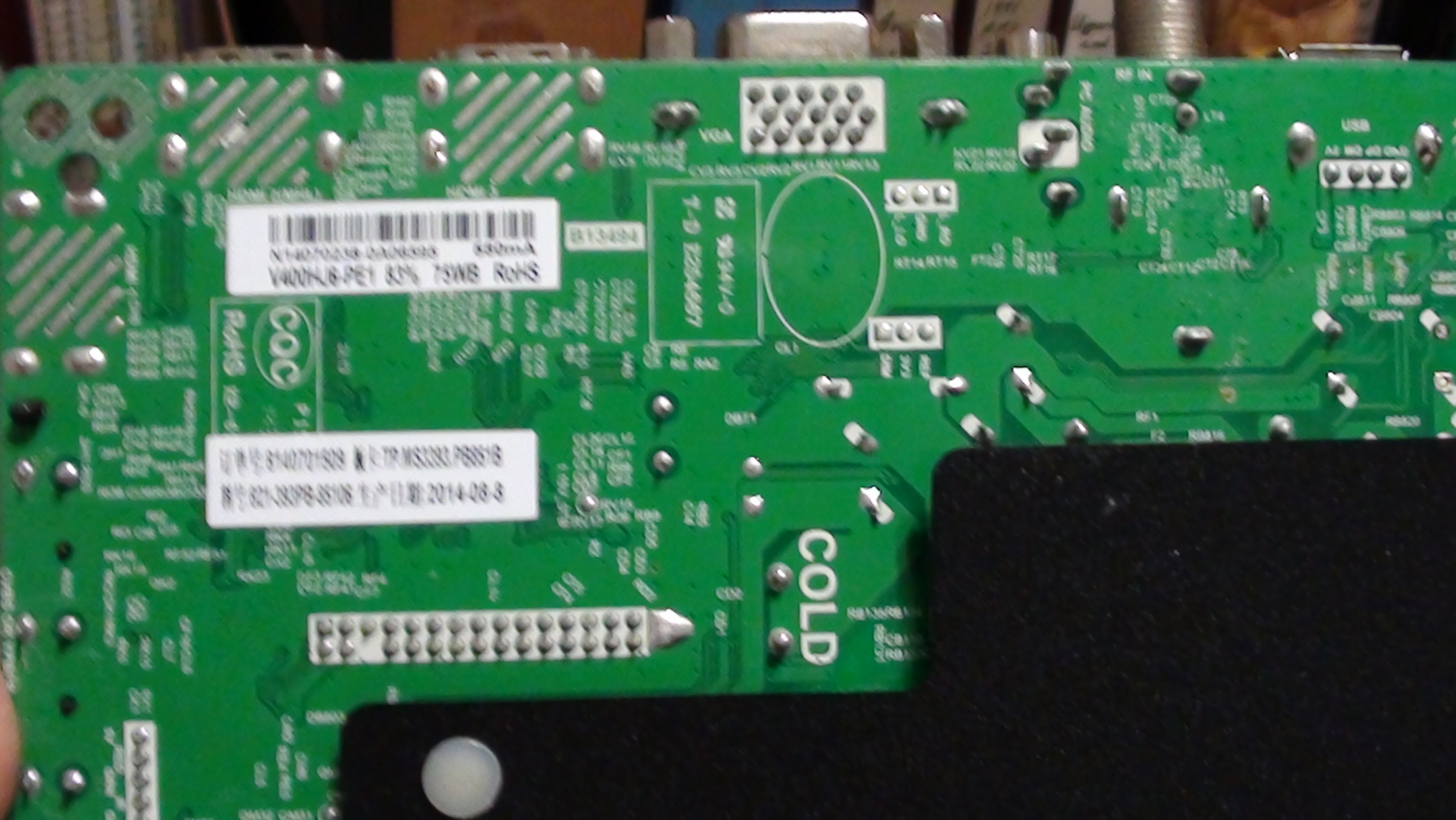

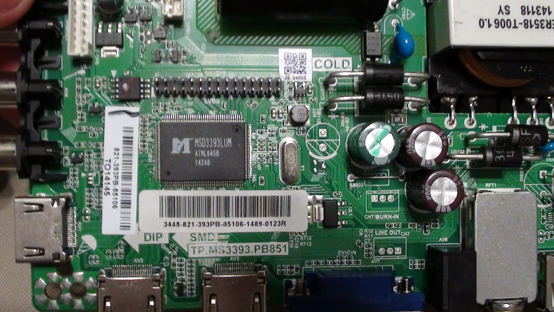

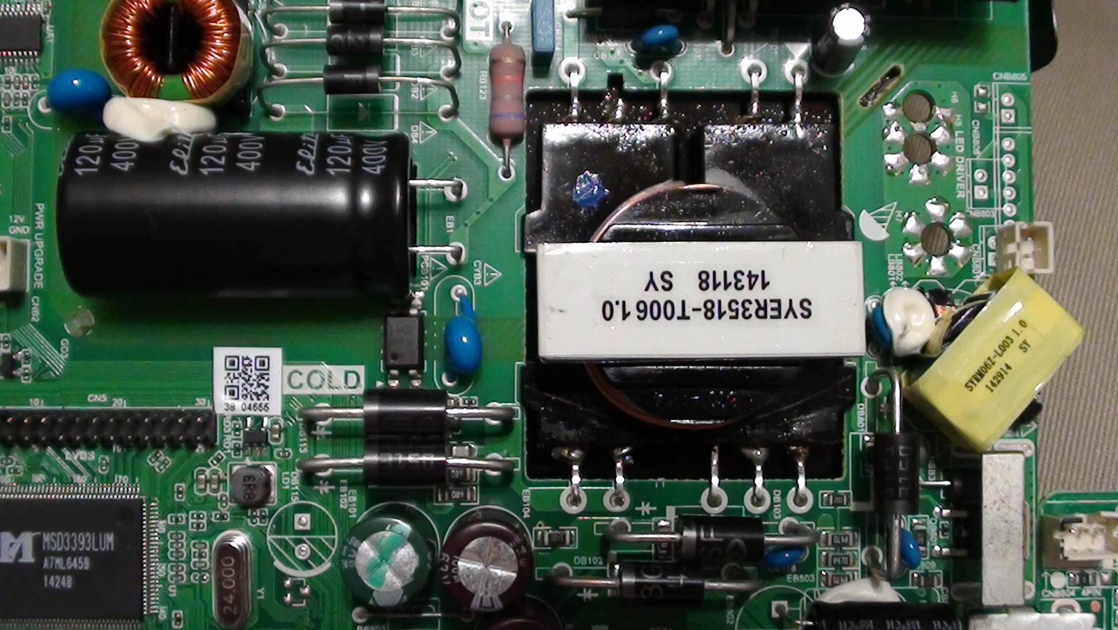

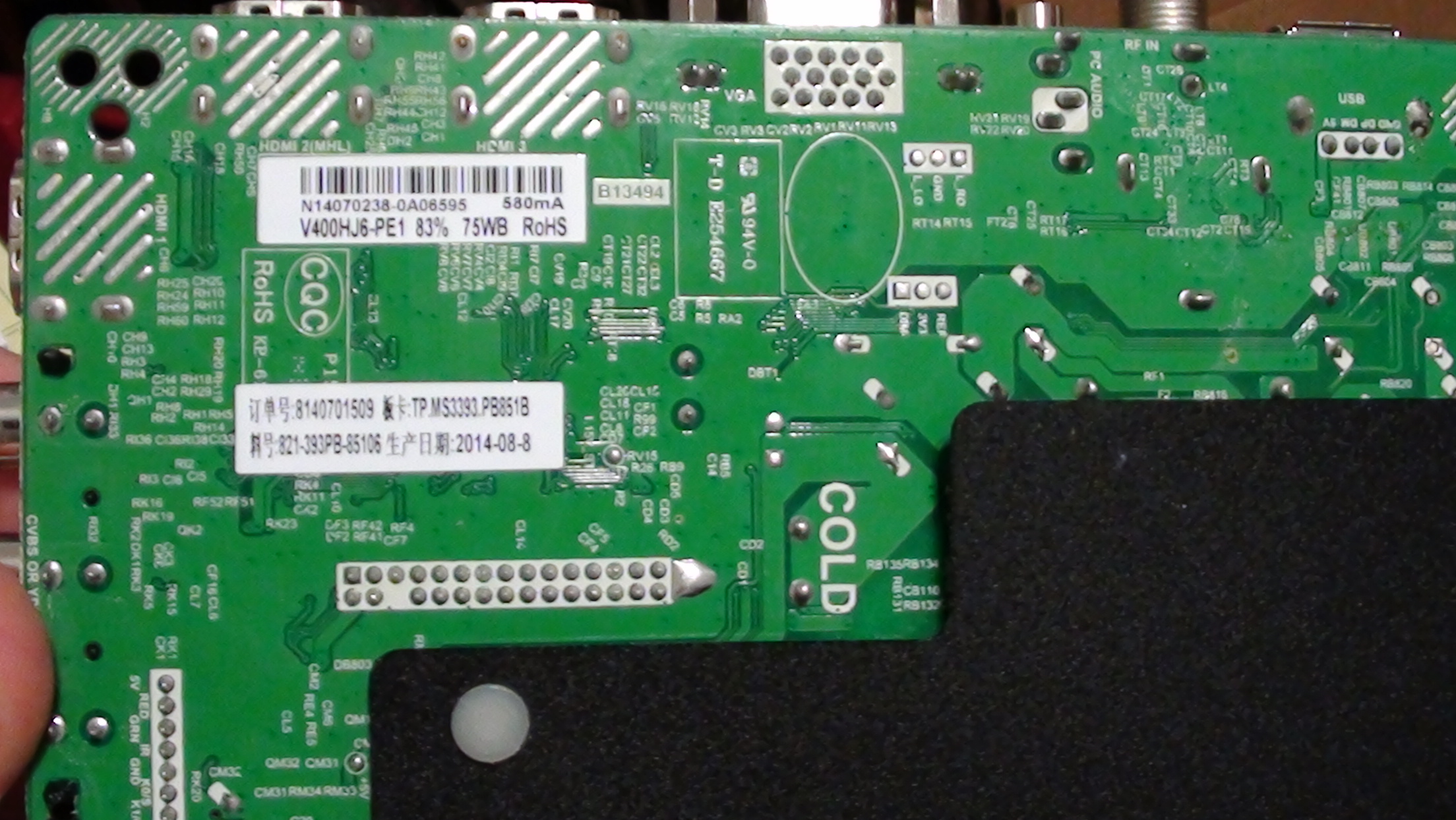

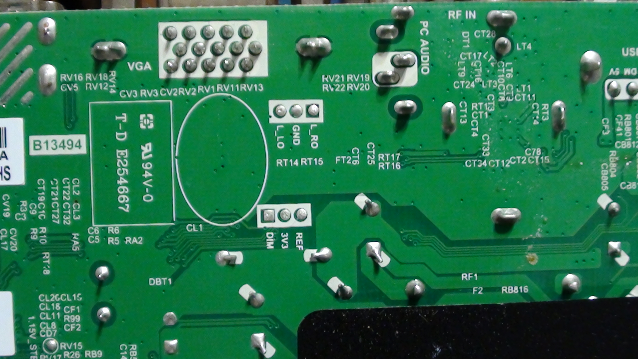

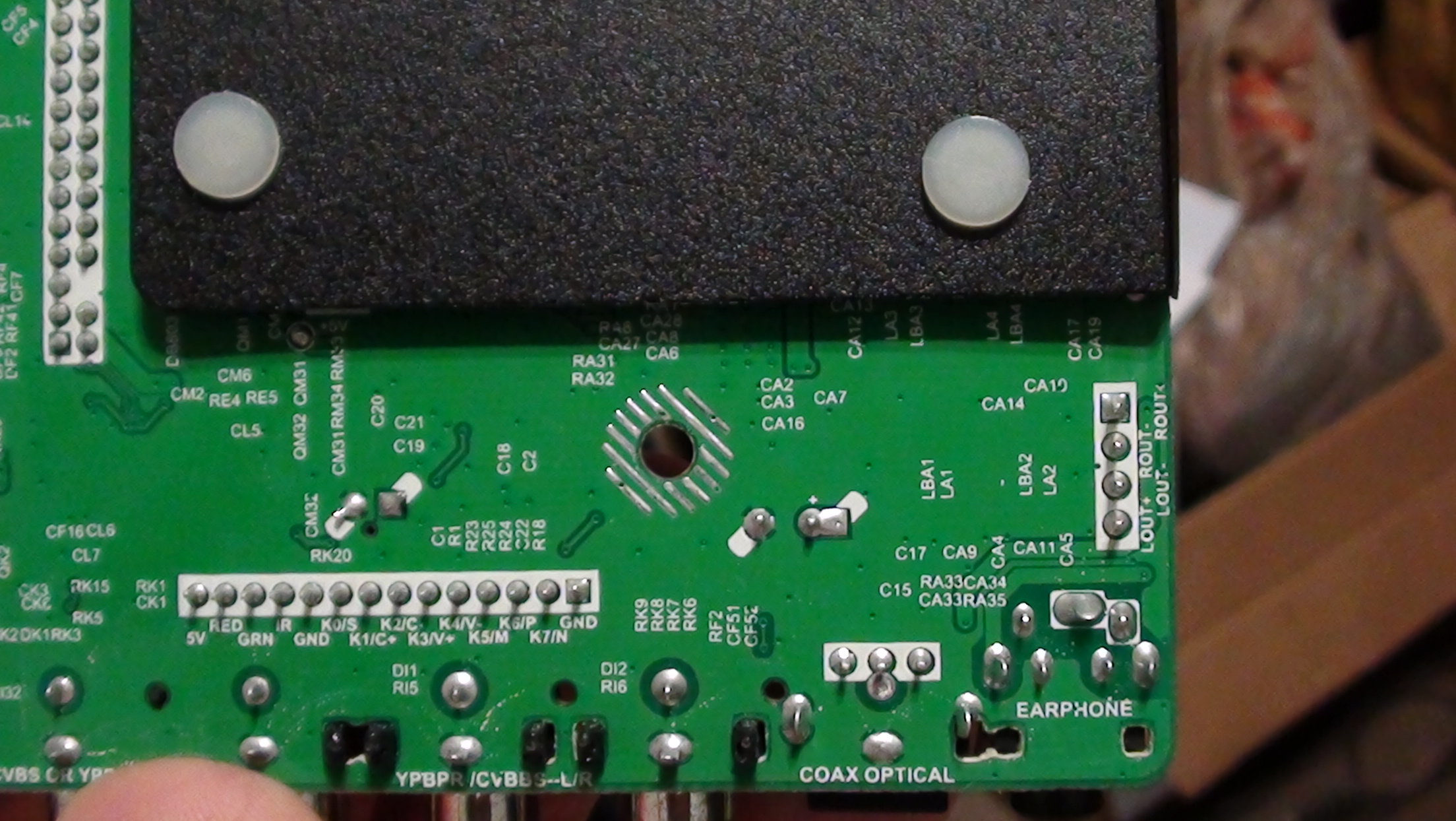

                                        Re: Element ELEFW40C won't turn on.
                                        https://www.badcaps.net/forum/attach...1&d=1486337777
                                        Picture is not clear enough to read those prints on the bottom side of the board, you also need to remove that black insulator sheet in the primary side so we see the prints under that too.
