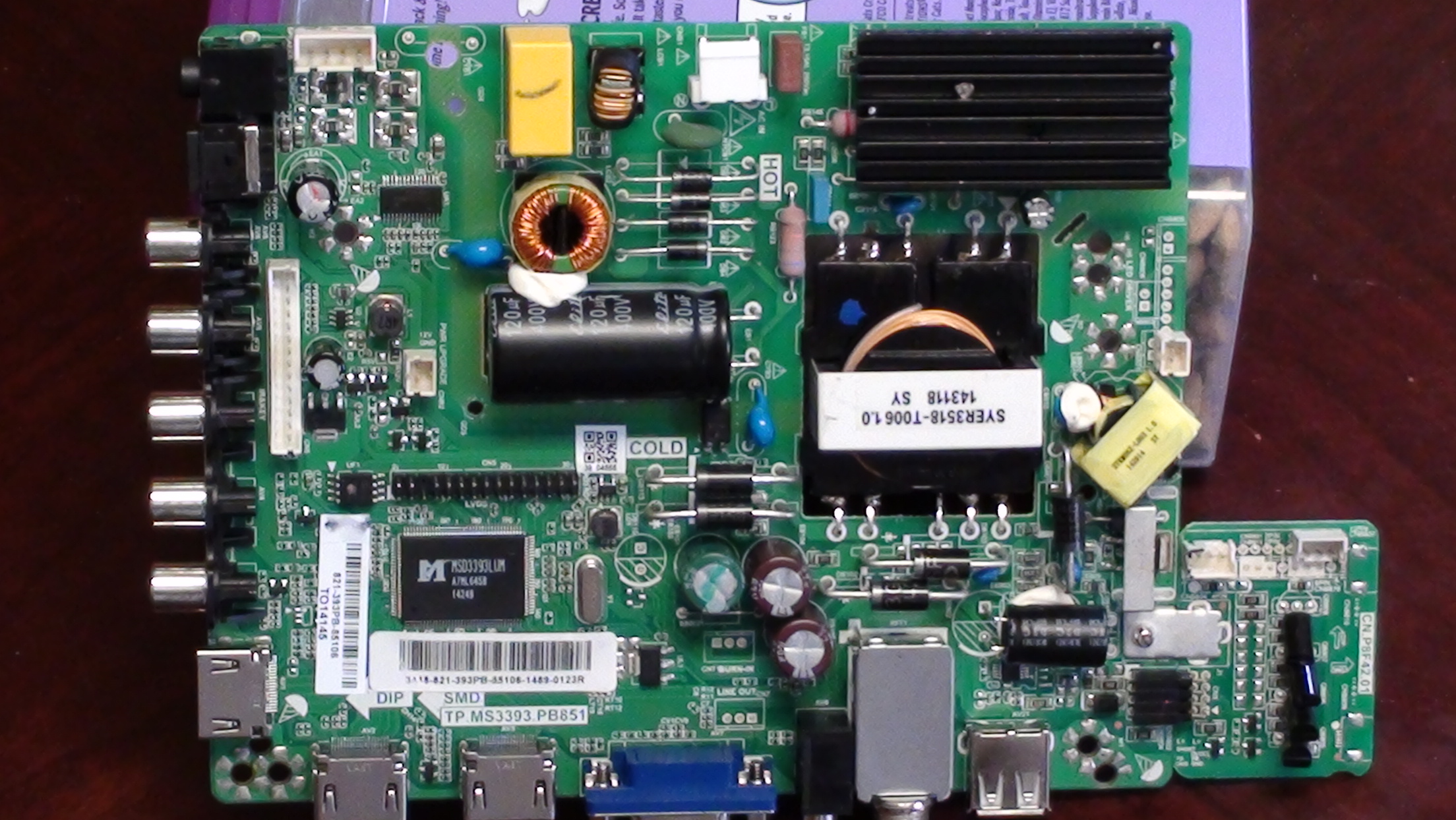

    Yes, the main main cap is that 120uF 400VDC cap.
    How about those Voltages? That will give us more clues.

      Re: Element ELEFW40C won't turn on.
      With the camcorder, this is the best I can do without zooming in and taking pictures in pieces. When my wife gets home, we'll try her fancy cell phone. It might have a better camera.
      Give me a sec and I'll get those voltages. I gotta take care of the baby while I'm doing this, so it's taking a little longer than it normally would.
        OK, I can see that the cold side of the power transformer has two windings, the rectifier diodes for each winding look to be connected in parallel. So we need those Voltage reading the in the picture I have marked.
          Okay, I got the voltages now.
          Code:
          Cap:   37.50VDC
          Diode 1: 12.12VDC
          Diode 2: 12.12VDC
          Diode 3: 37.5VDC
          Diode 4: 37.5VDC
          -- Law of Expanding Memory: Applications Will Also Expand Until RAM Is Full

            OK, as expected.
            Now I know why you are getting the reading of 37V on that Diode of the Boost converter, that 37V is the feeding Voltage to the Boost converter that gets converted to higher Voltage to drive the LED strings but since it is not running which can be due to no BL-ON command to turn on the Booster circuit or the booster is bad, but from what you describe the problem with the TV it sounds like there is no action going on in the main board section. The power supply is fine.

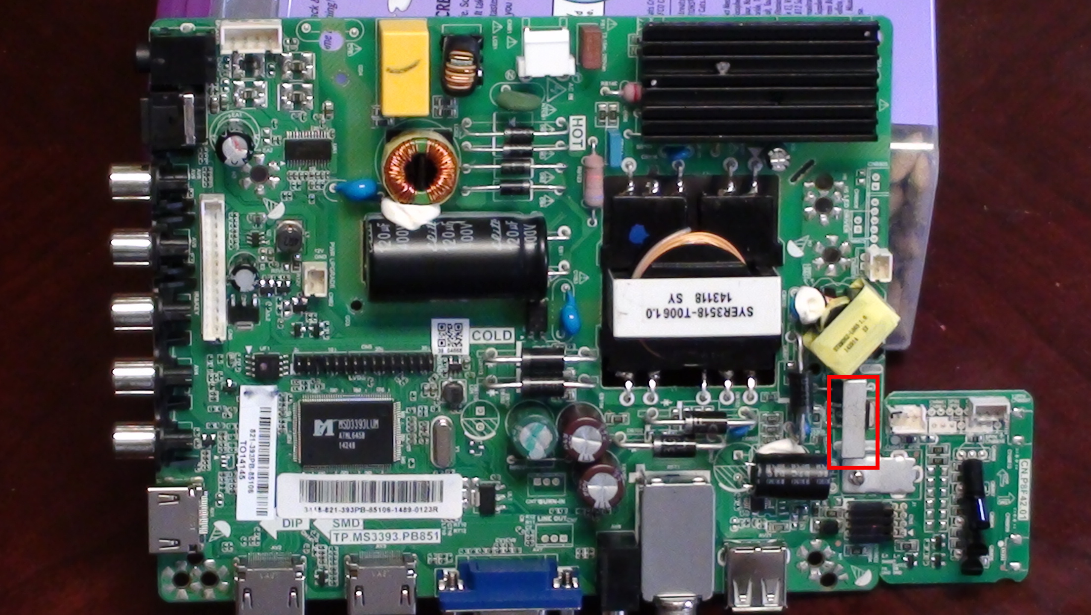

                    Here's something else that I find very strange. This metal bar, that I thought was supposed to be a GND is actually reading 37V. There's a chip underneath it, I think it might be a voltage regulator. There's three terminals on the bottom of it and the middle one doesn't appear to be connected to anything, then there's the big fat tab at the top. I measure the voltage of the bottom terminals. The two outside ones read 0VDC, but the middle one reads 37VDC. The big fat tab reads 37VDC as well. Is this normal?
                        That should be the MOSFET for the boost converter. The big tab should be Drain pin. If you look at the PDF I provide, then you will understand why you are see the 37VDC when the Boost converter is not running.
