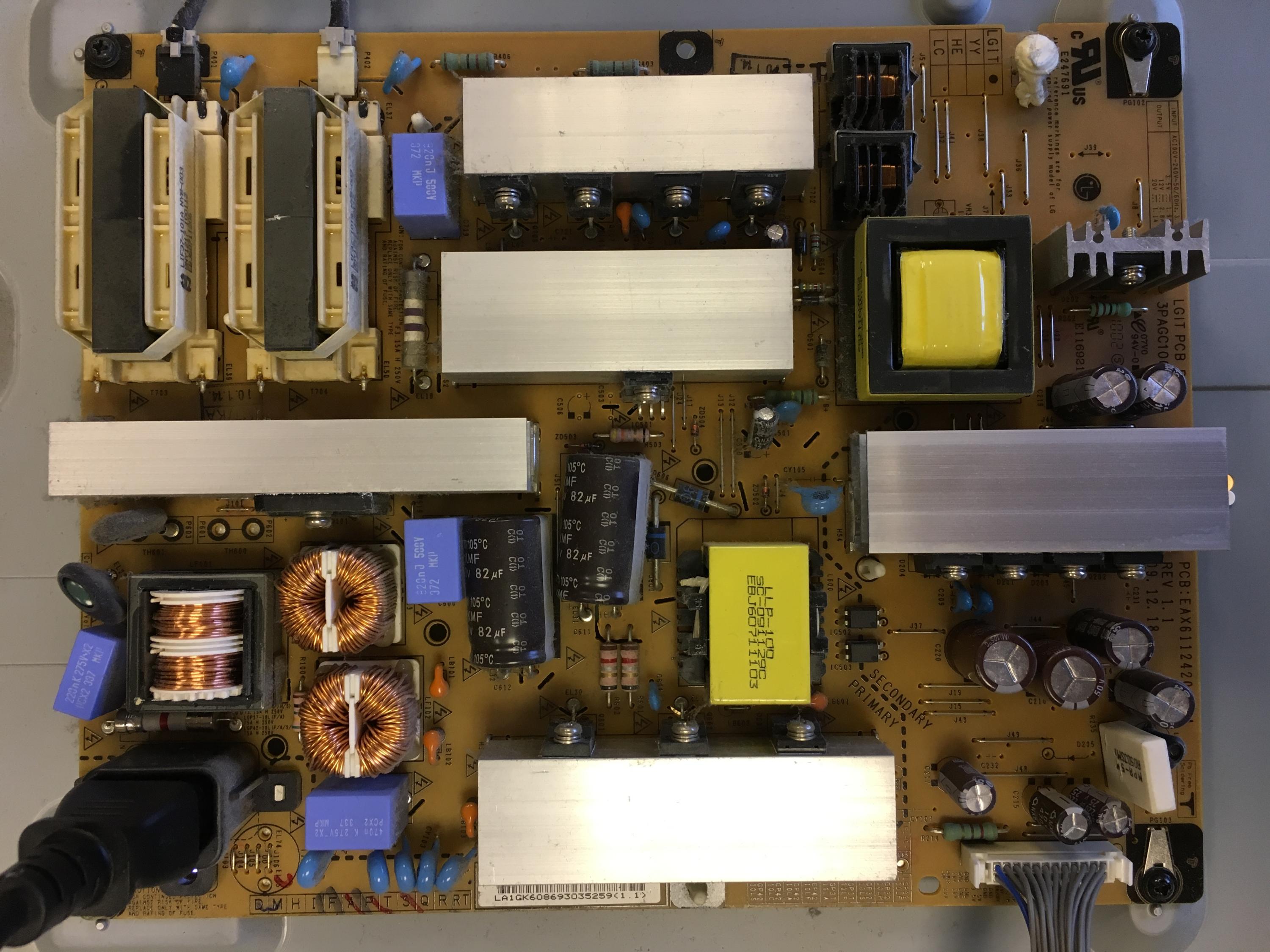

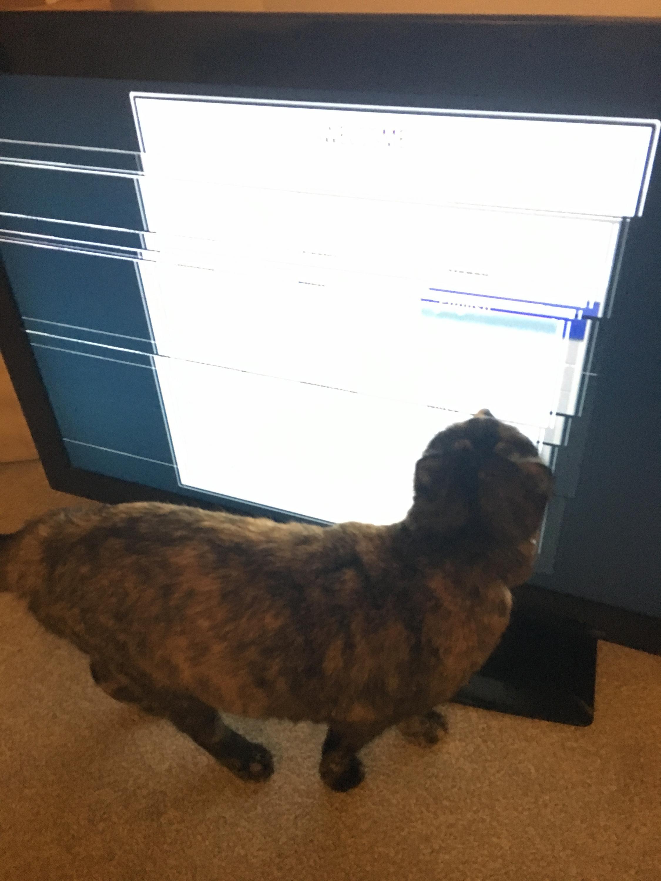

    I have been given a sickly LG 37LD490 with a glitching/tearing picture that improves as the tv warms up, but never quite clears up, also the HDMI ports don't seem to work. It powers on fine, gets past the LG logo to the spinning LG cube, you can enter the menu, etc, although I don't have the remote
    The power supply output looks like this;
    NC | Error
    12v | P-Dim
    12v | A-Dim
    12v | INV ON/OFF
    Gnd | Gnd
    Gnd | Gnd
    3.5v | 3.5v
    3.5v | 3.5v
    Gnd | Gnd
    Gnd | Gnd
    20v | 20v
    Pwr On | 20v
    The 12v output is running at 12.3v, the 3.5v is at 3.4v and the 20v is 21v. My assumption here is that is in reasonable spec. No visibly nasty parts, everything looks "normal". Attached are pictures of the three main boards and my furry diagnostic assistant.
    I gather from googling that re-flowing might be in order? Any tips gratefully accepted.
    Thanks.

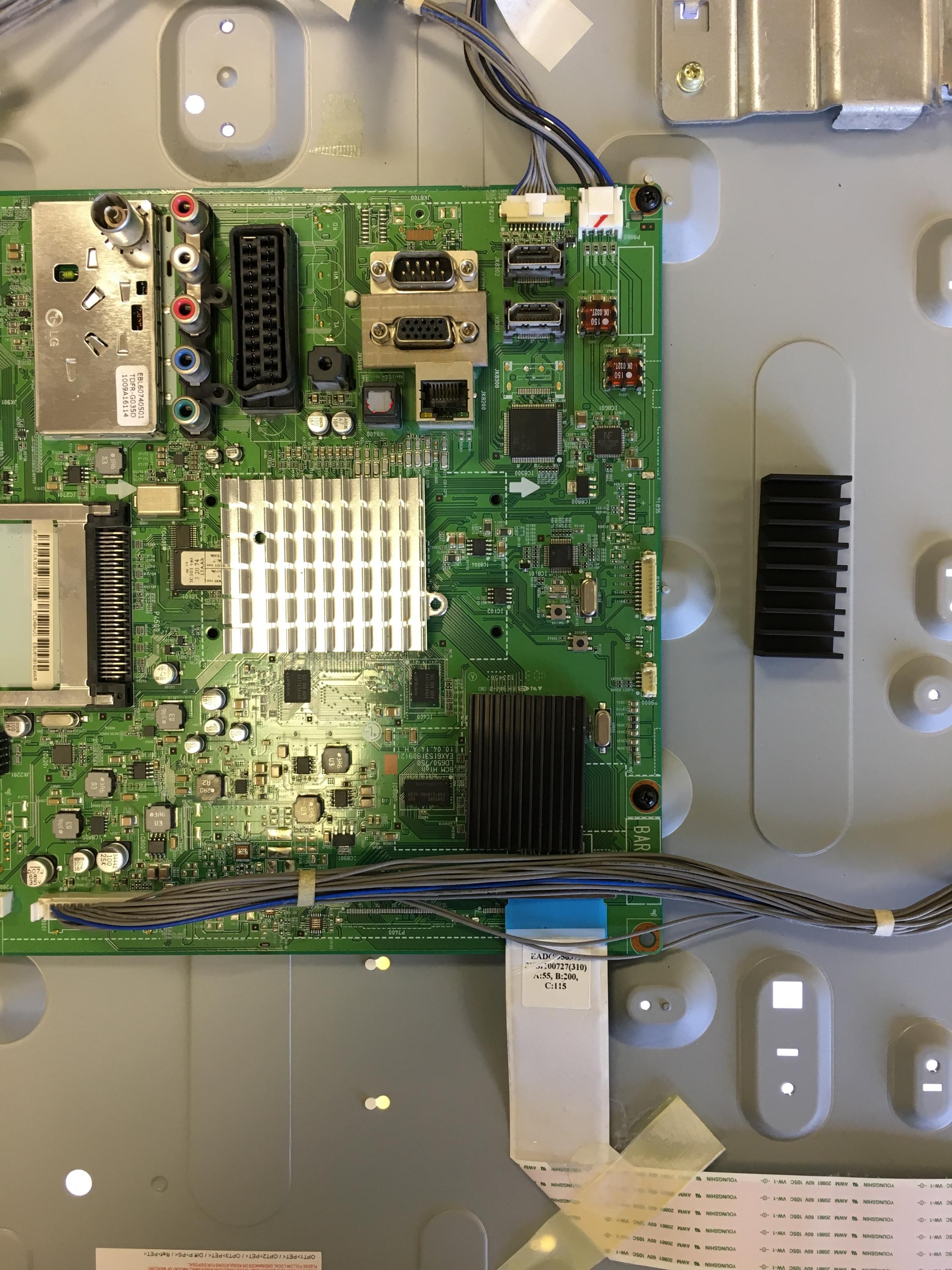

      Given the very poor implementation of the heat sink on the XD chip, I'll start there. The sad part is you can see the PCB has been designed to take a heatsink MUCH larger, but they opted for a 2/3rd's option, leaving some of it uncovered, that can't do it any favors.

          I'm going to try and find a larger heatsink in my spare parts bin, a passive cooled graphics card would be suitable I suppose. Anything is better than the LG supplied one

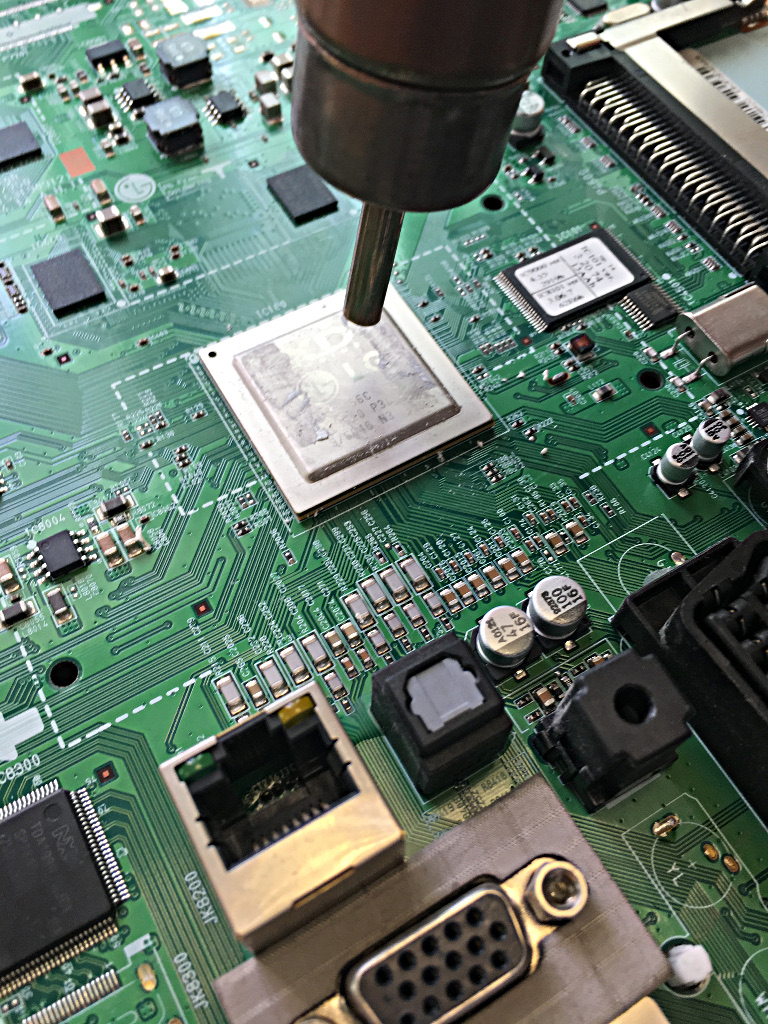

          Using a cheap rework air station, picture attached

                Re: LG 37LD490 - Glitching picture.
                vinceroger69 - I only have very fluid flux, not the nice thick stuff, I need to order some soon. I applied a little around the edges but most of it had evaporated by the time I'd finished.
                ReeceyBurger123 - I've found a nice AGP graphics card with a heatsink four times the size, just need to find some sticky back thermal silicone.
                I cooked her gently for 10 minutes at 300 degrees, currently letting it cool down by the window, will test shortly.

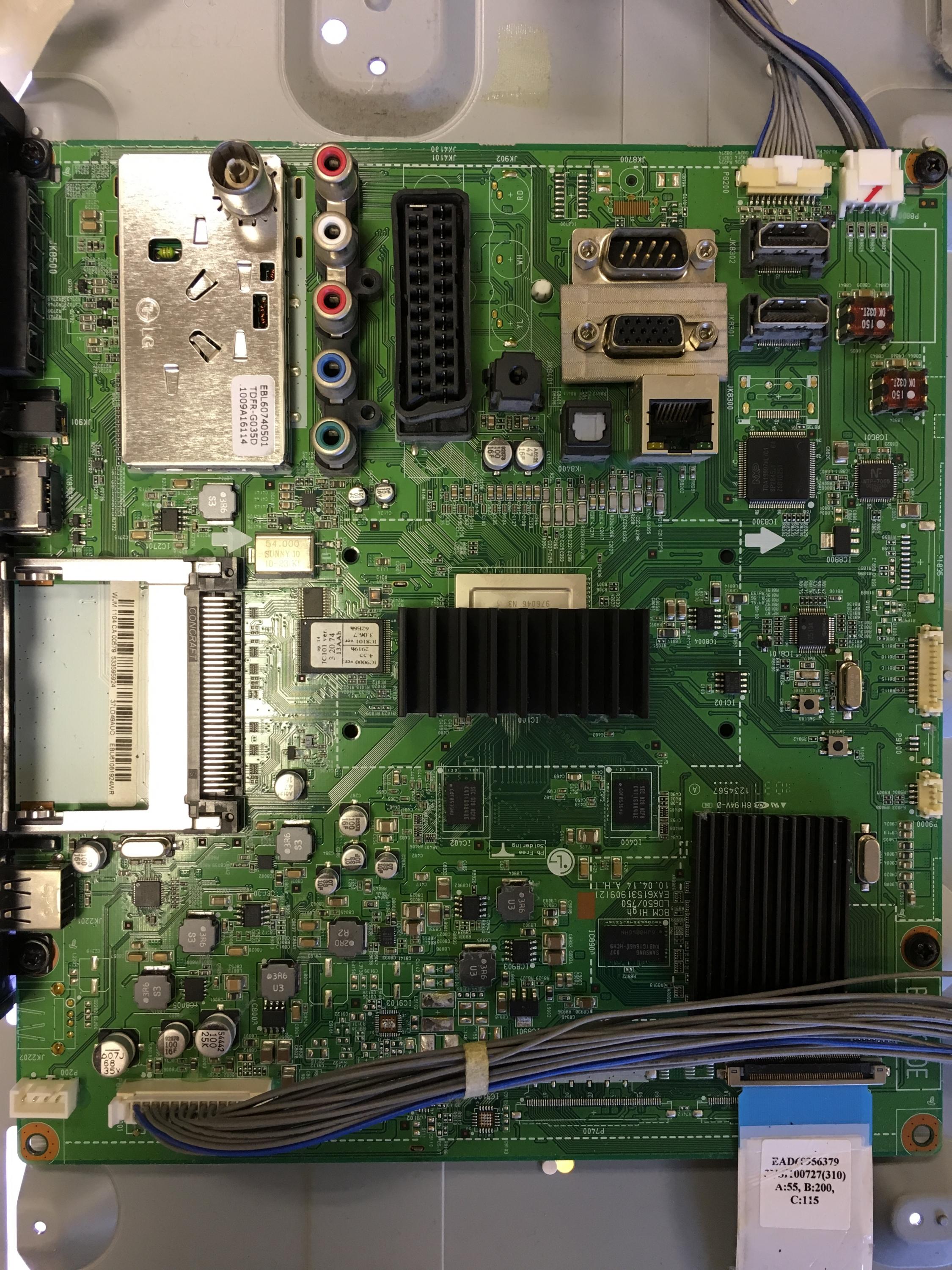

                        After a night to cool down she's fired up fine this morning, a day of testing awaits her.
                        Attached is a picture of the proposed heat sink, the old one is off the board for comparison. It still gets so hot, you can barely touch it, but I'm hoping the extra surface area and complete chip coverage will help with the longevity of the repair.
                              Should apply thermal glue to attach the heatsink to the board itself as well. Two reasons:
                              1. The heatsink's weight may force the solder to crack again.
                              2. It dissipates some heat to the board, and the board acts like a second heatsink

                                It's sitting a little high for that, but I'll see what I can do, I'd love to see the original design! I'm still waiting for the glue to turn up in the post, but the TV was left on all day yesterday watching some movies by itself and it's continues to work fine, picture wise and HDMI ports. Left off over night and back on this morning, everything good.
