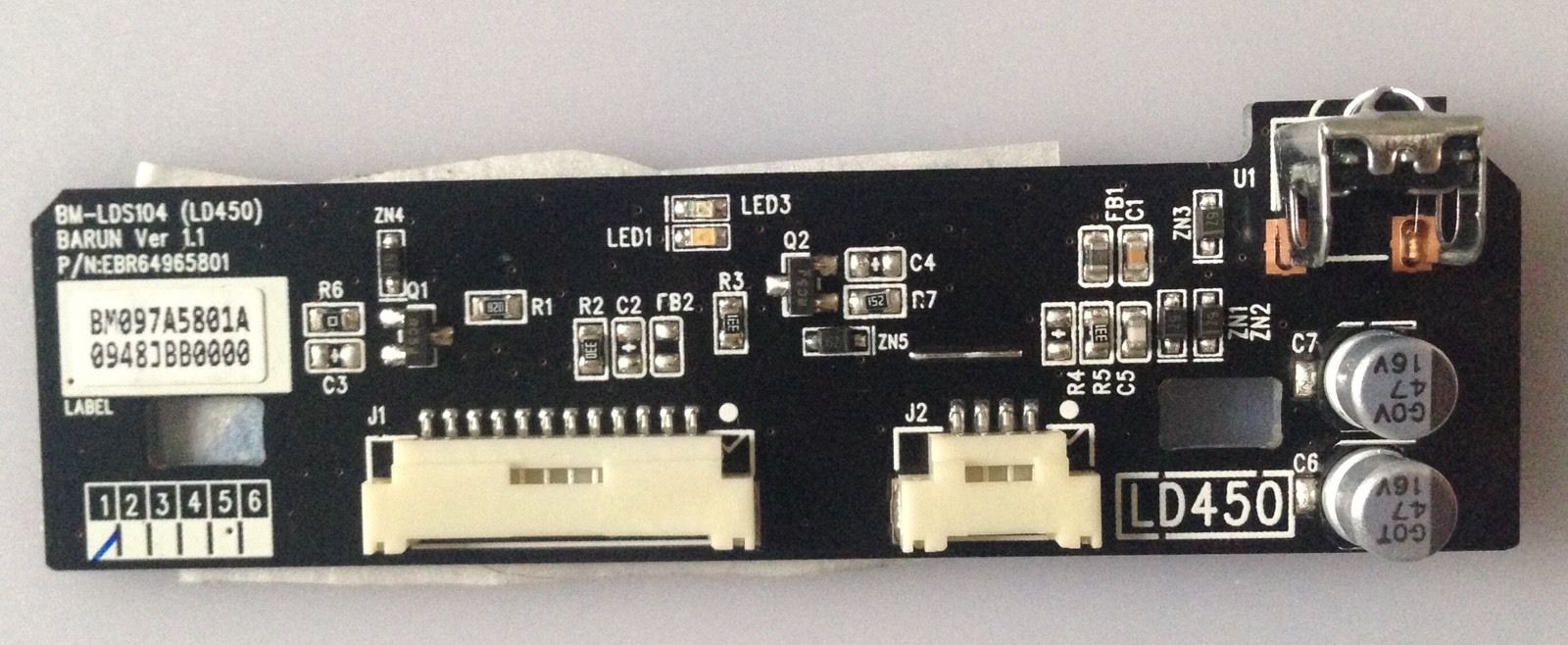

            After a great deal of testing, the picture and inputs continue to work. It does still have one problem.
            I bought a replacement remote as the previous owners had long ago lost the original, claiming it never worked very well so they stopped using it. The replacement is very intermittent, as a test I used a universal remote and they too is intermittent, so the assumption is it's the TV.
            For the hell of it, I've ordered a very very cheap spare IR sensor board to swap out, but while I'm waiting, does anyone know if this is a common fault? I read the voltage on the IR receiver, it's voltage would fluctuate when receiving a signal, so I'm hoping it's not still a problem with the main board.

                                I've tested continuity on the sockets and the cable, they seem OK but I guess I could give them a little attention with the iron, wouldn't hurt!
                                Attached is a picture of the IR board, it's pretty simple looking, I've tested the zeners, caps and the resistors, they seem ok, although I've not tested the two transistors.
                                • vinceroger69
                                  • Mar 2012
                                  • 6714
                                  • uk
                                  #36
                                  Re: LG 37LD490 - Glitching picture.
                                  as you say if the old owners complained it had issues to it has to be the ir board or mainboard does this set have side buttons do they all work ok? if so i guess you can use them but if your like me you like a 100% fix no faults etc.

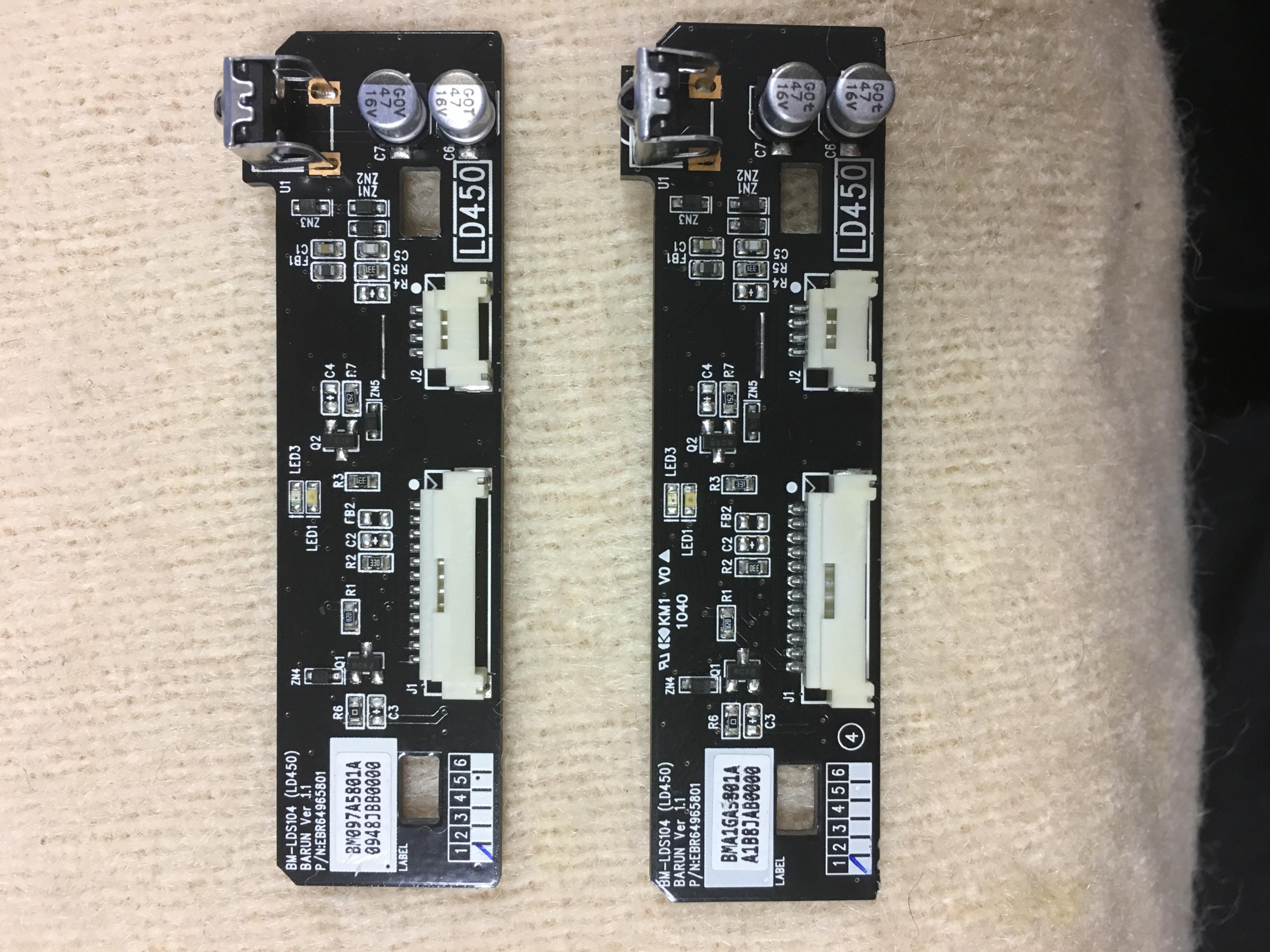

                                      OK, swapped out the suspect one for the 2nd hand one and its even worse. Other than allowing the TV to come out of standby once, none of the remote control buttons function at all. Swapping the original board back in allows gives me back most functionality...
                                      I've given it a stern look, but it refuses to cooperate.

                                        i would send your new board back and get a refund i wonder if somehow this board needs to match the mainboard? seems odd it just turns it on
                                        • jondoe
                                          • Nov 2016
                                          • 547
                                          #40
                                          I've attached a picture, they could be twins! It's very odd, I tried them both in and out a few times, no change in function.
                                          The mind boggles!
