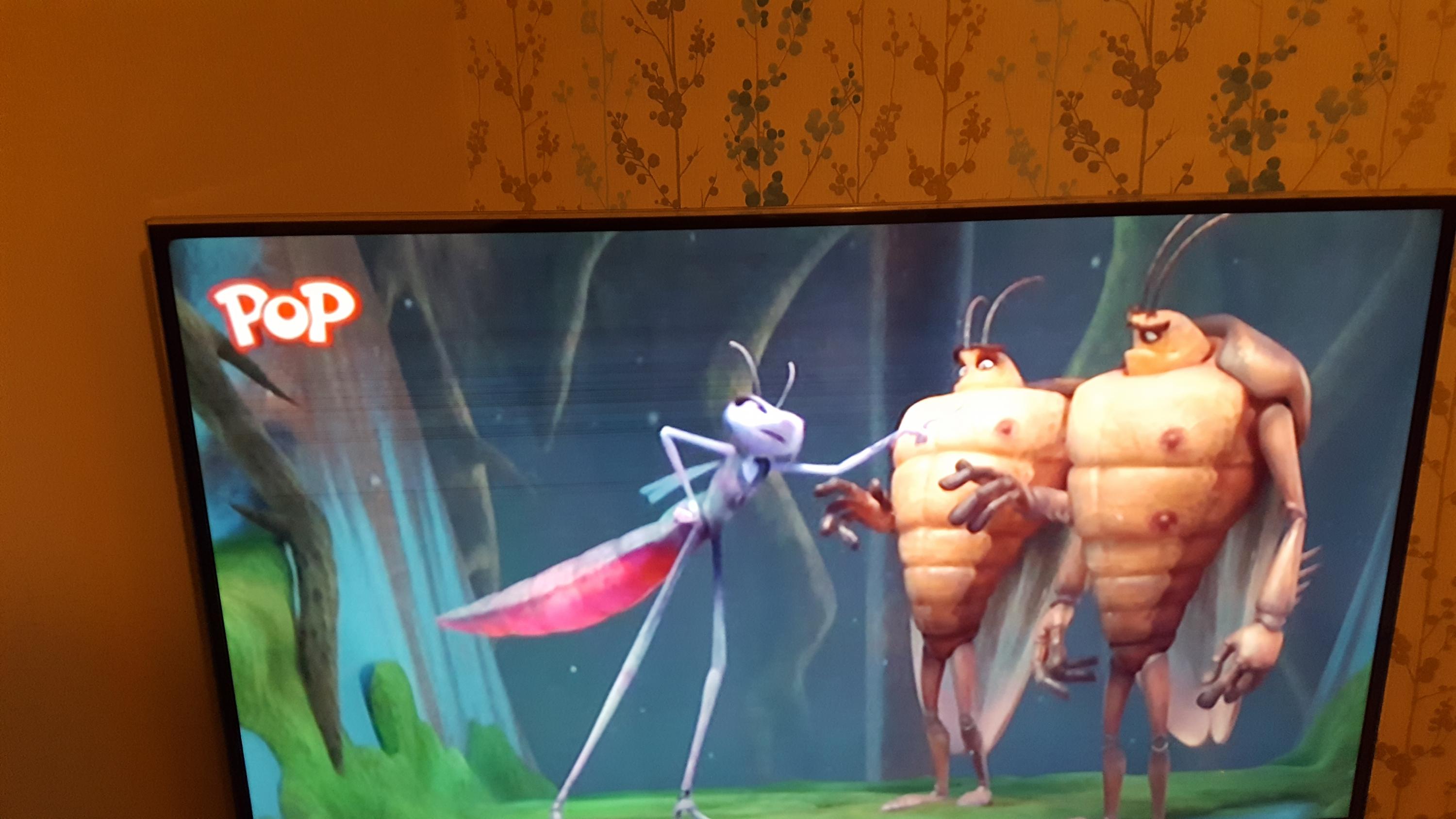

    I've got horizontal thin black lines starting on the left hand side top quarter. The lines seem to disappear the further right they go and only seem to be on the darker colours.
    Any ideas of what could cause this?

    Screen shot of what you are seeing?

      Re: Samsung ue48h6400 horizontal lines
      One
        most horizontal lines belong to T-CON fault and LVDS connection, start with clean LVDS and reset them.

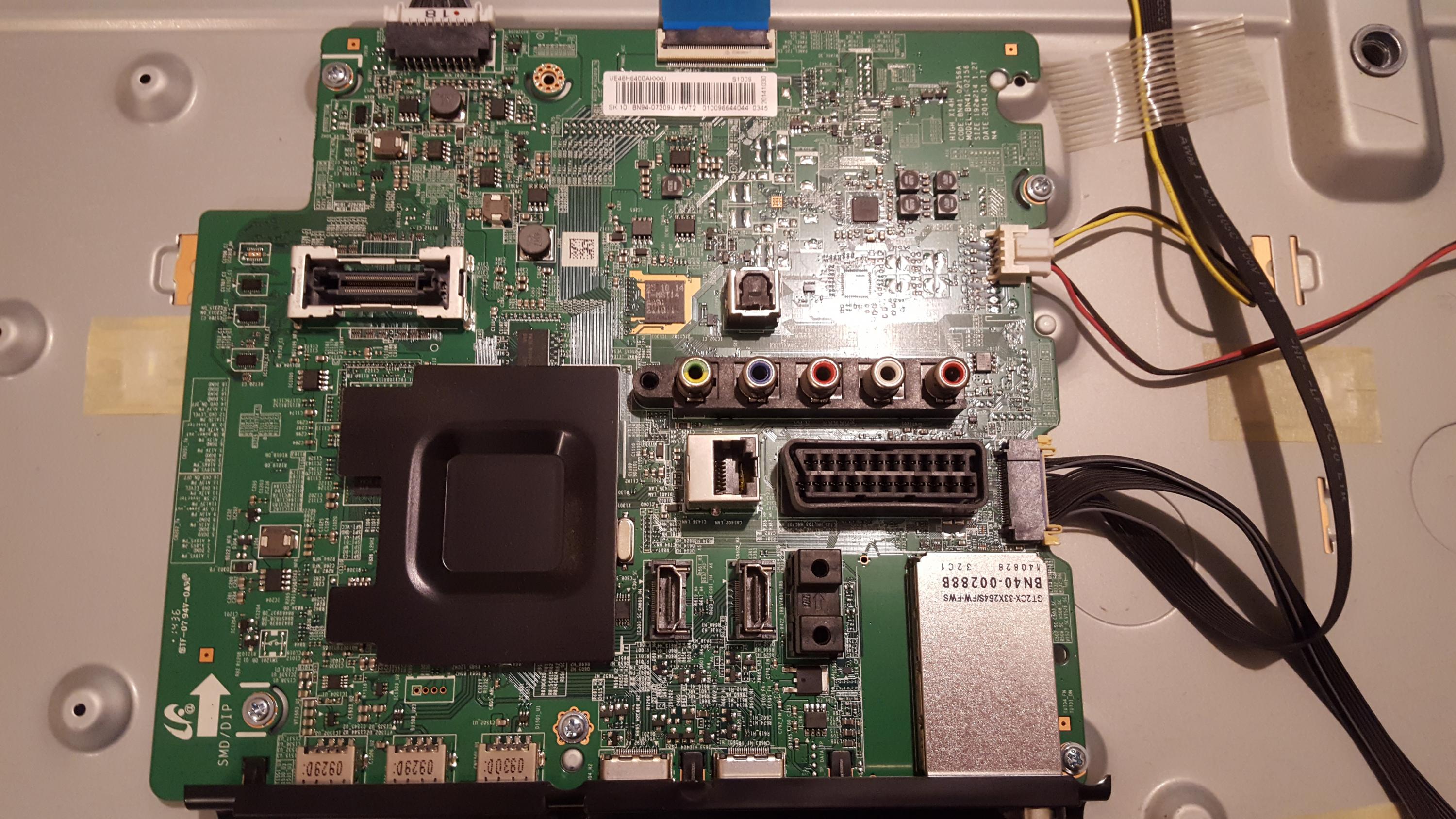

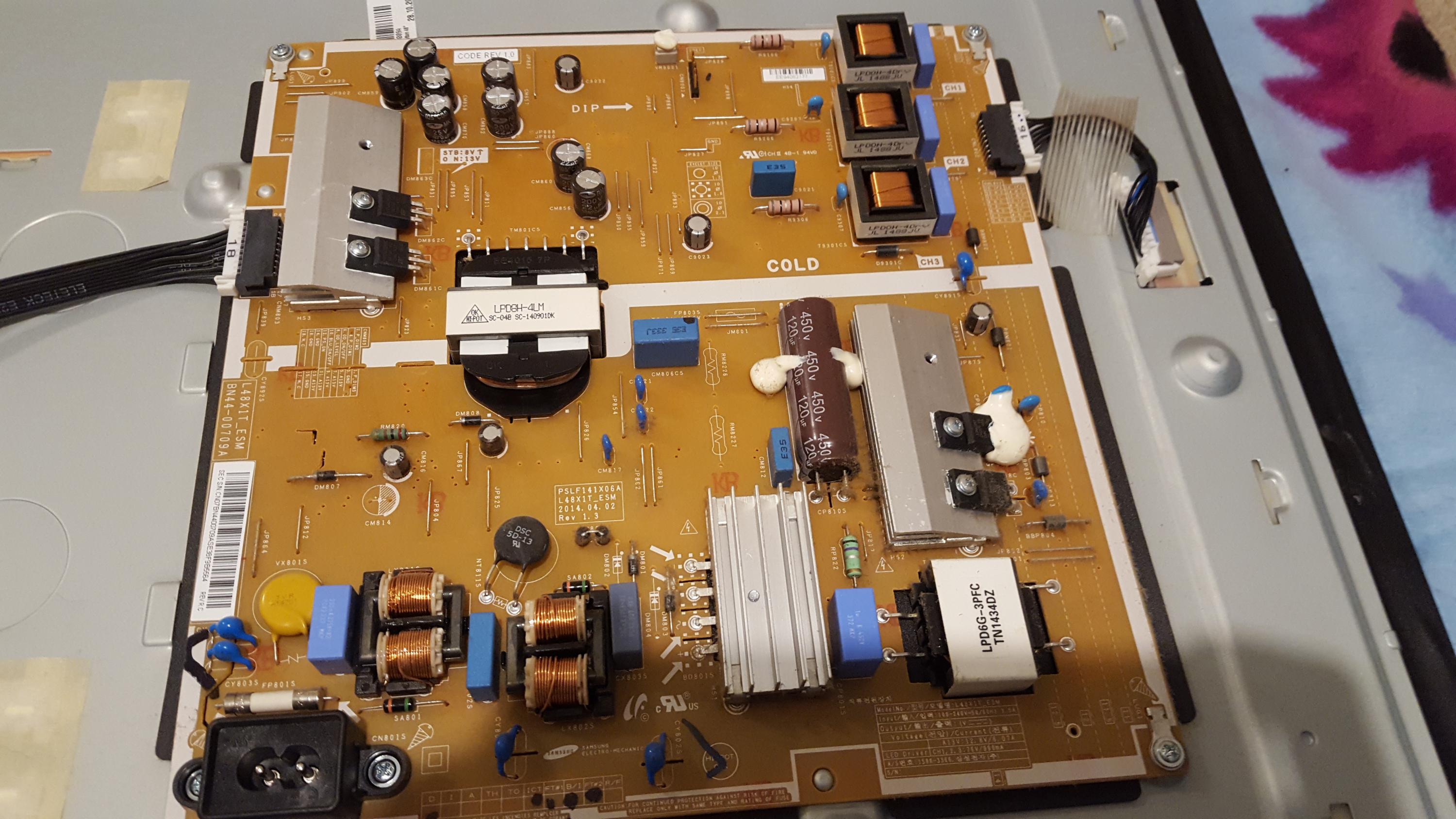

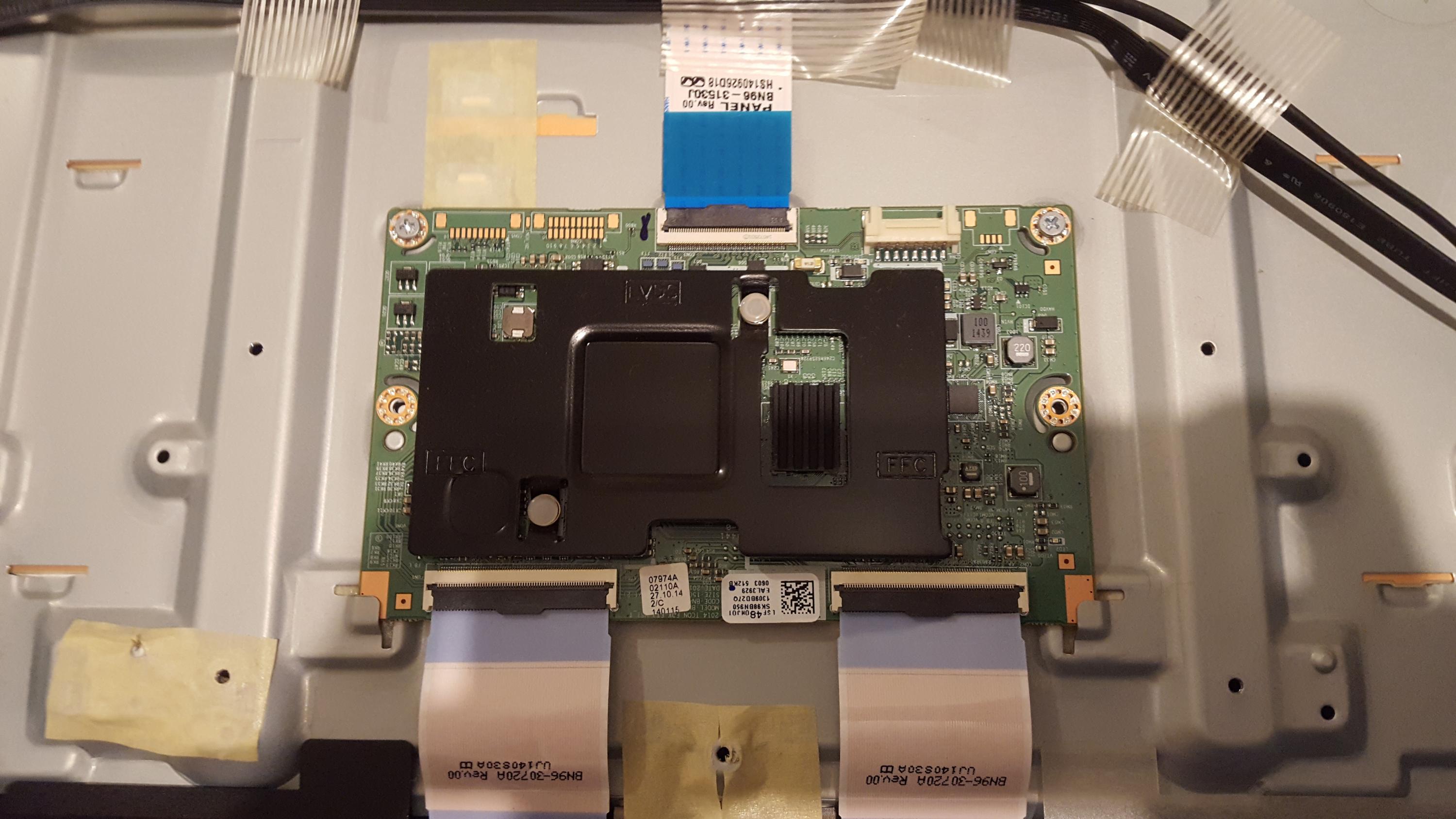

                              Boards
                              • Diah
                                • Feb 2013
                                • 6598
                                photo in the middle No2 if the clean and reset LVDS from T-CON to MB or the ribbon cable from T-CON to the panel didn't help, replace T-CON

                                  Gave them all another clean nothing has changed same lines. Should I try the cable? Is it definitely the tcon? As the picture is perfect bar the line on the darker colours
                                  • Rob0904
                                    • Dec 2016
                                    • 57
                                    • Uk
                                    I've ordered a replacement tcon board. If that doesn't sort the issue what else could it be? Panel?
