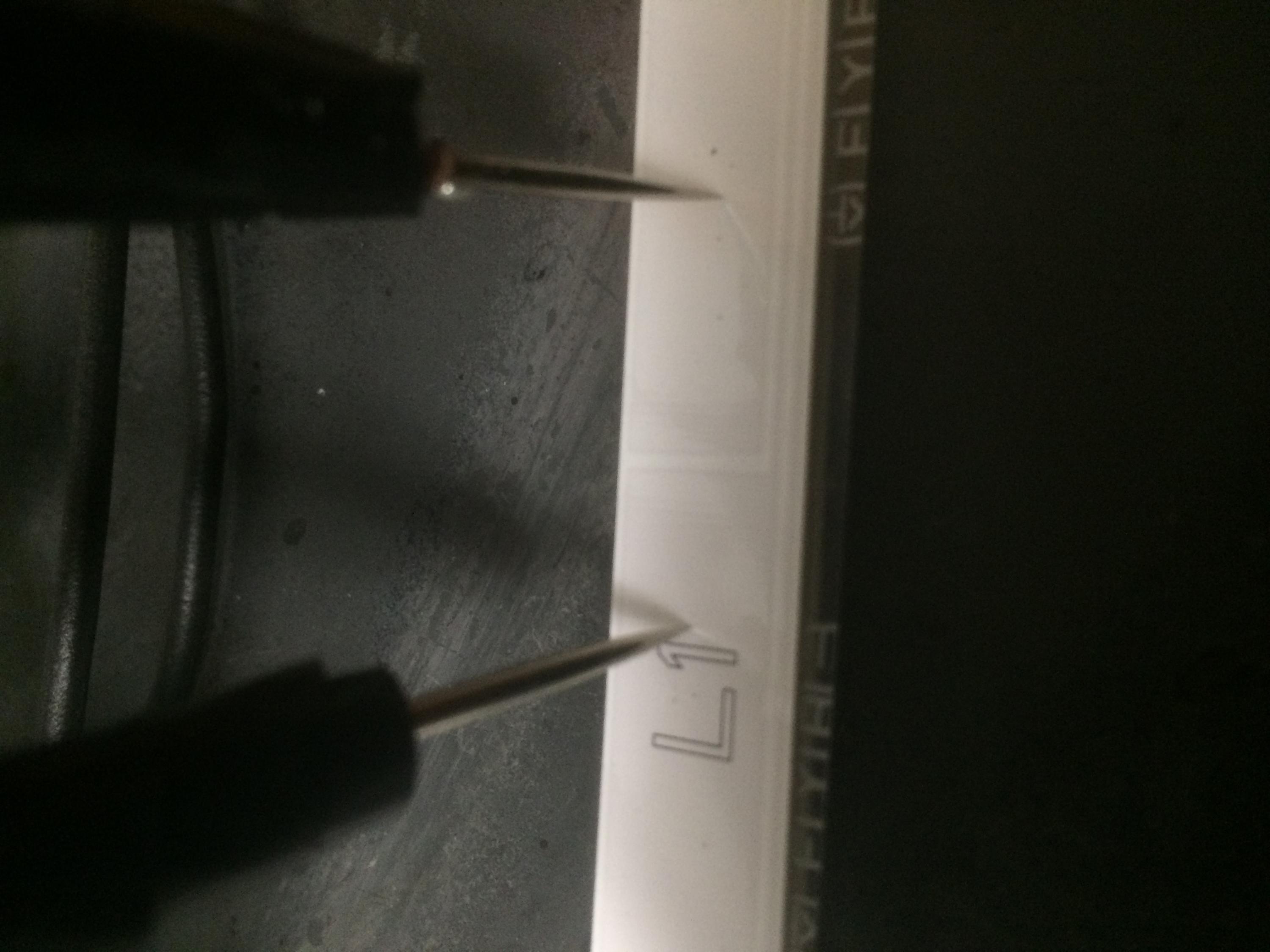

    I have repaired about 6 of the same model tv within the 2 weeks, with the exact same problem. They all had bad leds..Very cheap fix , but time consuming

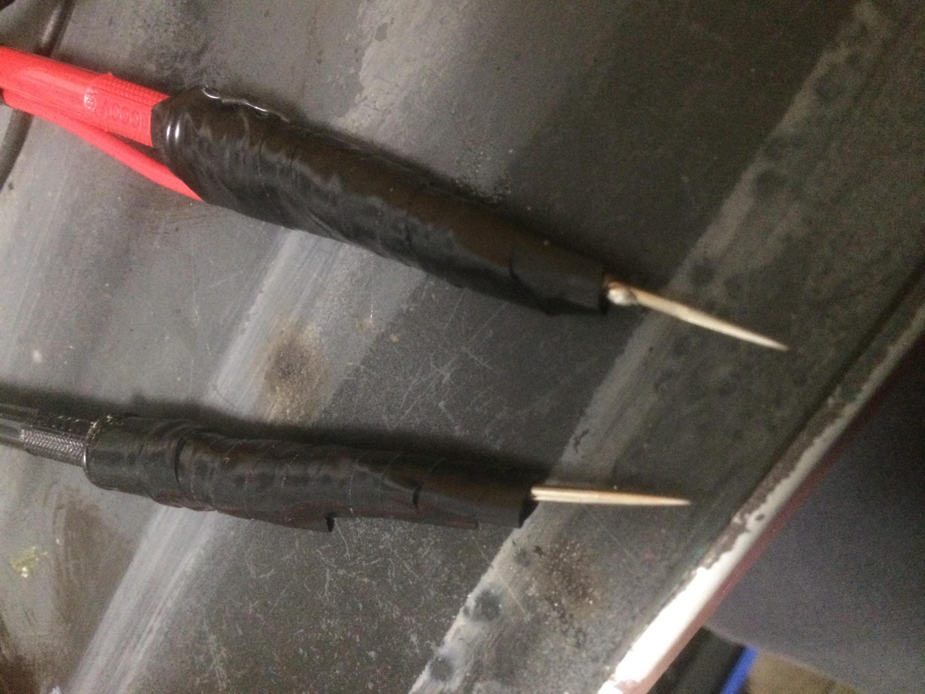

      Tear tv down to led stips

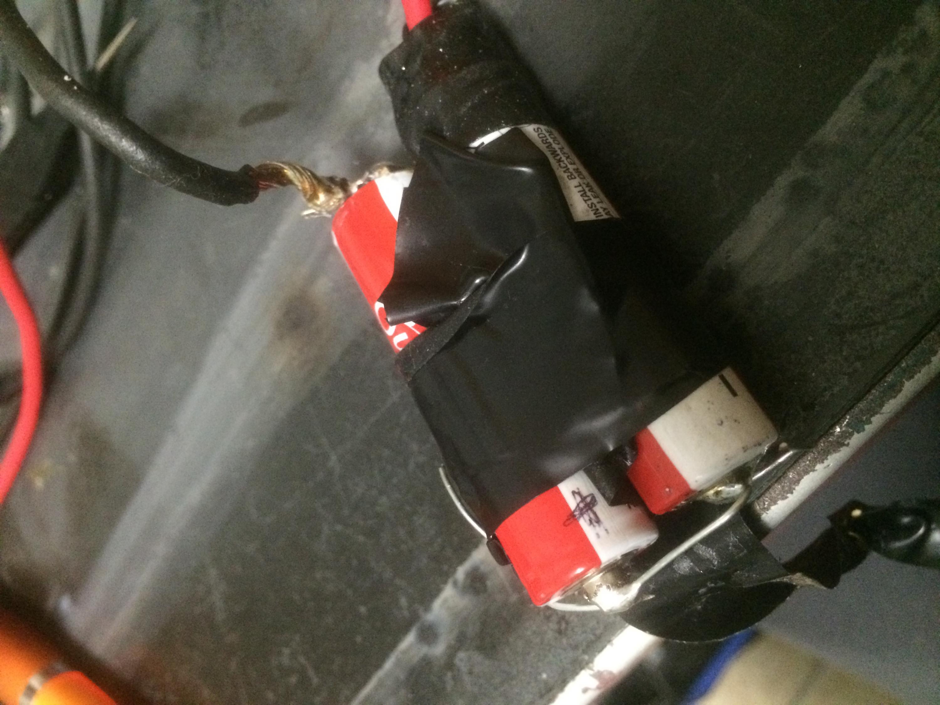

      Solder 2 AA batteries together, Neg to Pos
      Solder leads to other sides, and solder the thickest sewing needles you can find at the ends
      Test each led by, pericing the Pos lead to the right pad and neg to left pad. Appy good pressure and a couple of wiggles to make connect under plastic

        Be careful using batteries testing LED without current limiter due to if the applied Voltage is applied with wrong polarity to the LED, the protection diode in the LED will heavily conduct if the polarity is not observed and it will shorted out and you will damage good LED. So make sure you have verify the correct polarity of the LED first.

          Yes I think LEDs bad also....I used an analogue meter on RX1 to test LEDs like that...........I bought the LED Tester and use that instead, now.
