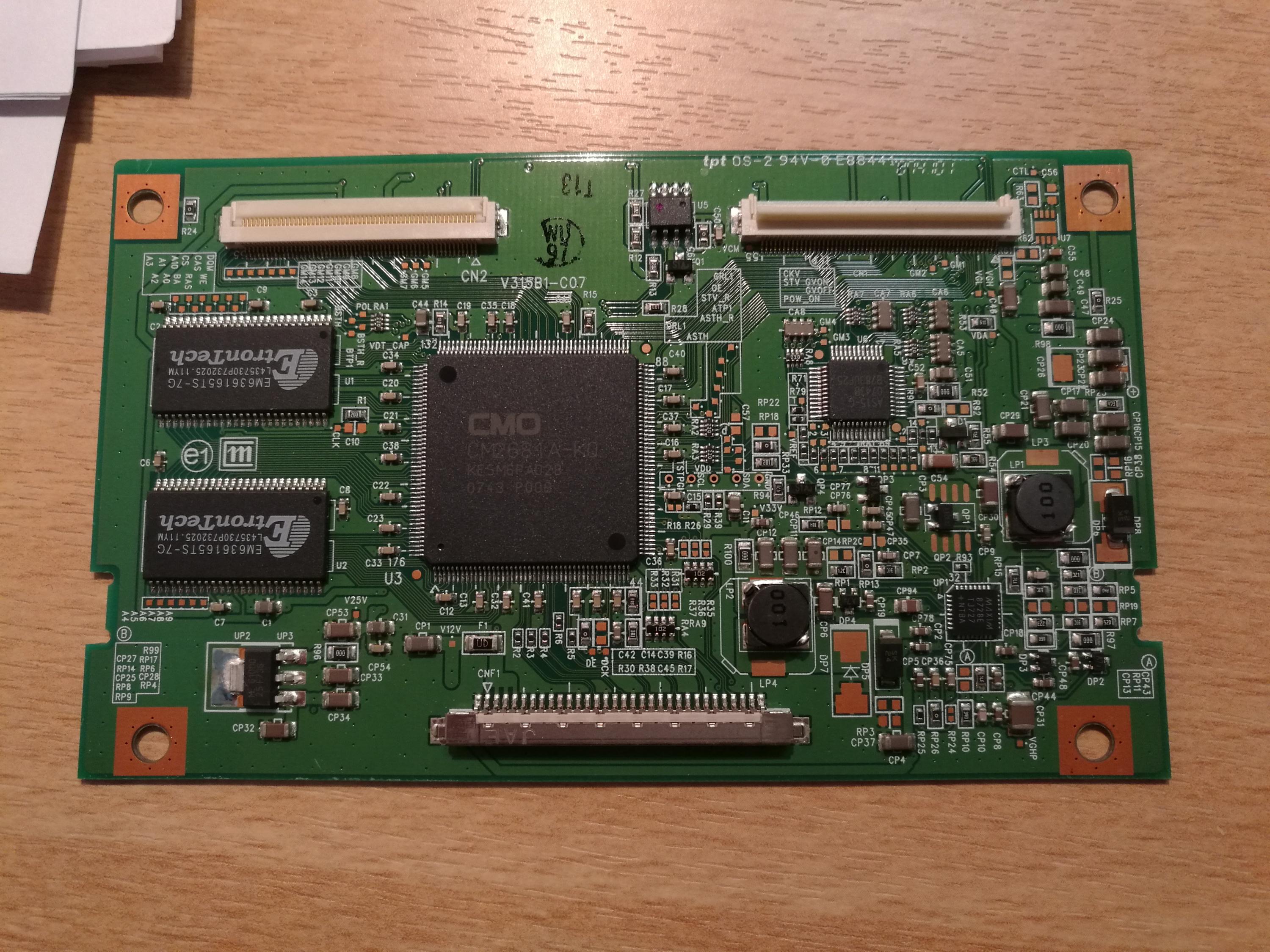

                  Re: LG 32lc46 solarized colors
                  Hello
                  I've tested with a VGA cable on the PC input, same color issue.
                  Do I have to test with a scart input (a old DVD player).
                  here's a picture of th t-con board.
                  thanks for your help.
                  Best regards
                  JM

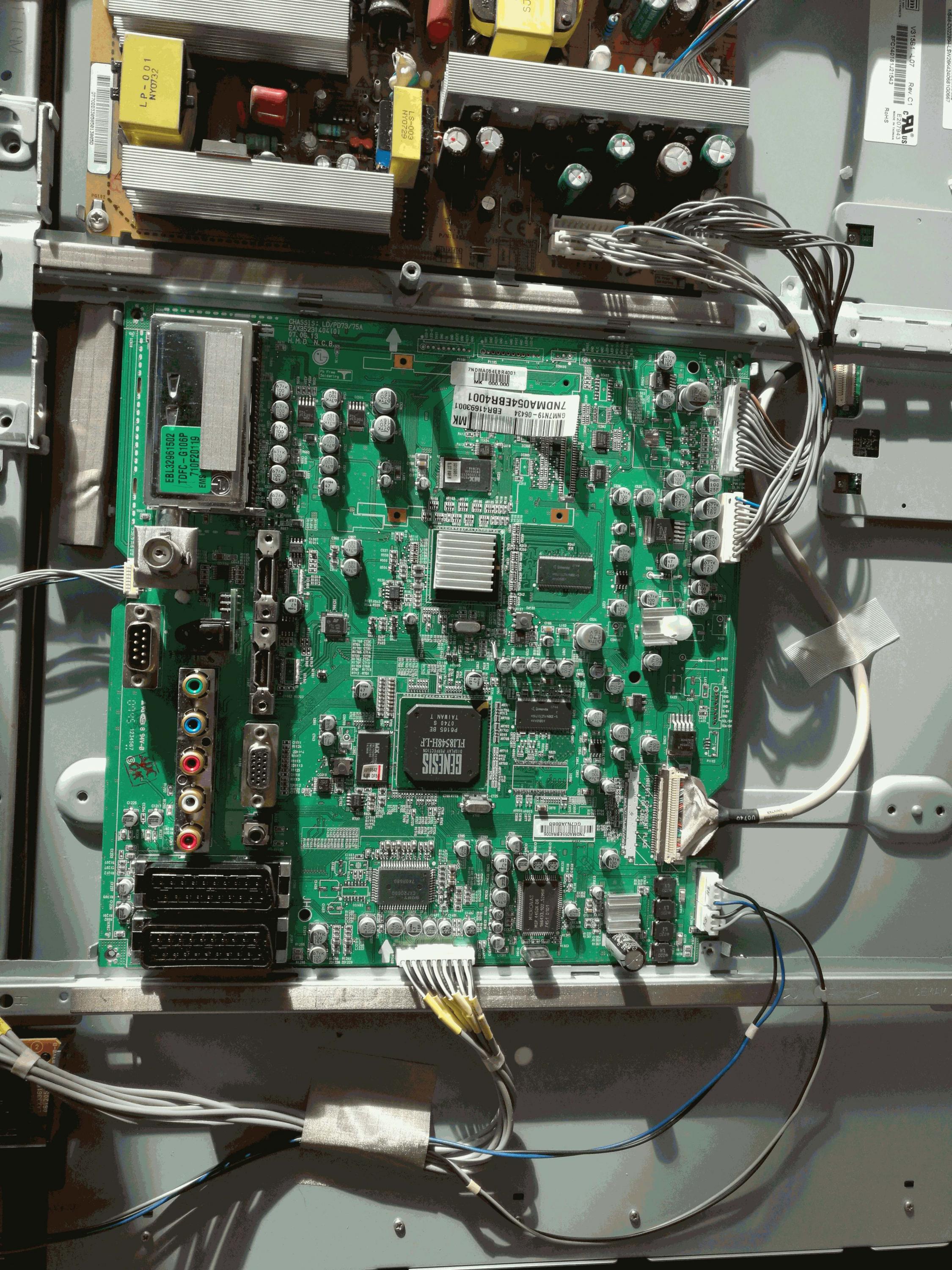

                  • vinceroger69
                    • Mar 2012
                    • 6714
                    • uk
                    thats not the tcon the t con is usually under a metal cover on the right hand side of the mainboard in the picture theres 4 connectors on the right hand side the third one down if you follow that cable the tcon is on the other end of it if you need more help upload a picture showing the whole back of the tv then we can point it out.

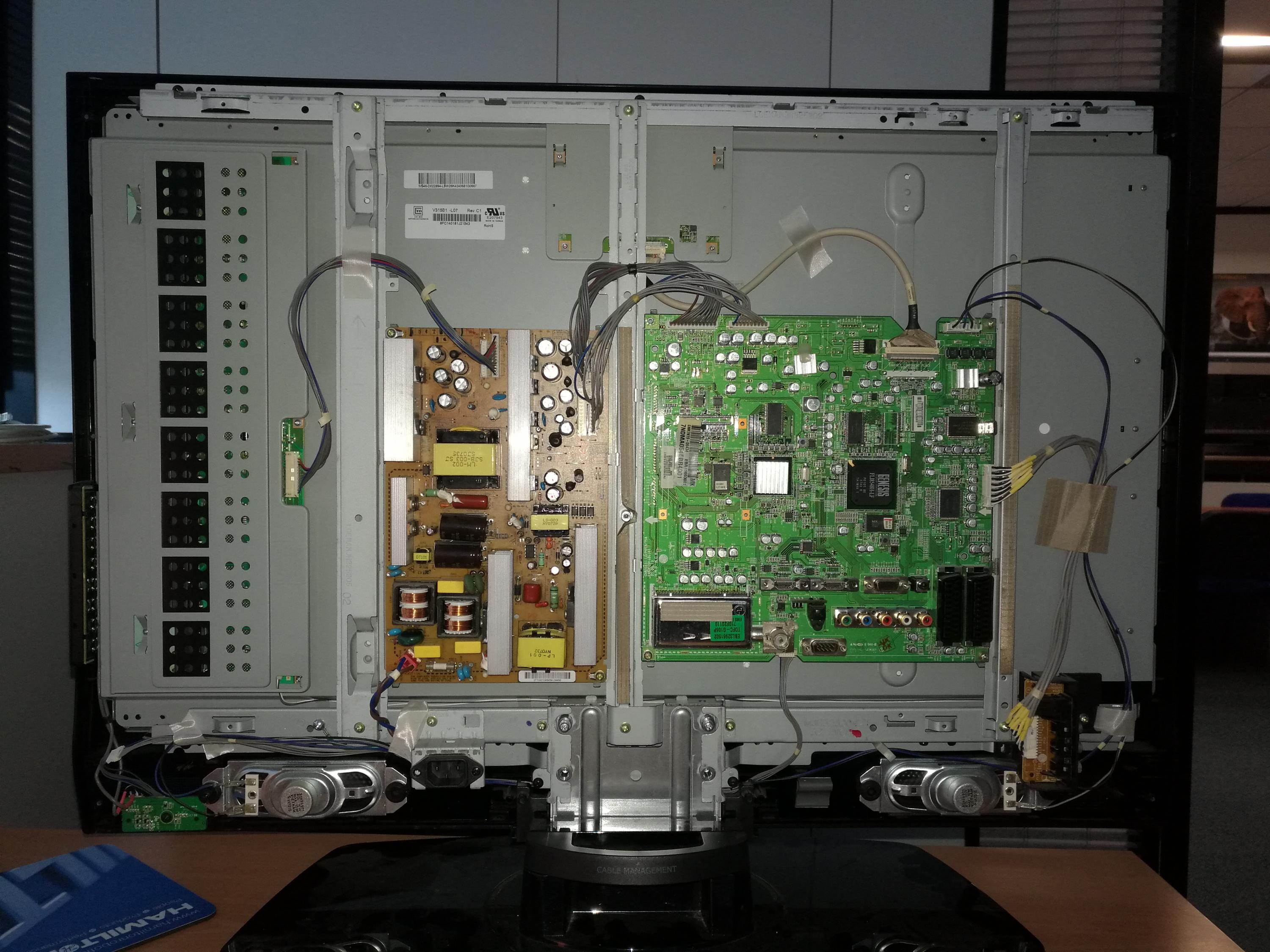

                    • perette
                      • Mar 2013
                      • 71
                      • france
                      Hi
                      the full back of the TV set.
                      sorry for my mistake, where is the famouw T-con (the board hidden at the top ?)
                      BR
                      JM
                      • diif
                        • Feb 2014
                        • 6978
                        • England
                        Yes, under that metal cover with the 4 screws.
                          Hello everybody
                          got it. now I see it, the famous AS15.
                          here's the t-con.
                          now the question : is it for sure the T-Con and its AS15 that are creating this beautifull color scheme and then changing the as15 (could be tricky, i don't have the propore tool to unsolder it) or the complete T-Con can solve the problem?
                          best regards
                          JM
                          • vinceroger69
                            • Mar 2012
                            • 6714
                            • uk
                            if you cant swop the ic maybe buy another tcon there is a test you can do by measuring the various test points on the t con board too make sure it is faulty if you do buy another board make sure you get one with a returns policy as these boards have a high failure rate or maybe look for a ebay repair service. Notsure if you have any other bad caps members in your area whos willing too swop the ic for you?
