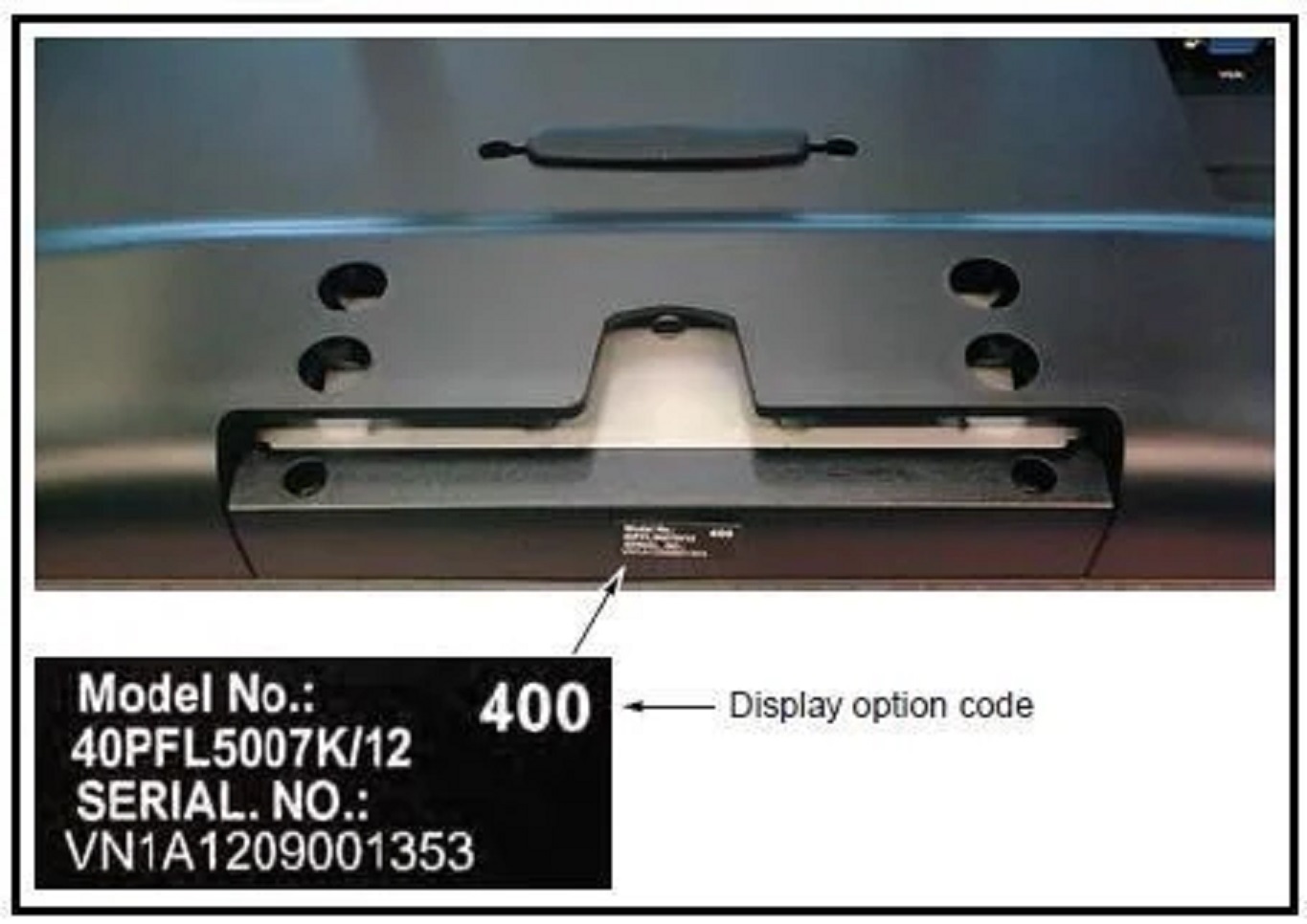

      First check the screencode. Press 062598 menuXXX on your remote, after the code is accepted the TV should go in stand by, if not try again. XXX is the screencode that you can find on the rear cover.
          Thanks! Found the screencode...284....and the TV goes to stand by.
              this mean it accept the code... if the color remain you need to log in service menu sam and do adjustment at white balance
