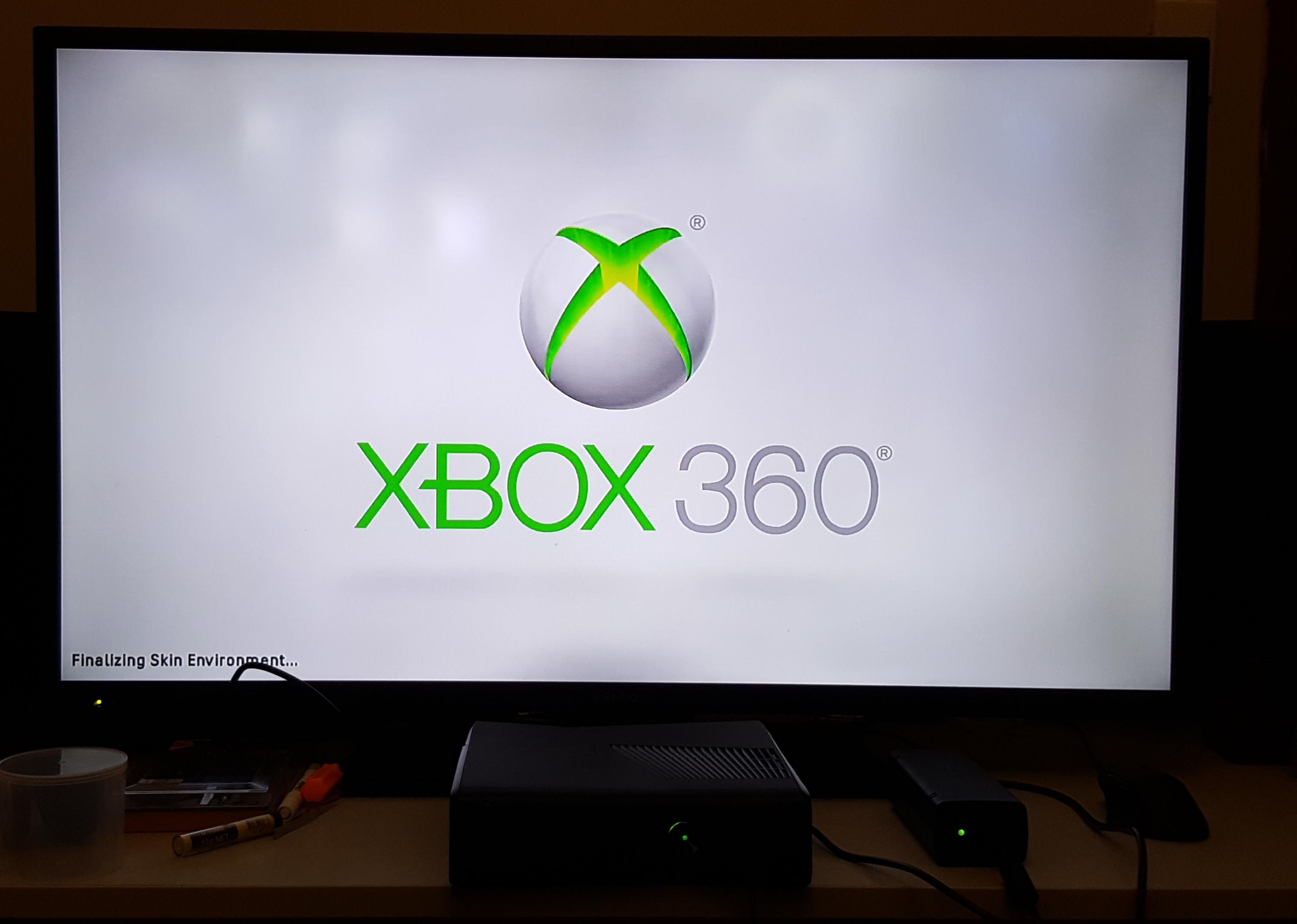

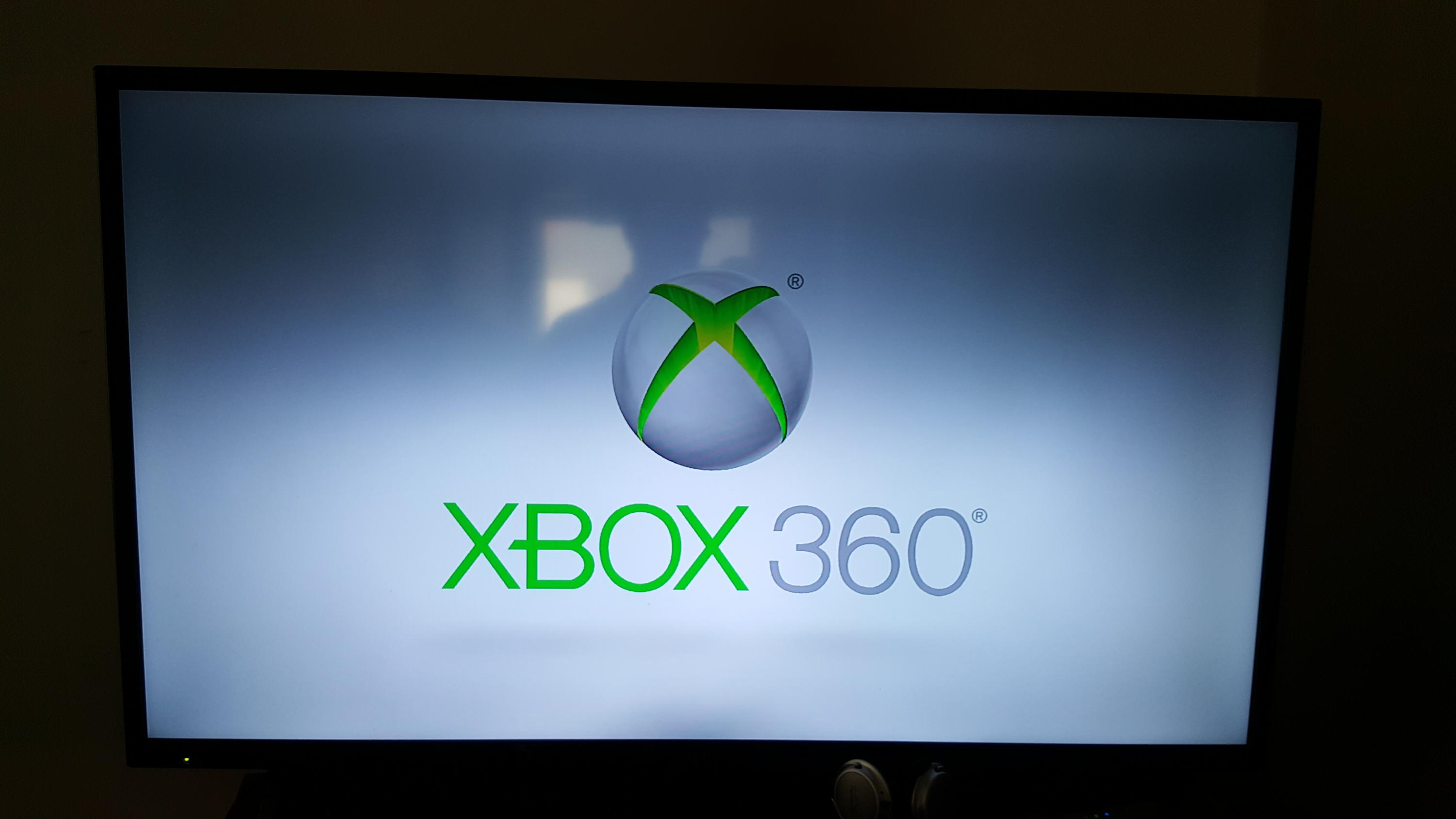

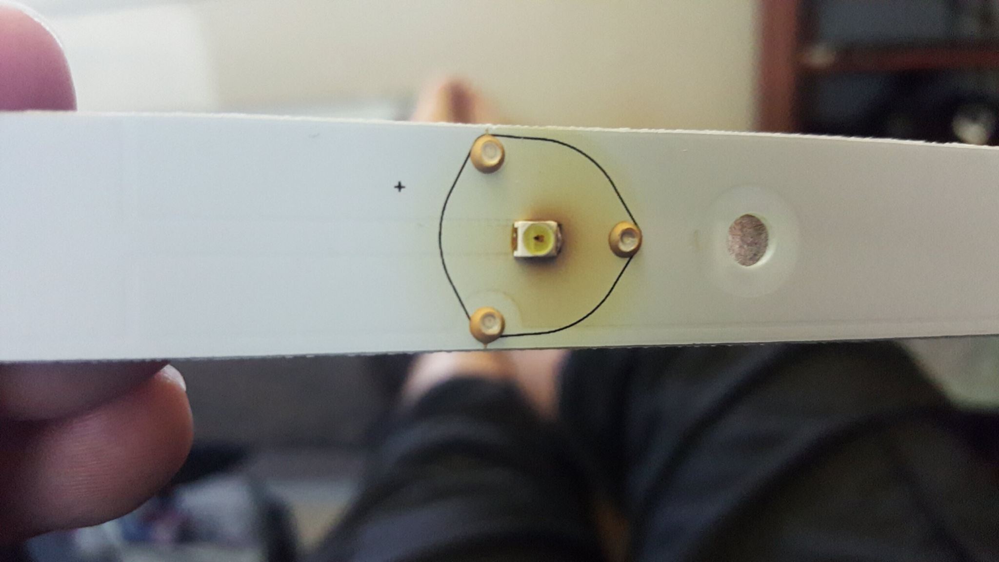

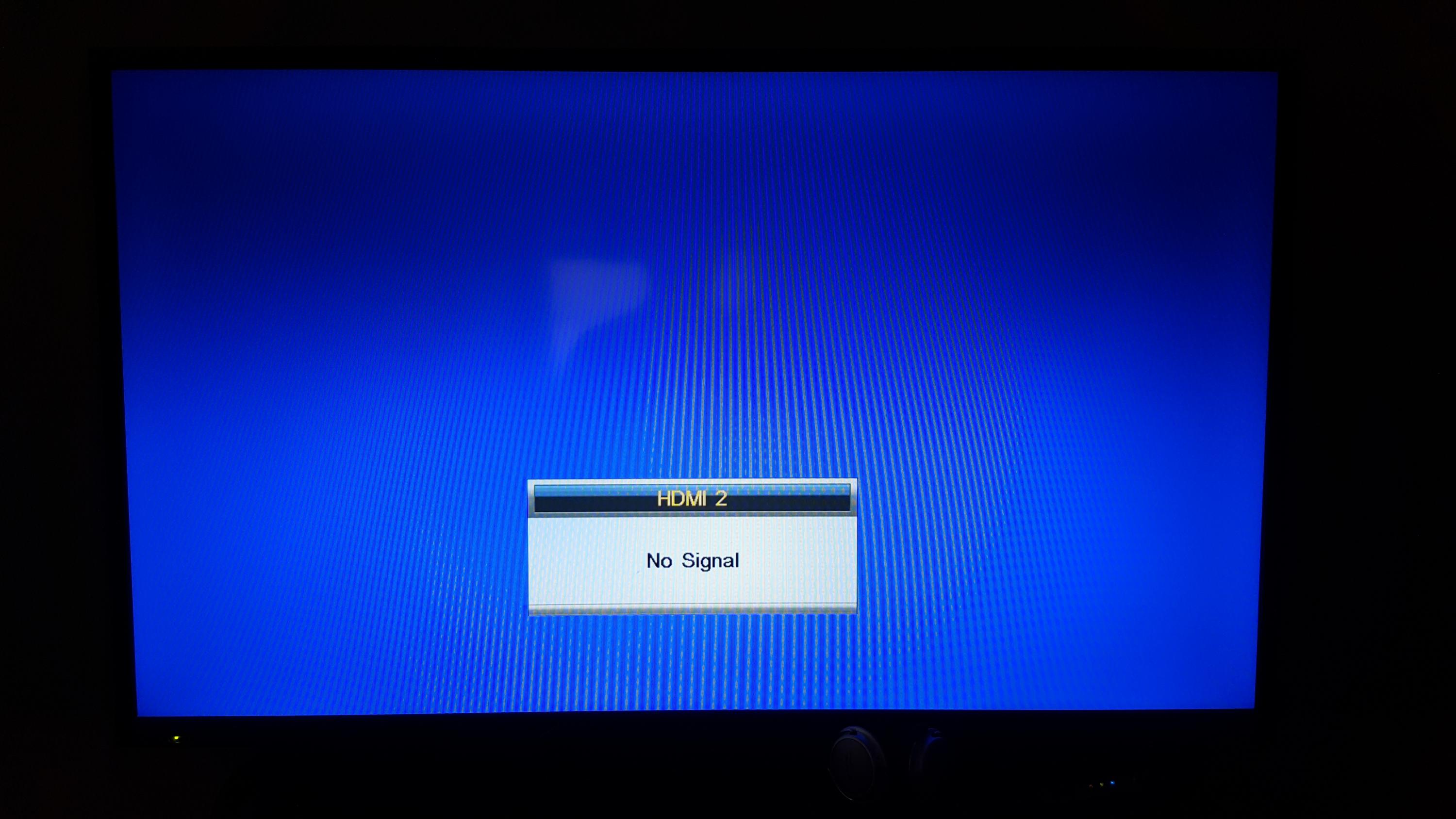

    Hi, I have a PENDO 48" TV, Model "PNDLFHU48" with an LED back light, it has 3 blown LED's on the strip that I need to replace but I don't know the exact specs or type of LED, is someone able to link me a web site where I can them please? I've tested them all and the rest of the strips are still working :-) I'm capable of replacing them on the PCB I just can't find them online :-( I've attached pictures of the LED's.
    In the first picture, positive is on the left end and neutral is on the right end of the LED.

    John;nobody knows who makes that brand,your best bet is to order some of these and try to replace the burned led on your strips and wish for the best,
    in your case those strips should have printed on the the info if not your out of luck.
    you also could contact jimmys.com and give them all the tv info and see if they can find out which led strips are good for that Modle #.

        you can use 3528 SMD LED 3.6V forward voltage, also buy this and cut them to use one by one over yours old one aliexpress

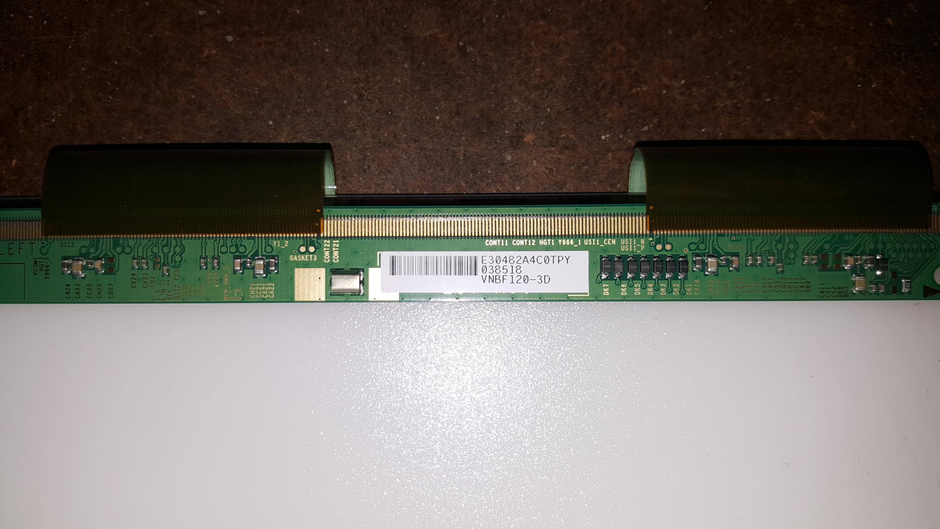

          Yes, I plan to replace the burnt LED not the hole strip that would be hard to find, a TV repair tech friend here in Australia said he thinks it's an LG panel and that each strip runs on 24V, so will those LED's on ebay be the correct voltage?
          Originally posted by budm
          Is it using SAMSUNG LCD panel or?

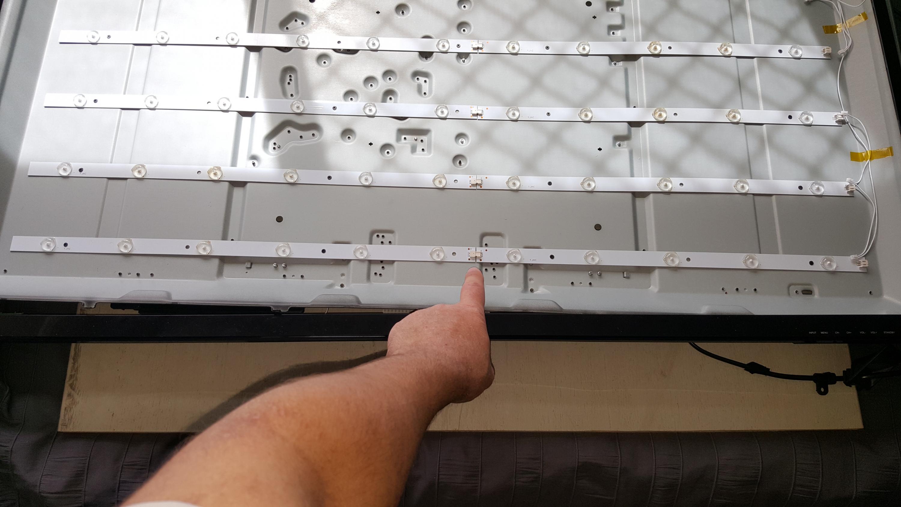

          A TV repair tech friend said he thinks it's an LG panel, I'll attach a picture.

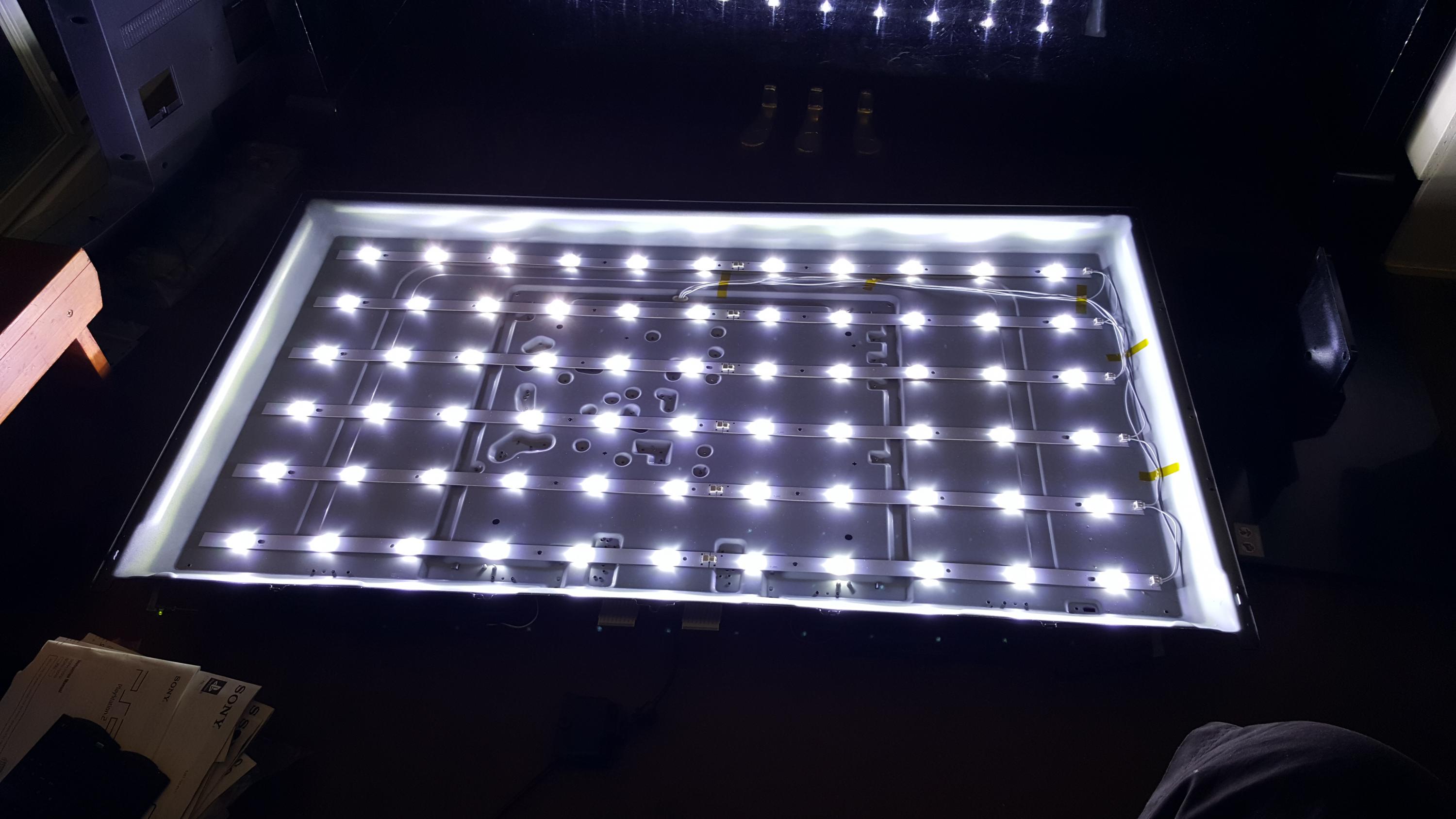

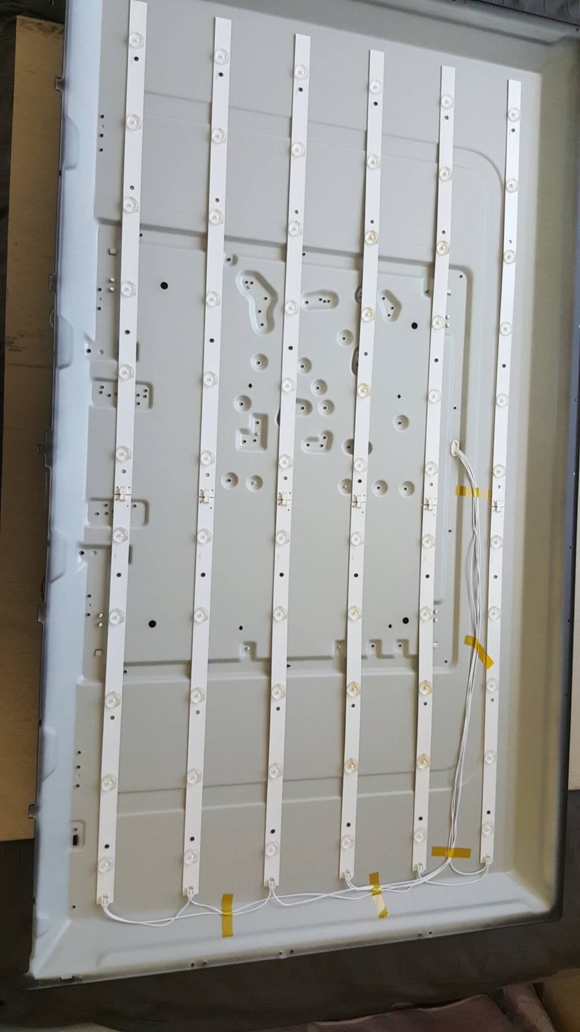

            The one you found on aliexpress is the same type but for a 32inch, each strip on mine is made up of 2 halves connected together, one with 5 LED's and the other with 6, picture attached.

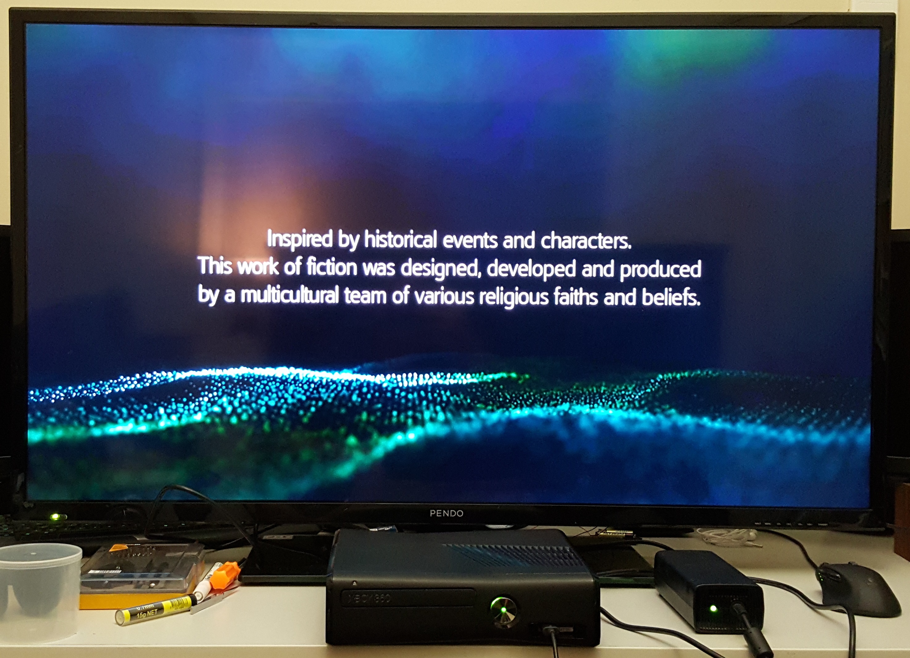

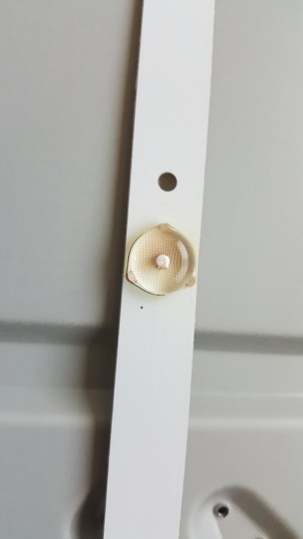

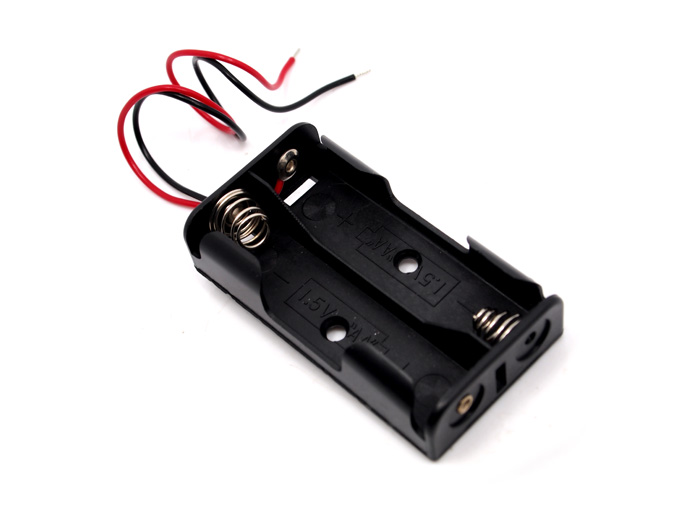

                        The repair was successful so far, hopefully it lasts, just remember to get the polarity right, I used a 2x AA battery holder to test the leds and polarity :-) forgot to take a picture of the replaced leds sorry :-)

                          Well, that didn't last long, the top row has gone but the rest still work? Too busy to try again atm

                            Next time you have it apart post a picture of the tcon board with the label. That will make it a lot easier to determine who made the panel.
