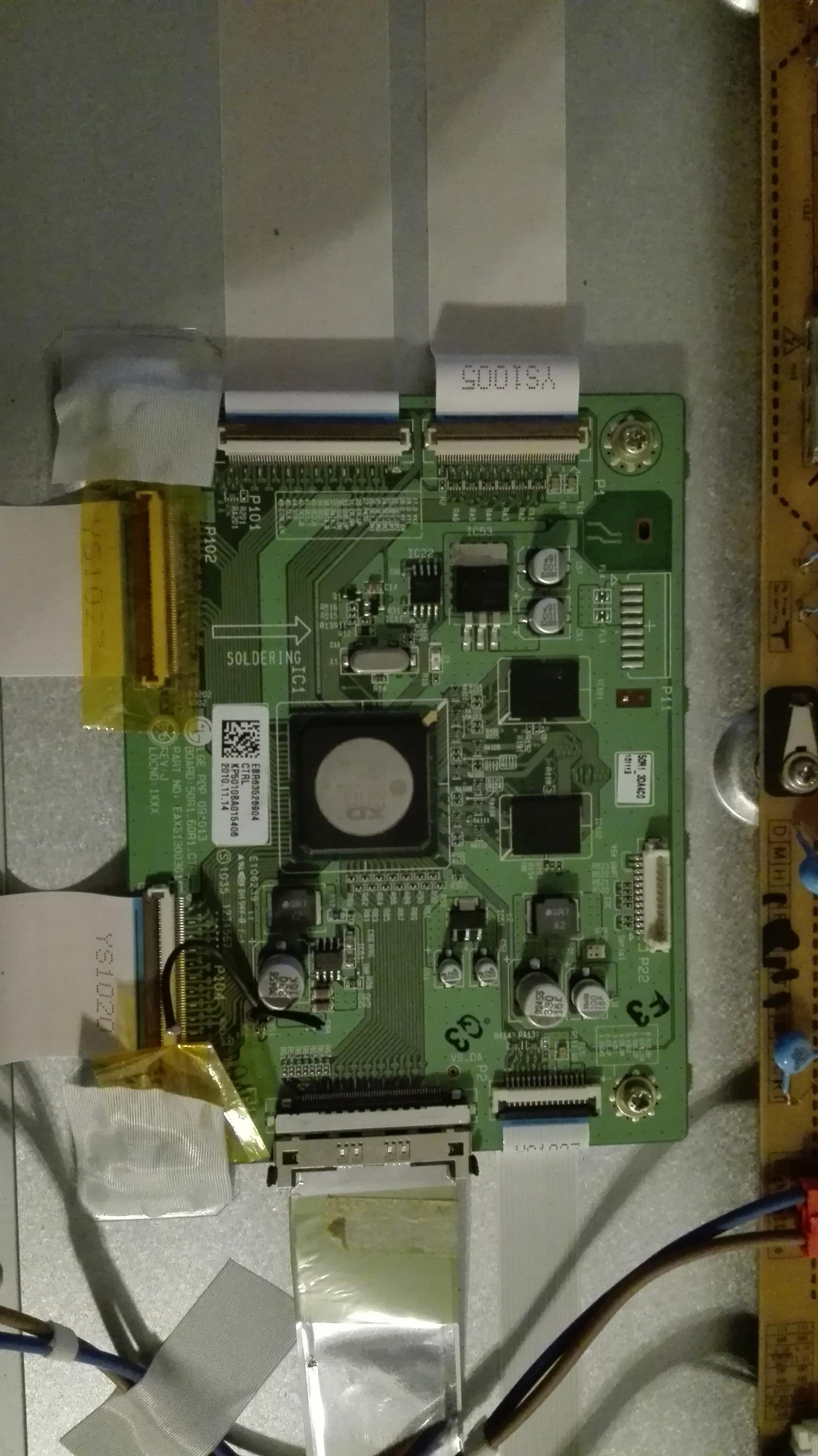

              hi nick,
              photo of logic board attached
              1.is the logic board is also the t-con?
              2.could you please mark on the photo where is the bga chip?
              thanks.
              • Nick's Tvs
                • Jan 2014
                • 621
                #67
                Re: urgent help 50pk550-so desperate here
                T-con board is a term used for the LCD and LED TV's. Plasma sets do not have a T-con board but what we call a logic board instead. They do have the same purpose to relay the information from the main board to the panel. They are basically the same just used in different types of TV's.
                The BGA chip which is the ball grid array chip is going to be the largest square chip on the board with a silver circle in the middle.
                That is the one you want to heat up and or cool down to make it temporarily work.
                Good luck and let us know how it goes!

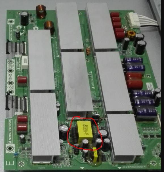

                  Hi All,

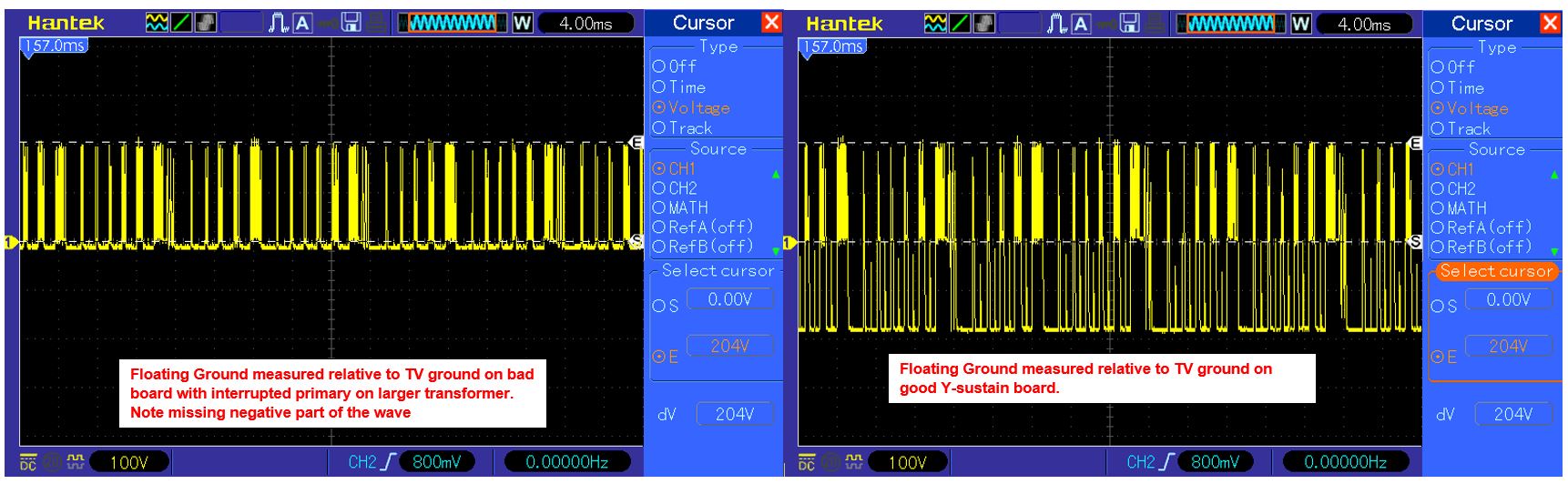

                  Exactly same problem, I found the defect on Y-sustain board. The large transformer EBJ60730703 had half of the primary winding interrupted.
                  Measured on oscilloscope, the floating ground (measured relative to TV ground) was missing the negative part of the wave.
                  I couldn't repair the board but I'm really happy I found the problem. TV works with another Y-Sustain board.
