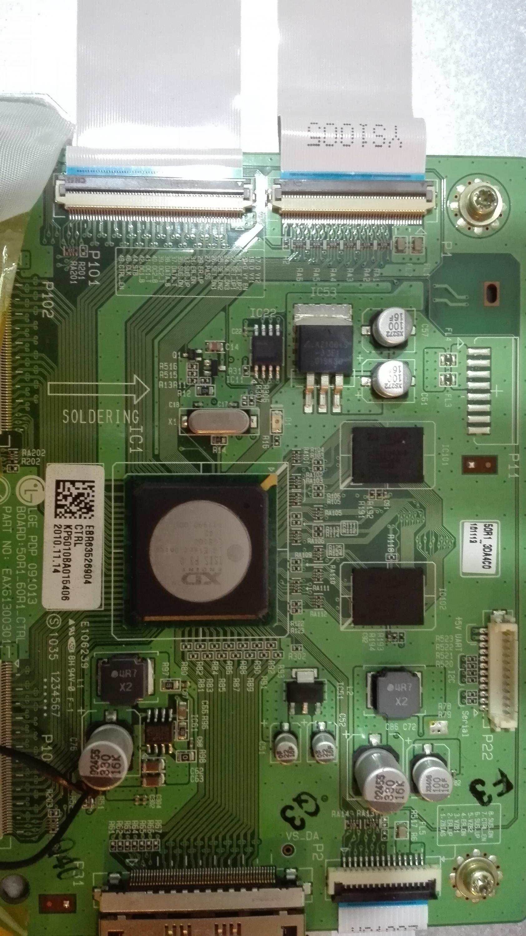

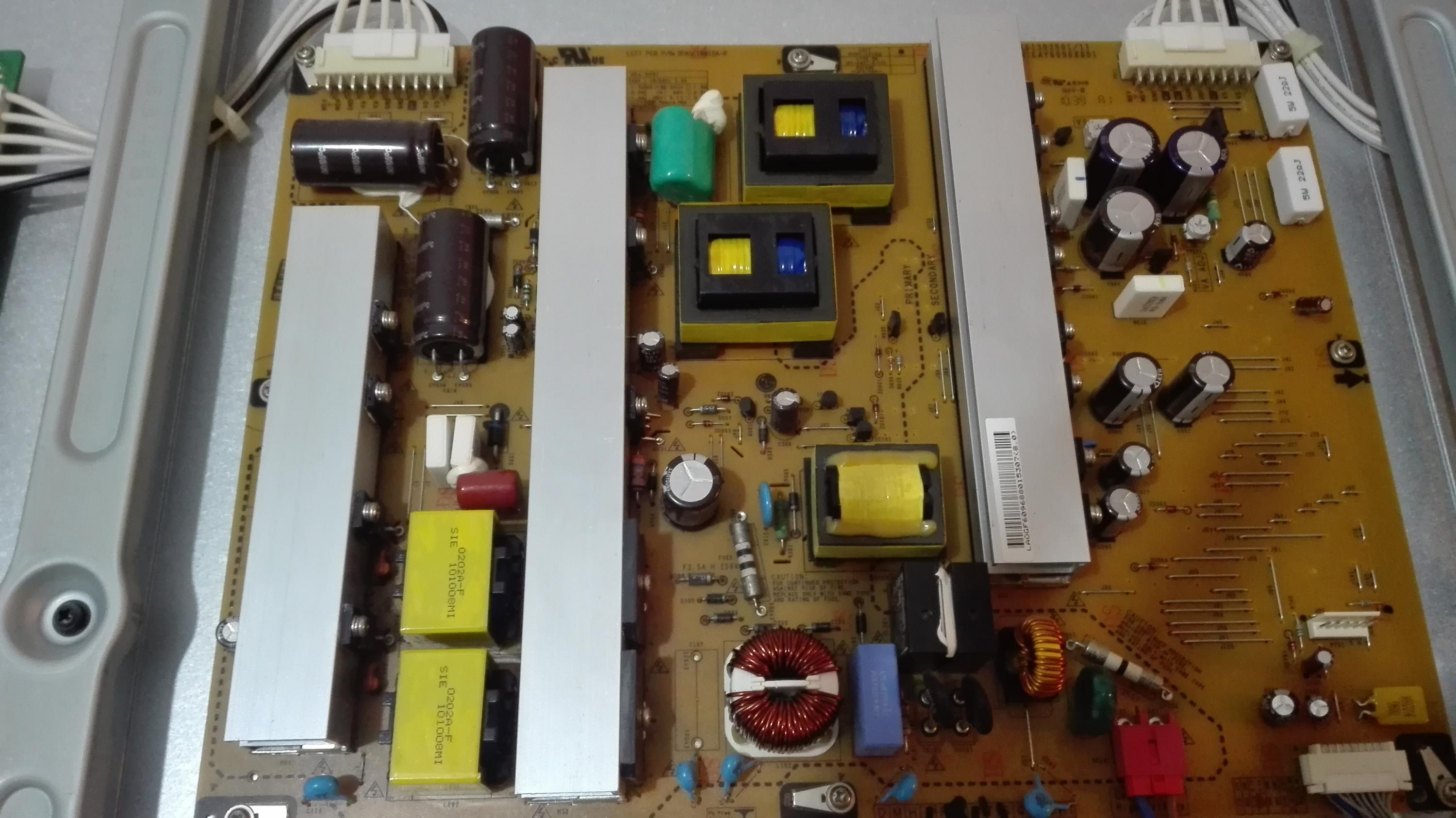

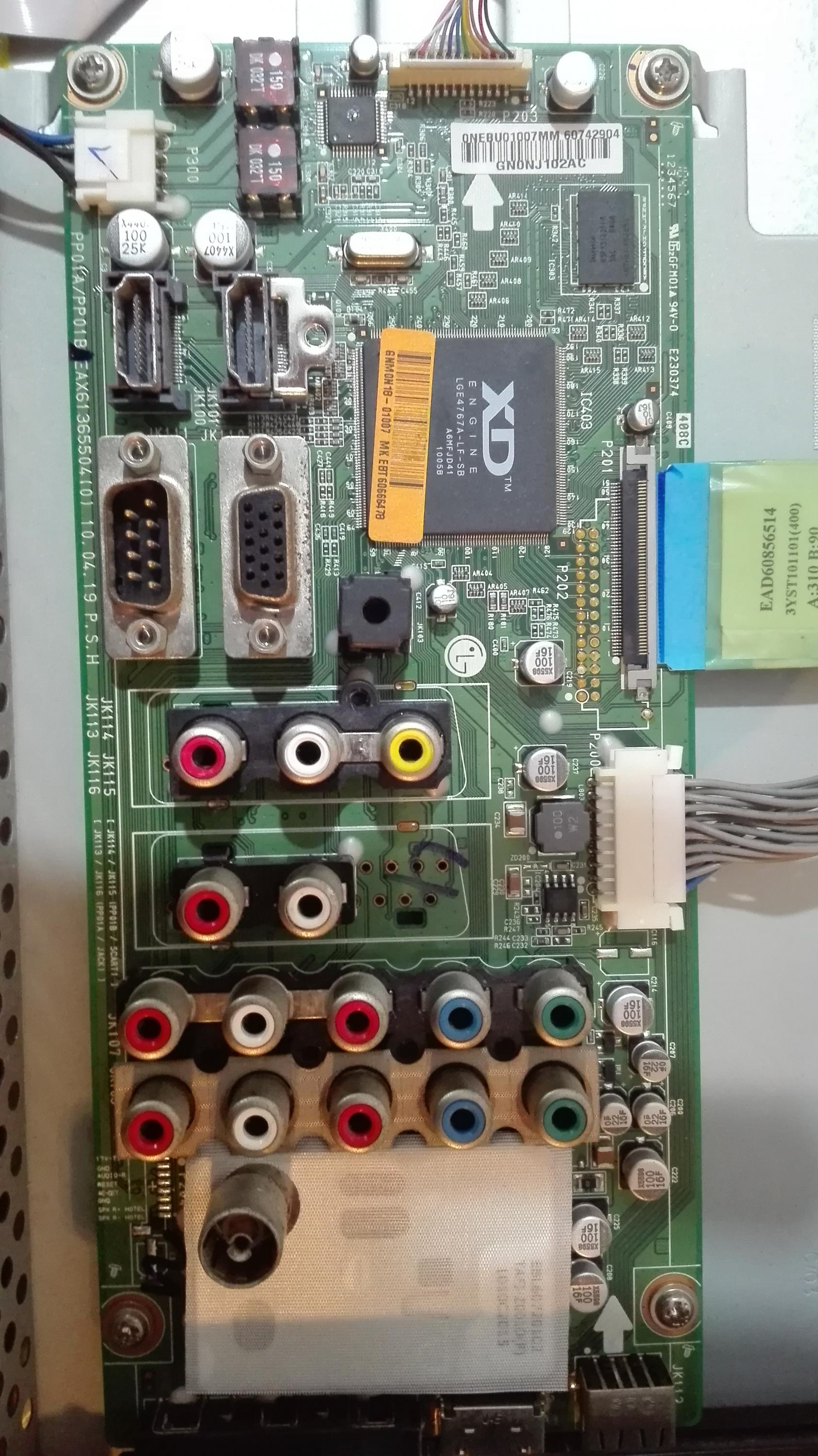

    i own this plasma tv set LG 50pk550 and the problem description is as follows:
    as i plug the power cord, red stby lights up perminant.
    when trying to fire up(via remote or touch buttons) two fast relay clicks followed by stby light turns off.
    after about 8 seconds, another click followed by red stby on again.
    through out all mentioned process the screen stayed solid black(verified in complete darkness)
    destructive googling lead to:
    1.bought the damn "repair kit" which included voltage regulator and couple of high white corner resistors-replaced everything with no change.
    2.executed different voltage examination-seems to be ok.

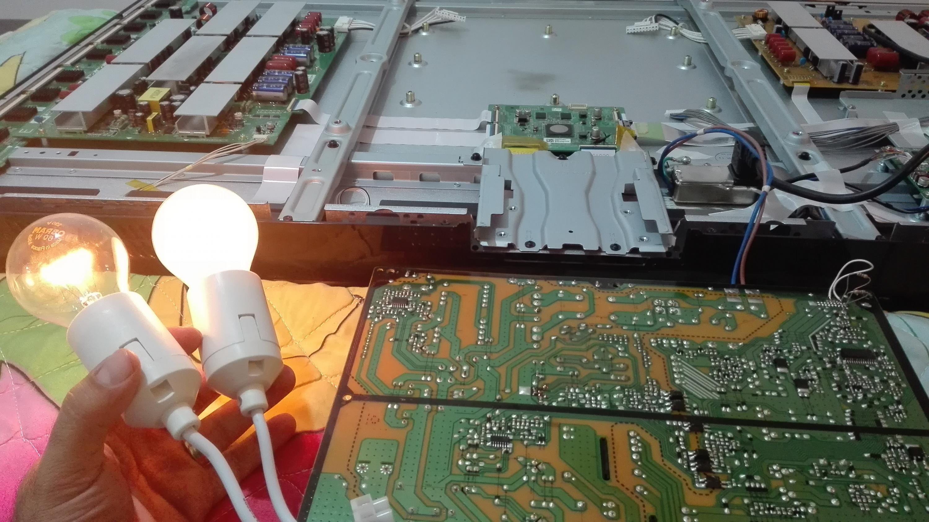

    3.executed two light bulbs load test-lights worked and stayd on(psu ok right?)
    4.executed sync board( the one with flashing tiny green led) test by jumping two holes as said in the training manual(for 50pk750)-nothing appears on the screen at all and it is still solid black, not even a clue for backlight.
    5.i must mention that when power on button pressed (stby light off), the y and Z boards makes a silent "buzz" noise, as if it works ok( i guess ).
    6.checked ALL visible fuses within ALL boards-continuity OK.
    7.i must also mention that all caps and boards seems to be BRAND NEW as can be seen whitin attached photos.
    PLEASE any more ideas,directions,examinations?

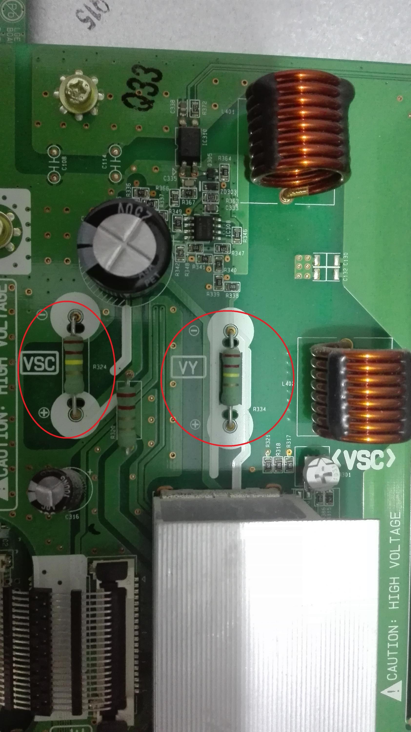

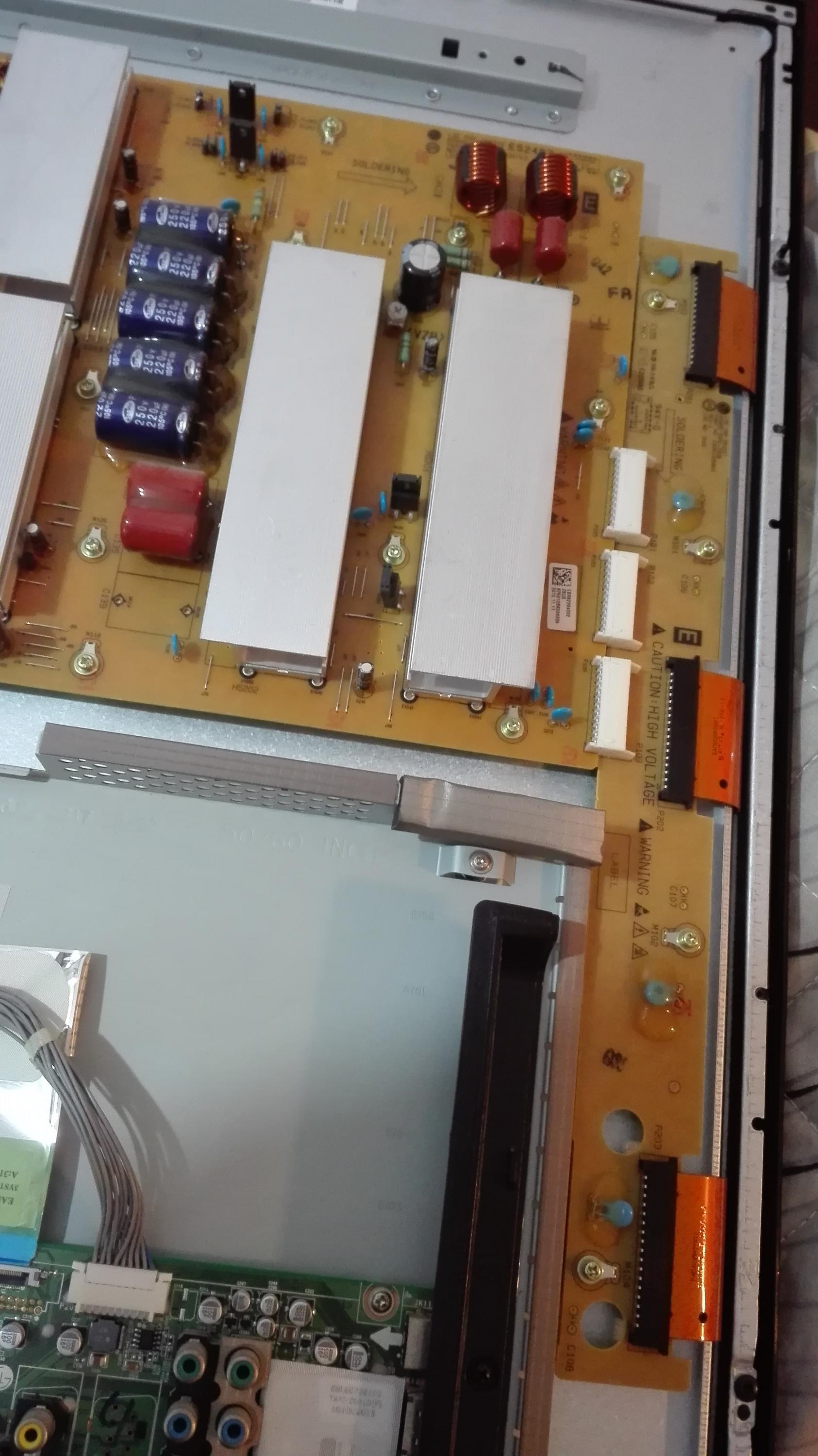

    In the top corner of the y-sustain you'll find 2 resistors marked vsc and -vy.
    Measure across these resistors and see what voltage you get.
    -Vy should be around -180v
    Vsc should be around 150v
    • ramirachamim
      • Nov 2016
      • 40
      • israel
      Re: urgent help 50pk550-so desperate here
      thanks so much for your affort!
      will do in 2 minutes.
      • ramirachamim
        • Nov 2016
        • 40
        • israel
        if you meant the resistors in attached photo:
        vsc=15.3 Vdc
        vy=14.3 Vdc
        could not locate -vy doe.

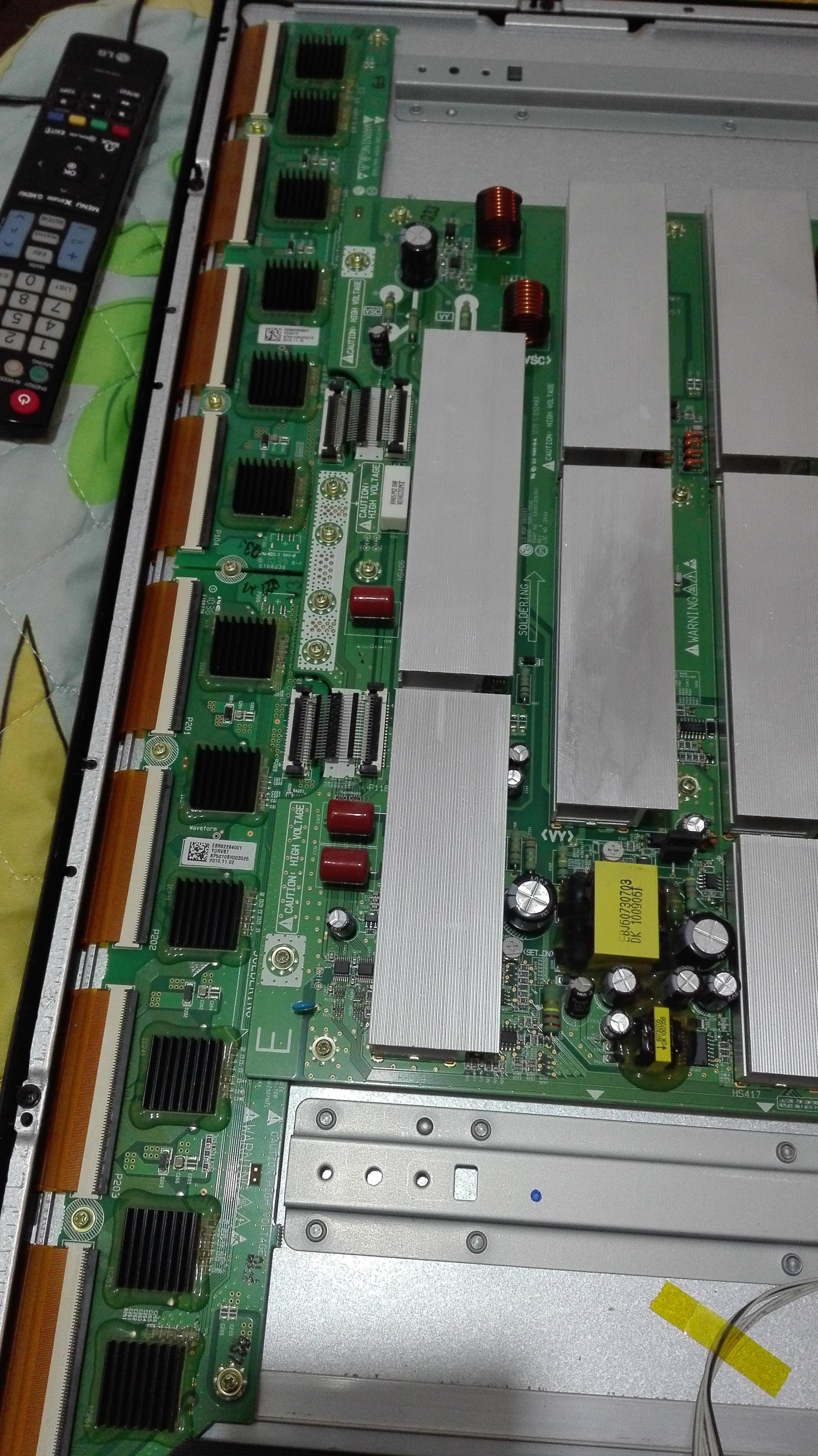

          attached photo.

            OK now unplug the buffers and check them again.
            • ramirachamim
              • Nov 2016
              • 40
              • israel
              1 min plz
              • ramirachamim
                • Nov 2016
                • 40
                • israel
                ok
                vsc= about -0.8 vdc
                vy= about -1.0 vdc

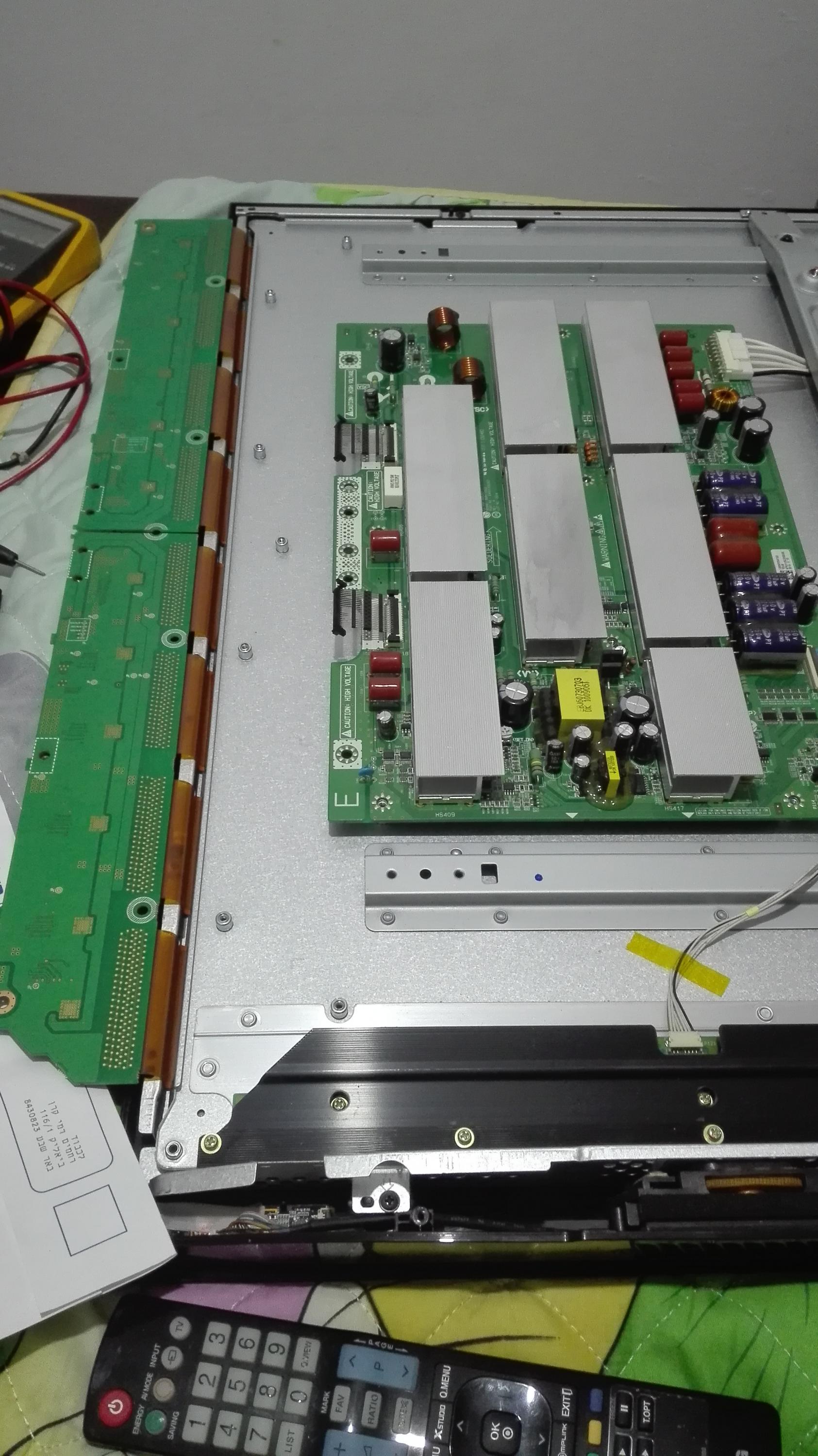

                  Doubt that can be right.
                  Have you completly removed the buffers?
                  • ramirachamim
                    • Nov 2016
                    • 40
                    • israel

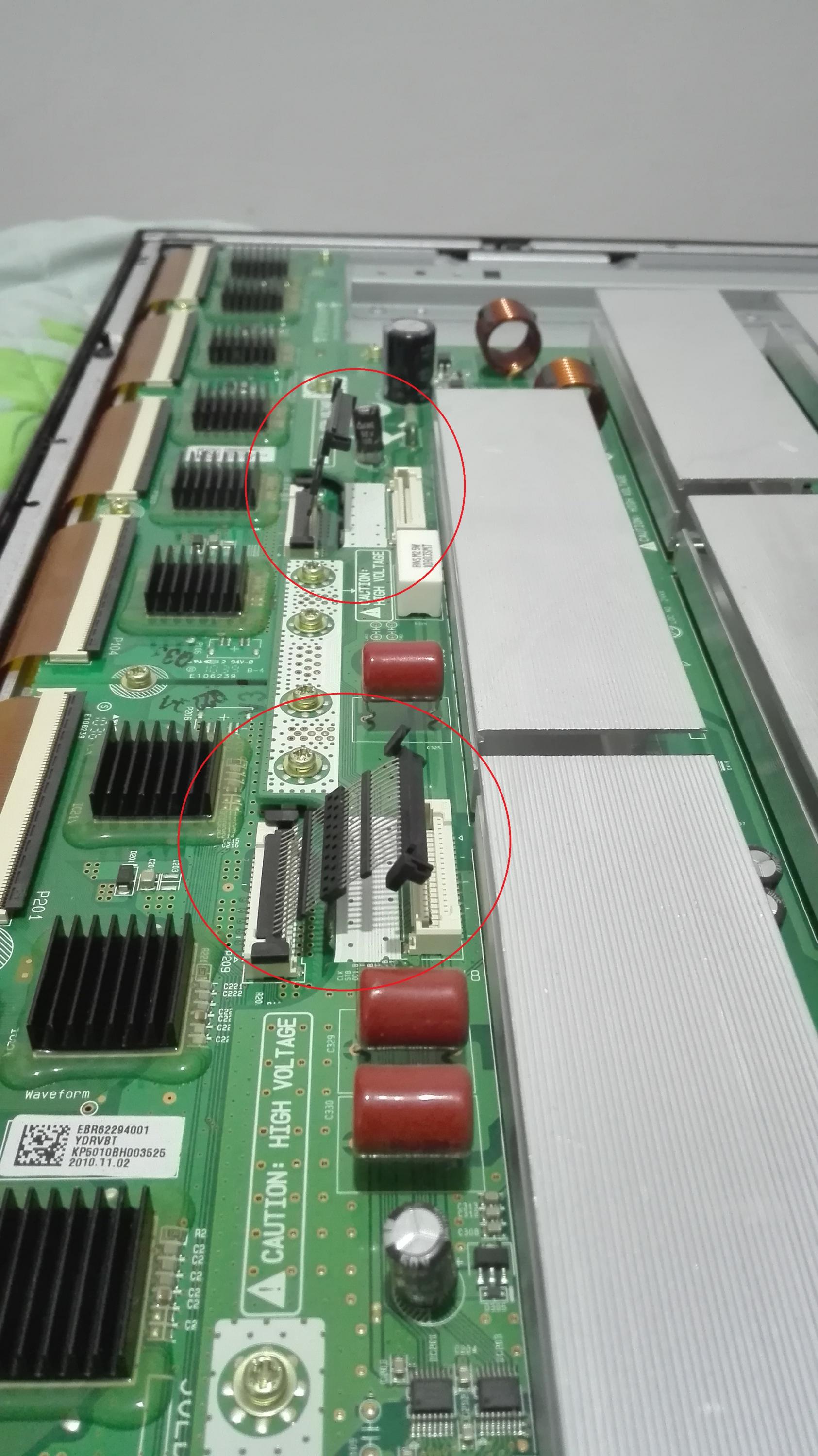

                    like so?
                    • Hamie
                      • Apr 2014
                      • 1383
                      No they are still screwed in.
                      For the avoidance of doubt just completely take them out.
                      You can still leave the orange panel ribbons attached but flop the buffers out of the tv so they nolonger make any connection to the y-sus.
                      The buffers cannot touch the ysus in anyway.
                      • ramirachamim
                        • Nov 2016
                        • 40
                        • israel
                        ok,sry for the delay,demanded some heavy unscrewing...
                        vsc=-0.6
                        vy=-1.0
                        examined as shown

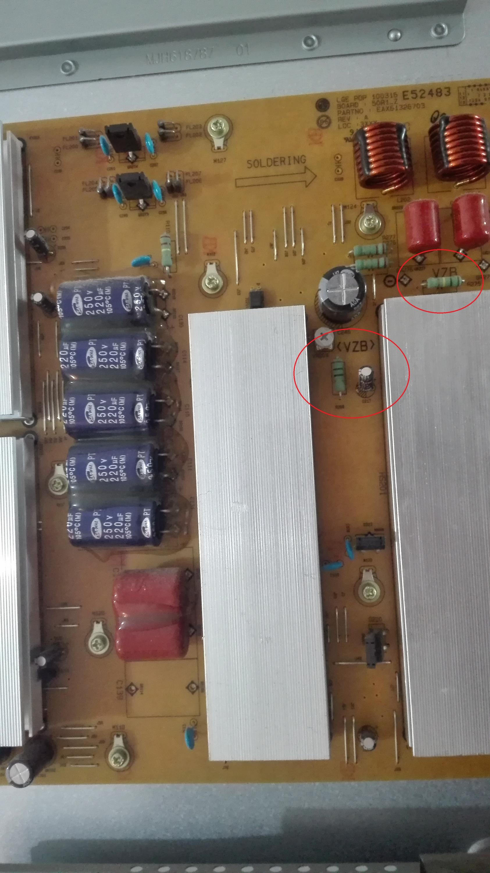

                          OK leave the buffers out for now and check the voltage for VZB on the z-sustain.
                          • Hamie
                            • Apr 2014
                            • 1383
                            To clarify, when checking VZB have the y-sustain unplugged form the SMPS
                              Short IGBT's on y-sus most likely.
                              Check Vs line for short on y. and x
                                hi hamie,
                                please do include all of "well knowns" or "clarifications" up front.
                                if you wouldnt clarify i would never unplugged the y sus myself.
                                now for the practical issue:
                                unplugged the y-sus.
                                the z board had 2 capacitors says "VZB"
                                both reads zero 0 VDC.
                                photo attached.

                                  • Hamie
                                    • Apr 2014
                                    • 1383
                                    One marked <VZB> isn't a test point it's to label the VZB potentiometer.
                                    The VZB test points are marked - and +
                                    You need to.put your meter in DC volts put your negative probe on the - point and positive on the +
                                    Is the tv on when your doing these tests? Because it's strange that both the y and z to go faulty at the same time in this model as they are not linked directly.
                                        hi hamie,
                                        got it
                                        checked the "-" and "+" with my dmm on dc volts.
                                        it reads about 3 vdc on stby and 204 vdc when "on"
                                        regarding your question the set was on when executed the tests for the y brd.
