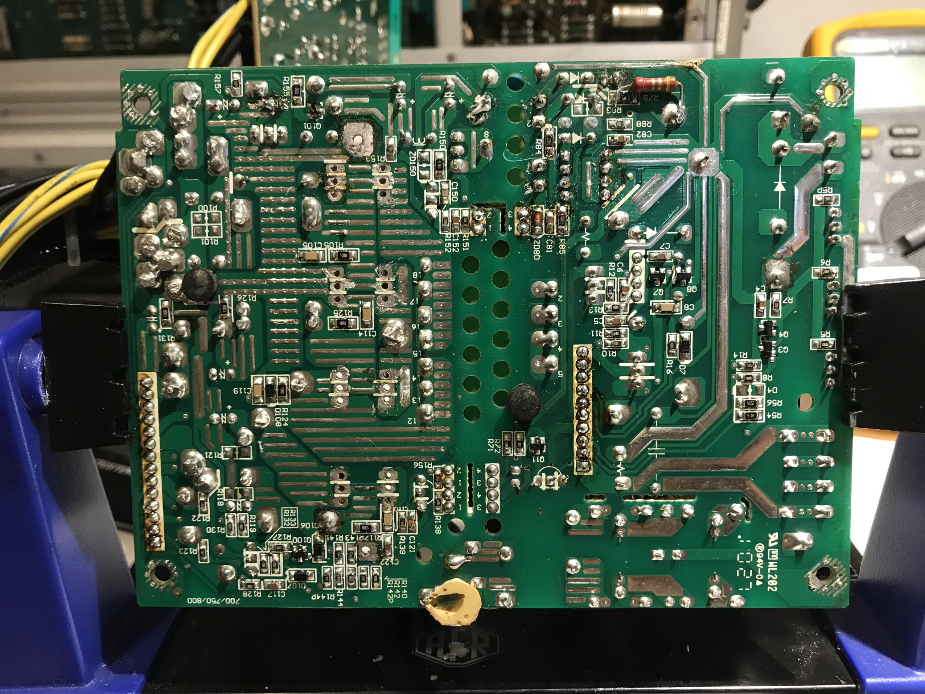

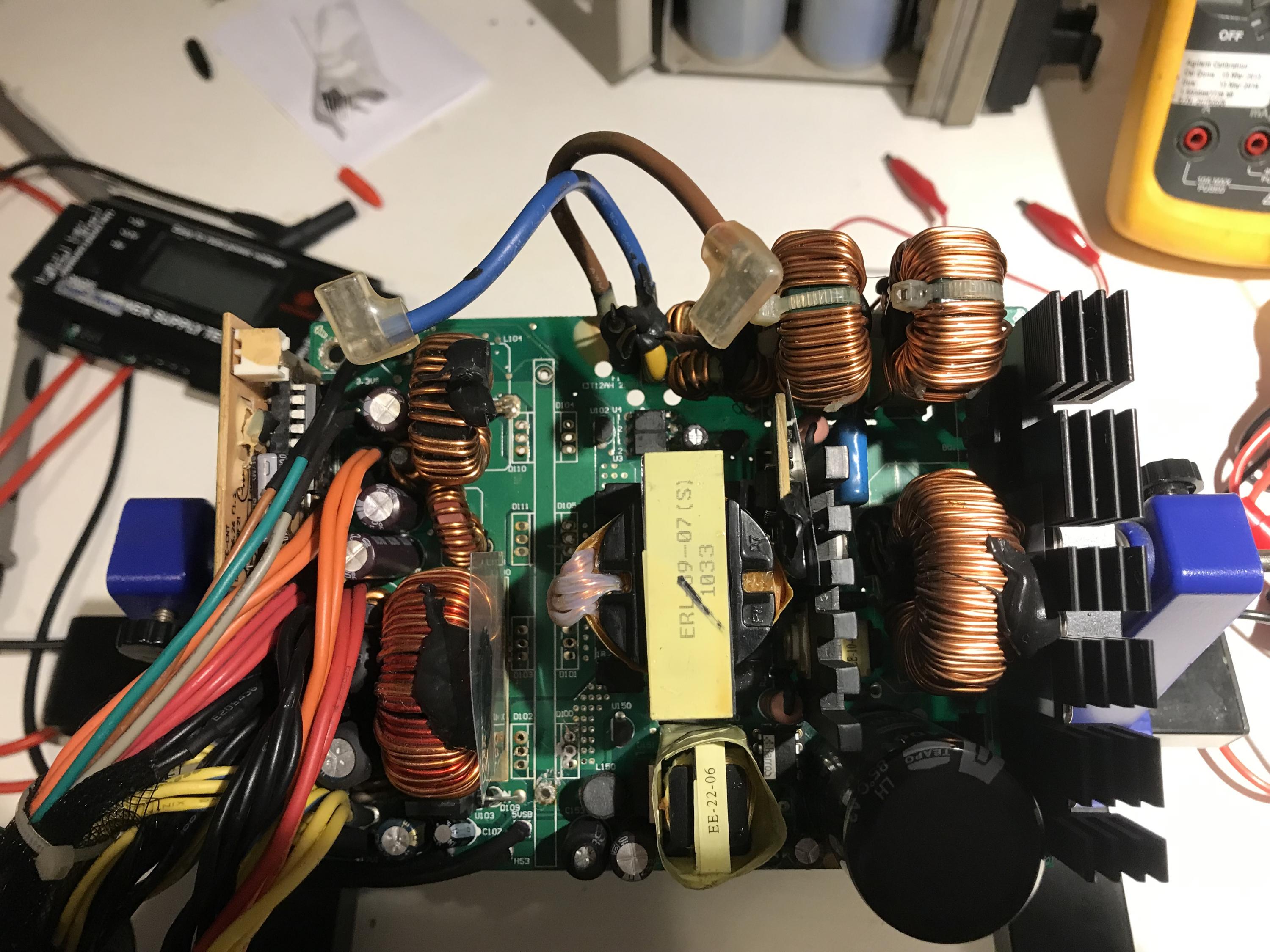

                      Maybe post some clear, straight shot, high resolution pictures front and back of the PSU.

                        Re: Thermaltake TR2 750W -fixed 5v stby now +5v reads low and no 12v
                        These are photos from top and bottom.
                        The heatsink with the rectifier diodes of the secondary has been removed so I could check them out of the circuit.

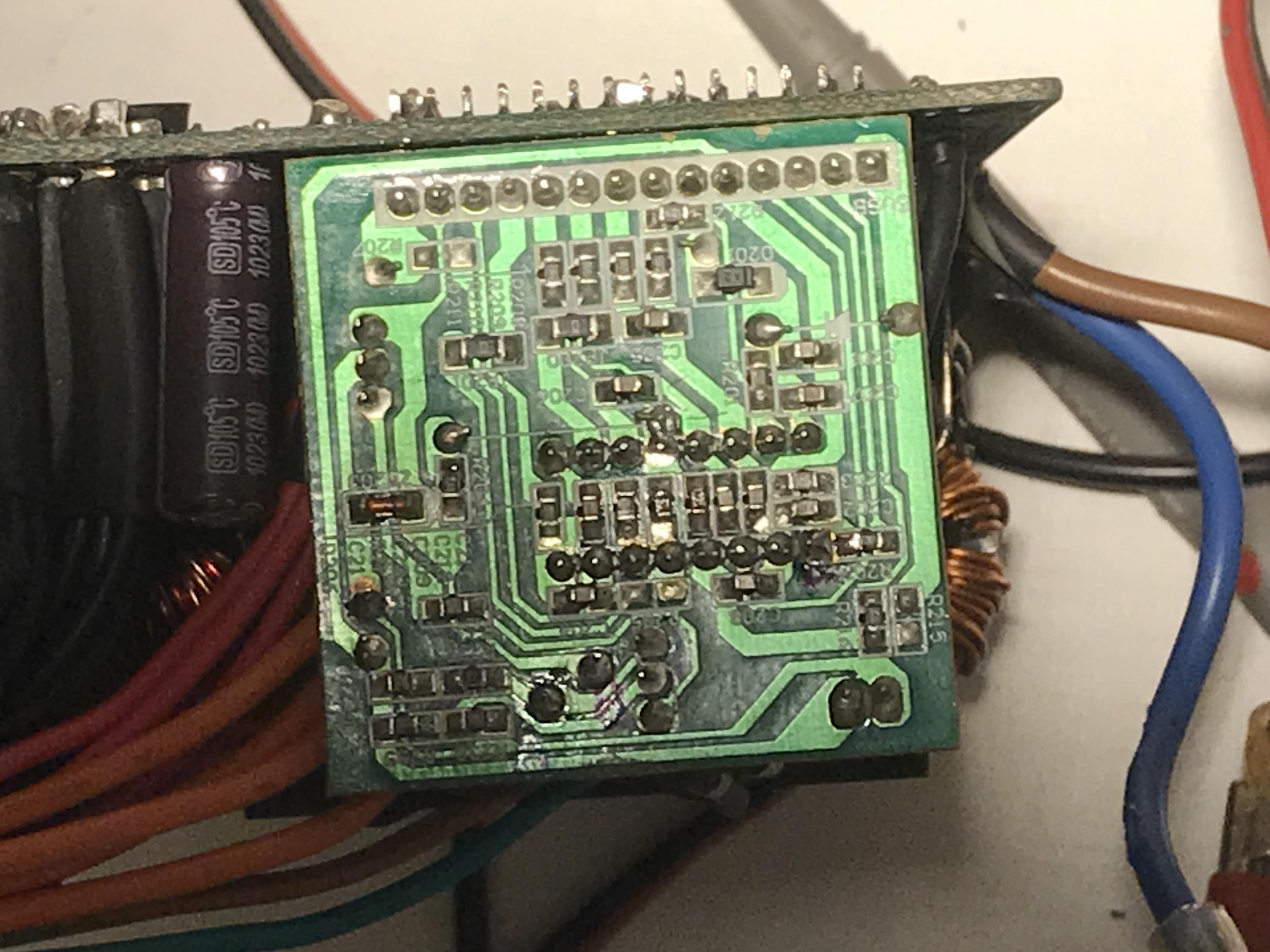

                                I inslalled the PS223 backwards again and the PS starts and all the voltages are ok.
                                This means that the CM6800 and all "power semiconductors" are ok.
                                So I guess that the problem is located on the small pcb where the PS223 is installed.
                                As I asked in my previous post, I do not understand very well how the PS223 works but it seems that installing it bacwards causes the ok signal to be present.
                                I have already checked every resistor (on board) and the readings seem ok.
                                The there are two to92 devices and one diode on the component side.
                                unfortunately the markings of one of the devices is covered by glue, so I can't tell if it is a transistor or a 3 pin reference.
                                There is also a smd zener diode which I don't know what is its zener voltage but it tested good as a diode.
                                Is there a schematics available for this board?
                                Any idea of what might be triggering on the FAULT status if it seems that there is no short at the outputs?
                                Note: I have measured the resistance of every rail to ground and I am sure there is no short in the voltage rails.
                                    if you ground out the FPO pin from the PS223 supervisor, all it does is disable all the supervisory functions. Basically if something is wrong in the secondary like over voltage or over current or a blown diode / missing voltage rail, the PSU cannot turn off.
                                    So either there is something wrong with the little supervisor board, a cold solder joint, a solder bridge, a bad PS223 supervisor IC (even so it is new) or something else on the monitoring circuitry on the secondary. I always order at least 2 IC's just in case.
                                    When you had that supervisor installed backwards, all the voltage rails were up and running?
