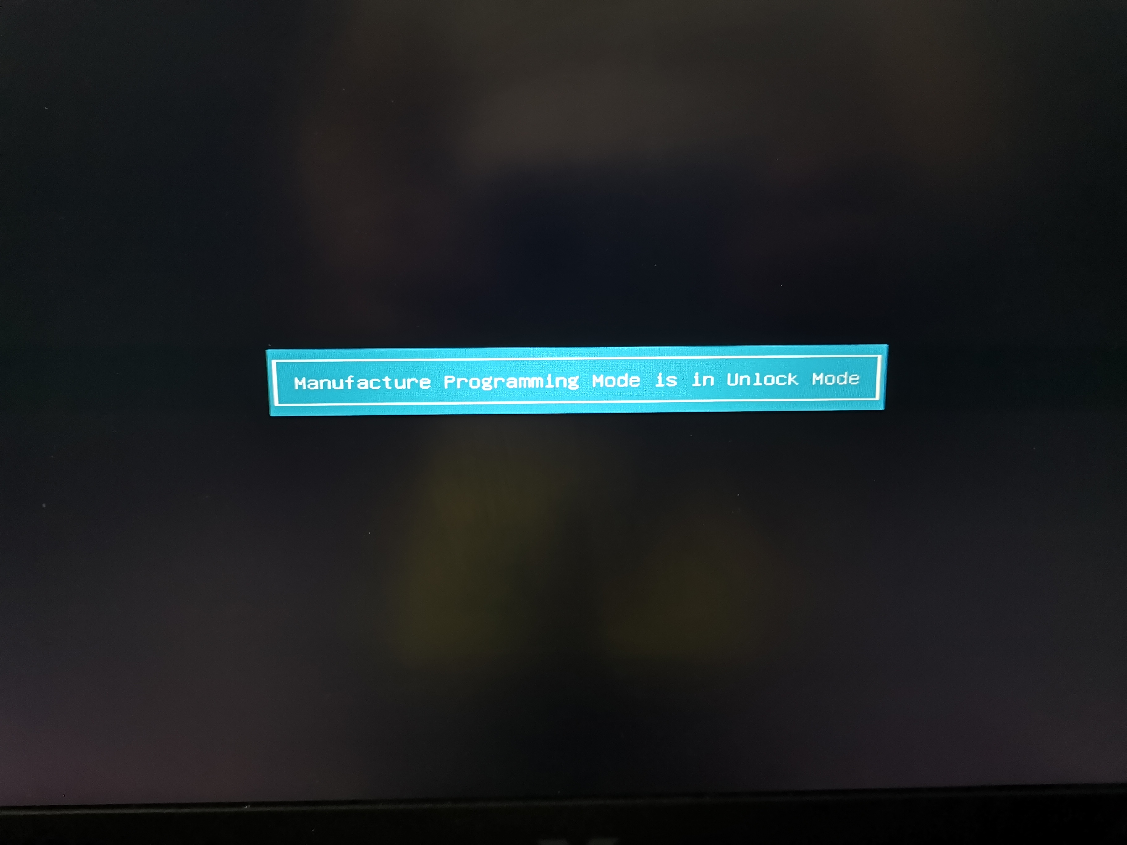

    Hello Everyone,
    I need your help plz
    After bios update, laptop not booting up, power light working but only i get black screen
    Model Name : HP Victus 15-fb0039ne
    S/N : 5CD30740K7
    ProdID : 7Y7G6EA#ABV
    My Bios bin in attachments
    Thanks in advance

        Try
        Victus Gaming Laptop 15-fb0039ne (7Y7G6EA)
        BID 08A3C
        BiOS ver. F.22
        S/N 5CD30740K7
        DMI+Win key 26000-2803F

          thank you very much
          it's working but there is popup message coming once i turn on the laptop, you will find it in attachments
          can you help me with plz

            You can use HP BCU
            https://ftp.ext.hp.com/pub/caps-soft...it/HP_BCU.html
            S/N, product ID, model name, feature byte, etc should already be present
            Change "Manufacturing Programming Mode" to *Lock (delete the asterisk in front of *Unlock and add it to Lock)
            Code:
            *Lock
            Unlock
            MPM should also lock after few reboots and the message will go away

              Thank you so much
              everything is okay now
