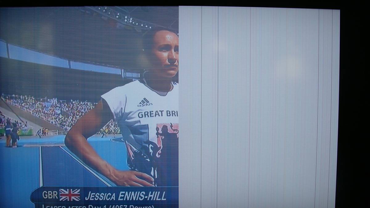

    I have a chance to pick up this TV.

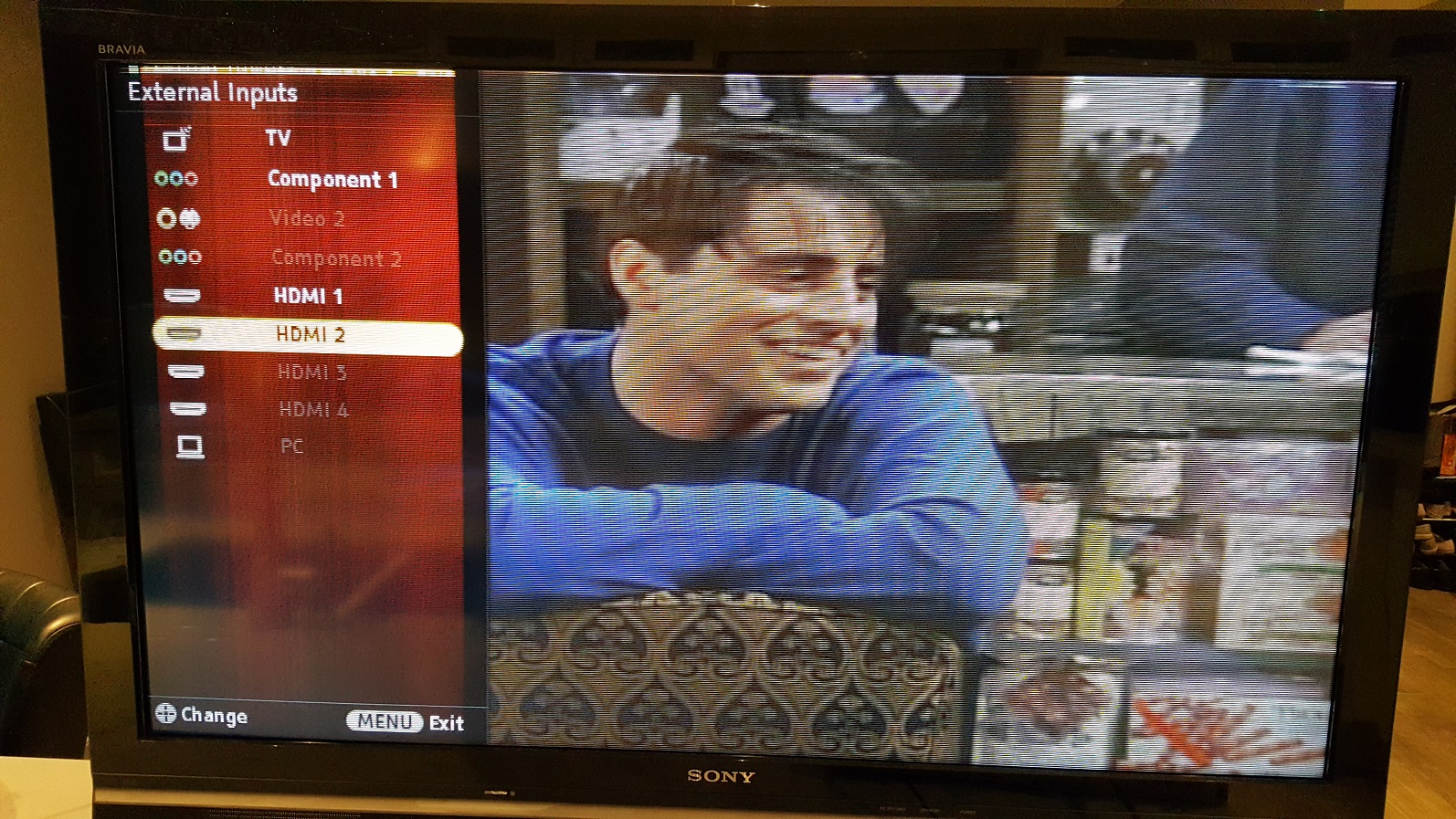

    Re: KDL-46v5100 T-CON or Panel?
    Take a look at the screen when you press menu button. See how it looks. Your 1st pic looks like there are horizontal lines all over, maybe just the pic. But I am thinking bad panel.
    If menu looks good, I would say bad main, maybe tcon. Stay tuned.....better answers to come.

      Re: Sony KDL-46v5100 T-CON or Panel?
      Yes All these are famous for Bad panel _
      i just trashed one KDL46S4100
      with good pic but one strip right in the middle;
      FX - Chassis
      KDL46S4100- LTY460HB10-001
      LTY[Z]460HB11-A02
      EX2R - Chassis
      KDL46S504- LTY[Z]460HB11-A02
      EX2R - Chassis
      KDL46S5100-- LTY[Z]460HB11-A02
      MA2F - Chassis
      KDL46SL140- LTZ460HB10-001
      LTY[Z]460HB11-A02
      KDL46V4100- LTZ460HB10-001

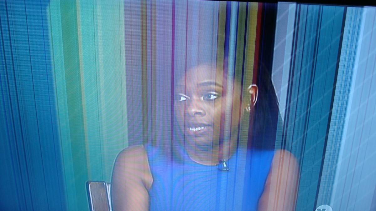

          Sorry to be resurrecting an old thread... but I have the same model TV with the same problem as the second picture with the lady and all of the different colored vertical lines.
          Was it determined that the panel was bad? or Was a t-con board possibly tried with a positive resolution to this?

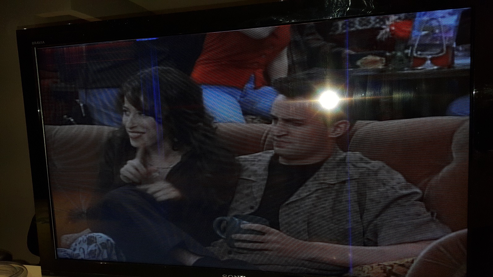

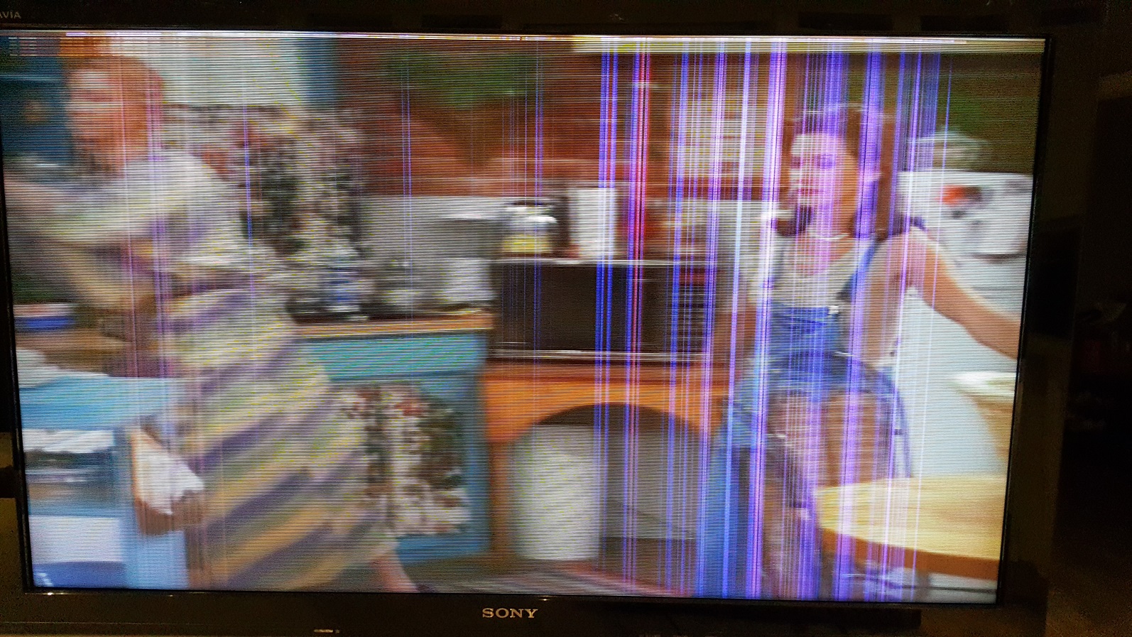

            The lines as well seem to come and go. With the picture looking fine at times. Here are a few sample pics
            • Thrashbast
              • Oct 2018
              I have a Sony KDL-32" same problem and it was the T-Con Board which was goosed..
                    Tcon service there for 30 bucks. https://www.ebay.com/itm/SONY-KDL-46...-/153149898784
