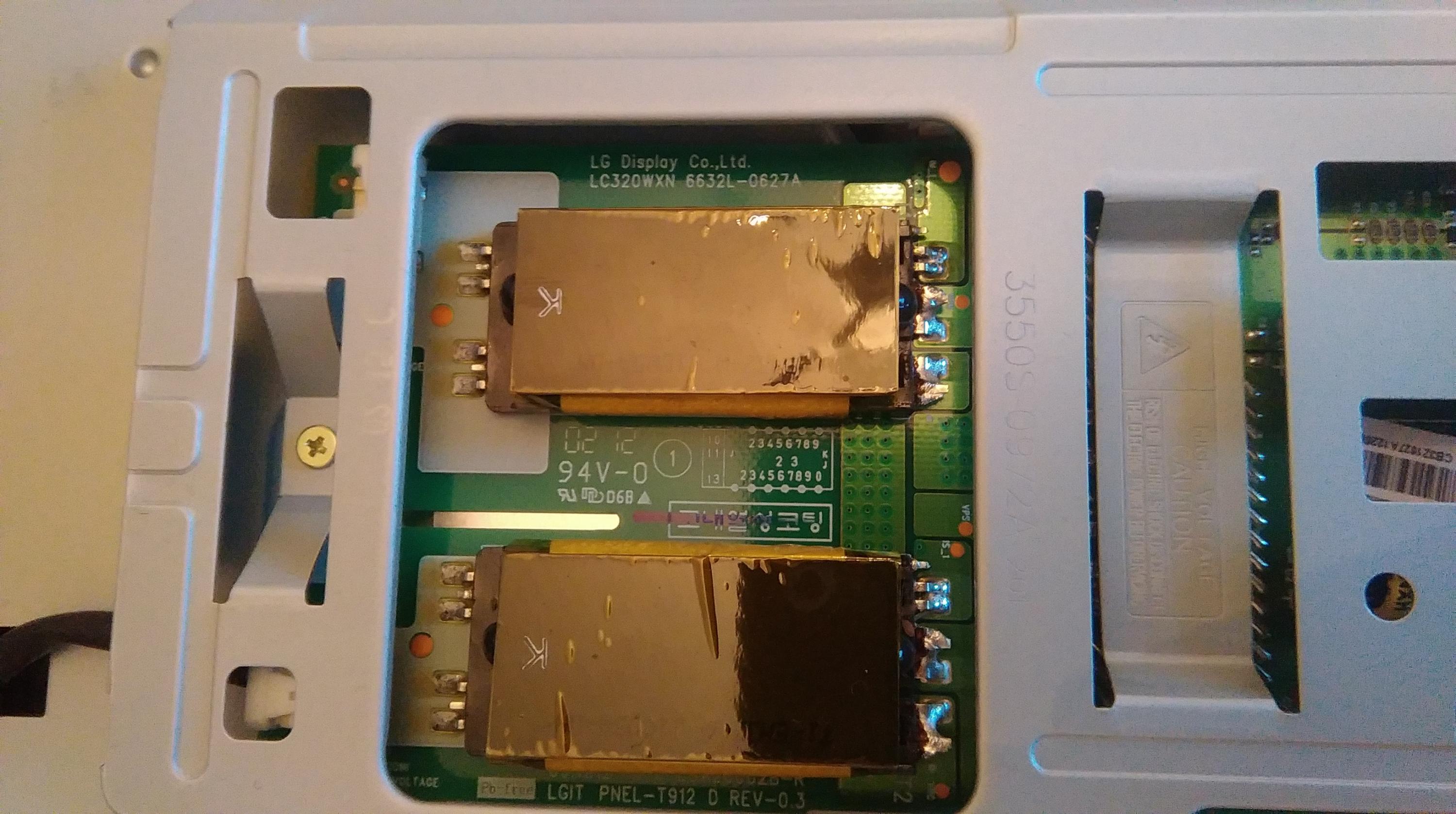

        What Lcd panel is it ? You have to match the board to the panel but if the Psu connector is the same it will work but you need to match the panel first.
          #44
          Re: sharp LC-32SH130K / Vestel 17PW82-2 v.1 090511
          Is the panel the LG board: LC320WXN?
          All the numbers on the main board match the board Vince listed and it was listed for the same model Sharp.
          How do I match the panel to it?

            Maybe ask the ebay seller did they note the panel number from the set that the mainboard comes from failing that its a chance you take really when buying it but as its listed for the same set i would personaly take the risk and buy it.

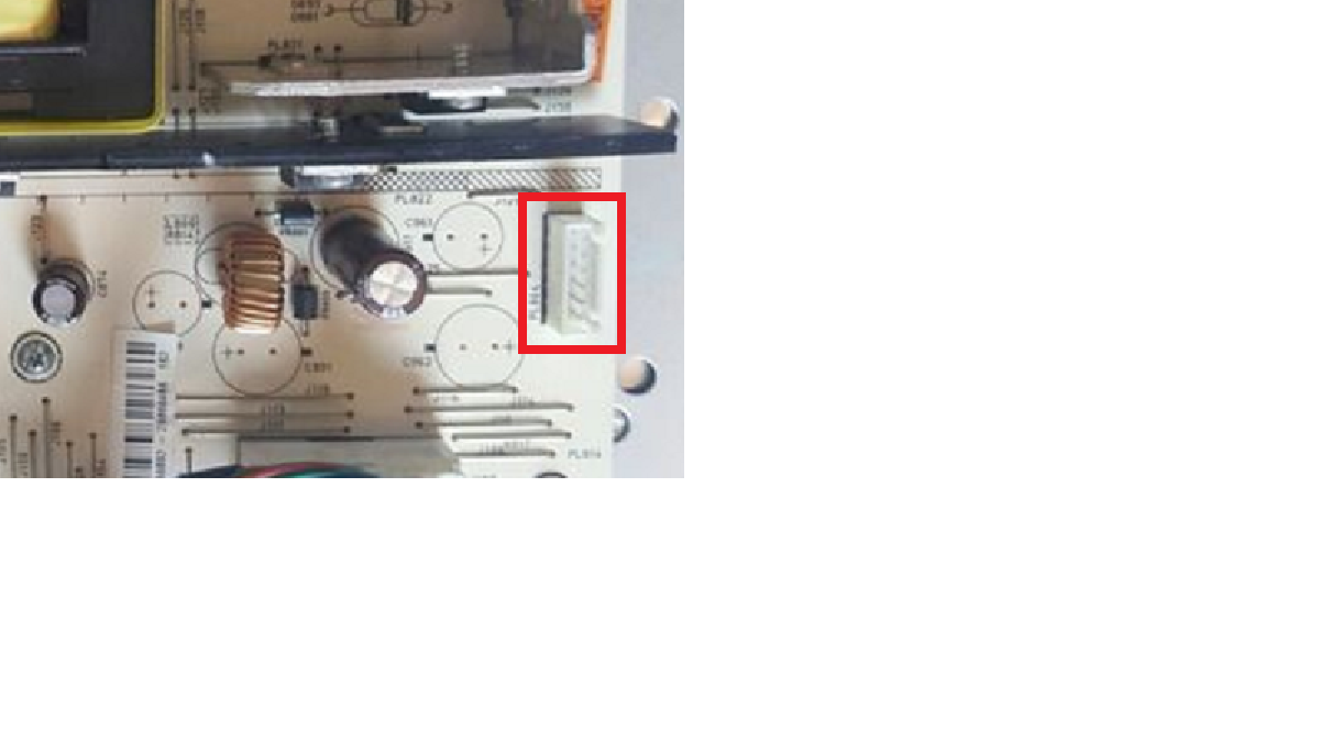

              Hi all, long time no visit I am dragging up this old thread as I have a question regarding the board. Vince mentions socket PL804 as not being in use on this set BUT I was wondering if anyone knows what it was used for ( Maybe on on other sets) I have looked
              at a range of sets with this Vestel Board and havent spotted anything.
              It is 6 pins 12v 12v Gd Gd 5v 5v and is on the schematic.
              Have added a pic (not my Board) to show position of PL804
