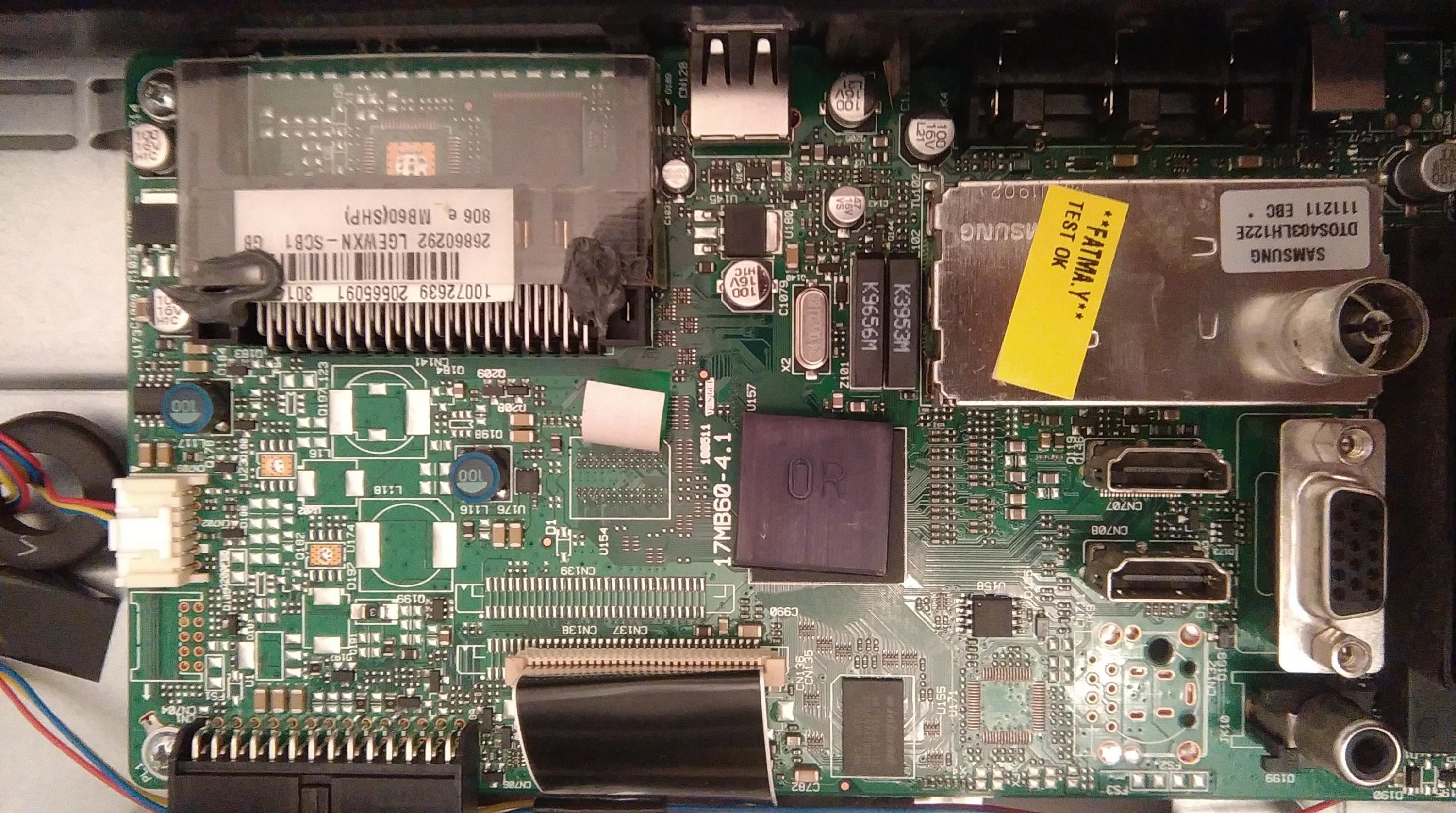

    Whats the mainboard part number used in this set
      Re: sharp LC-32SH130K / Vestel 17PW82-2 v.1 090511
      When you say main board, do you mean the one which has all the connection points e.g. SCART on it?
      I'm pretty sure it's a Samsung board but I failed to take a picture of it. I guess I'll be popping back around for that info.
        yes sorry the one with the scart/hdmi etc on it if you can get a good picture of it and also the part number.

                                Hmm mainboard issue then, Ive had 17MB62, 17MB60 and 17MB82 fail like this shorted Cpu due to poor heatsinking.

                                      say no more being a vestel once we know what mainboard is used in this set we can try to offer some more help and advice.
                                        #39
                                        Thanks for all the help.
                                        Main board is a 17MB60-4.1

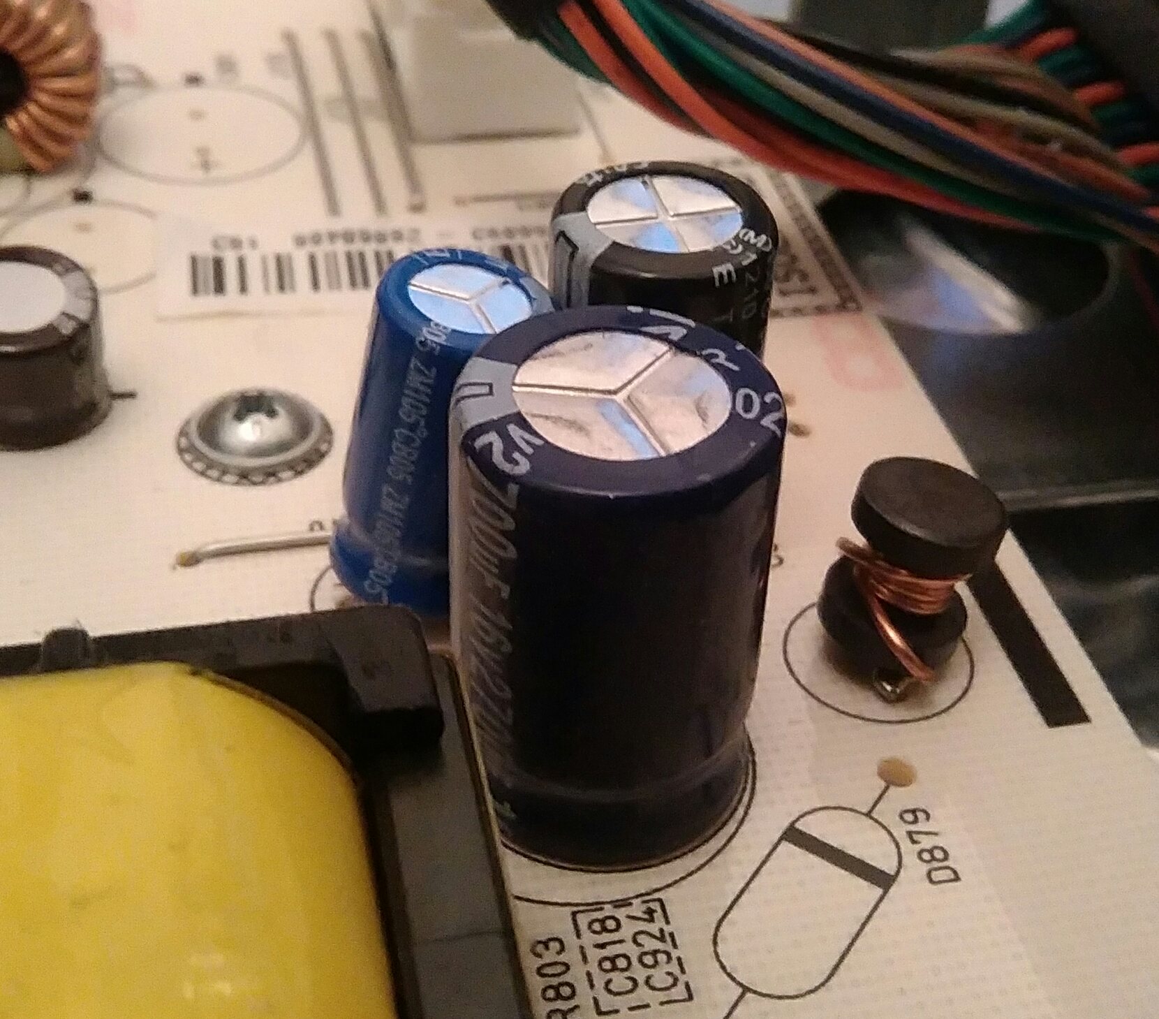

                                        The 3 diodes in circuit read 473 on my multimeter.
                                        On looking at the caps again I'm wondering if one is slightly dome'd.
                                        Just trying to upload pics from mobile.
