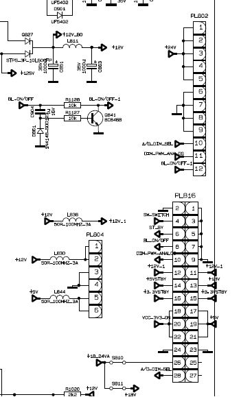

        Re: sharp LC-32SH130K / Vestel 17PW82-2 v.1 090511
        heres a schematic for the psu test the voltages as advised above first then we can advise more

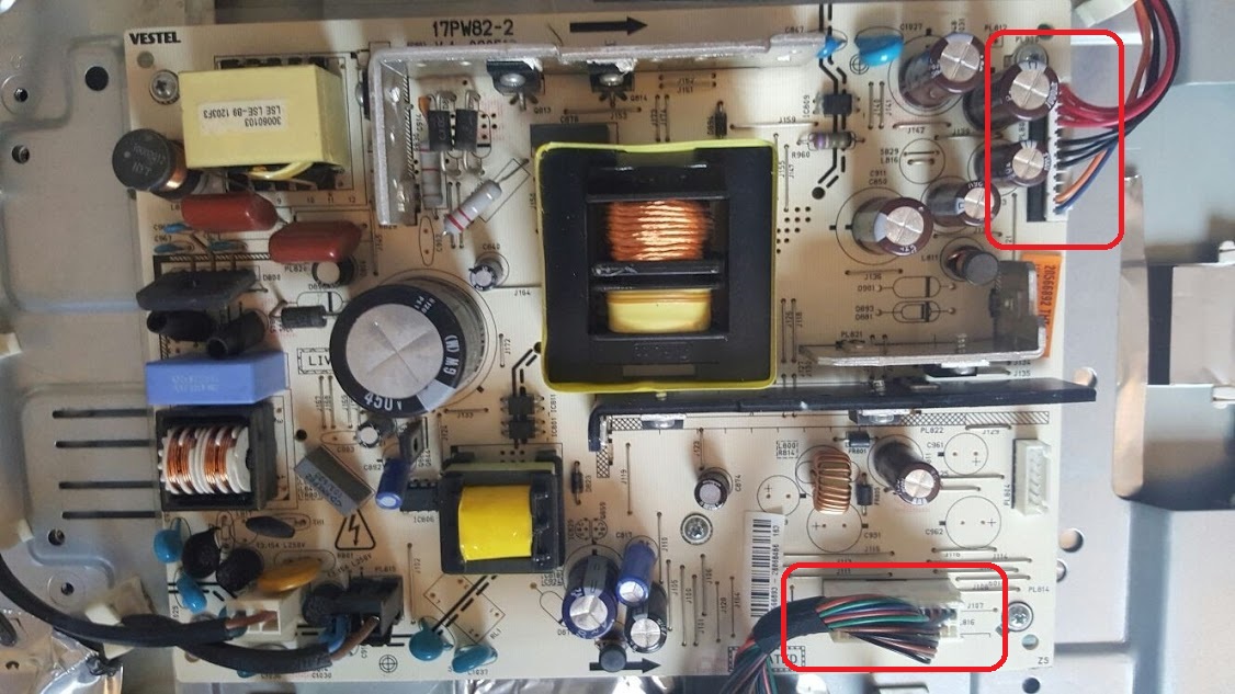

          Hi - have updated the original post so images are included now.
          I'm new to all this but do have a multimeter. Are the Pins clearly labelled on the board?
          I also can't change it in and out of standby. When turned on there's no indication the TV is on other than beeps from the controls on the edge of the screen (TV/AV, channel, volume etc).
          The standby light does not illuminate.
            Once you are able to tell us what voltages you have on the connector pins people will be in a better position to advise you.
            Sometimes the connector pin names are on the underside of the board or printed on the top side of the pcb in a table form close to the connector if not given alongside the pins.
            Thanks to Vinverogers69 here are the connections for which the voltage readings would be helpful.
                if the pins are not marked use the schematic ive enclosed as it shows you what each pin should be voltage wise it and what does etc
                im not sure what multi meter you have but have put it on dc volts setting use the metal tv chassis as a ground (you do not need to measure the primary side ac volts for now) just test the secondary side voltages if your stuck on testing anything just ask and we can advise
                      looking at your pictures its the two connectors on the right with the wires going too them the one on the bottom row is double pins so a lot of diffrent voltages etc too take.
                      i dont think pl804 is used on your set once we get those voltages we can advise more if its a psu issue or mainboard but these psu s are troublesome this is whats in a repair kit for them.

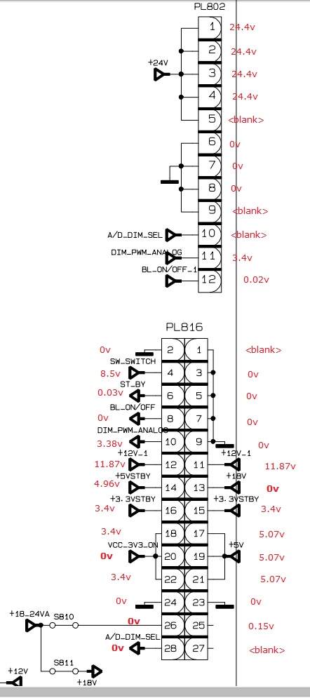

                                        OK, so I'm still alive.
                                        The filter cap read 399v when plugged into the mains. I was surprised here that I needed the mains cable plugged in and the black power cable from the logic (?) board plugged in and switched on, but that's just my lack of understanding I guess.
                                        The voltages below were all read when plugged into the mains and with the rocker power switch on the back of the TV 'on'. The TV will not switch in and out of standby so these are the only readings I could get.
                                        PL802 - do the two readings for pins 11 and 12 look ok?
                                        PL816 - Pin 13, 20 and 26 don't look quiet right according to schematic?
                                        Thanks for all the pointers so far. Your help is appreciated.
