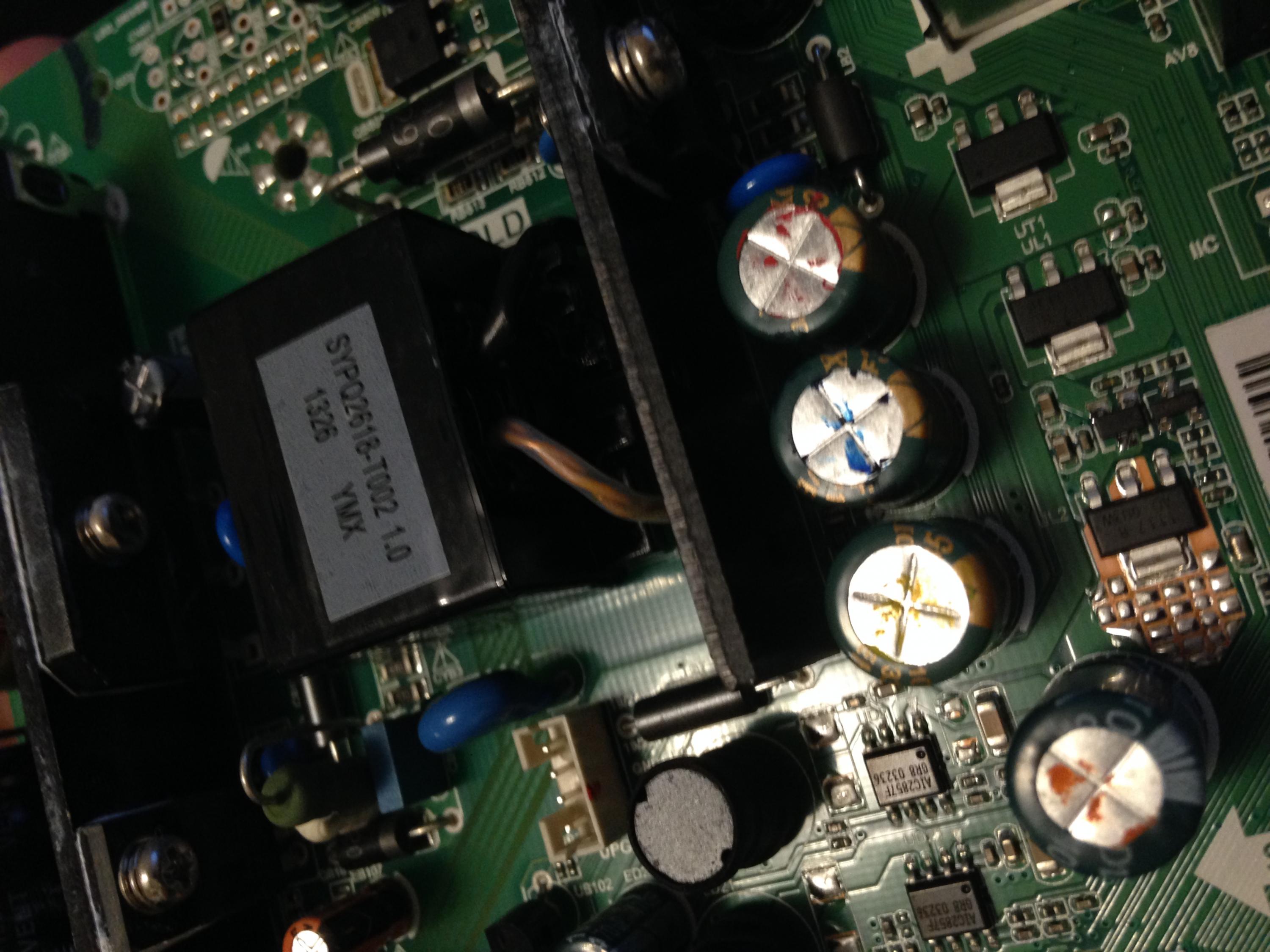

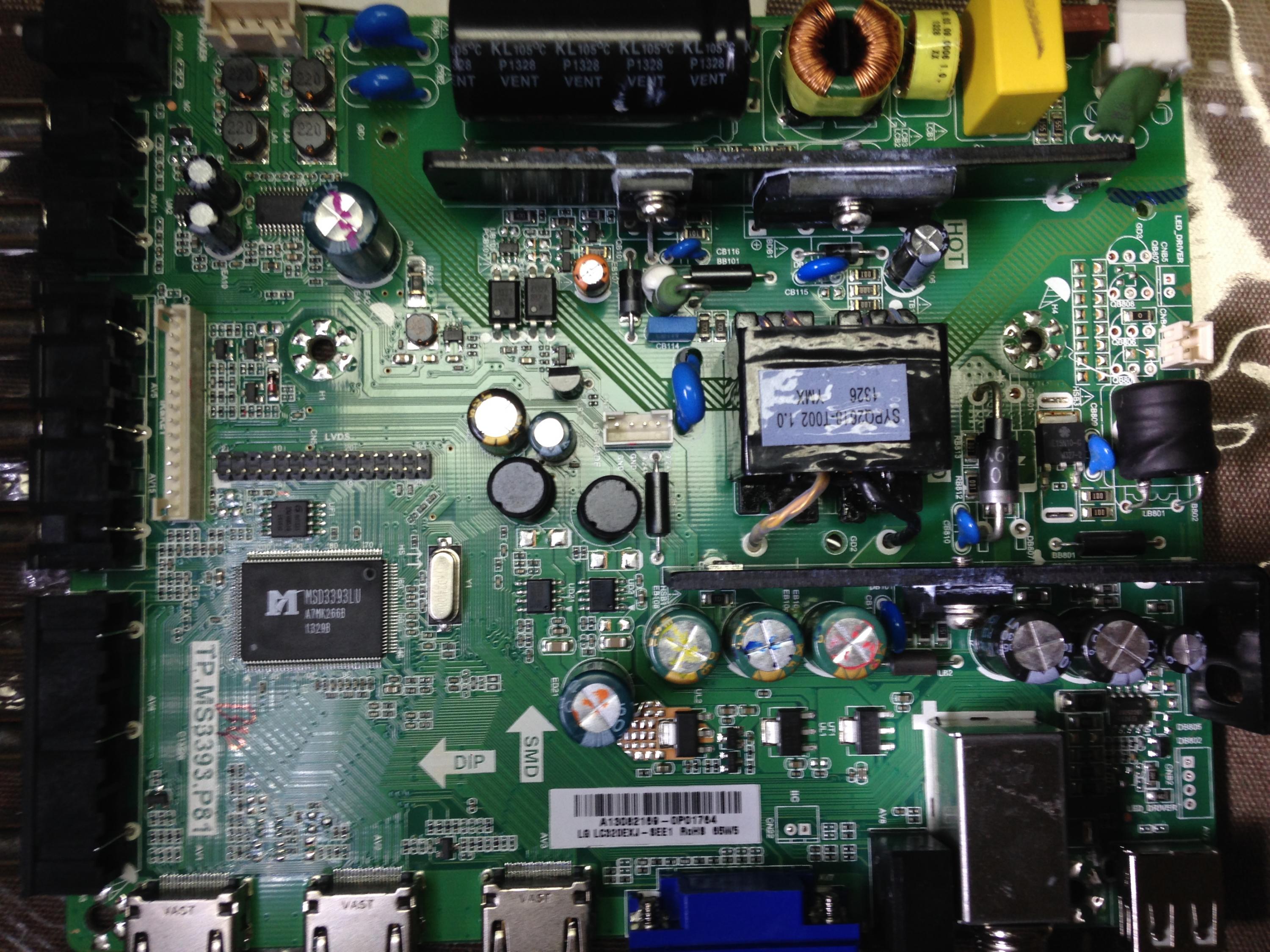

    I'm getting a standby light, But when i press the power button nothing happens.
    It uses an all in one board TP.MS3393.P81

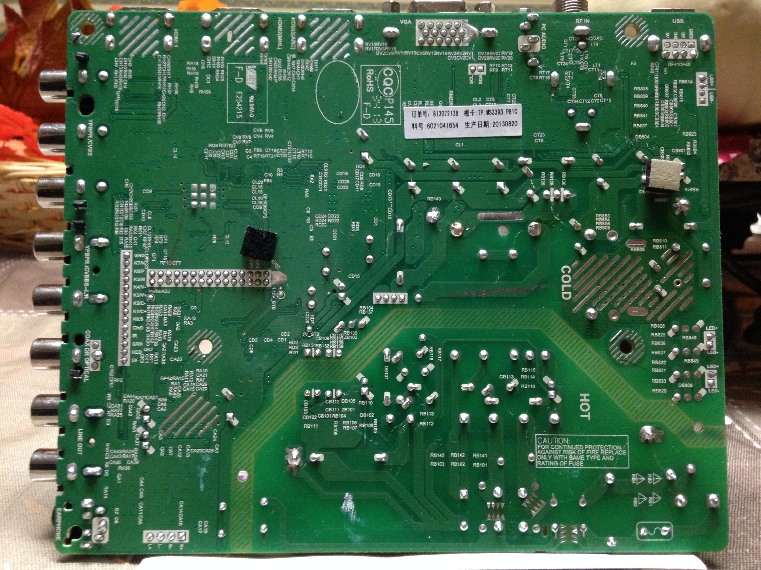

    I'm getting 19V across the caps(the ones in the third image)
    There is 5v going out to the IR board
    Only thing strange i noticed was some type of black powdery substance around the top of one of the caps as pictured(cap with blue mark on it).
    Sorry for bad quality photos, If you want a better photo of a specific area let me know.
    Any help is appreciated.
    Last edited by jihadi_john1; 10-06-2016, 09:24 PM. Reason: Clarifying what caps i'm getting 19v on
  • jihadi_john1
    • Oct 2015
    • 15
    Re: RCA RLDED3258A-B Stuck in Standby
    I replaced the cap with the black stuff on it to no avail.

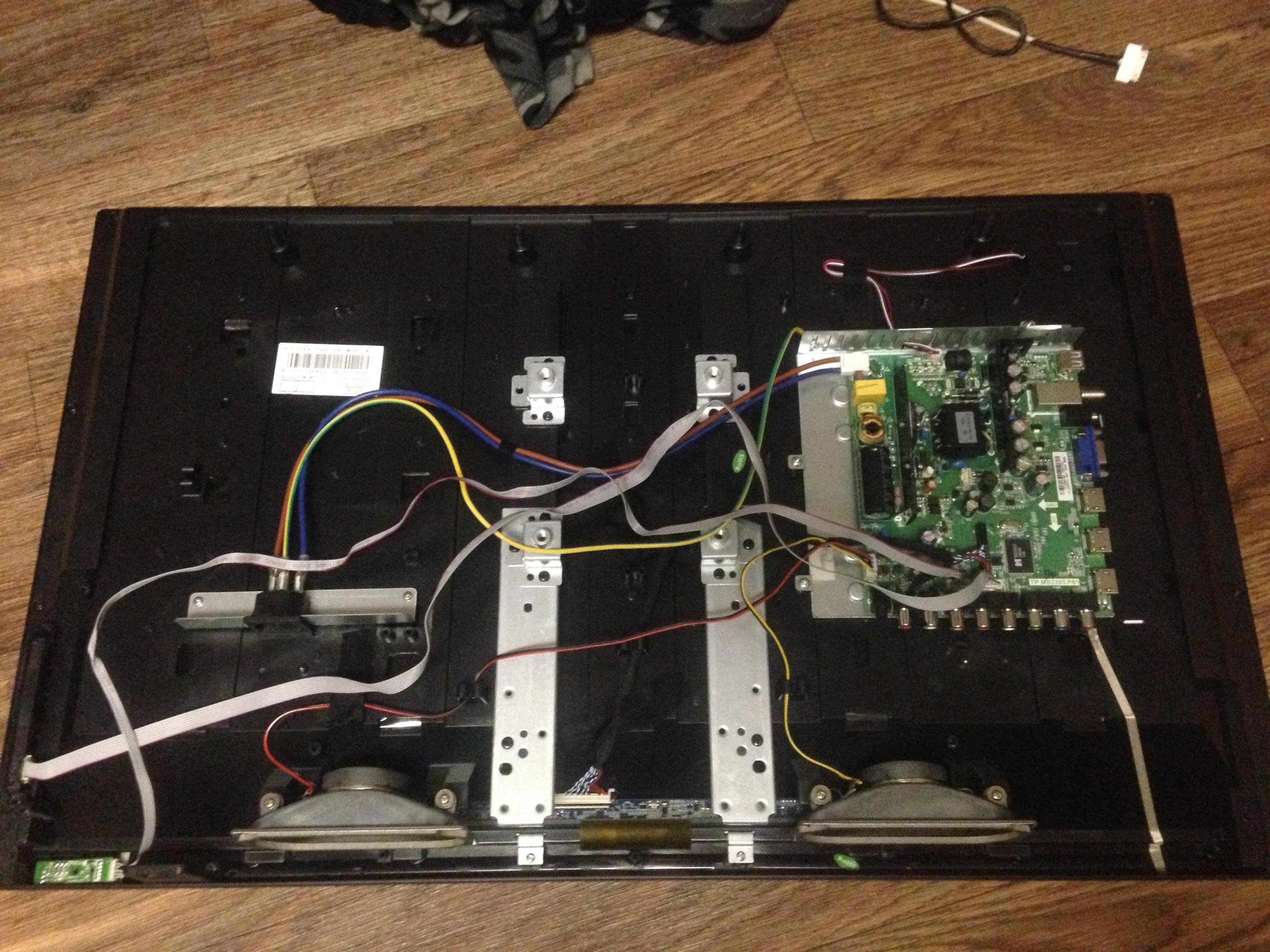

      We need the pictures showing the whole back side of the TV so we can see all the boards and how they are connected together.
        Here's the picture you requested
            What dcv do you get at those 2 pins connector for the LED backlights with ref to GND when TV is plugged in but not turned on, and when the power switch is activated?
            • jihadi_john1
              • Oct 2015
              • 15
              I'm getting 18.92v on the LED out, And it doesn't change when i press the power button.
