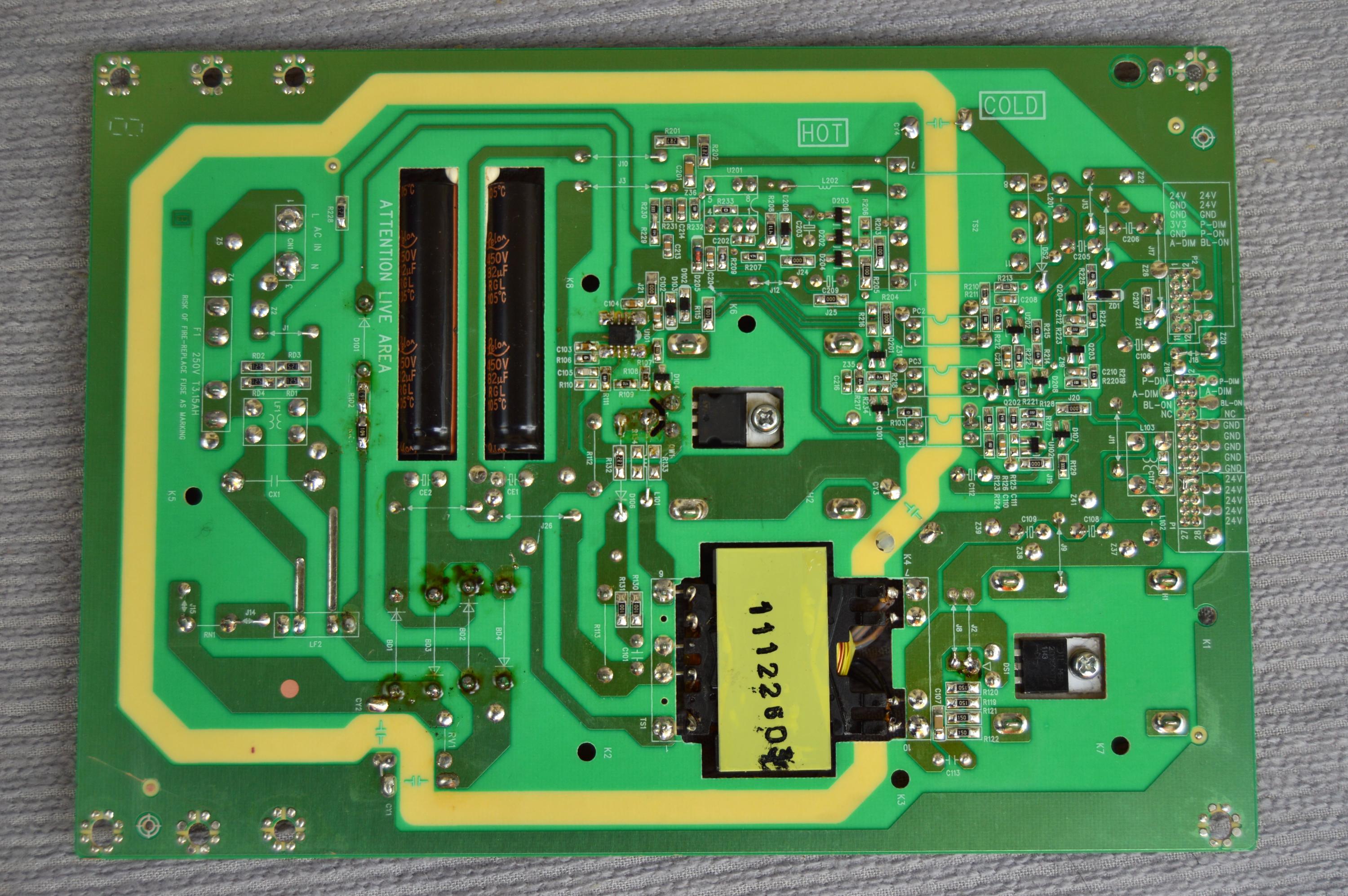

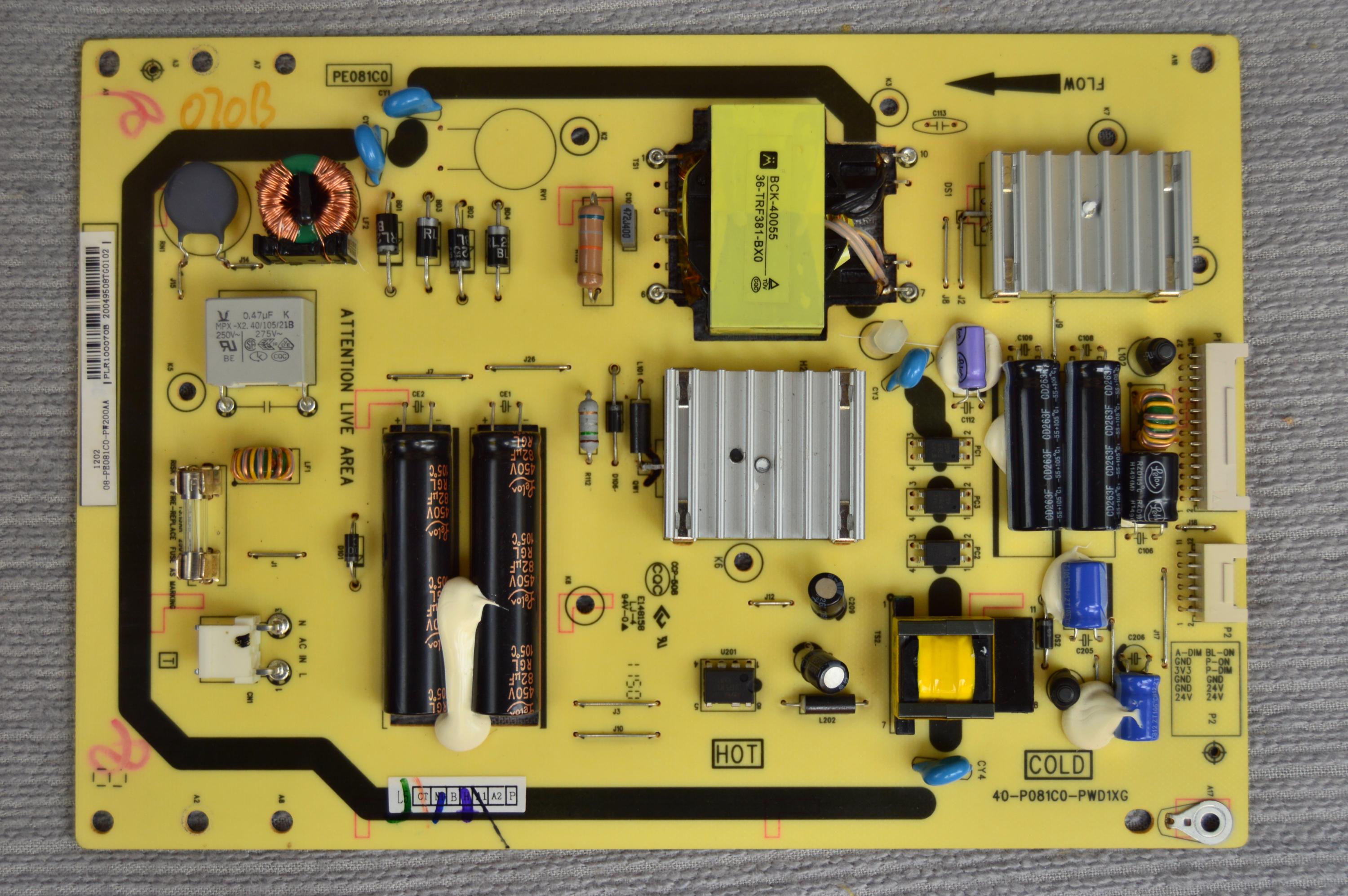

    Recently I got an LED TV Hannspree HSG1210 with no power symphtom.
    The power supply is a 40-P081C0-PWD1XG, I could not find a schematic for it other than from a similar TV, Philco PH32.
    The power board has a VIPER17L which makes 3.3V, and a FAN8754 which is not working or won't start.
    The VIPER17L is working and 3.3V is present. FAN8754 is making a rattling sound and does not operate the power mosfet.
    I have changed the FAN8754 and the power mosfet, thinking they are defective. But the 24V still does not appear.
    The four rectifier diodes I did change, still not working, I have 300V on the HV cap. there is near to 0V all the time on the power mosfet's gate. so the fan is not control it.
    Anyone knows where can I continue troubleshooting ?
    Any info whould be much apreciated

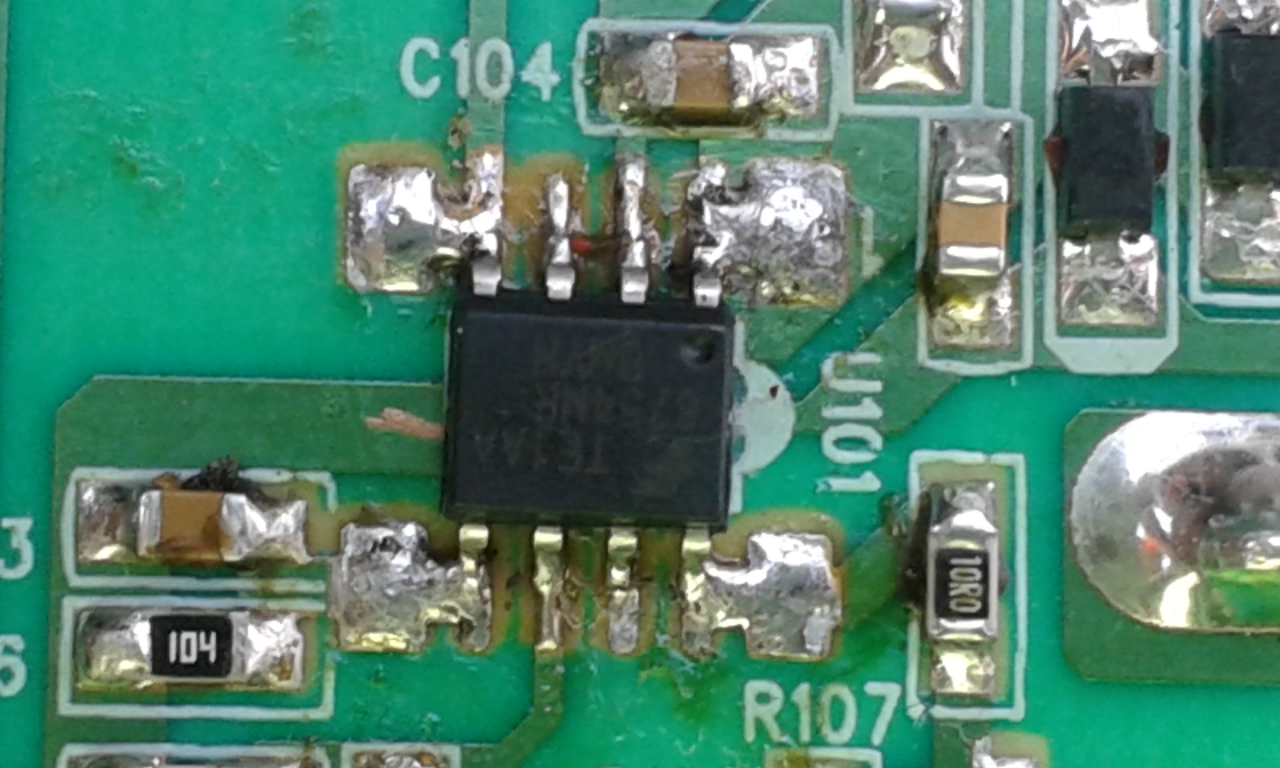

                The mosfet pin needs to be soldered and looking at your photo there appears to be a solder shard between pins 1 & 2 of the FAN chip although it could just be the lighting.

                    What's the voltage on the feedback pin 2 which should be <4.6V
                    And is that a small slither of solder between pins 1 & 2 of the IC or just a reflection of the light on the photo?

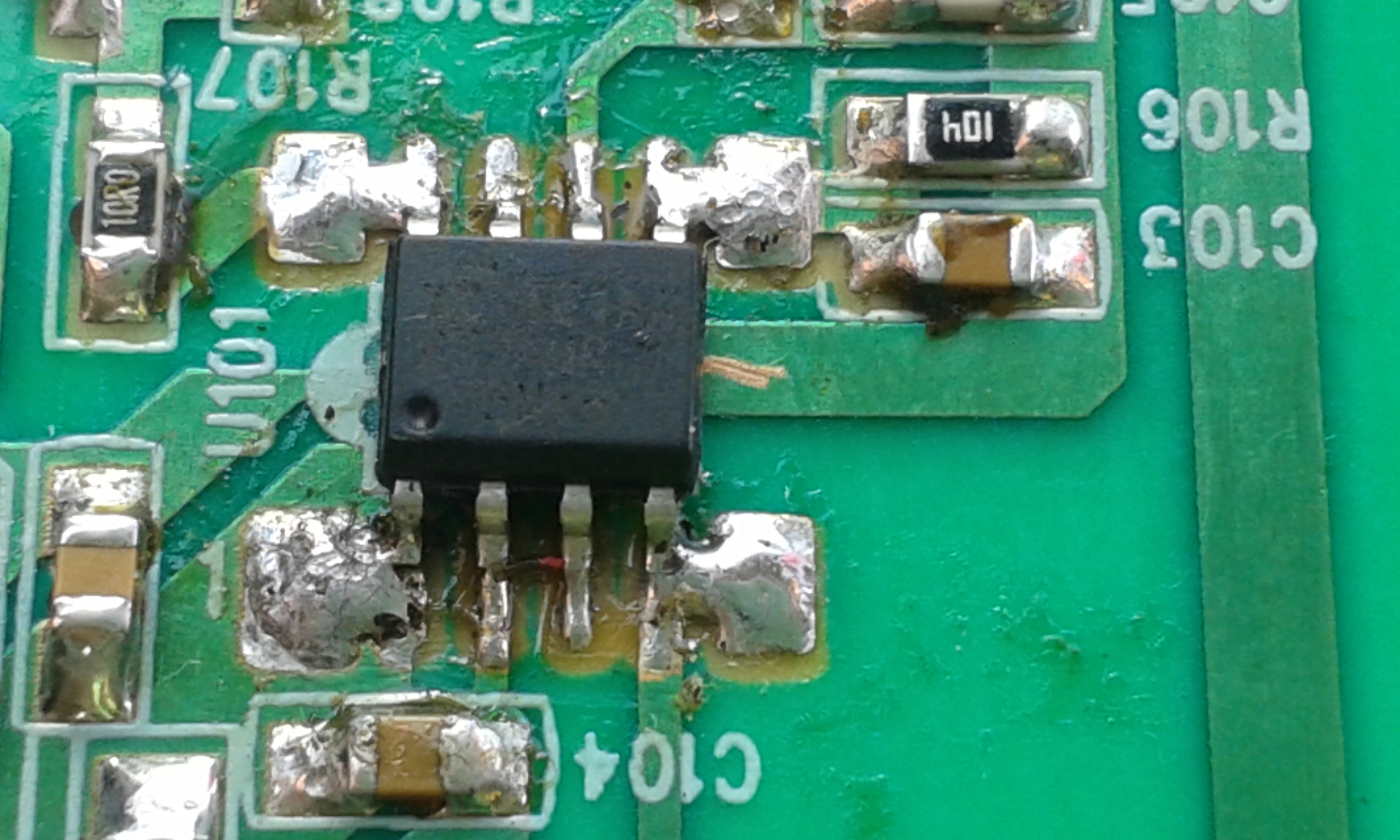

                      Re: PSU with FAN8754 won't torn on
                      Between pins 1 and 2, It is flux wich remained after replacing the IC.
                      I will check the voltage on the feedback pin and be back to you.
                      Attached some close up pics of the IC
