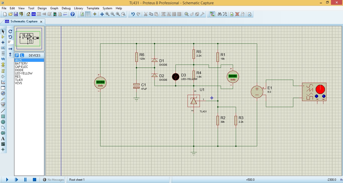

      Re: PSU with FAN8754 won't torn on
      I've simulated the opto-isolator circuit attached. The opto-isolator is not activated until the 24V output supply comes up at which point it is switched on. Anything less than 24V at the output and the opto-isolator is off.
      Edit
      D3 acting as the internal opto-isolator led.
        I'm suspecting that there is a fault causing the opto to turn on when the output is only 3v.

              #46
              Hey, I'm back. I just had a day off and had time to play with this PSU.
              I did played with the whole day,and I was really frustrated, but the success arrived after about 12 hours of thinkering and trial, but at the end worth it.
              I tried finding the 431 problem, with a circuit built on a proto board, similar to the one which regulates the voltage. No luck
              Inspecting, measuring resistors, caps, opto's, either removing them, and with new spare parts. Not working.
              At the end I measures the voltage coming out from the 431 cathode, and driving it with an external laboratory PSU adjusting from 0-32V. The voltage on the cathode was cutting at 2.8V . After trying again, it was cutting at 4.5V . Finally I decided to desolder the 431 SMD type and solder a new one back. And voila, it works.
              Thanks for all of you guys trying to help, especially for mr. rievax 60 "I'm suspecting that there is a fault causing the opto to turn on when the output is only 3v."
              you where right, the 431 was faulty and was turning on randomly.
              Another TV saved from being a waste for the planet.
