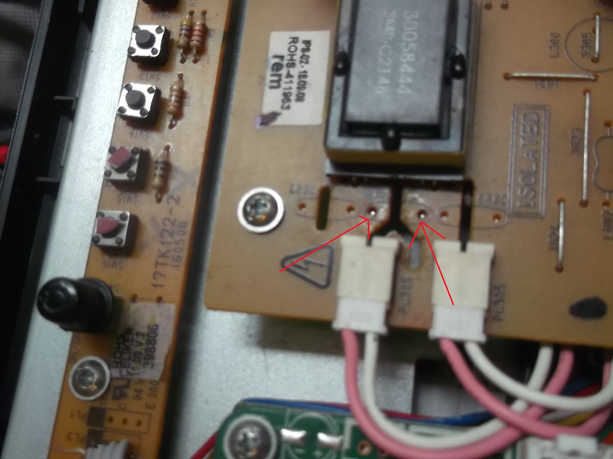

    On the following PSU/Invert board -> 17IPS02-2
    The fault is that the tv backlights do not turn on, there are 4 backlights, wired in pairs together. Each pair has a ceramic cap across the outputs. I have a small diy meter off ebay that can recognise components, it didn't recognise them. My multimeter said they were open circuit. After removal the backlights work so I bought new ones which the diy meter correctly reads. But the backlights do not work when I put them in circuit
    So I would like to know can I just leave them out as the tv now works?
    But I would like to know what they are there for and why the lights will not work with the new ones? Are the lights failing and this could cause this to happen?
    Many thanks- Simon.

            Re: Tv Inverter works without Output caps but why?
            You're driving a gas/mercury discharge-lamp. those disc ceramics are there for hash supression, nothing more.
            I have been known to hack 'em out with no negative effects--Who these days listens to long-wave radio after all!
              Thanks for replys. Some conflicting replies though, so some clarfication, I replaced with:
              Blue ceramic cap:
              3KV 4.7nF
              From ebay:
              http://www.ebay.co.uk/itm/2312562422...%3AMEBIDX%3AIT
              The same as original.
              They were connected right next to the lamp sockets so paralleled on the output.
              See attached pic. Only 2 caps were connected one on each pair. See arrows showing one for one of the pairs. The spaces on the board for more were not populated.
                  Looks like we're in agreement that they're to stop interference, but any idea's why replacing with good ones stops the backlights coming on? The picture still comes on and can be seen with a flashlight.
                    Usually capacitors in that area are there to tune the resonant frequency of the secondary circuit. 4.7nf doesnt sound right. Are you certain that the originals are this value?
                    Take a photo of the other side of the PCB if you get an opportunity.
                    Did the back lights not work at all originally or did they light for a short time?
                      Yes, no way 4.7nF is the right value there. I think it was 4.7pF
                        Ah, looks like I ordered the wrong value then, I'll try and find the originals and check the markings. The new ones are def nF.
                            Cheers.
                            That's why I asked for photo's of the old and new with their markings shown in just this event.
                              You are lucky that your inverter works like that. Usually that capacitor has the purpose of making a LC resonator circuit with the inductance of the transformer. This generates the high voltage necessary to strike the CCFLs. If that capacitor is burned or missing the result is usually the same - no backlight at all, not even a flash, as the voltage cannot get high enough to strike the lamp.
