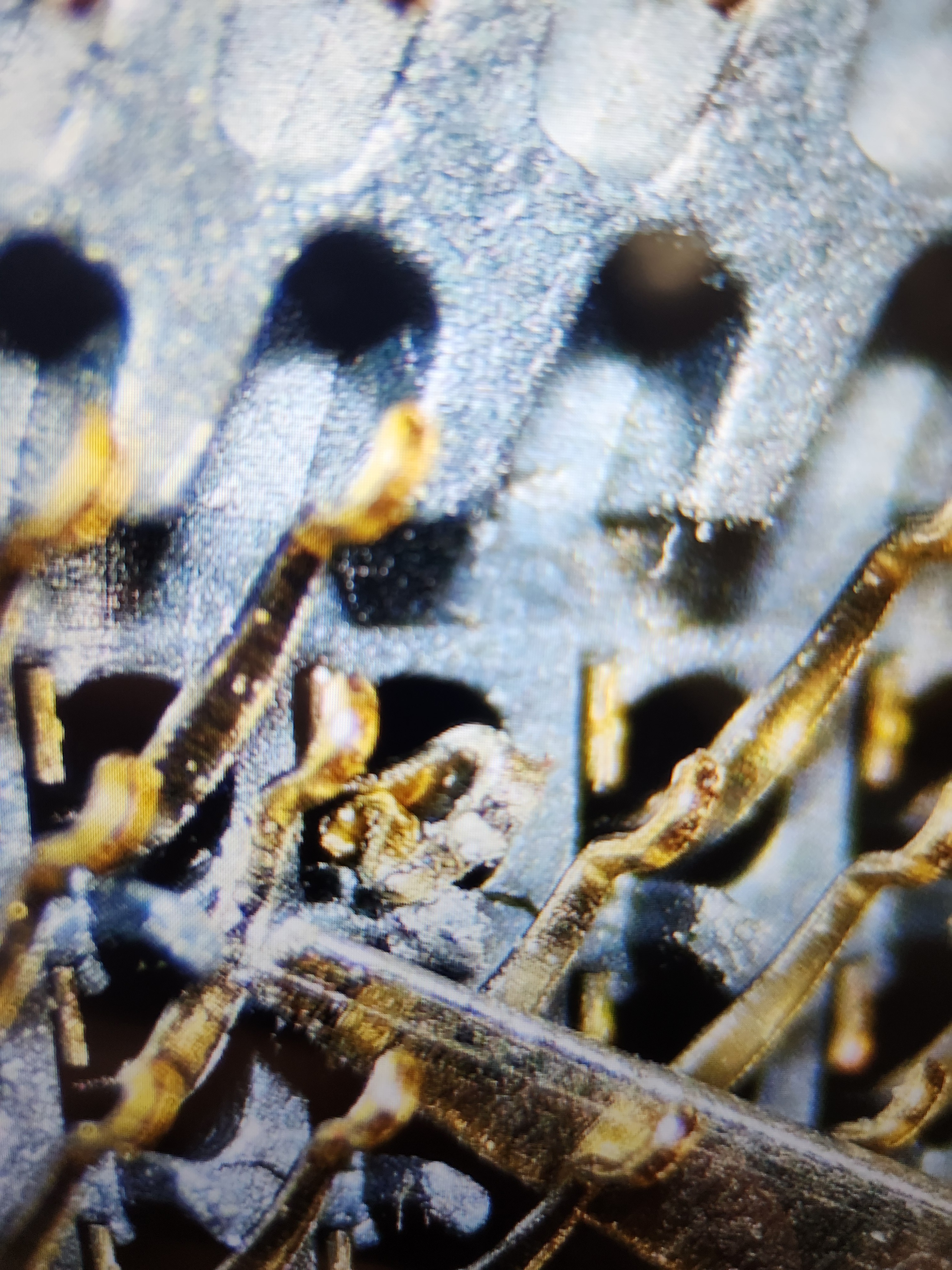

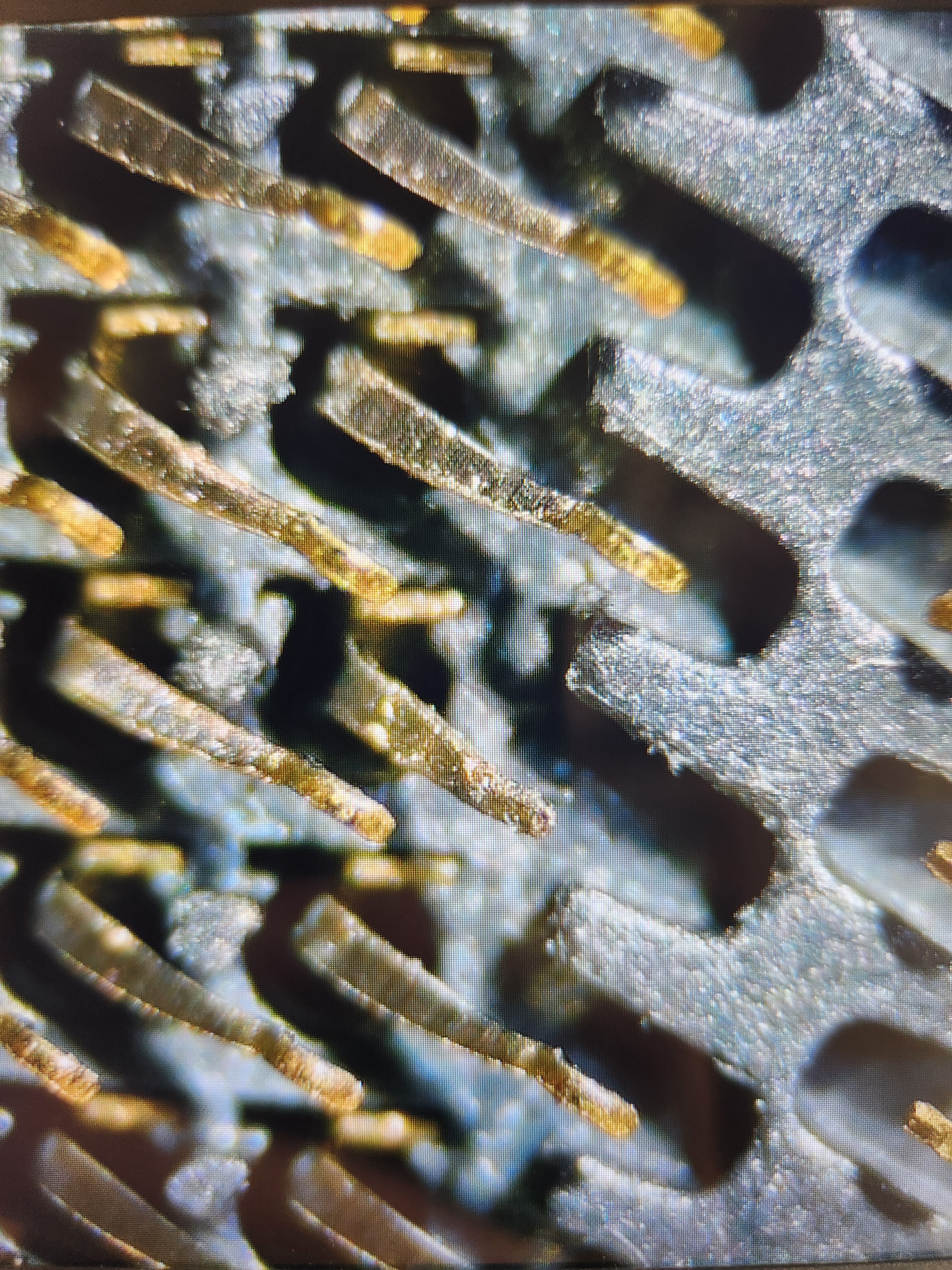

          Finally, I did go and take a look at the cpu pins. All of the pins looked fine, except this one.
          It was somehow bent back on itself completely. I checked the boardview, and it looks like this is pin G30, a VCORE pin. I attempted to bend it back as gently as I could, but it was bent so badly initially that the tip broke off in the process of bending it back.
          I reinstalled the CPU without issue but I'm unsure if the pin is making contact with the pad, and the behavior remains the same as before.

            OK, one VCORE pin is completely not relevant, there are a lot of them in parallel. So this is not the issue.
