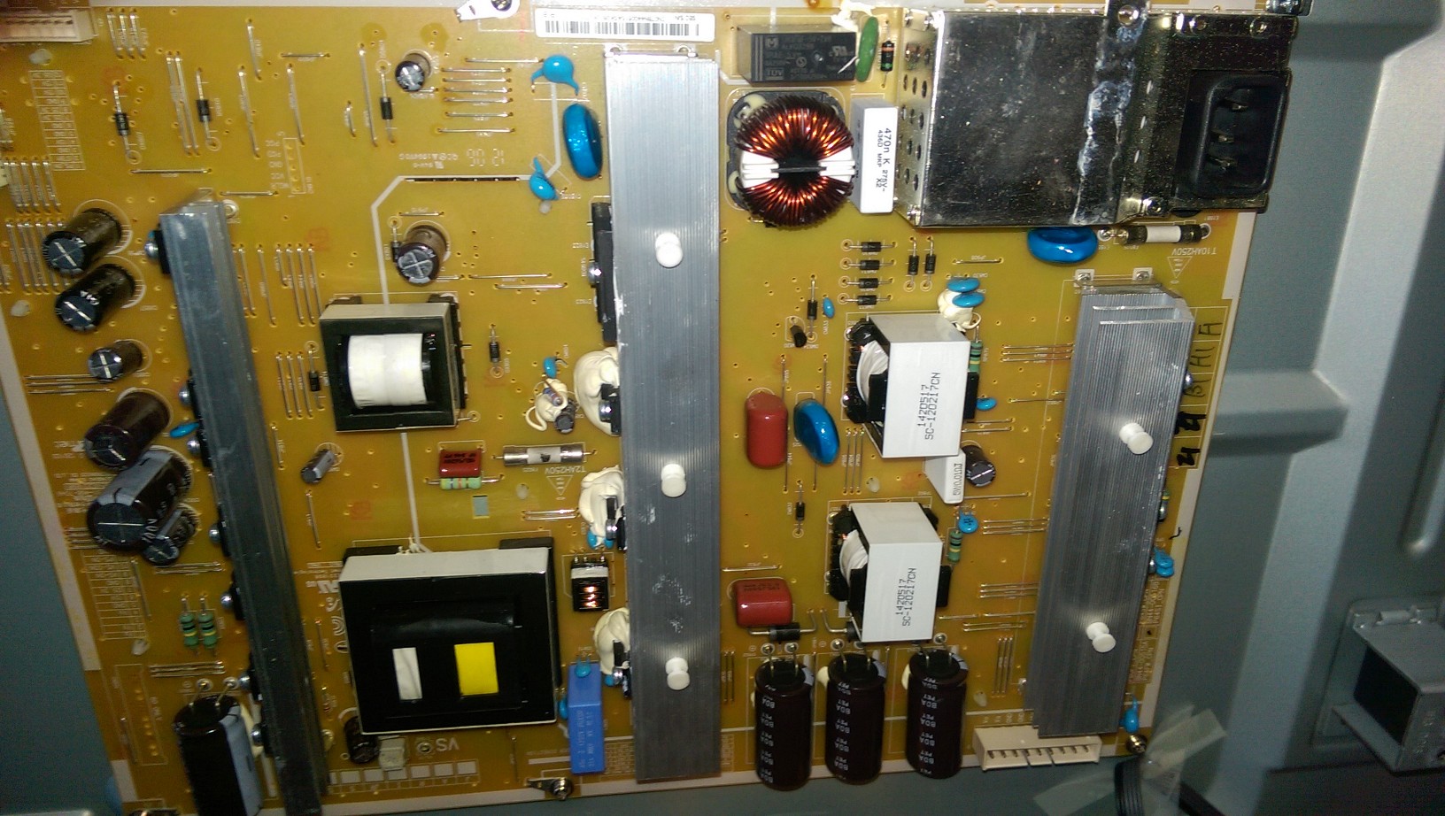

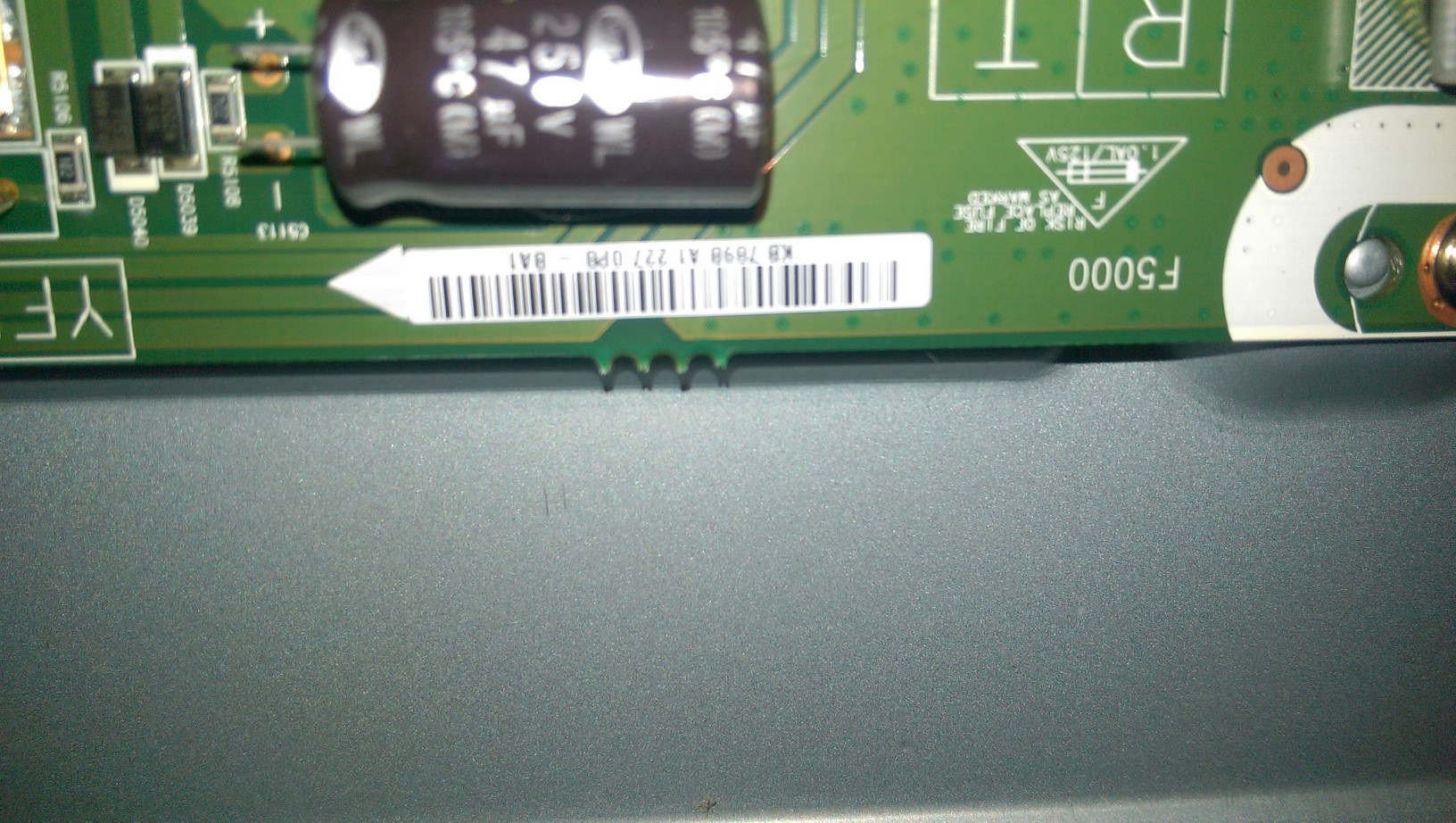

            PS board is bn44-00515a. I will take pictures tomorrow and post them.

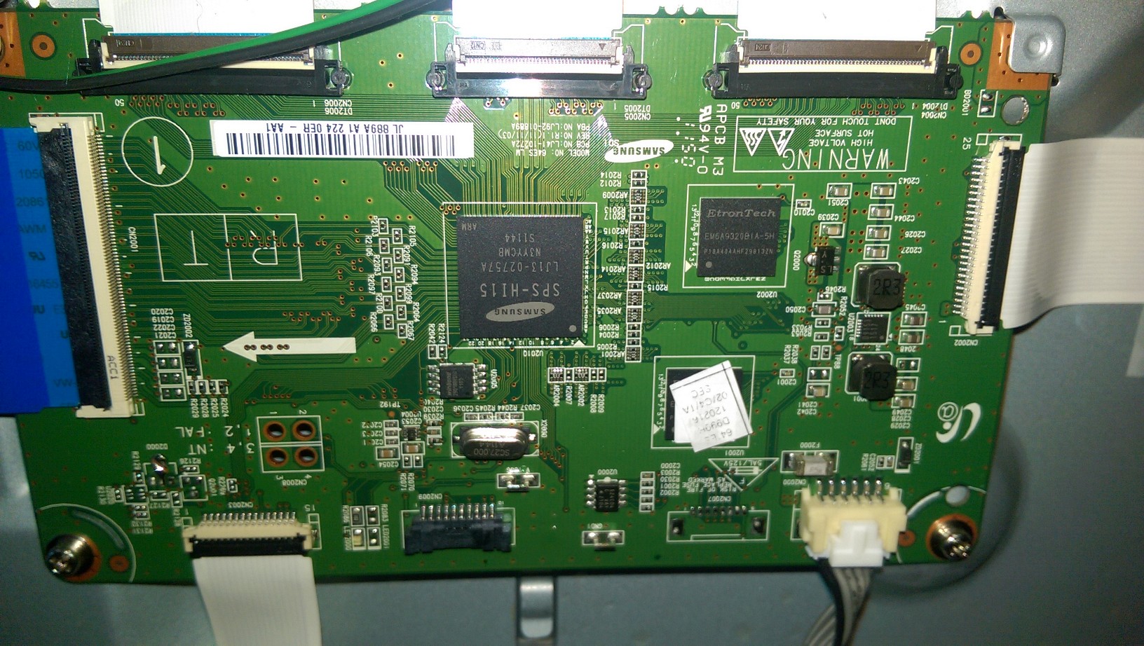

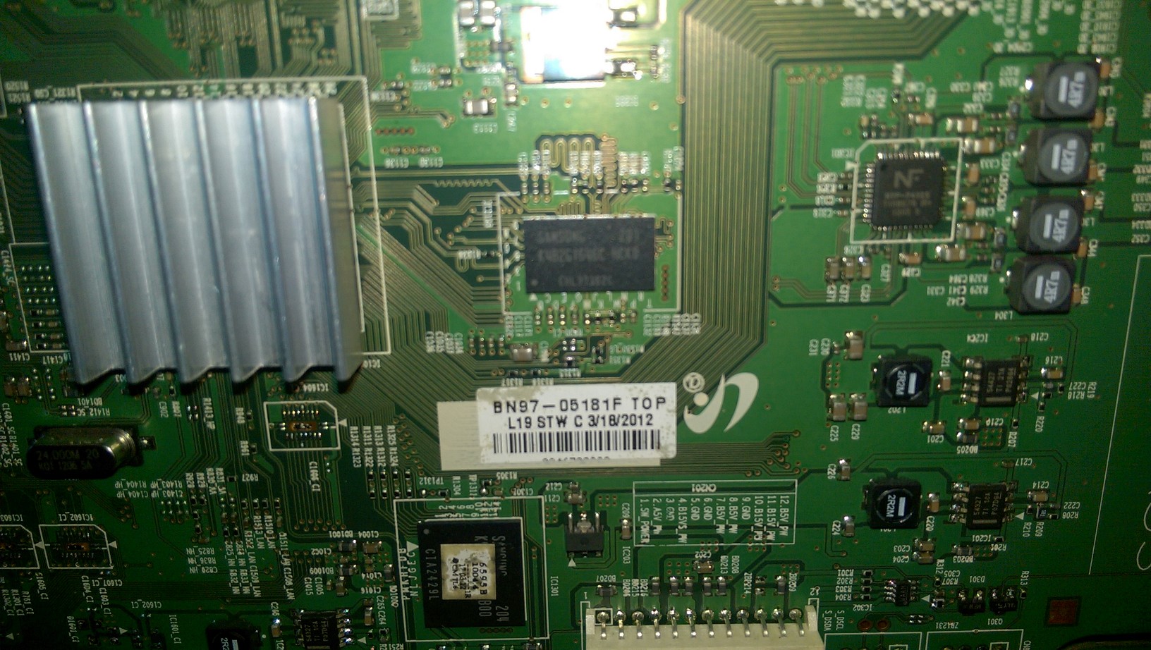

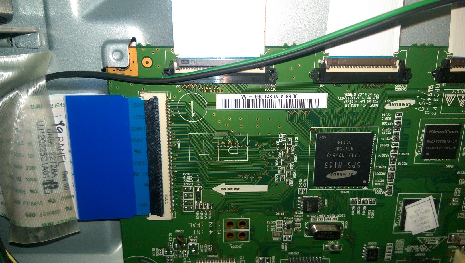

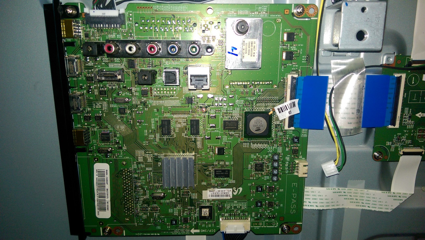

                I took these pictures in a rush and I will get better ones tonight.
                  Re: Samsung PN64E550D1FNZA

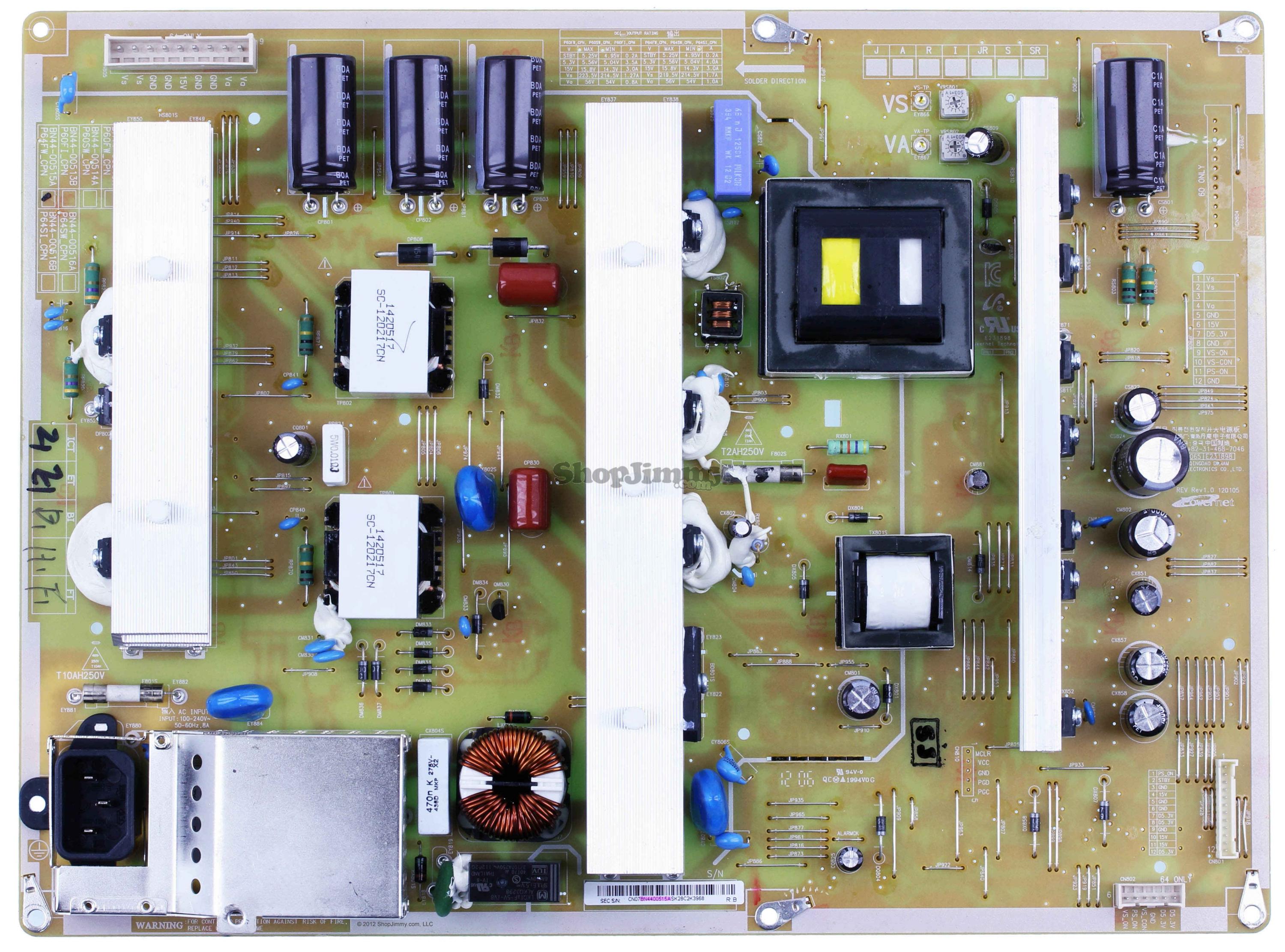

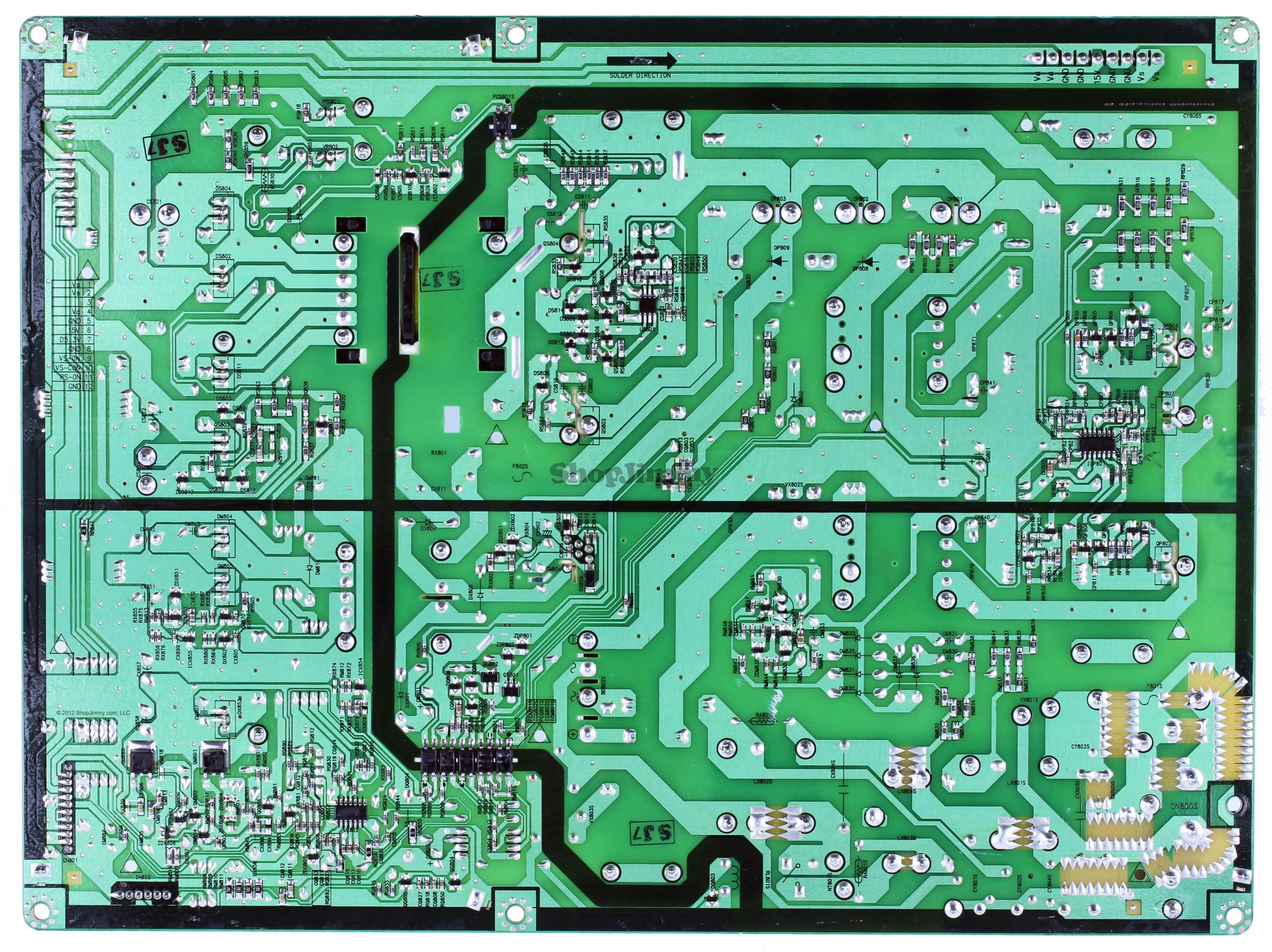

                  BTW, you should check all those parts used in the SJ Kit on your board to see if they are OK.
                  SJ pictures as a ref to compare to your board:
                  Samsung BN44-00515A (P64FW_CPN) Power Supply Unit.
                  Pictures provided by shopjimmy.
