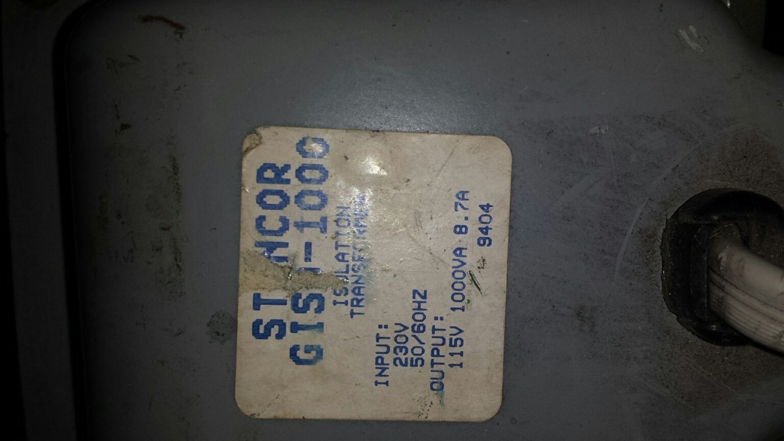

    Re: Isolation Transformer
    Originally posted by budm
    Are you sure you received the GIS-1000 as shown in the web site and matched the PDF spec I provided? 1000VA is a BIG transformer.
    Show us the EBAY seller web page and the picture of the unit you bought.
    I see some on EBAY:
    http://www.ebay.com/itm/Stancor-GIS-...oAAOSwd2xXP~t-
    It is the same transformer, same as in the link you provided.
    • R_J
      • Jun 2012
      • 9624
      That link http://www.ebay.ca/itm/222226718872#ht_166wt_1319 shows a picture of a 220 volt to 110 volt step down transformer. which is what you got
      I suspect it is a GISD-1000
      So if you connect it to a 220 volt outlet you will get your isolated 110 volts
      • tech2014
        • Aug 2014
        • 807
        The eBay seller lied in his listing as it says its an isolation transformer. Opened a return request since its useless to me.
        • dick_barton
          • Aug 2015
          • 6643
          • Wales
          The ebay picture above may well be an Isolation transformer but the spec says:
          Input 230V 50/60 HZ
          Output 115V 1000VA 8.7A
          To check if it is an isolation transformer measure resistance between the input and output terminals which should be open circuit between Live In /Live Out, Neutral In / Neutral Out.
            GISD-1000 IS isolation and also a step-down transformer as shown in his description and also in the spec. sheet.
            'Stancor GISD-1000 Isolation Transformer Used.
            Plugged in and works.
            Mounting brackets are slightly bent (see pics). Device shows some wear and tear.
            Input 230V 50/60 HZ
            Sold as is no returns'
            See attached spec sheet for GISD-1000.
            You should have bought GIS-1000
            • dick_barton
              • Aug 2015
              • 6643
              • Wales
              +1 Agree with Budm and it looks like non returns.
                • 31293
                sellers description is crystal clear.
                makes a nice change!
                • tech2014
                  • Aug 2014
                  • 807
                  I did a resistance check and there is no continuity between the input and output so it is indeed isolated. Problem is I am only getting 60VAC since it is a step down. Is there a way to modify or some way i can still get it to output 120VAC.

                    #29
                    Input 230V 50/60 HZ
                    Fuck sakes wasted over $120 on this useless piece of shit, just a big fucking paperweight. I may try and sell it on ebay to recoup.
