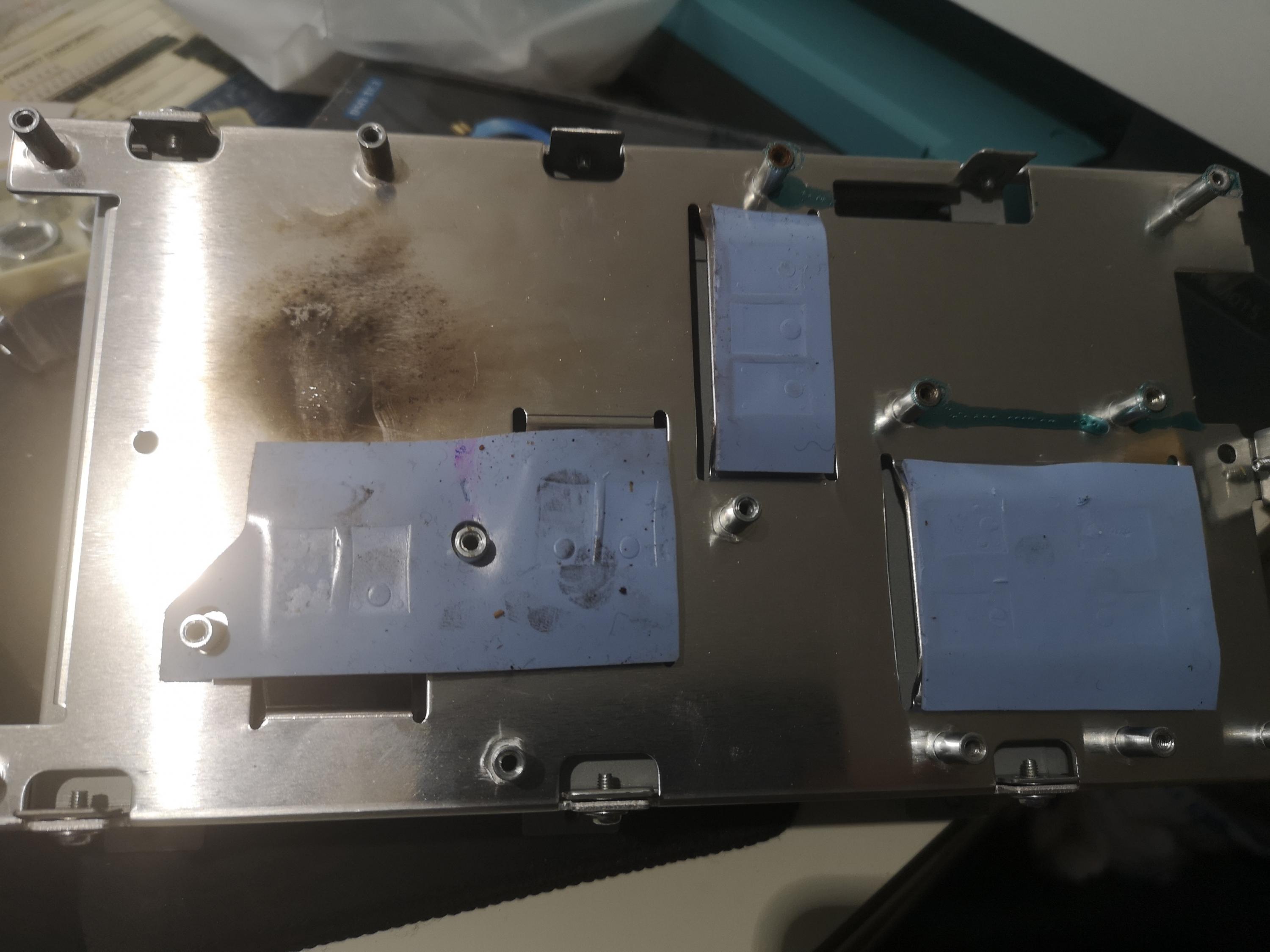

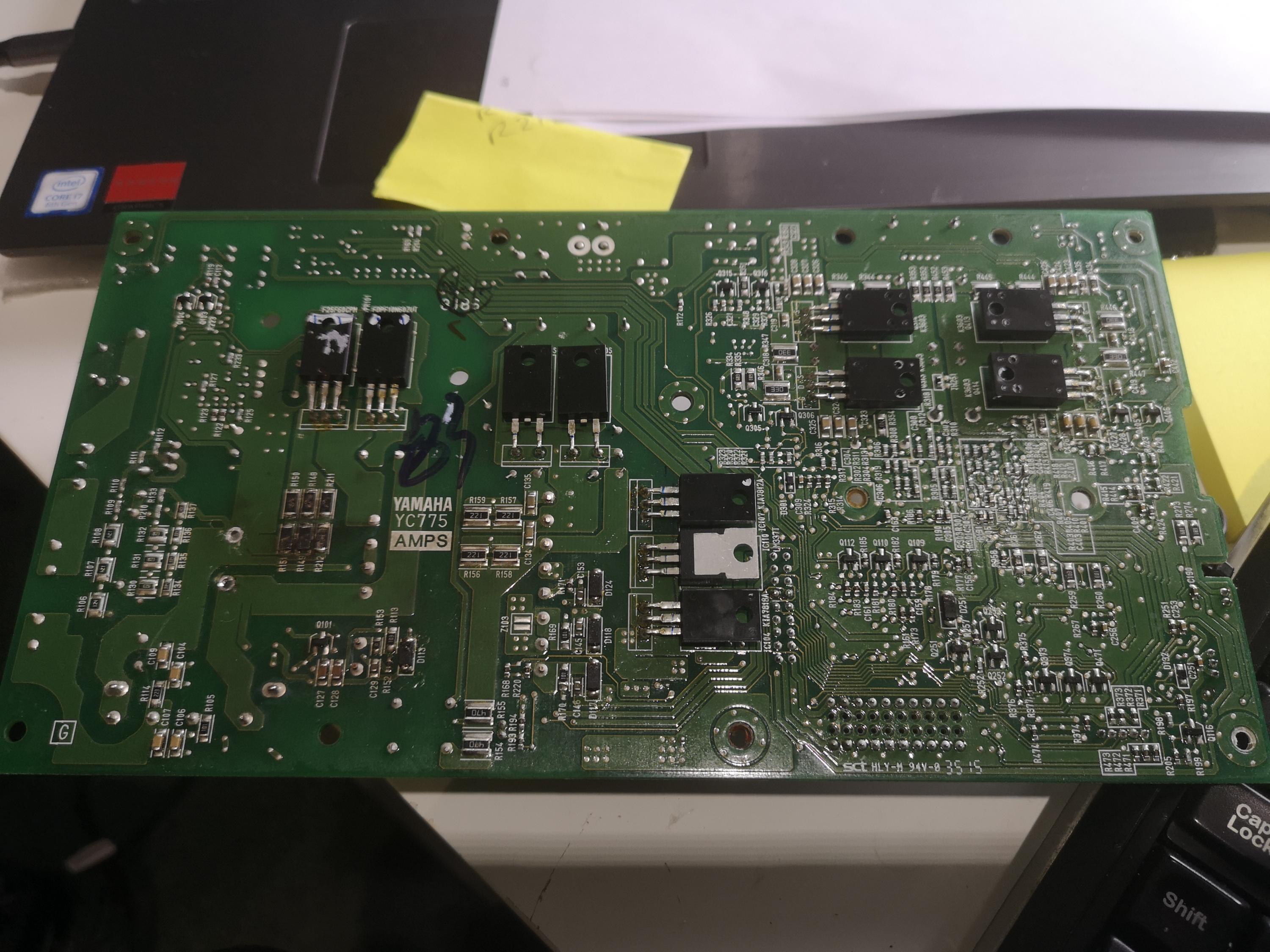

    I have a blown smps and I am looking for some reassurance as to the amount of diagnosis I have to do. It blew the instant I plugged it in not under any load.
    As you can see from the attached pix, the damage is located around the main or bulk capacitor (since removed for testing) and the resistor array/network that drives it (the bunch of SMD components to the left of the YAMAHA YC775 AMPS logo). The burn mark on the frame clearly shows the pins of the capacitor. And, for the avoidance of doubt, there is no way the board could have contacted the frame, it was correctly mounted on the standoffs at the time the amp blew up.
    If anyone has any comments on how far any damage is likely to have spread, I would be grateful.

    looks like the mosfet shorted and took out the resistors.
    maybe because of a bad cap.
    secondary is probably fine, but thats a complex looking board.

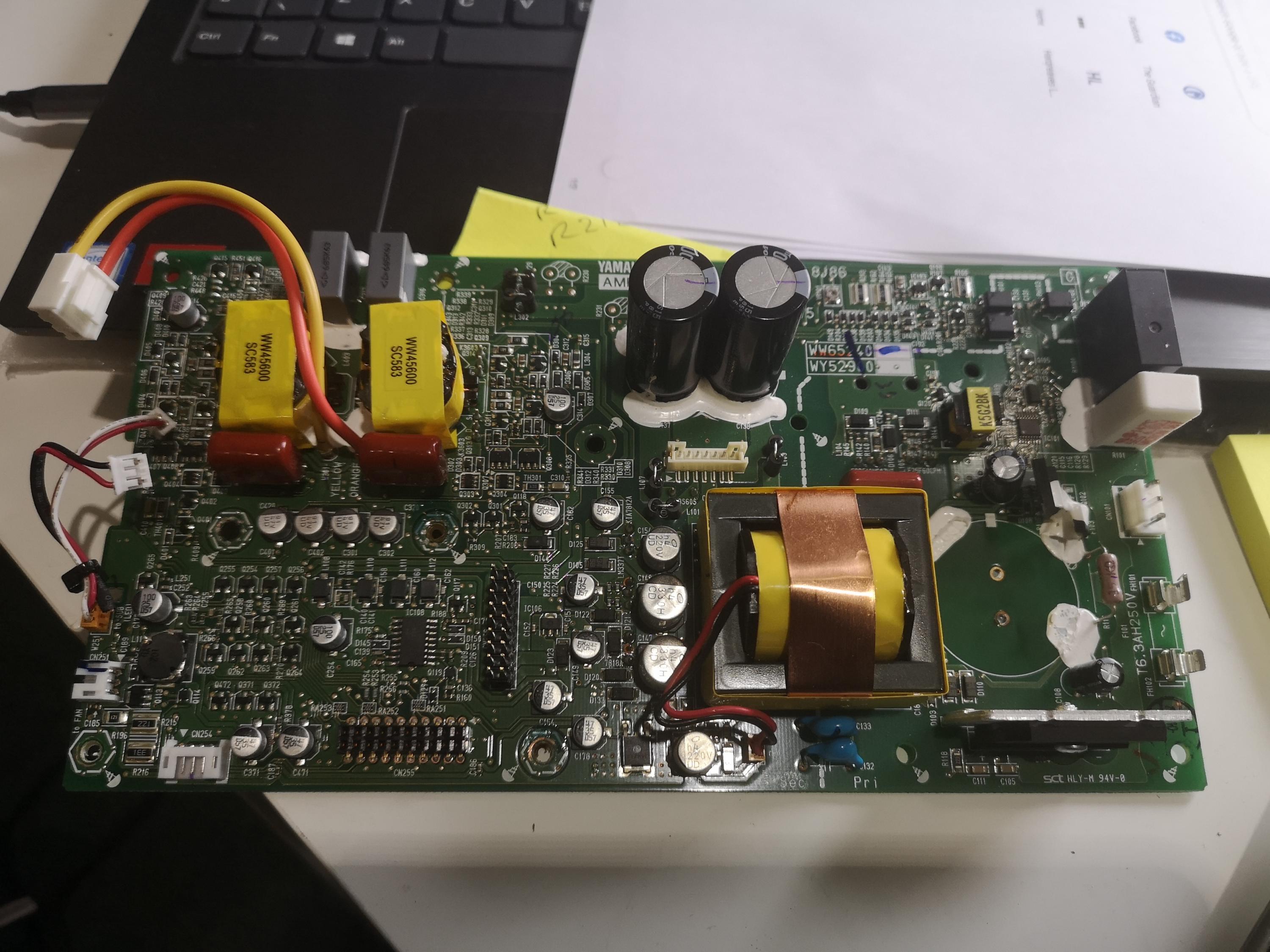

      Looks like an SMPS with a class D amp all combined on one board.
      The SMPS looks like a double-forward topology.
      I agree about checking the small caps near the big one on the primary (that is now removed), since those looks like they are cheap brands.
      Could also be that the clearance / distance between the primary cap's leads and the aluminum heatsink just wasn't big enough, so perhaps the HV arced over to secondary side ground. But then that doesn't explain why those resistors would blow. Those resistors are for current sense on the primary side (for the MOSFETs), so indeed one or both MOSFETs could be blown up... or their damper diodes.

        I also agree that the 2 mosfets connected to those resistors are blown and no damage on the secondary side of the transformer. I would suggest checking the Greatz bridge (AC/DC) converter before the big capacitor on the ac side because it can be the reason for the big capacitor failure. You can replace it also it may looks good with a new one to be sure no problem on the ac side.

            Update: I removed the 25F60CPM MOSFET and it tests as a resistor so it's definitely defective. Is the advice still to remove the other MOSFET or can I leave it where it is?

              Remove it and test it.
