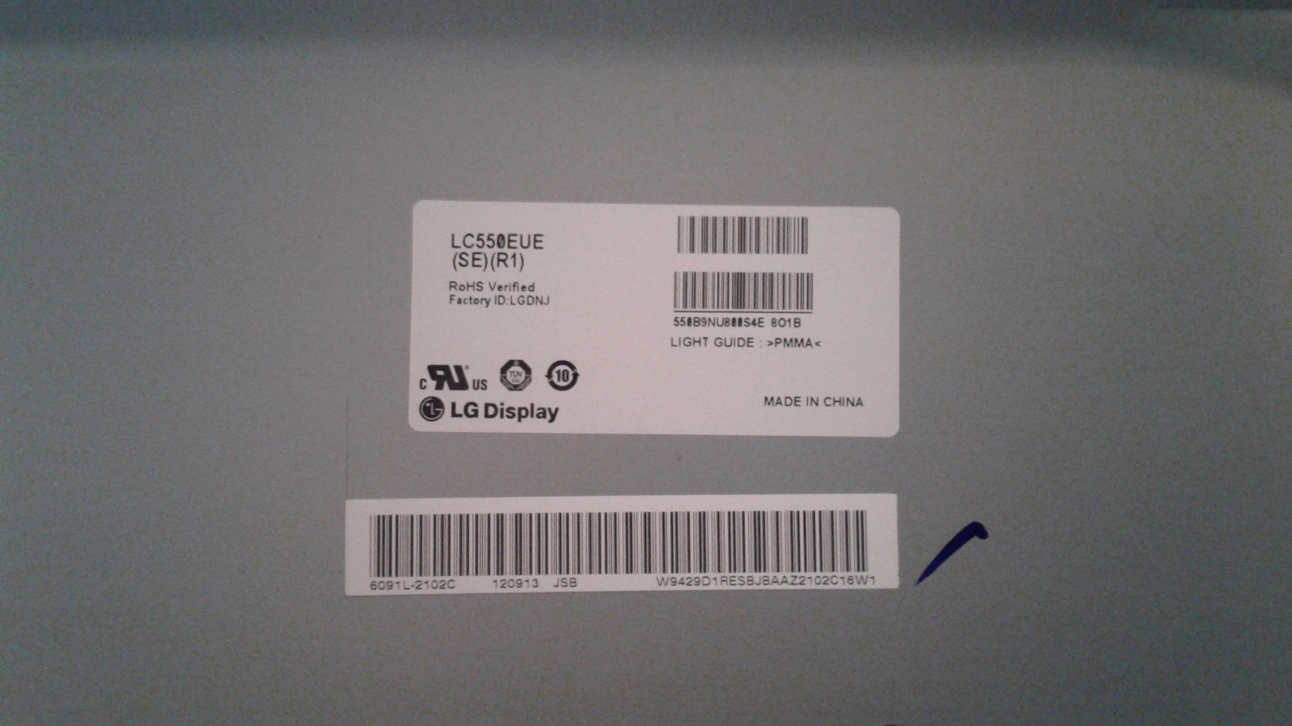

                Ok opened it up , Lcd panel # is LC550EUE. BUT I can't seem to find the backlight strips for sale anywhere. ShopJimmy.com has 2 strips listed (but out of stock) However it has SEF1 following the above listed part # so I'm not sure if it's the right one. Here is a pic of the panel label, maybe someone can help me find the LED assemblies.

                  Re: Please Help with LG 55LS4500. DARK SHADOW ON SCREEN
                  Do you have pictures of the led strip and the numbers given on them.
                    No I was under the impression I could order the LEDs with the lcd panel #. I reassembled the TV so I can use it until I have the parts. While it seems the parts are nearly impossible to find I may just have to buy a new TV. It works fine except for the shadow ,but I can't stand looking at it. I can find leds for dang near every tv ever made except this one. If I completely disassemble the TV and get to the leds I will be out of a TV for days to months until I find parts...kinda stuck I guess.
                      some good pictures of the leds which maybe used in this panel
                          i wonder if its worth looking on aliexpress.com for replacement leds? and just changing whats gone and have some spares? depends if cgreen can change them or knows somebody who can.
                          Maybe something like this but i have no idea of the size or volts used
                          https://ru.aliexpress.com/item/50pcs...9-87bbd415770b
                            http://www.ebay.co.uk/itm/BACKLIGHT-...-/201483699561
                            I saw those on ebay but wast sure if they were the right ones, or if that was the left or right side....or if it even matters.
                              I know my next tv will not be a lg, this one is only a couple years old. Nothing lasts long anymore.
                              im sure if you email the seller they will advise you what side there from and may even offer you a cheaper deal ive got to say i do like lg sets myself and a few family members have lg stuff too.
                                Good advice, I emailed the guy and he said it was the right side . He also emailed me a good close up of the part number on the leds. So here I go tearing down the TV again to make sure before ordering.
                                  I got it completely disassembled, managed to successfully remove the lcd without breaking it. I found a complete set of leds on ebay, with matching part #s. It lists for a different tv model but the actual led assemblies have matching part #s. Got both sides for $79 with free shipping. Thanks for all the help guys, now to wait on the delivery guy.
