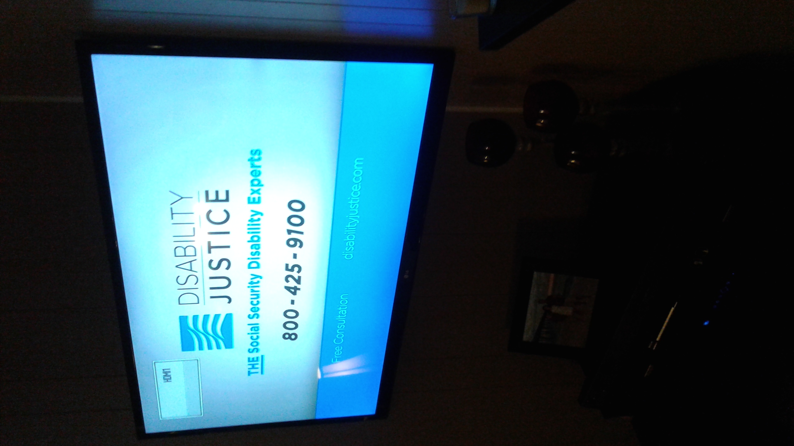

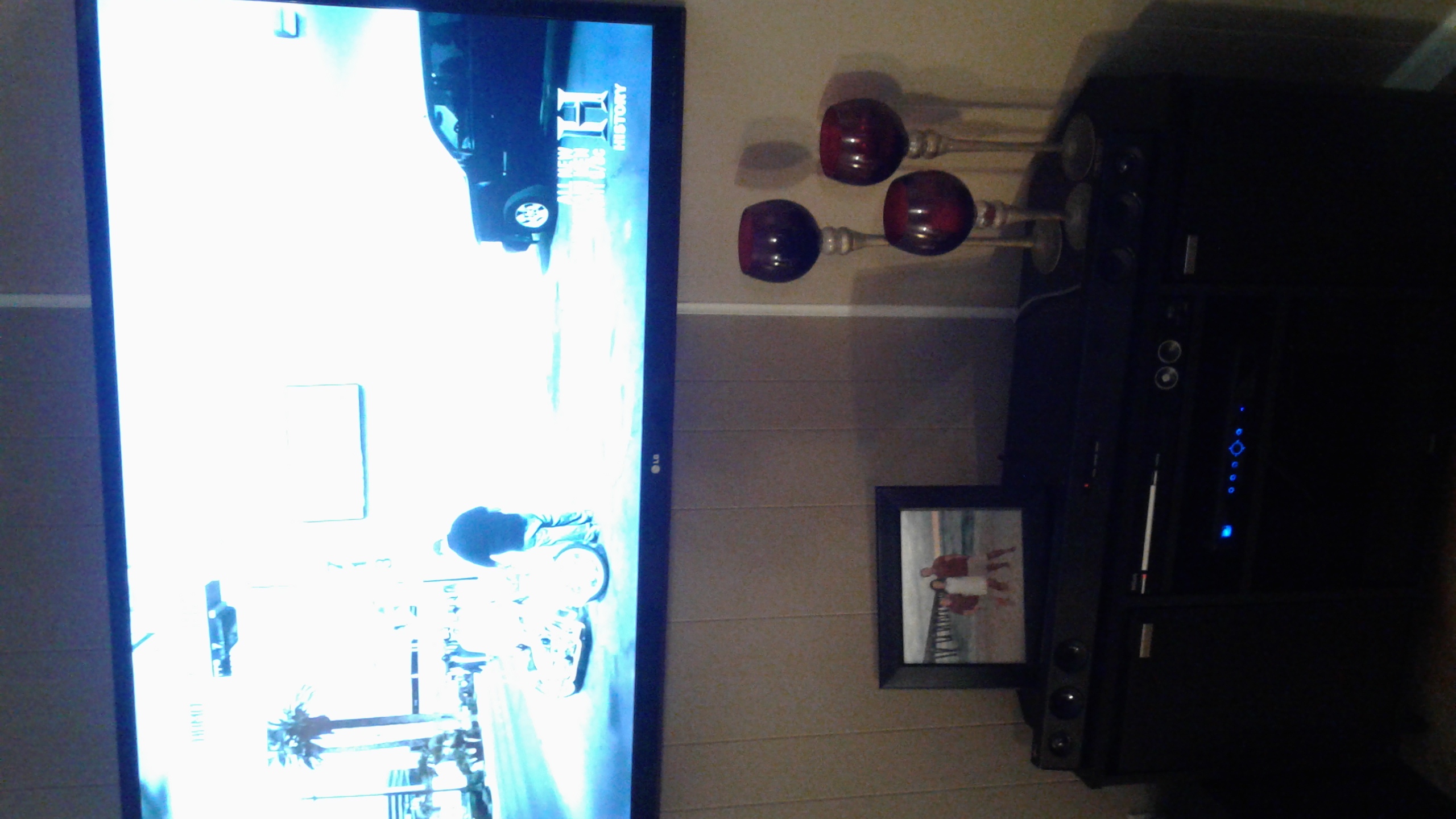

    Hey new to this forum, but active member of several automotive forums.
    Can someone please tell me the source of this problem that started about 3 days ago. It is a 55 in LG model #55LS4500 it has developed a horizontal shadow in the middle right side of the screen. There is still a picture in the area it is just darker, shadowed.
    I have repaired several tvs in the past . Mostly caps,dlp chips and t-con boards. But I don't know where to start troubleshooting this one.
    The odd thing is when I first turn the TV on the shadow is not there, then approx. 3 seconds later the screen dims slightly and the shadow appears.
    Is it the led strips?..a board??..caps??. Any help would be appreciated.
    It looks way worse in the pics than it looks in person but still it is annoying.

    It's an edge lit led set so I suspect some of the leds have failed.

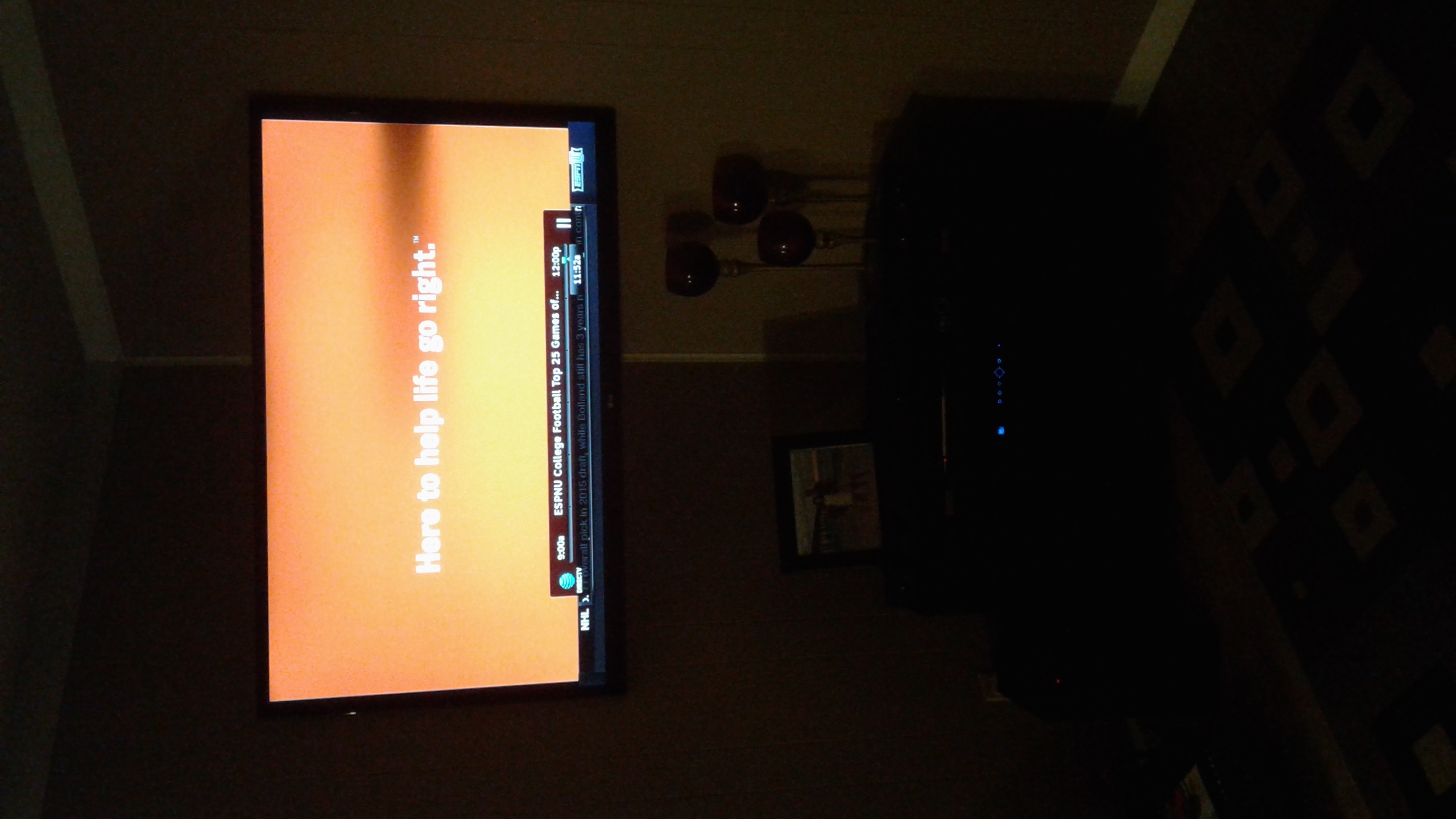

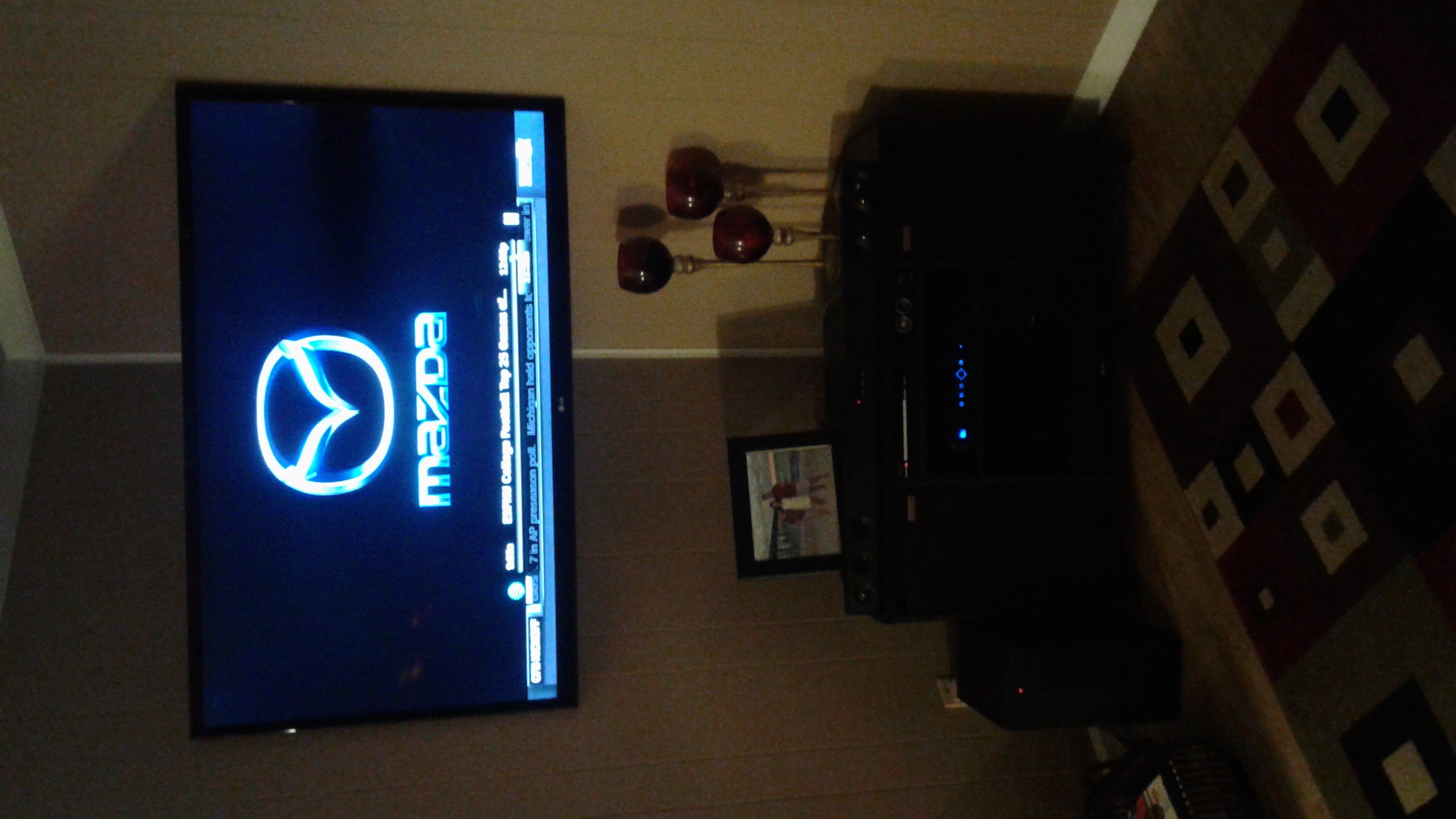

              Re: Please Help with LG 55LS4500. DARK SHADOW ON SCREEN
              You can still see it with backlight on 1. Here is a pic just now of it when
              It first comes on.. No shadow.. then 3 seconds. Later it appears.
              Well you can kinda see it start to form. It took a sec. For my camera to take the pic.
                Here is one timed correctly,
                  Backlights (not Brightness level) level at 1 should be very very dim. I say you have bad LEDs that are dying. If you test the Voltages at those test points in the link, it should show some not normal reading.
