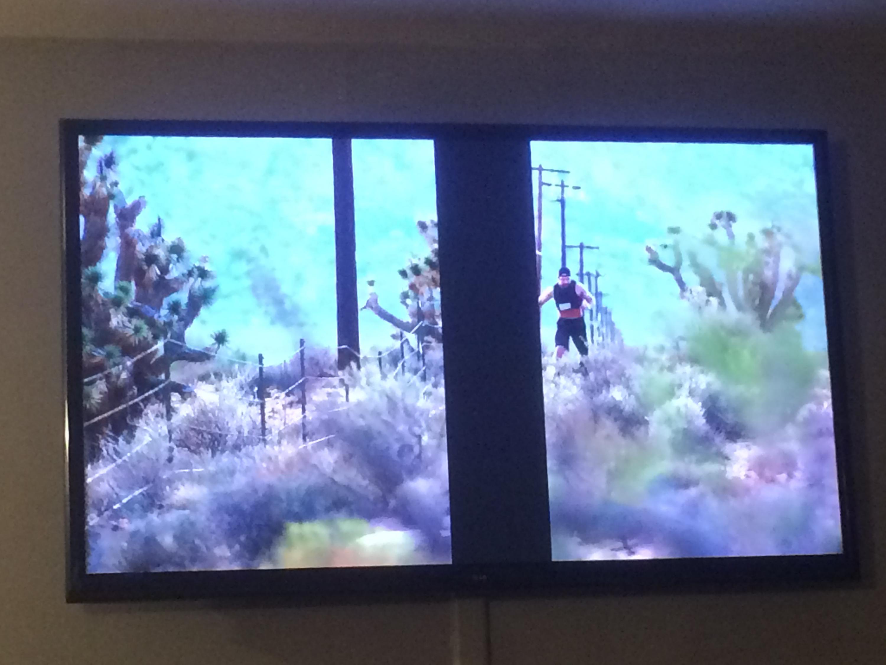

    LG 60PB6650 - Black Vertical Bar
    I was watching TV and suddenly the a thick vertical black bar appeared near the center of the screen.

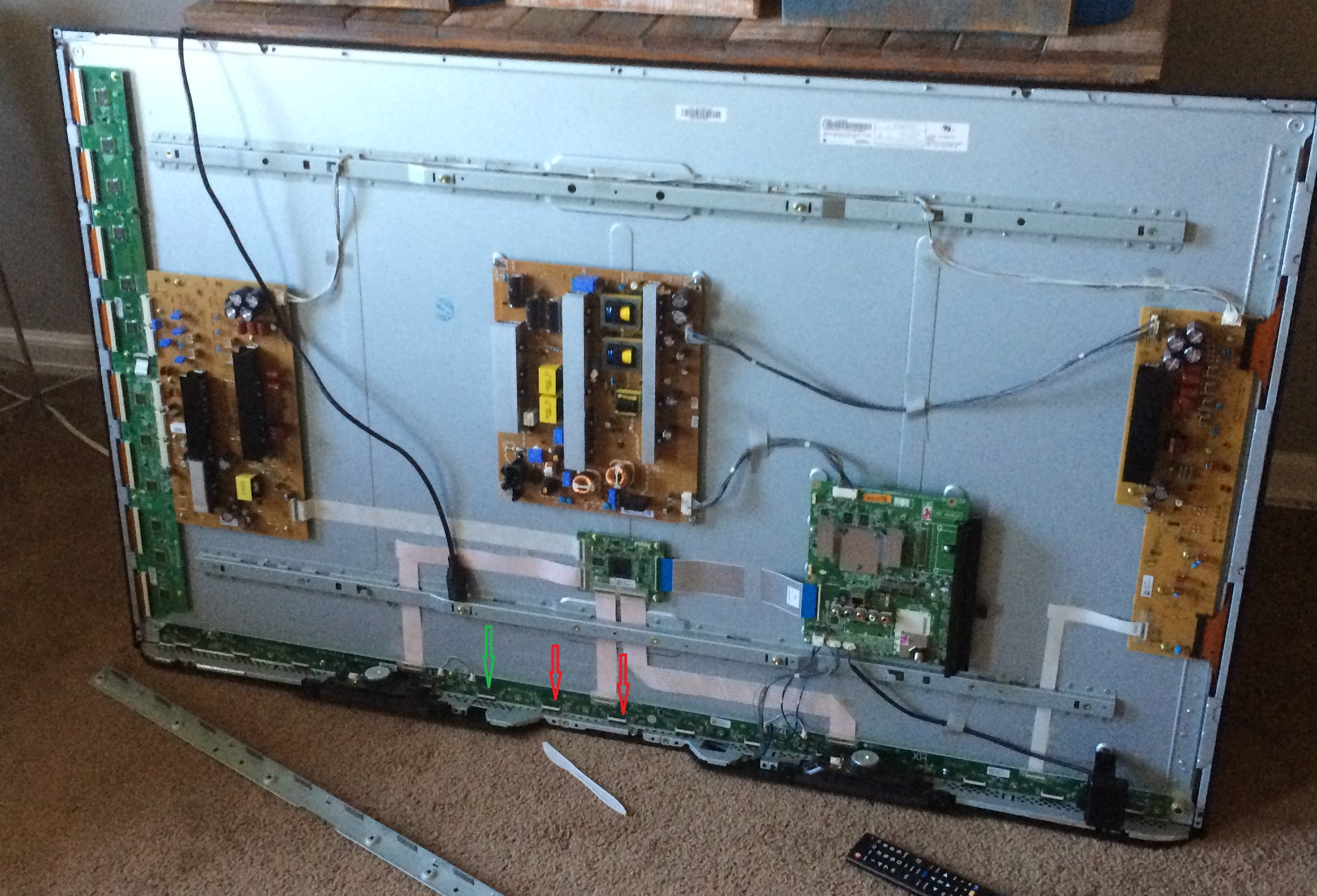

    After some research, I found out it could be caused by one of the ribbon cables connected to a buffer board or a blown component on the board itself. I opened the TV and looked around for some burned out components on any of the boards but didn't find anything.
    Disconnecting and reconnecting the ribbon cables marked with a red arrow did not fix the issue. When I leave the ribbon cables under the red arrows disconnected there is no change in the picture. When I disconnect the ribbon cable under the green arrow, there is a new thinner black bar next to the existing black bar, but it is not as black as the original one. This is leading me to believe it may be the panel itself that is the problem.
    Would replacing the buffer board that the ribbon cables are connected to have any effect? Or am I out of luck?
    Any help/suggestions would be very much appreciated. Thanks!

    Re: LG 60PB6650 - Black Vertical Bar
    "DO NOT RUN SET WITHOUT THAT METAL STRIP SCREWED DOWN"
    could be lower buffer but more then likely panel fault
    re-seat all ribbon cables
      Address buffer failure, not fixable as they are bonded to the panel. Have fun smashing it I know I would
        Just occasionally the supply SMD resistor to the COF chip fails giving a black bar--but in your case, it would be the supply to Two adjacent chips due to the bar width...
          Which board would that be on? Would you happen to have a schematic available to help me determine if this is the case?
                As Alastair E and Reecy stated, not repairable.
                      Sal,
                      Please post what your updates are with fixing your set. The other day, I just got the exact same vertical black bar in the same location on my 60pb6650.
                      Unfortunately, 4 months ago I just went through replacing the YSUS and buffer boards to fix their failure when it was 1 year and 1 month old. Seems these sets are filled with chintzy boards/components.
                            Just tried new XC - same thing. Thanks for the quality product LG.
                              Its a shame as this has probably confirmed its a unrepairable panel probelm which seems to happen too a lot of lg plasmas, but as you know all the boards are good you maybe able too sell them all and get some good money for them, people will even probably buy the stand and even the remote control.
                                Just as a follow up and warning to others:
                                I took my set apart to sell the boards, and inspected everything. Here's what I found:
                                The PDP X ribbons have an embedded chip in them. The metal plate that is over the X buffer boards across the bottom has heat sink pads on it that mate against the chips to cool them. My plate must have had a bow to it, because I could see in the heat sink pads where they were smooshed on the outer edges and gradually got less impressed toward the center to the point where the one that failed barely had any impression at all. There was no residual heat sink material on the chip that failed, and there was material on every other one.
                                So be warned! If you are taking the back of the set off for something else, I would say it's well worth the effort to check this heatsink engagement with the ribbon chips, and apply heatsink compound as necessary to prevent this failure. They may not have put it together correctly at the factory!
