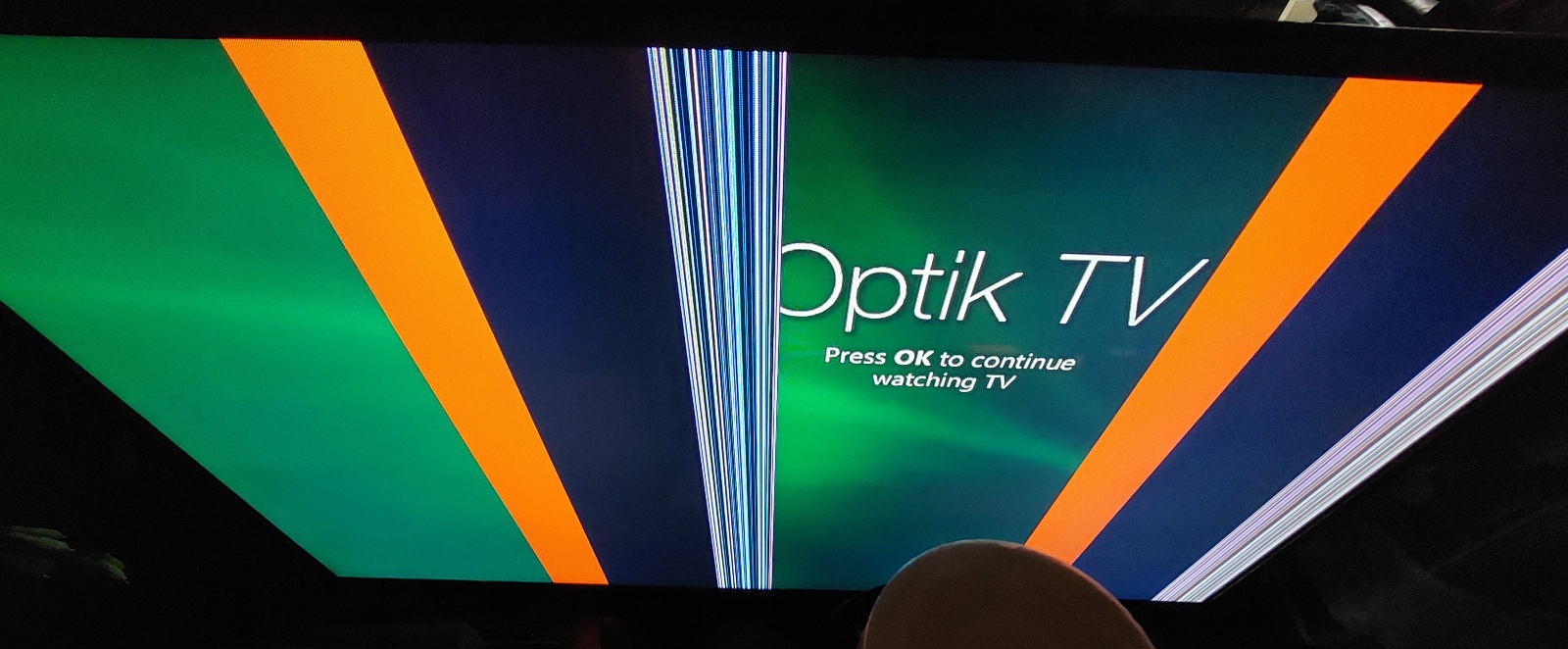

    Sharp LC-70LE650U vertical black and red bars
    70" LED TV is Sharp LC-70LE650U.
    Initial problem was horizontal lines and slow motion lurrs on the bottom left of the screen. So I removed both the left and right ribbon cables from the T-con board and tried to clean it with alcohol and when I put it back, this issue appeared. I tried carefully reinserting the ribbon bon cables but same thing. I checked the traces of the ribbon cables with magnifying glass and everything looks good. I cleaned the small jumper ribbon cable on the left side of the screen which cured the horizontal line and slow motion blurs but I ended up with this new vertical bars issue.
    One thing to be noted that the pattern is same on both halves of the screen. If I remove left ribbon able from the tcon boars, then left side of the screen turns white and if I remove right ribbon cable then right half turns white.
    Do you guys think I somehow damaged the tcon board? Can bad tcon create similar bars and pattern on both halves of the screen? The exact half of the screen is where the O of Optic is. So exactly same pattern on both halves of the screen. Please suggest. I have already ordered tcon board.Thanks.
