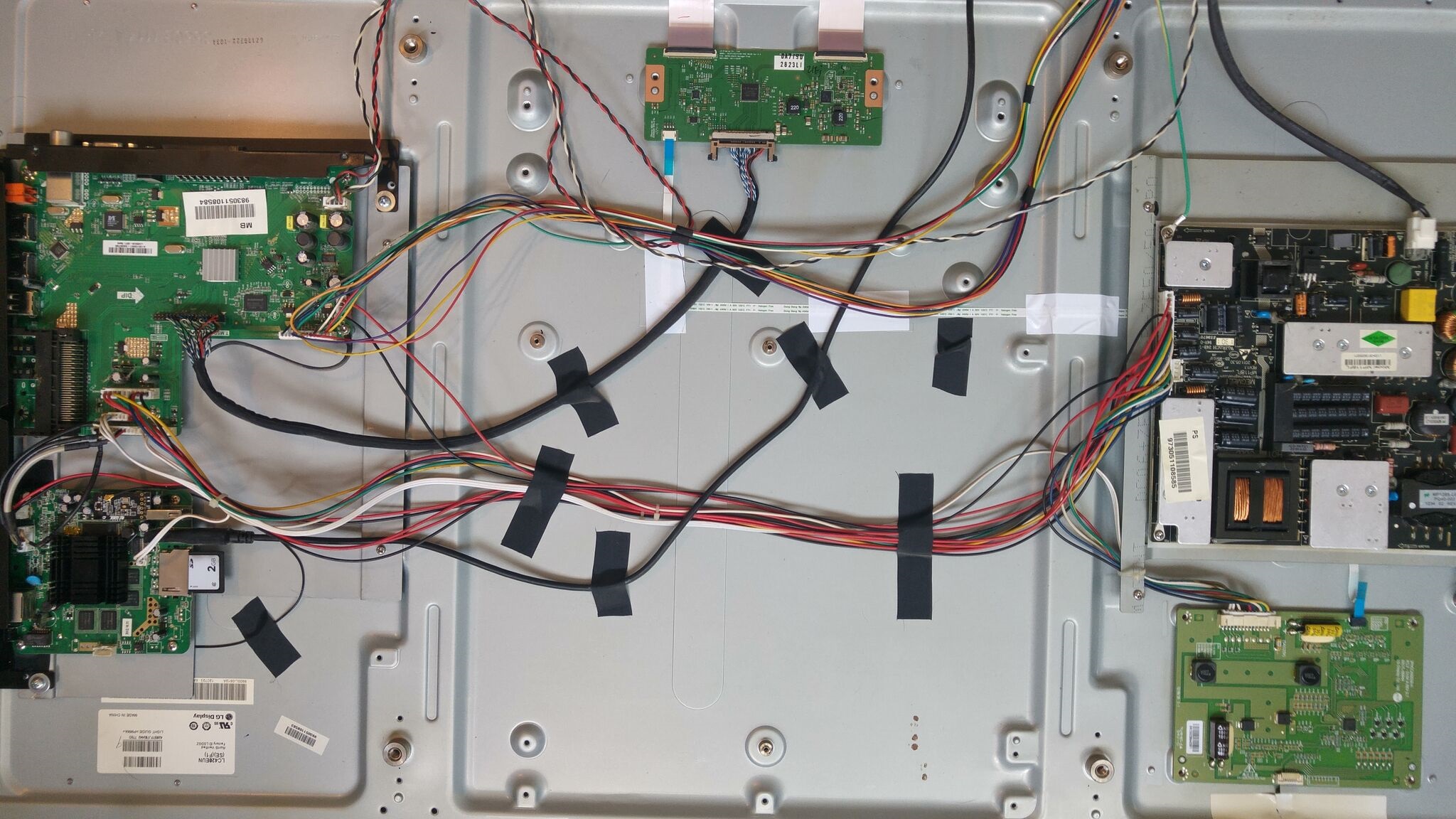

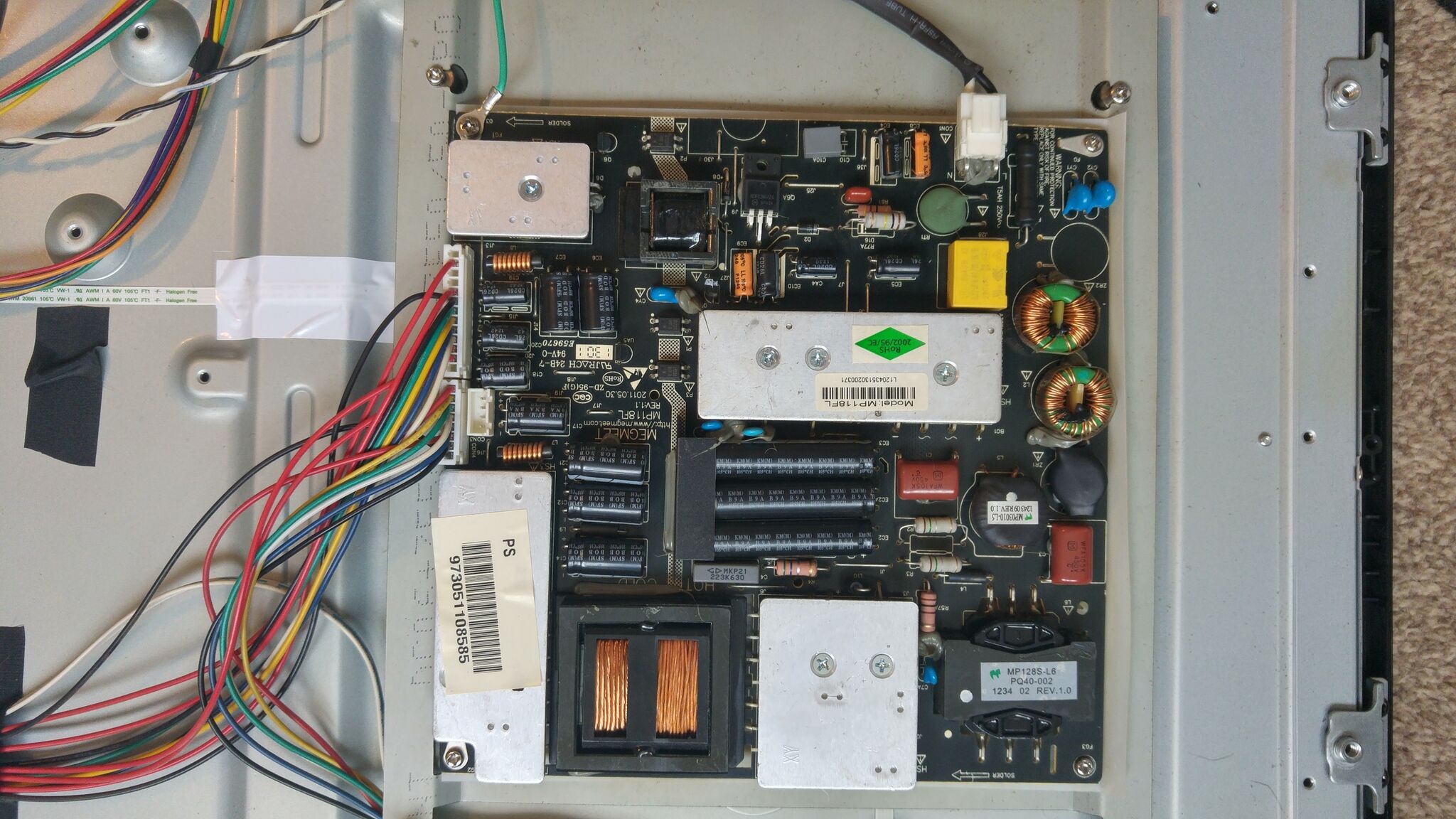

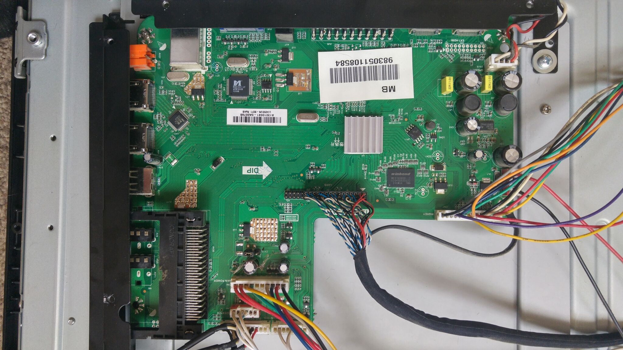

    Hello BadCaps Community my friend got this TV through Buy As You View, about 2 weeks ago the bottom half of the screen started going dark, i have reset it and checked energy saving and brightness settings but the problem still persists, when i turn the TV on it is fine but after 3-4 seconds the shadow appears. I have opened the set up and checked all the boards and reseated every cable. i suspect this is a panel issue. Any help would be appreciated.
    He has had the tv just over 18 months and his warranty has expired.
  • Andrew F. Ali
    • Jan 2014
    • 2450
    • Trinidad & Tobago
    Re: LG/Optica 7074c / 42" SmartTV
    Looks like bad backlights to me.
    • ReeceyBurger123
      Never Give Up !
      • May 2014
      • 7325
      • Britain

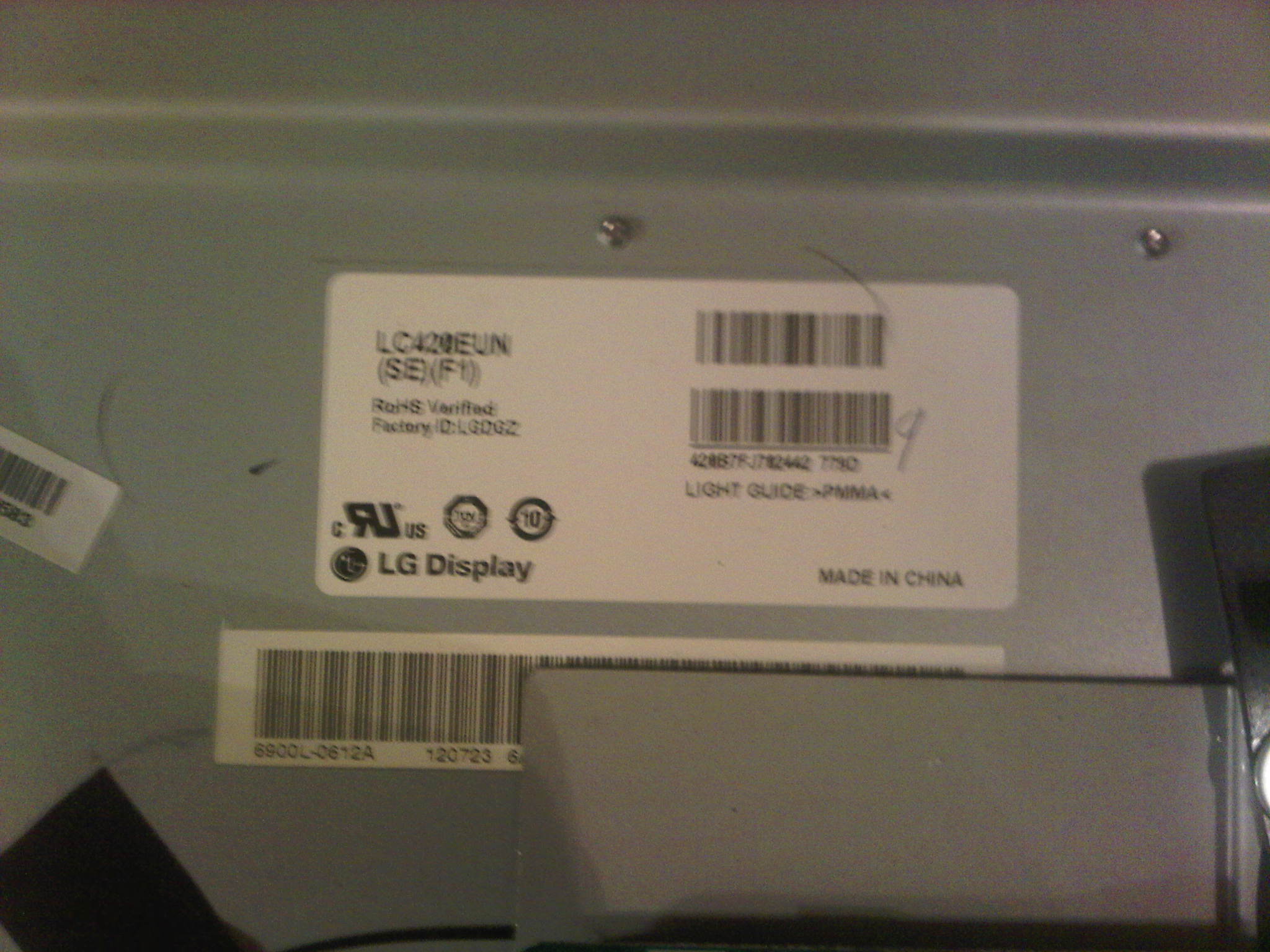

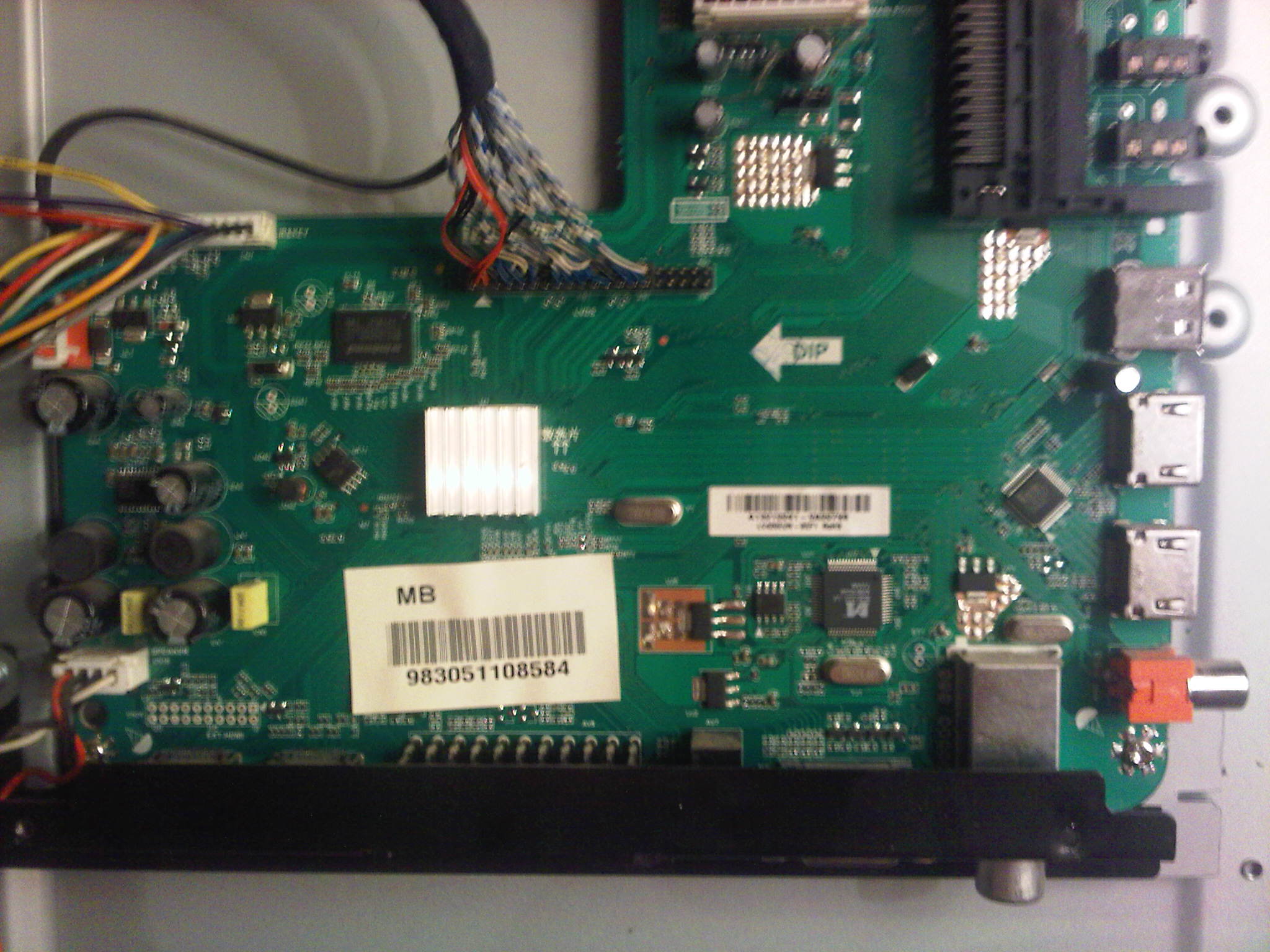

      Wheres Lg come from as well ? Nothing Lg about this I dont think. Also yes I agree with Andy Leds are out. Please post images of the boards.
        Its an LG panel, the TV comes on full brightness when turned on from cold but 3-4 seconds then it goes dark, i will post pics soon

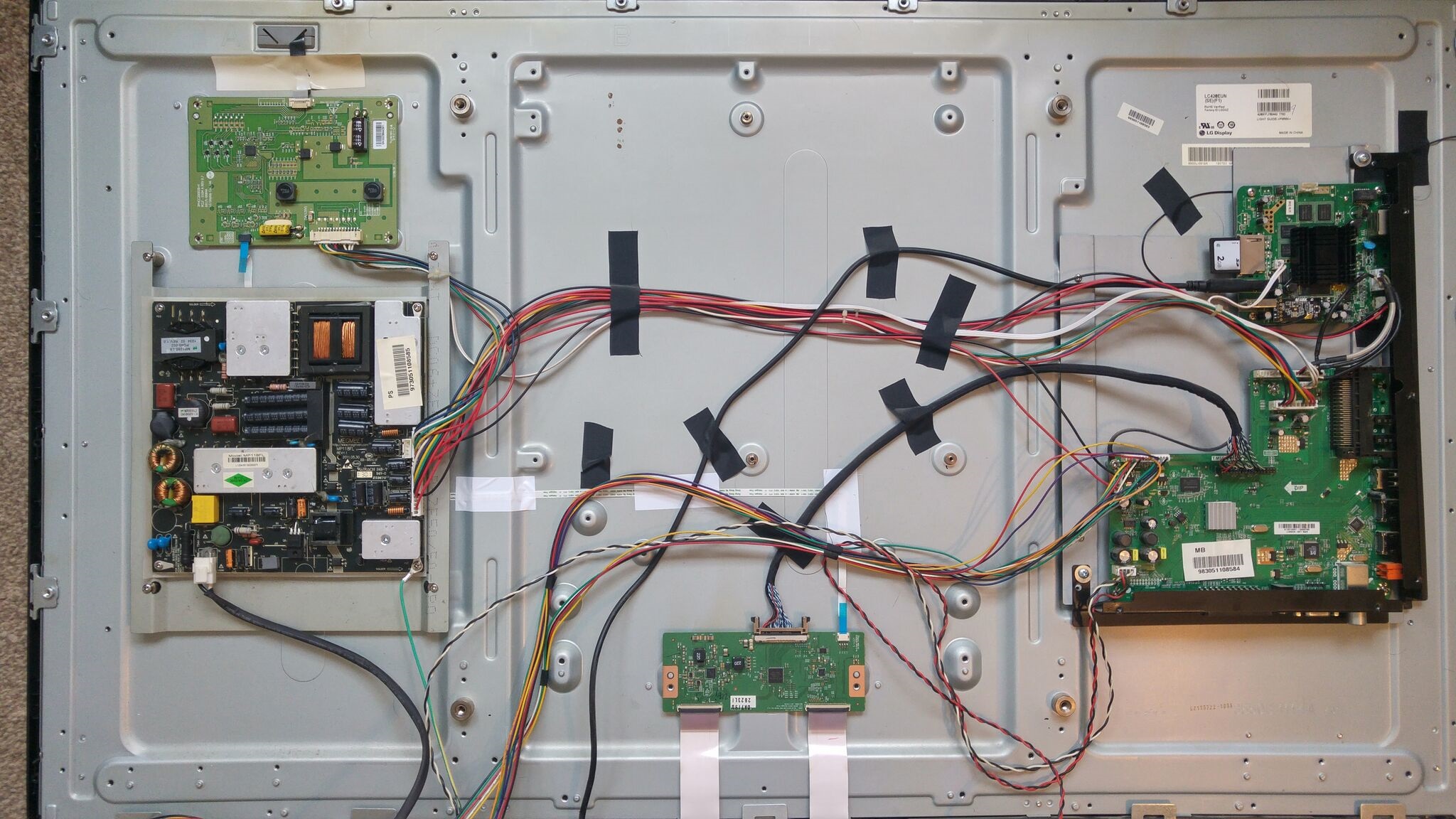

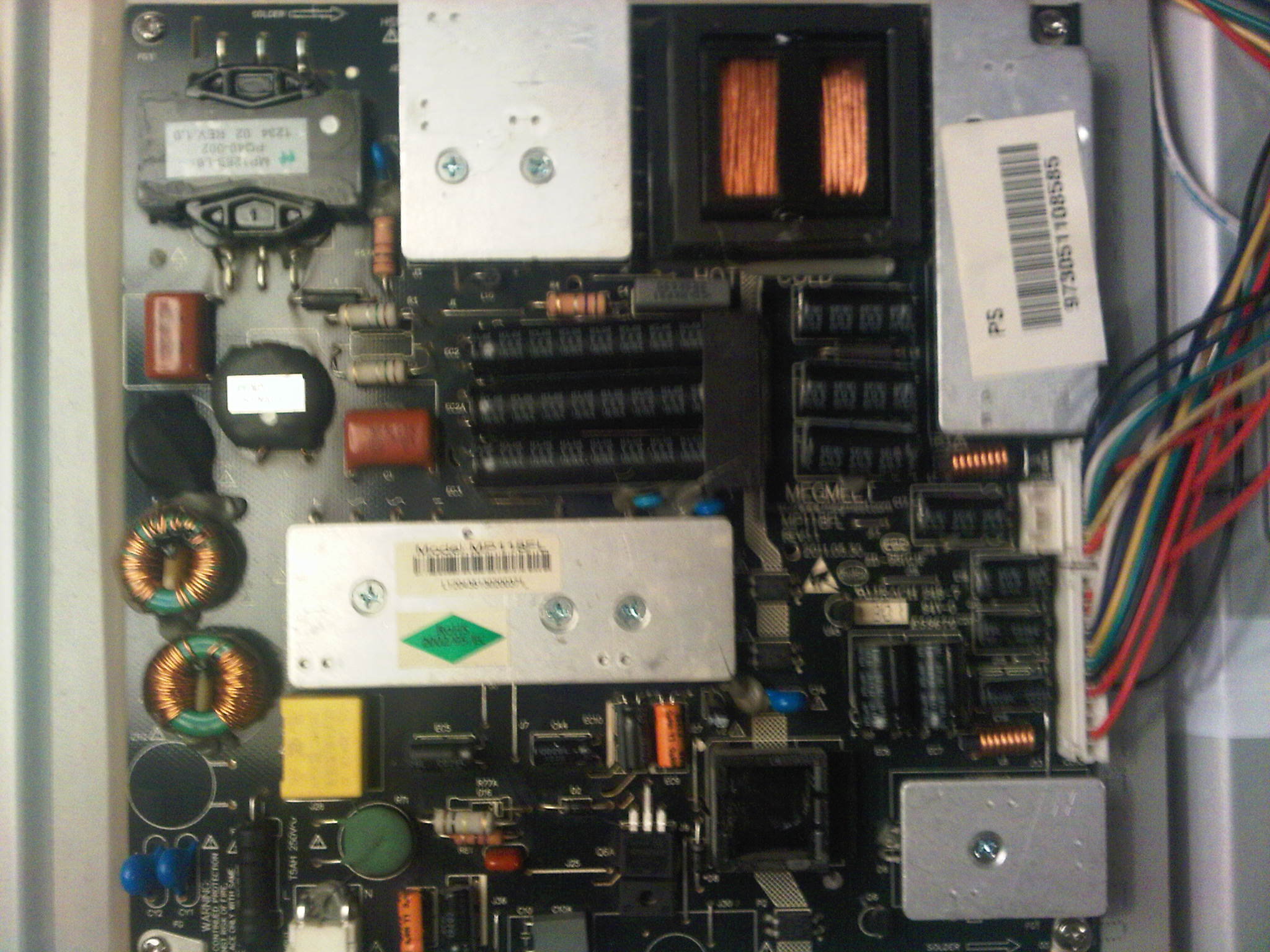

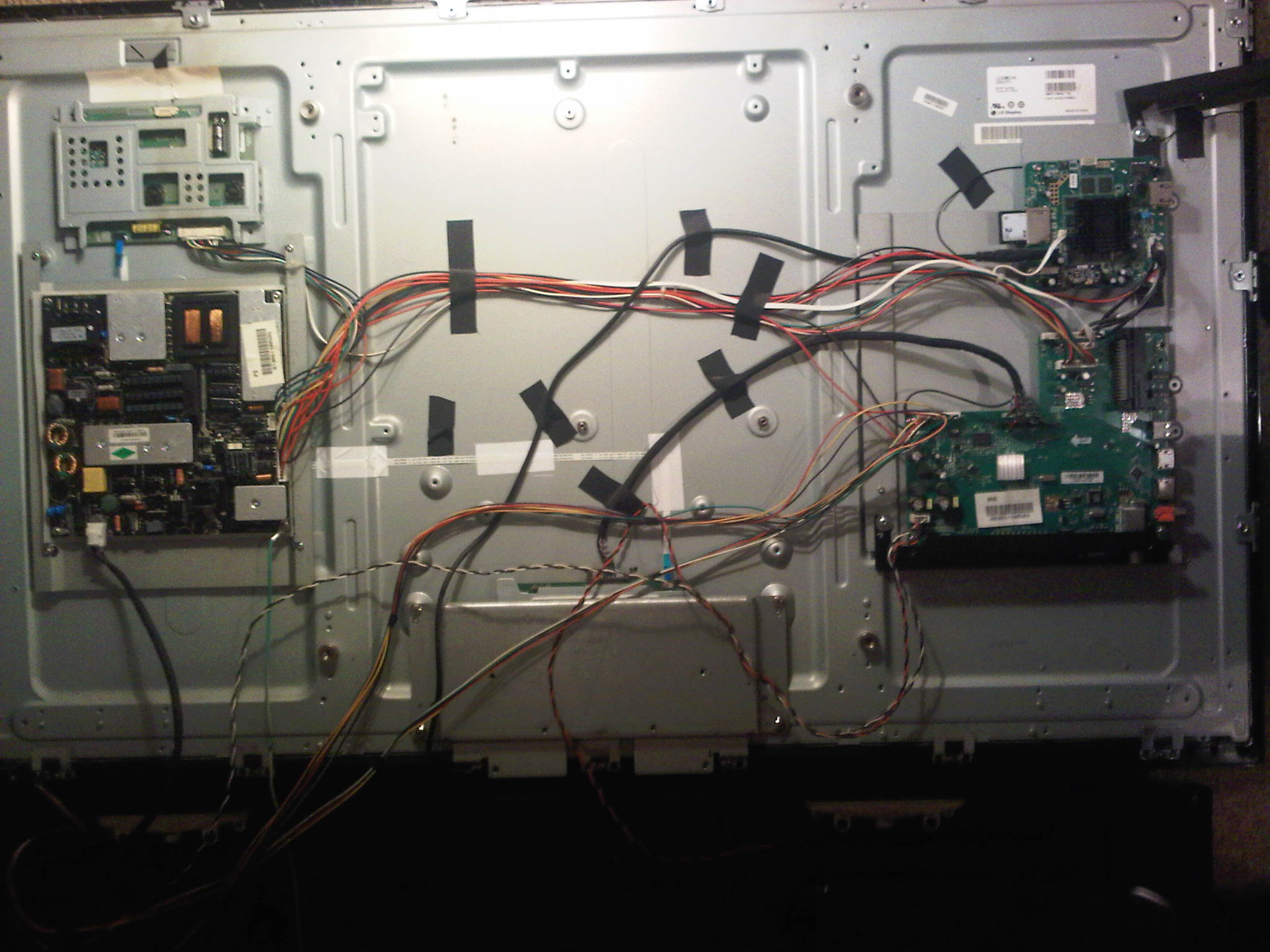

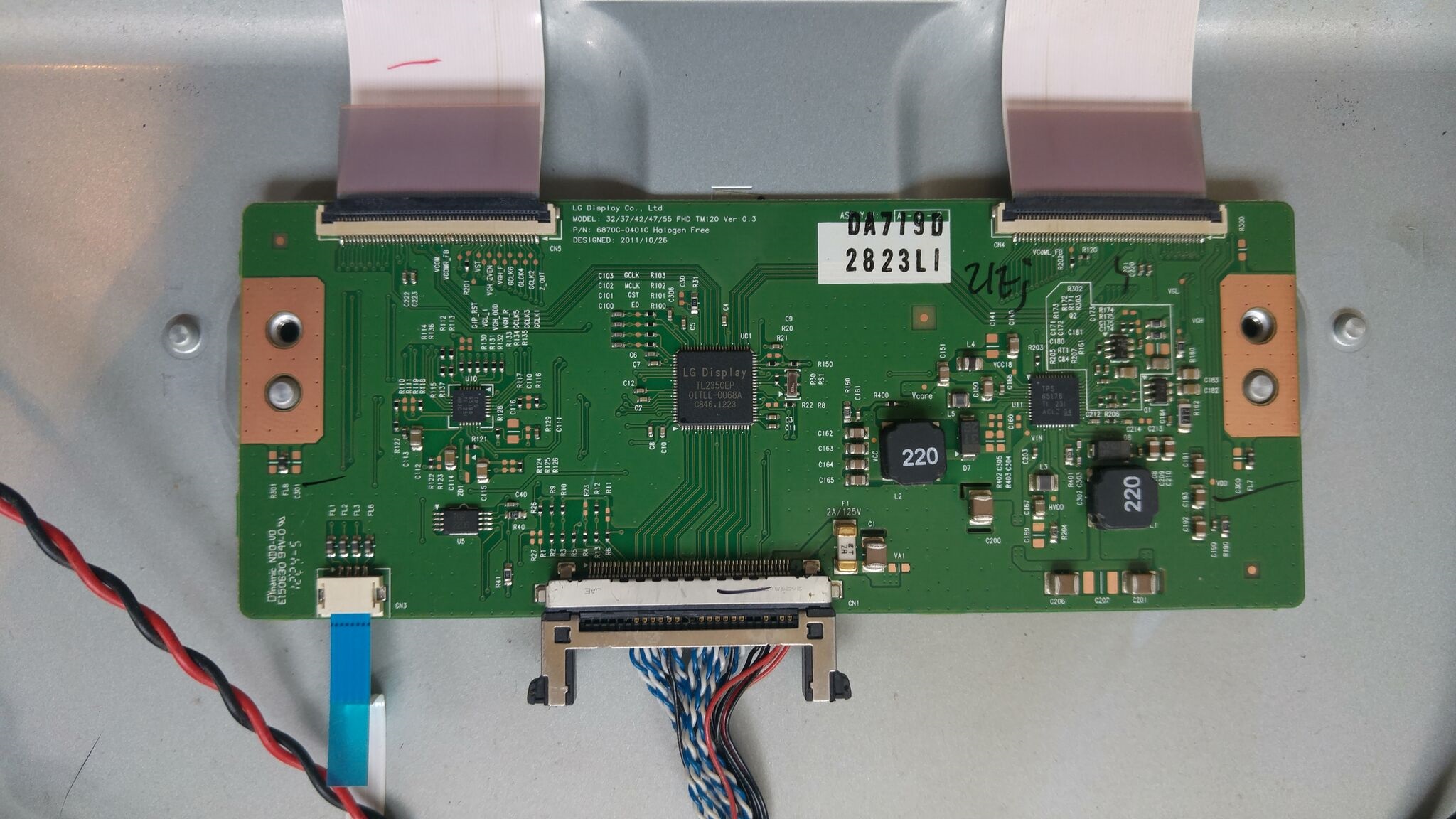

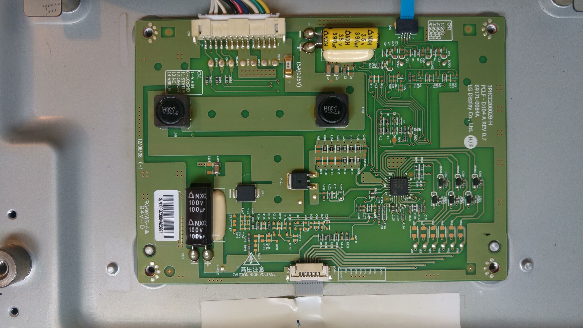

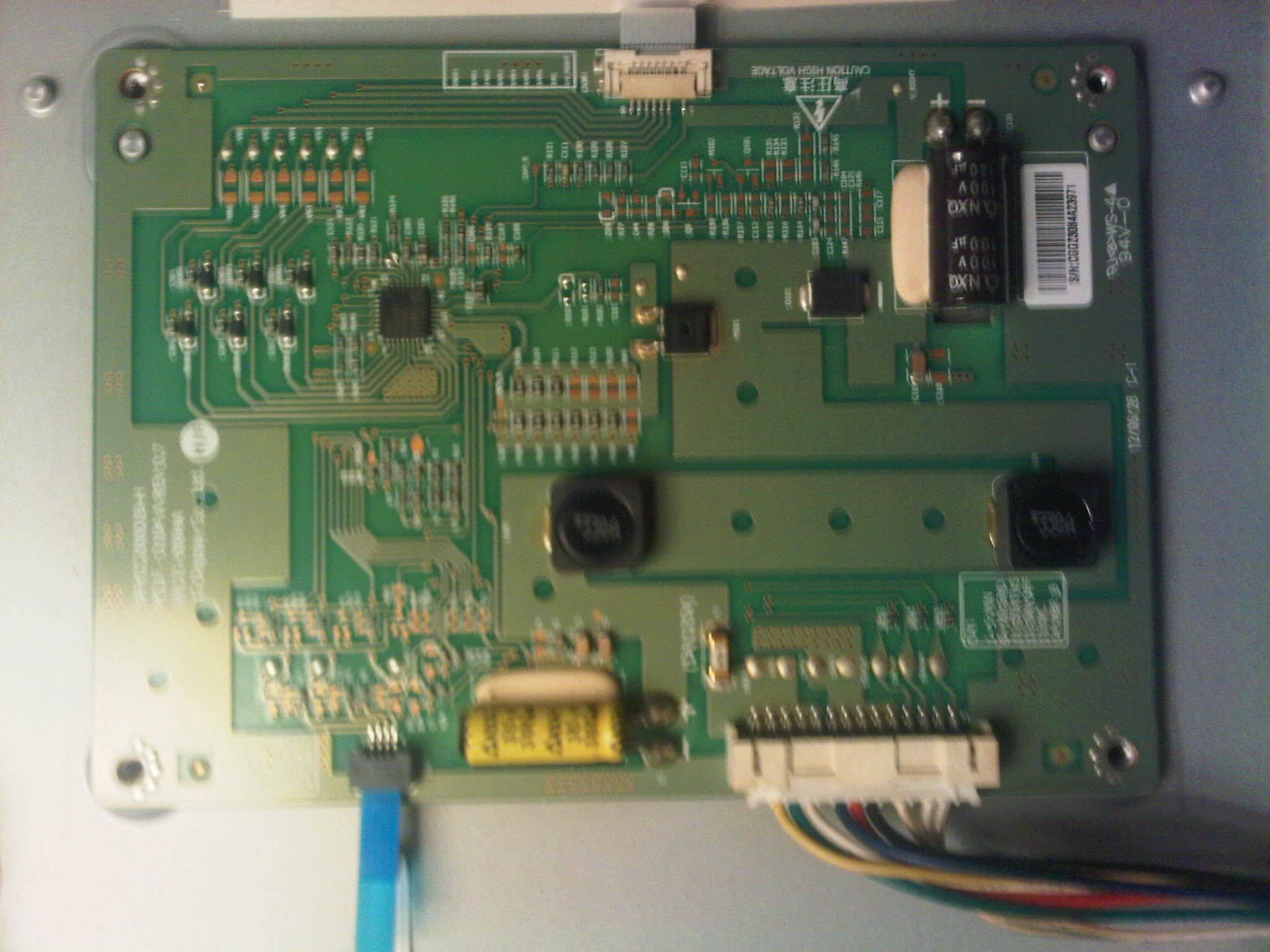

            Hope these help
              https://www.badcaps.net/forum/attach...2&d=1471877937
              Check the DCV on the test points VR 1~VR 6 with ref. to the chassis GND.
                Thanks Budm, when taking the readings the 2 coils on the inverter board were pretty hot, not sure if that is normal.
                VR1 - 0.8v
                VR2 - 0.7v
                VR3 - 0.9v
                VR4 - 1.1v
                VR5 - 1.1v
                VR6 - 1.0v

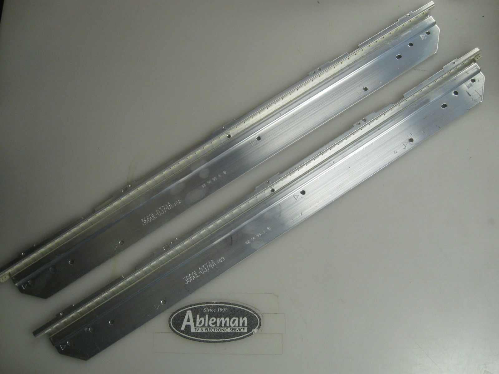

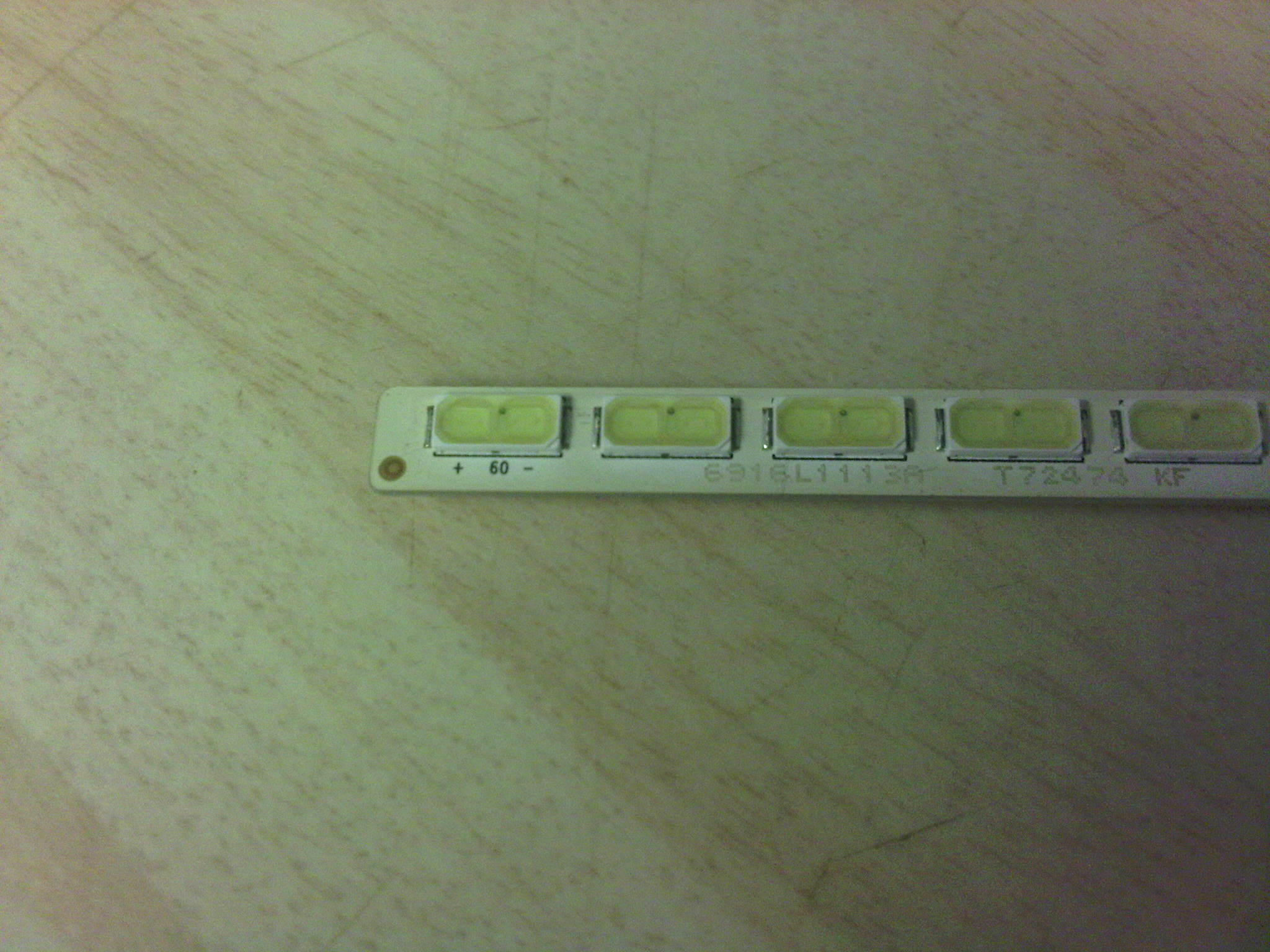

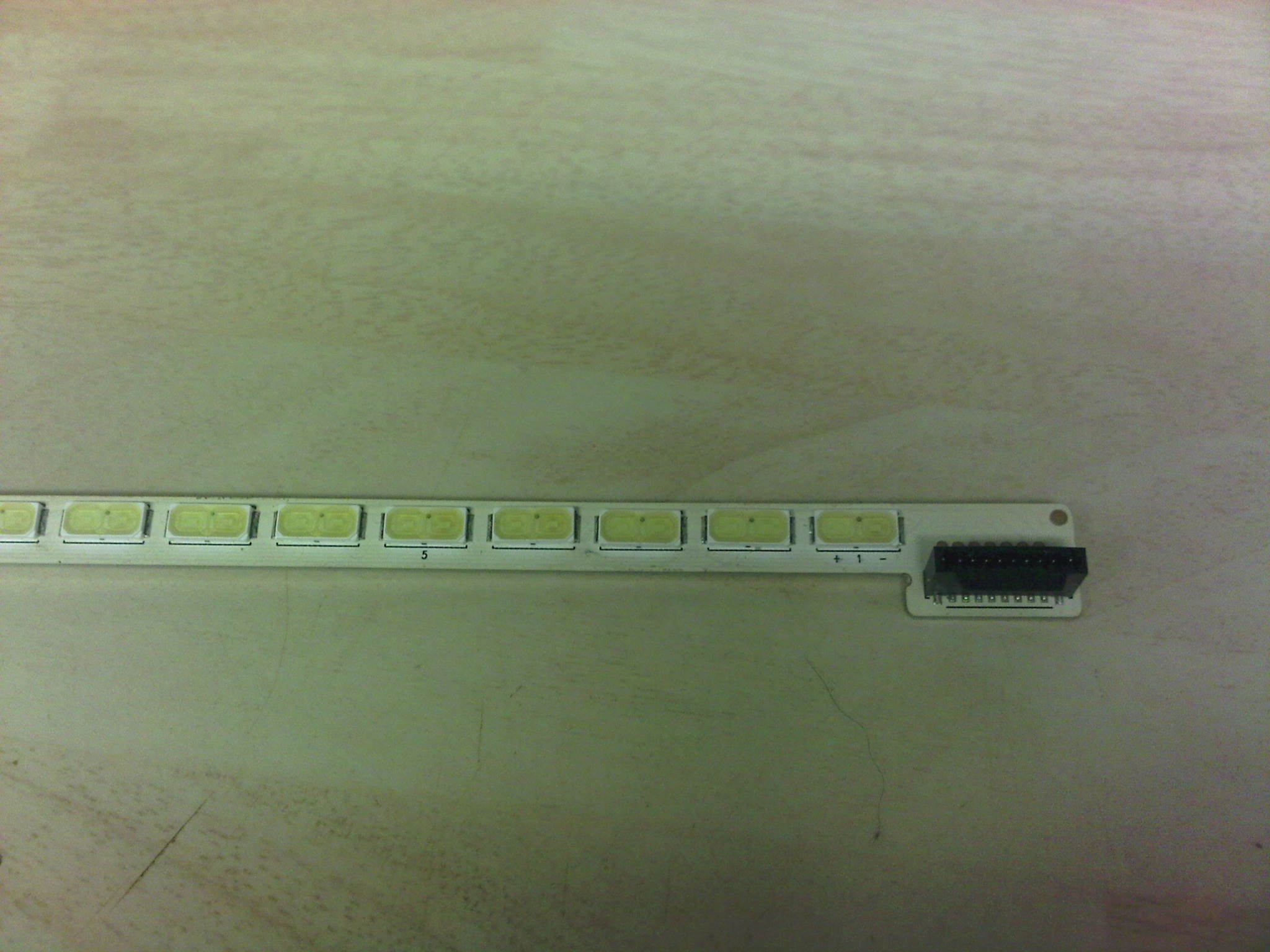

                  These are the LED strips that this panel uses

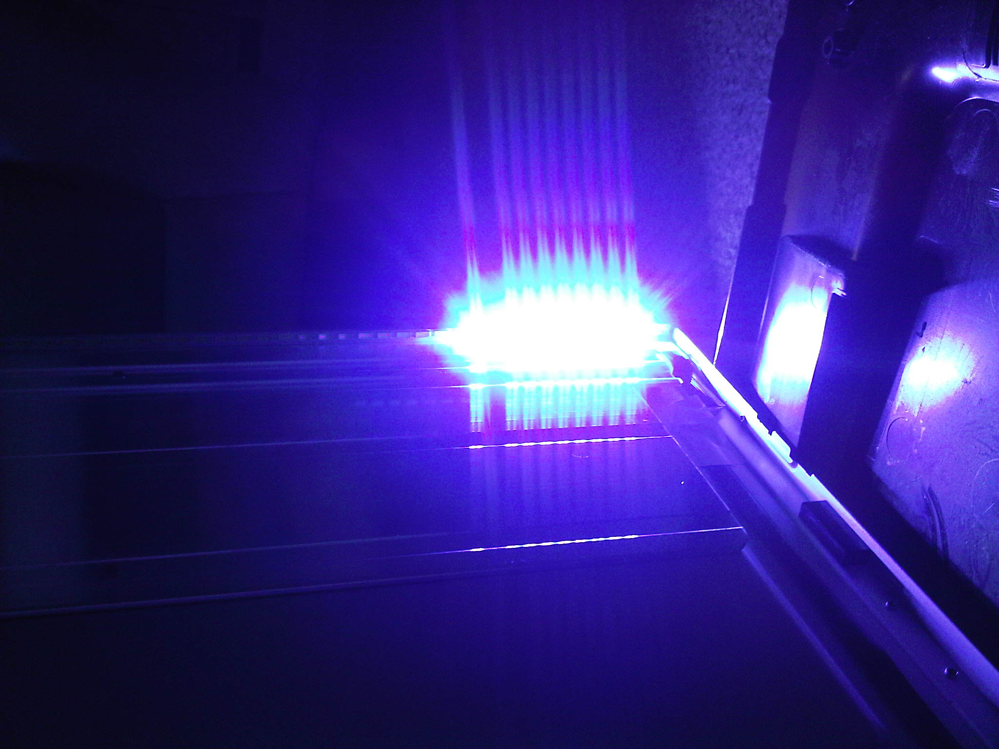

                    The bottom LED's are failing but the top ones are still working, i took the screen apart and 1 of the strips is dying but is this defective LED's or something else?
                      The reason that most of the TV with LED backlights have failed LEDs is due to the LEDs are being driven too hard close to or at the maximum spec with no regard to the ambient temperature so they failed. When you are done fixing the TV you should turn down the backlights level to as low as you can to extend the life of the LEDs.
                      I am surprised that the protection circuit did not kick in due to bad LEDs, may be they just do not care.
                      This is the Notes from LG LED spec:
                      Operating the LED beyond the listed maximum ratings may affect device reliability and cause permanent damage.
                      These or any other conditions beyond those indicated under recommended operating conditions are not implied.
                      The exposure to the absolute maximum rated conditions may affect device reliability.
                      Example of bad design in LG:
                      https://www.badcaps.net/forum/showthread.php?t=54197
                        I thought the TV had 2 banks of LED's but its only 1 strip with 60 LED's, they all light up from cold then most of them die and a few stay lit. as u can see in the picture 8 are lit then 1 is dead then the 10th 1 lit.
                        I have tested each individual LED with a battery and they all seem to work fine.

                          It looks like LG are not renowned for there backlights :o
                          Could a problem with the inverter cause these symptoms or would it be worth buying a new LED strip and hoping for the best?
                            Each bank has three set of LED string, that why you have VR1~VR6.
                              from yours photos i can say the LED are less than 60 on one strips as there are 3 groups of LEDs on each strip please check again, this LEd edge one 6 Volts, its crazy to be if one groups will be 20 LEDs
                              • badcaphunter
                                • Jan 2016
                                • 88
                                • England
                                Hey Diah, i have double checked and there is 60 LEDs on the strip, it is numbered in 5s up to 60

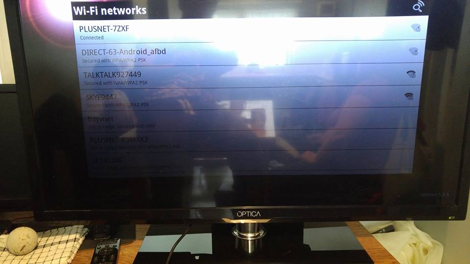

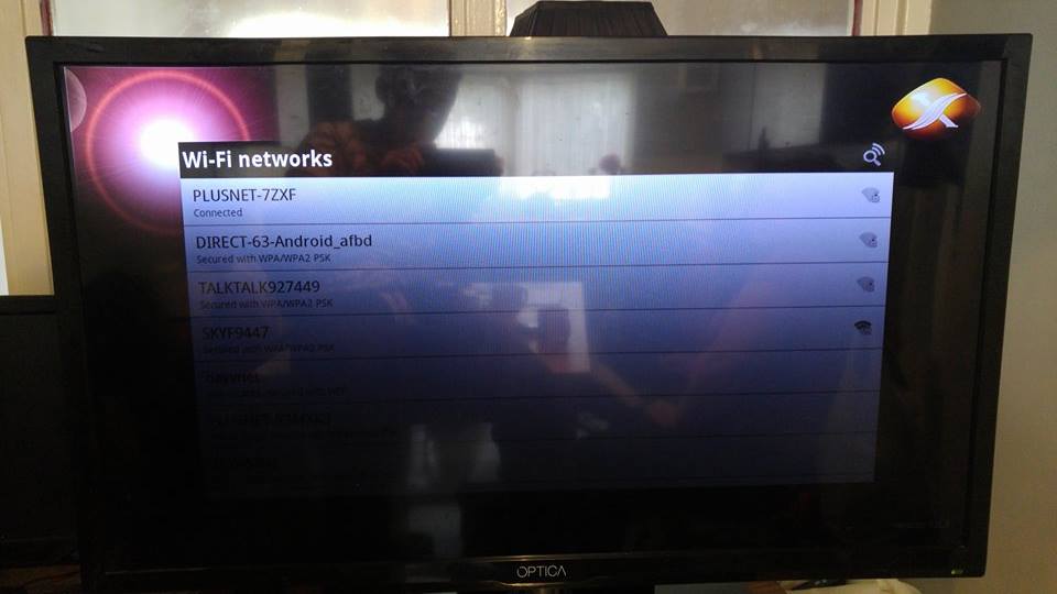

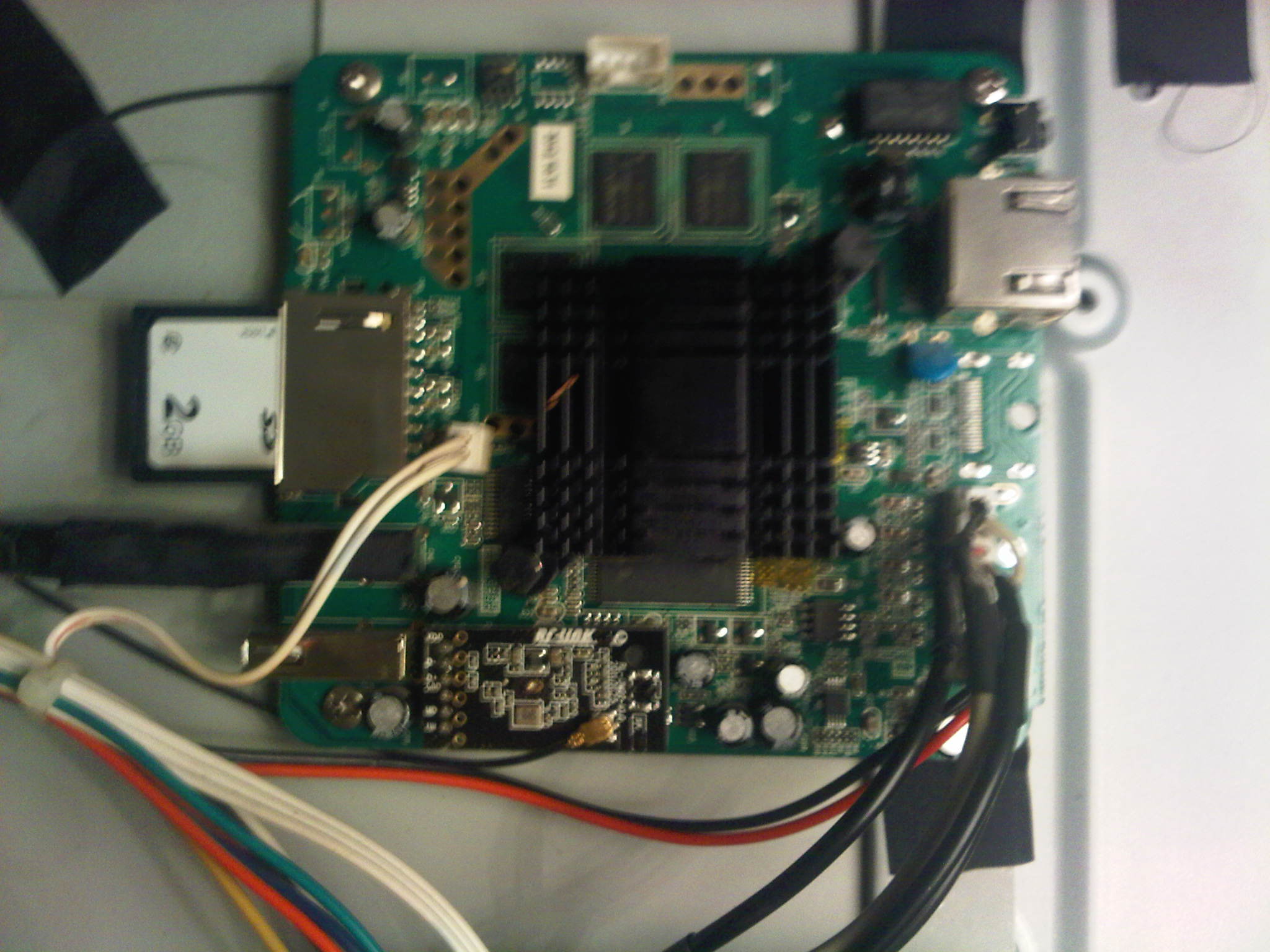

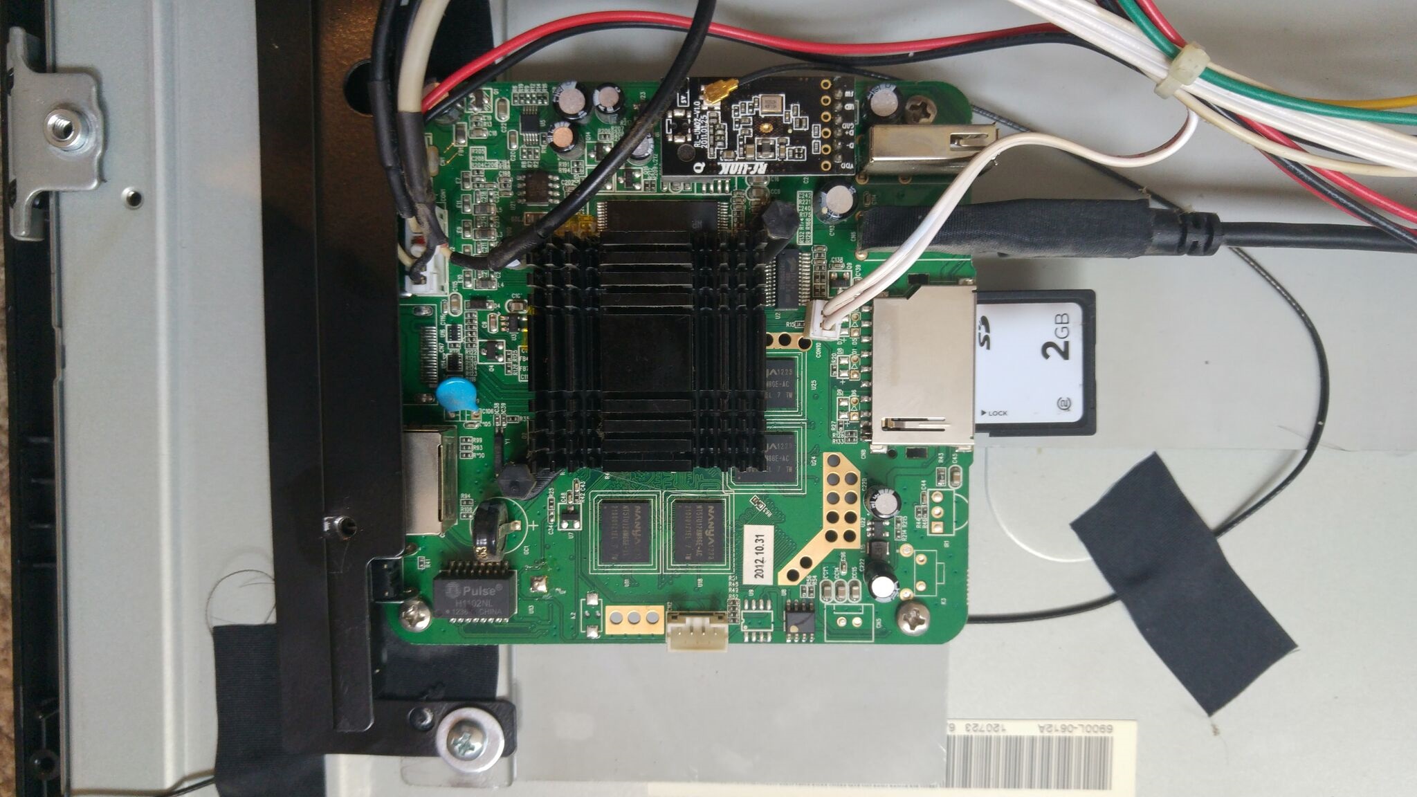

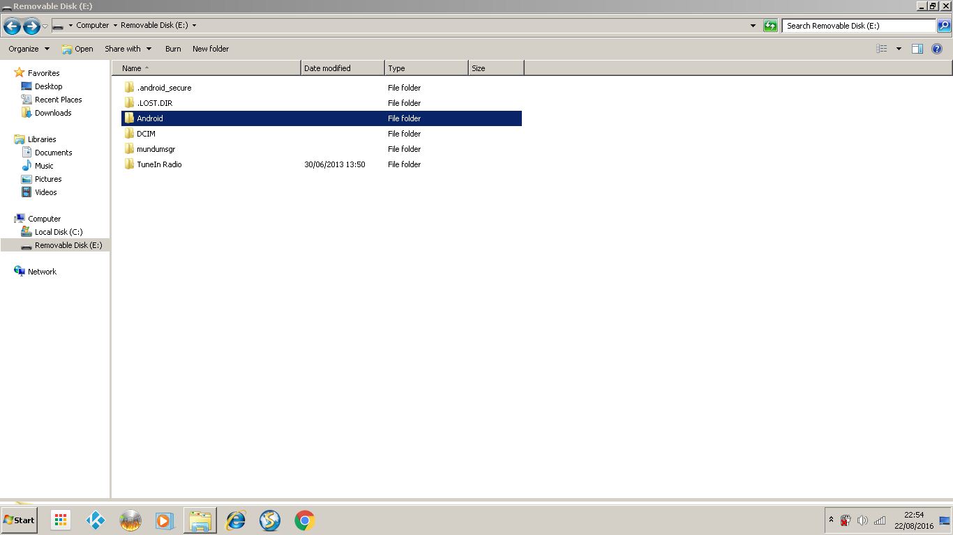

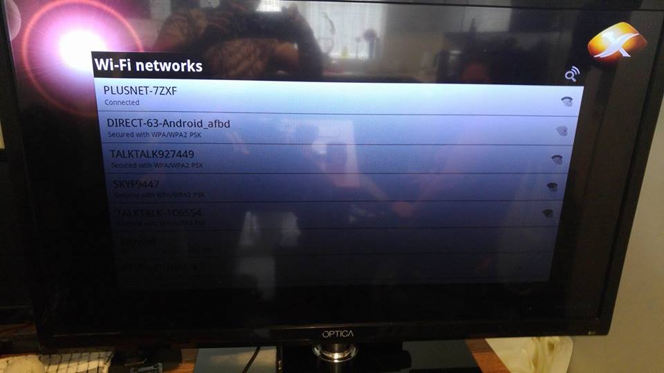

                                    dear friends,, yours TV set look like DIY TV , i will never believe on what printed on.. when you have booting firmware on 2GB SD card, you would believe on what printed ? lol check with finger 1.2.3 .4 sorry mat
                                    • Diah
                                      • Feb 2013
                                      • 6365
                                      it would be nice if you dump the total of SD card as zip and posted here... very interesting one.. did yours SET android firmware?
                                      • badcaphunter
                                        • Jan 2016
                                        • 88
                                        • England
                                        No but i think this was TV on finance so they could disable the TV remotely, it can be flashed to android if you know how, it still works without the sd card.
