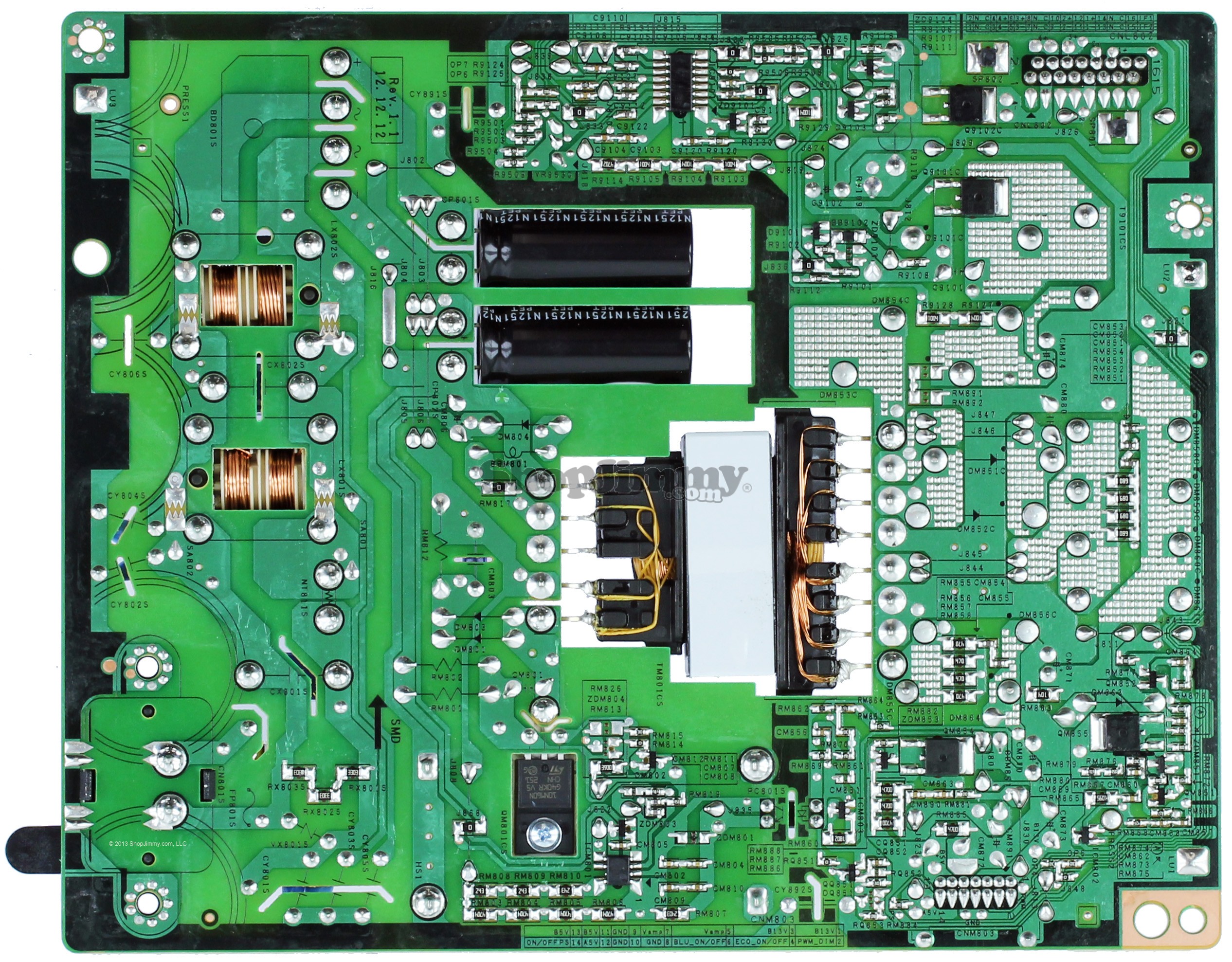

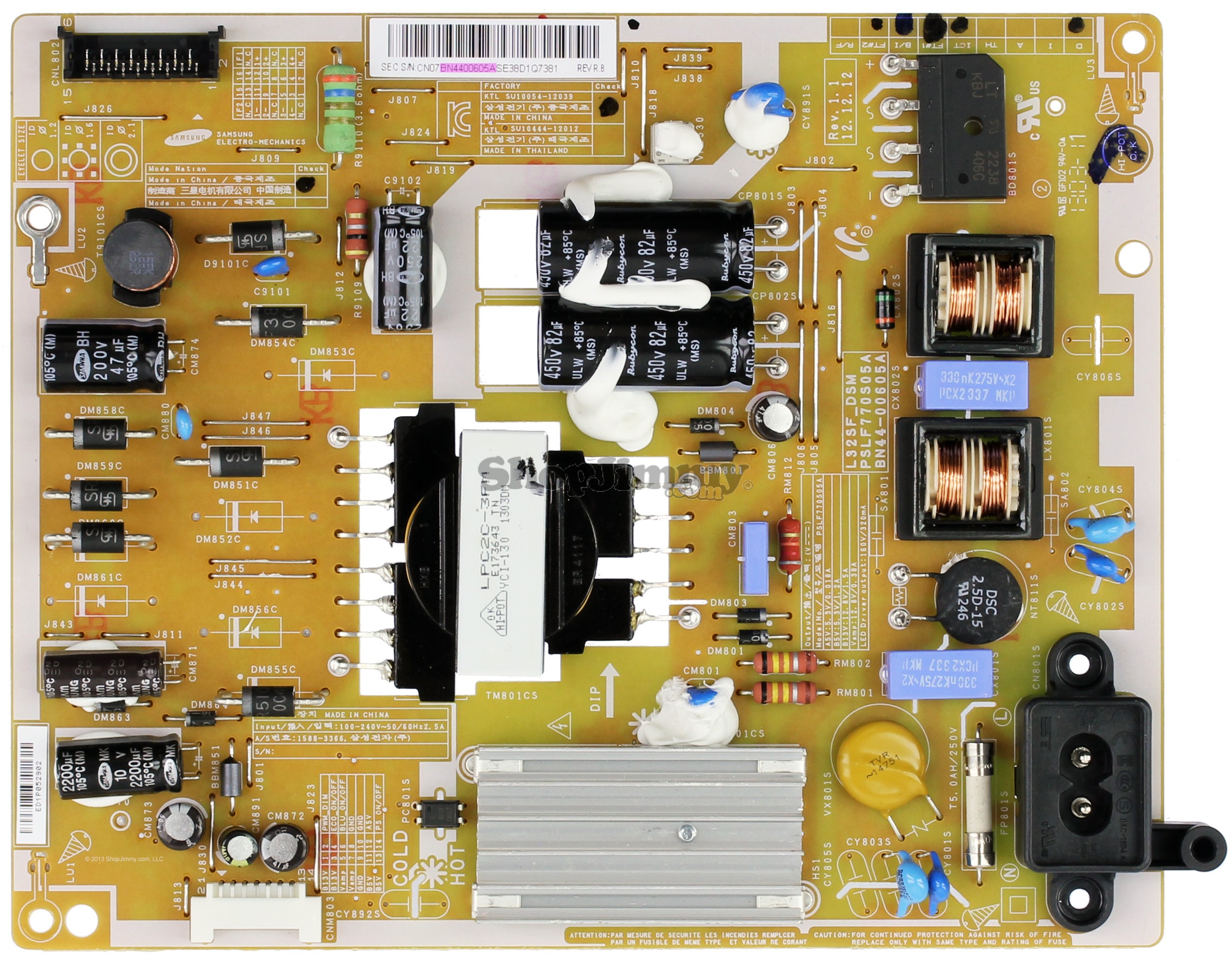

      Report the DCV readings of all the pins of the connector CNM803, make sure to put pin names and pin number in front of the DCV readings so we can see what we are missing.
      Pictures provided by shopjimmy.
