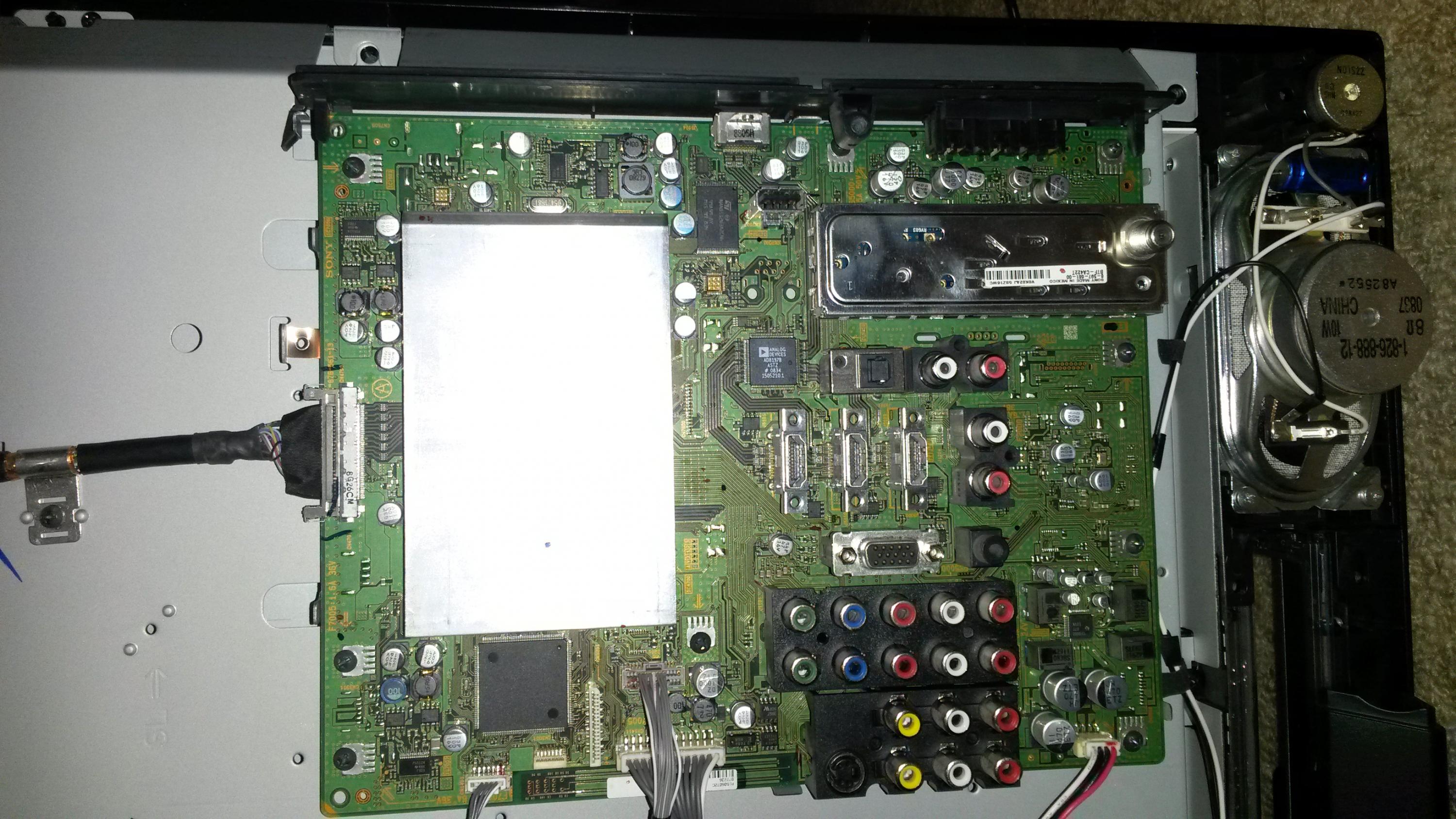

    Hey guys, I'm trying to repair this TV that does absolutely nothing. No LEDs, no clicks or whines or anything, I've tried both the remote and the physical power button. Apparently Best Buy diagnosed it as a bad power supply but I'm not convinced that's the case. The 3.3V standby from the power supply to the main board is good, so from a bit of searching the main board is the more likely culprit. Suggestions on where to check from here would be greatly appreciated, if you need more details or pictures or anything at all from my side just let me know

      If you have standby voltage going to the main board and the main board does not respond, then you certainly have a main board problem.

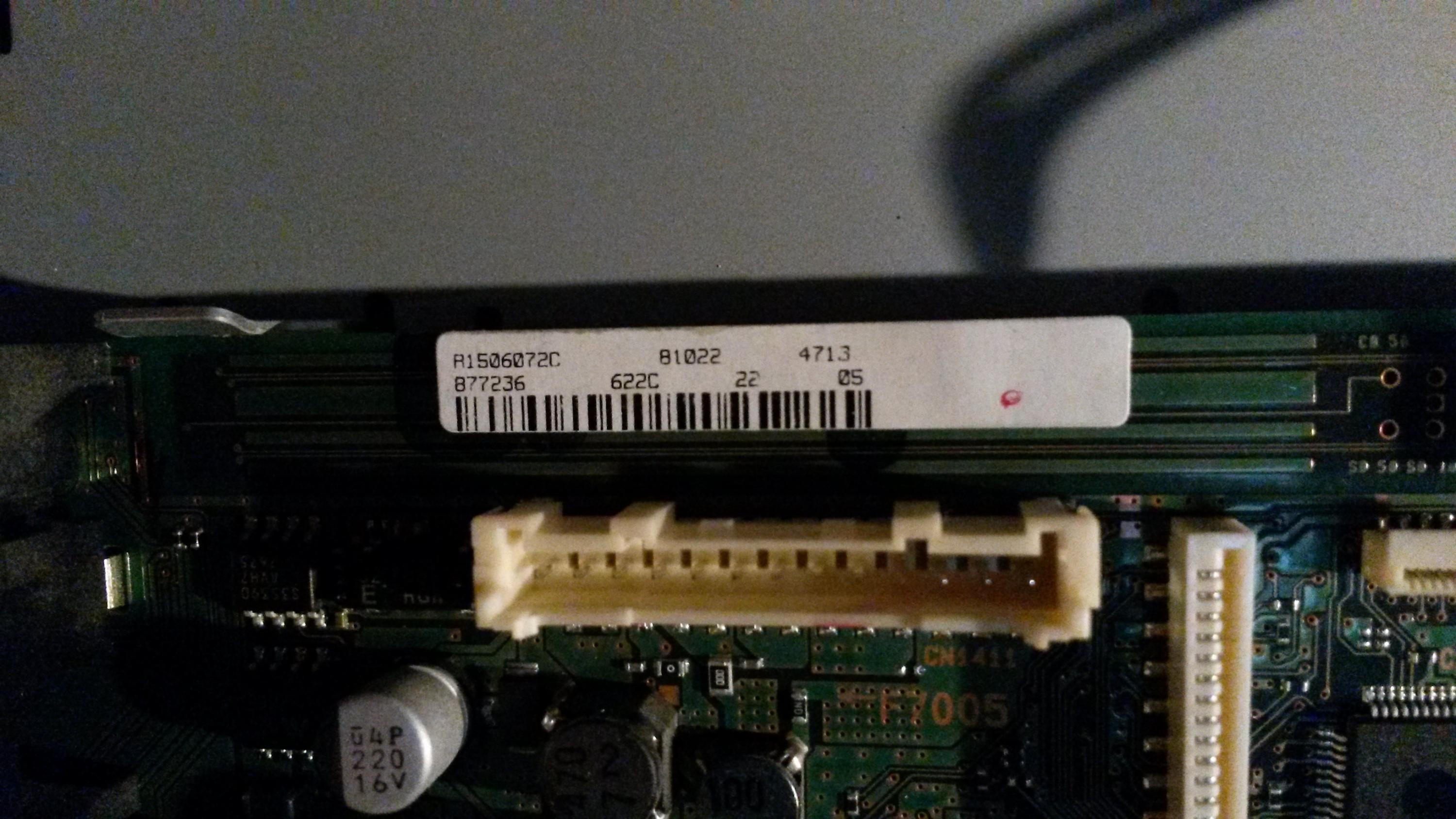

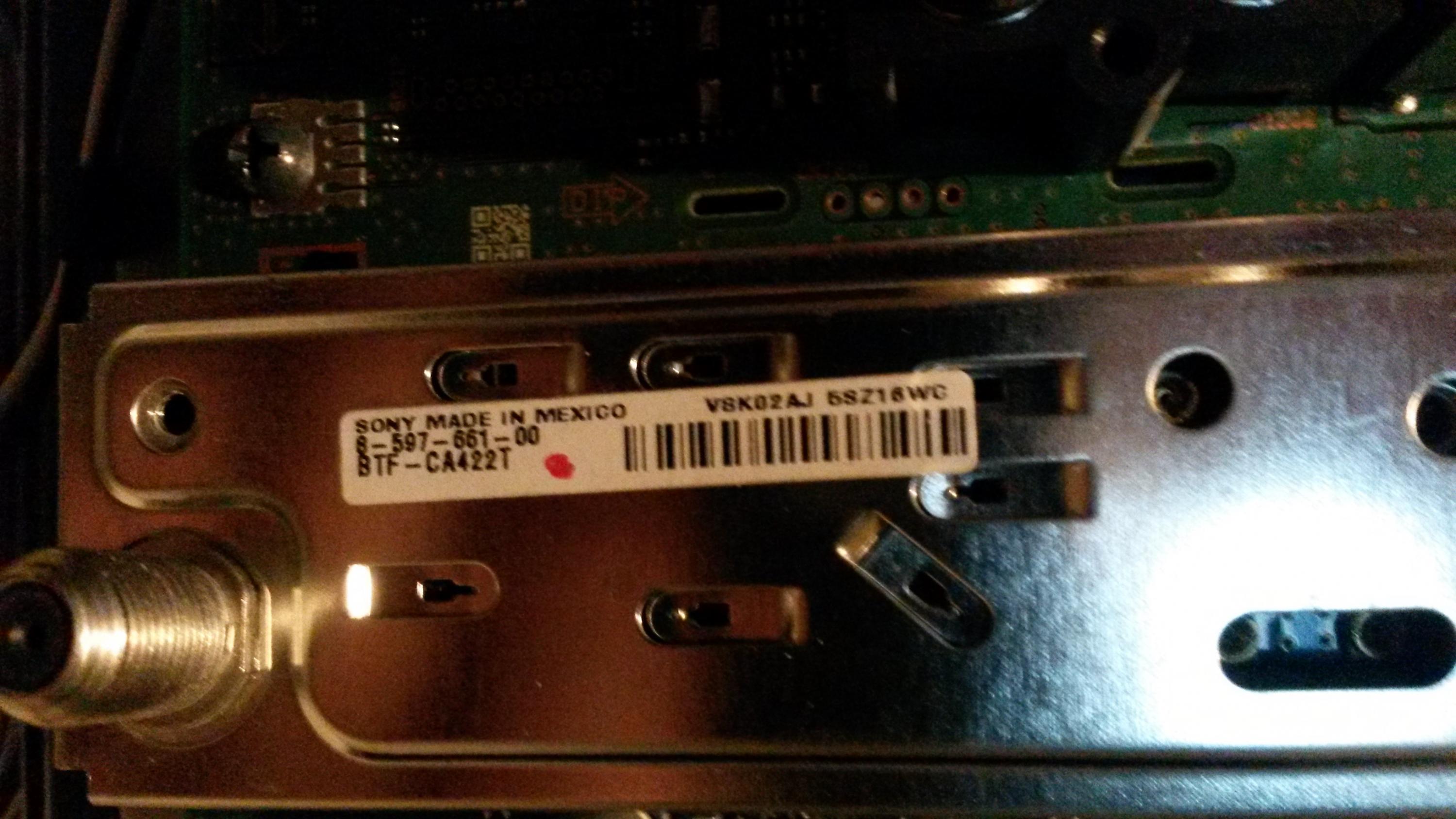

        Re: Sony KDL40W4100: no signs of life?
        Ok good to know, thanks! What's my probability of success trying to troubleshoot and repair a main board? Decent odds or pretty much hopeless?
        Here's the two stickers on the board, I'm not sure if the sticker on the tuner just applies to the tuner or to the whole board. Apologies for the less than stellar pictures, all I have is my phone. I can type up any of the letters/numbers that are unclear if needed.

            There isn't much you can do with a broken main board. You'd need a hot air rework station and a schematic. As for now, all you can try is to hear up the main board with a hair dryer and see if that brings it to life. You can also try freeze the board (can of air upside down) and see what that's gives. You can also check that none of the power rails on the main board are shorted to GND and that the voltage regulators are giving proper voltage. The main IC usually does all the turning on, off etc. So chances to repair that board is slim.

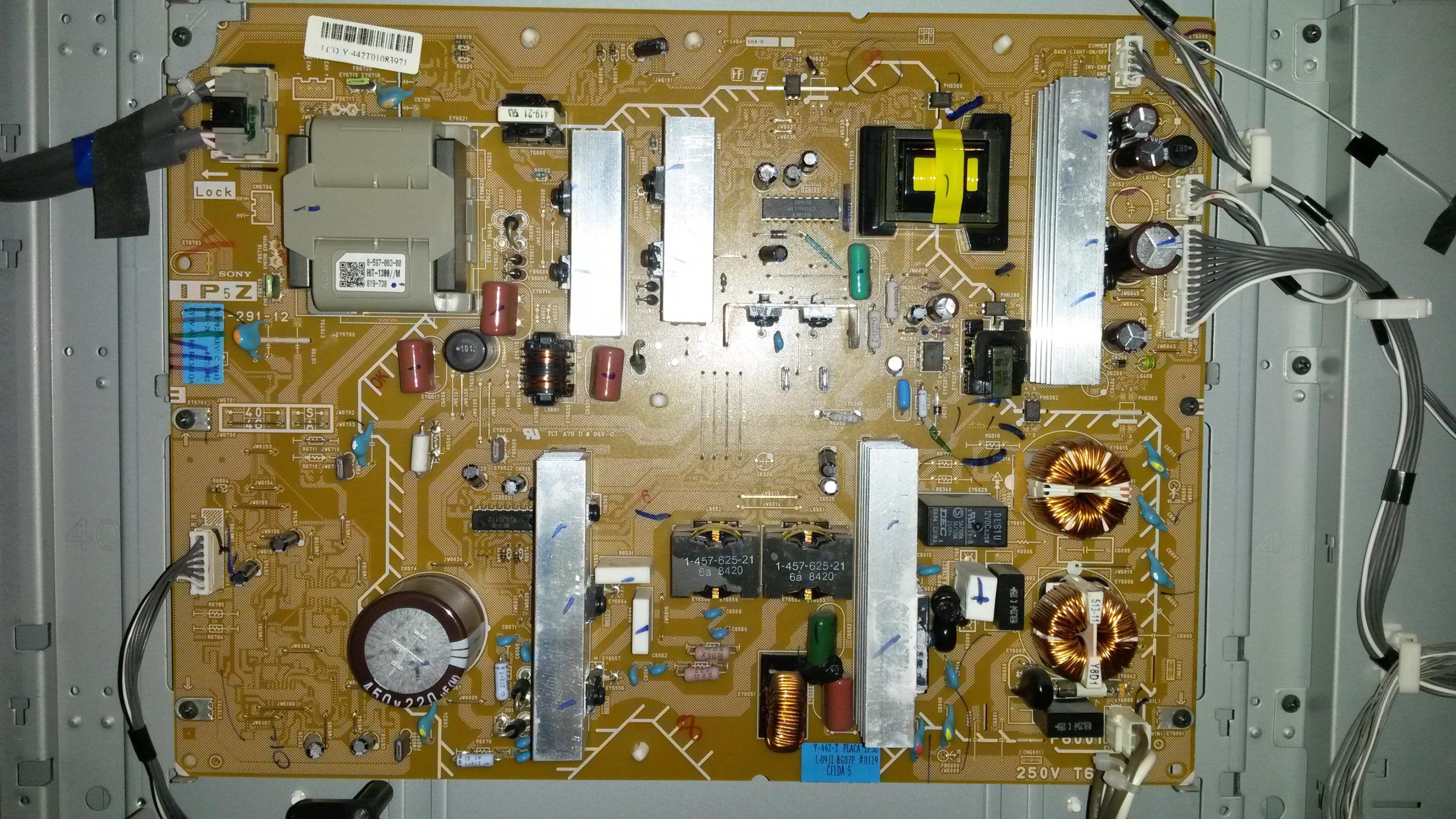

                    did you check underneath the power supply board for any charring/burning? I once spotted some charring on one of the transformer legs and exploded the solder off it. Luckily no components were damaged, just a quick resolder did the trick.
                    • whyexactly
                      • Apr 2014
                      • 28
                      I hooked up the resistors and all the 12V and 15V pins going from the PSU to the main board have the correct voltage, the only pin on that connection that I don't know what to expect on is called AC_OFF_DET. I ran out of time so I'll check the backlight this evening. I know they're a high voltage but the schematic doesn't show what the actual voltage is supposed to be.

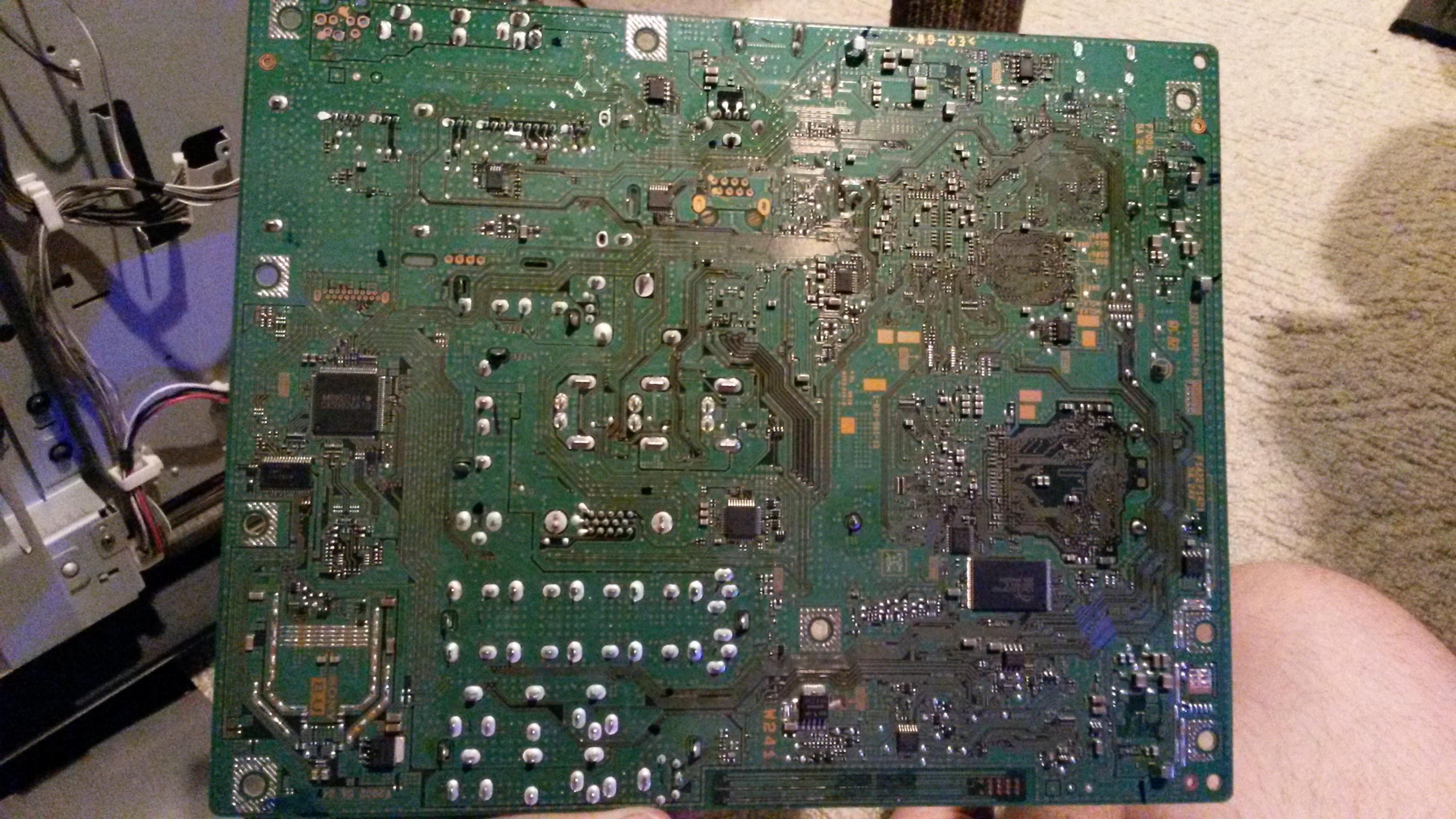

                        What is the all the dark looking stuff covering quite if the bit of the board in attachment 136762?
                            There doesn't look to be anything on it, that's just how some darker sections of the board turned out in the picture.

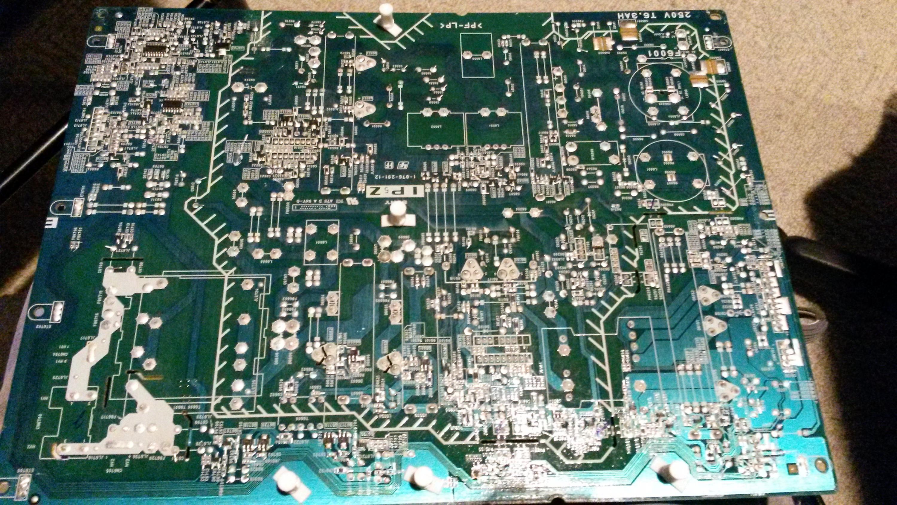

                              AC_OFF_DET read no DC voltage, and HV1 to HV2 only read ~6.4VAC on the PSU side with the backlight unplugged, so I'm not sure if I'm doing something incorrectly as that doesn't exactly seem high. I noticed there's a "DIMMER" pin next to the BLon pin so I'm not sure if I need to do something with that as well.
                              The PSU looks to be good on the back side, again apologies for my crummy phone camera, it's very hit and miss on quality.
