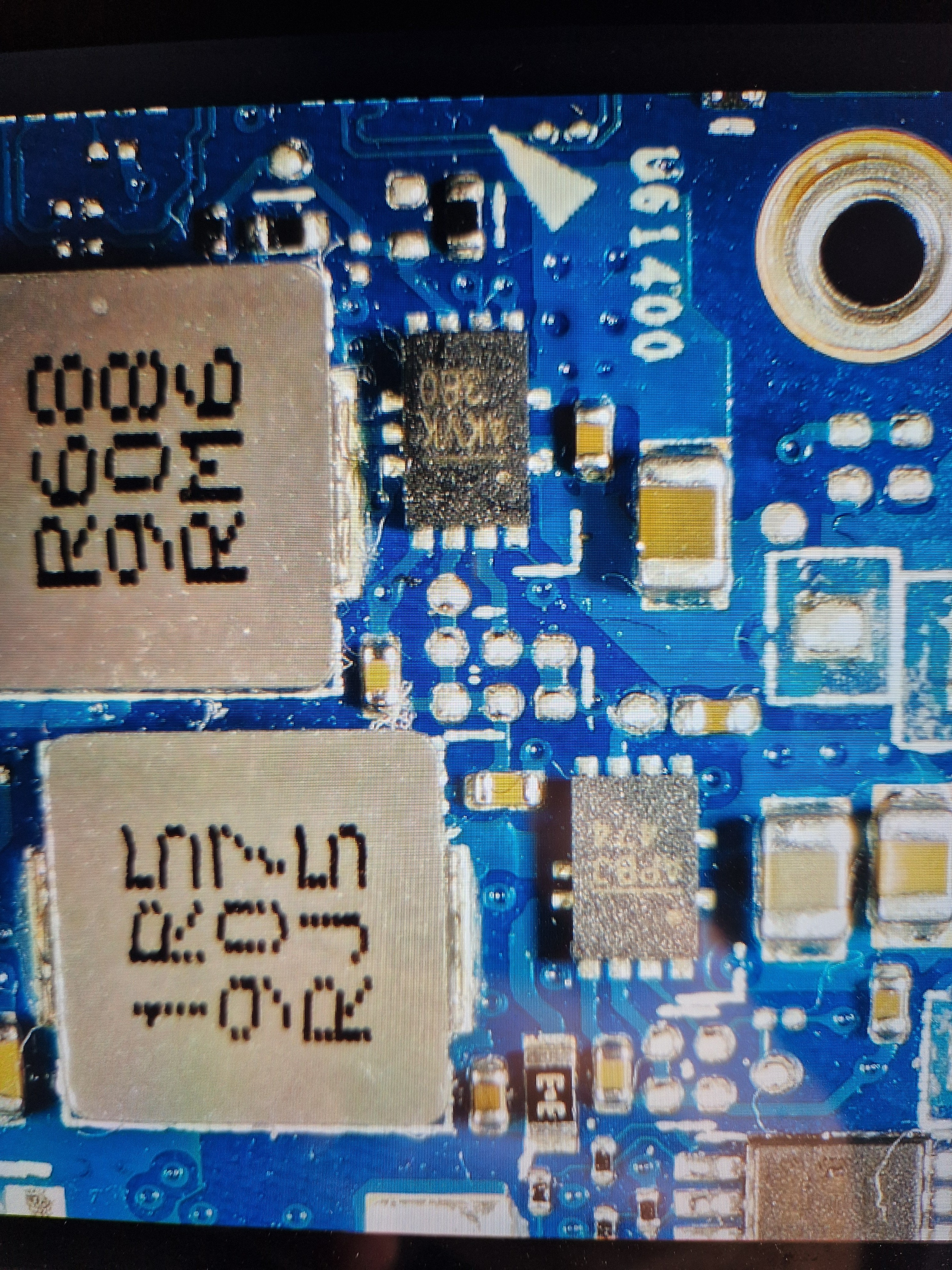

    the ACOK ? pin 24 FRWPG (pin 24) am ISL9538h is low with 0V
    but i dont know why
    i cant really understand what the mosfets in the pictures are doing for crazy things.
    i measuered voltage on coils....but now on mosfets near the coils too and they all had more than 10v i think one was there with 8v or something....so i think the cooils would have voltage, if the mosfets there will eb triggered
    bios has no voltage on it. but maybe this is normal i read ? it gets voltage if computer is turned on ?

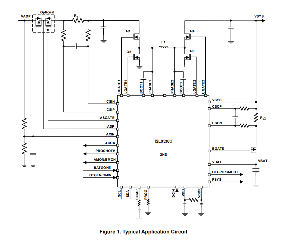

    VSYS is the feedback pin for the main power rail to the logic board.
    A partial datasheet is shown here:
    Click image for larger version  Name:	partial.png Views:	0 Size:	81.3 KB ID:	3519657
    The main power rail is not a valid voltage. Remove all power. Meter in resistance mode.
    Measure the resistance to ground at VSYS on the charger IC which is the same as the main power rail. What is the resistance in ohms? This check is to confirm if there is a shorted part on the main power rail.
    Once the main power rail is normal, this higher voltage will be used to create always on power rails including 3v3 and 5v0 - one of these rails will most likely be used to pull-up the open-collector ACOK signal. That is, the charger IC is receiving the adapter voltage but is unable to raise this ACOK signal to a logic high. Instead, the pin is floating and requires an external voltage to park this floating pin to a voltage level which is often from another regulator on the board. That regulator is not yet powered.

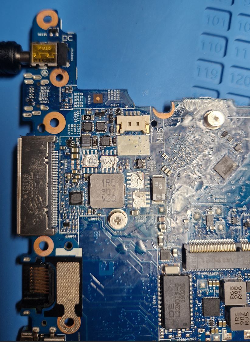

          i don´t know what happeneed but i get another reading now
          i was wondering about the boot and phase values and searched for the capacitors....is this strange.
          here are the updated readings ion the picture
          the mosfets have crazy effects during measurement. some valueas are different if i change + and -

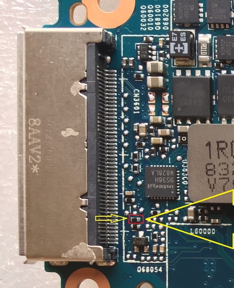

                    can somebody help me with the schematic ?
                    pin 13 ASGATE of IS9548h is shortet to BOOT1
                    but i can´t find where ASGATE is connected to ?
                    i ordered the IS9548h and Mosfets AON6380. thes are the 4 ones
                    or do you mean the 2 before could be faulty too ? they seem to pass the input volatage perfectly... they are SM3335p
                    i think the ASGATE is wrong in my picture....got the picture from a youtube video ? in the datasheet its calld ADPS: Reverse output voltage feedback. Use a resistor divider externally to configure the reverse output voltage
                    where from get the first 2 mosfets on the board triggered ? found no link on the board

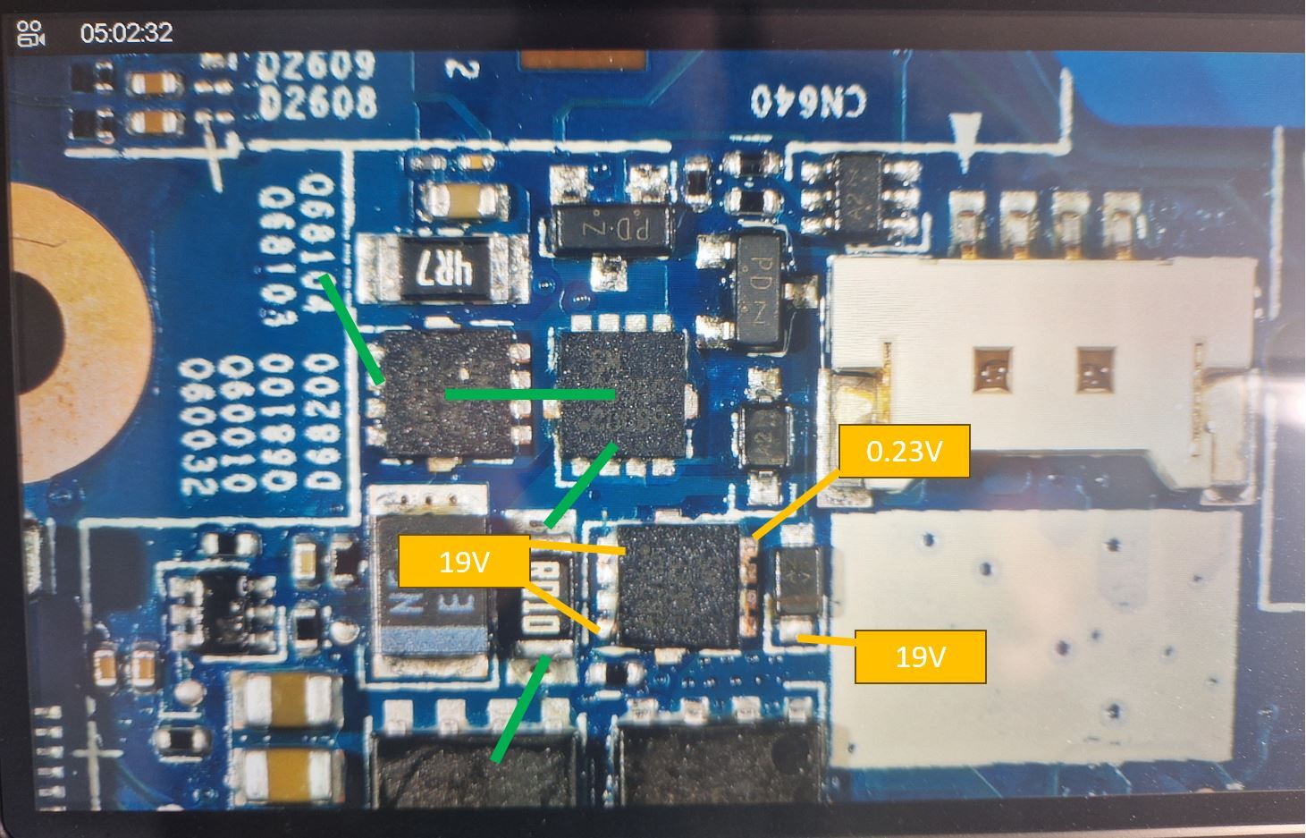

                        can sbd help me with this mosfet ? i don´t understand what it is doing. 19v ond drain and gate. and spource 0.23v
                        doesnt make sense ? or is it some switching circuit to change between battery mode and dc in mode that i dont understand
                        green is the +19v path as i understand it to the from the 2 smaller input mosfets to the 4 mosfets with the coil​
