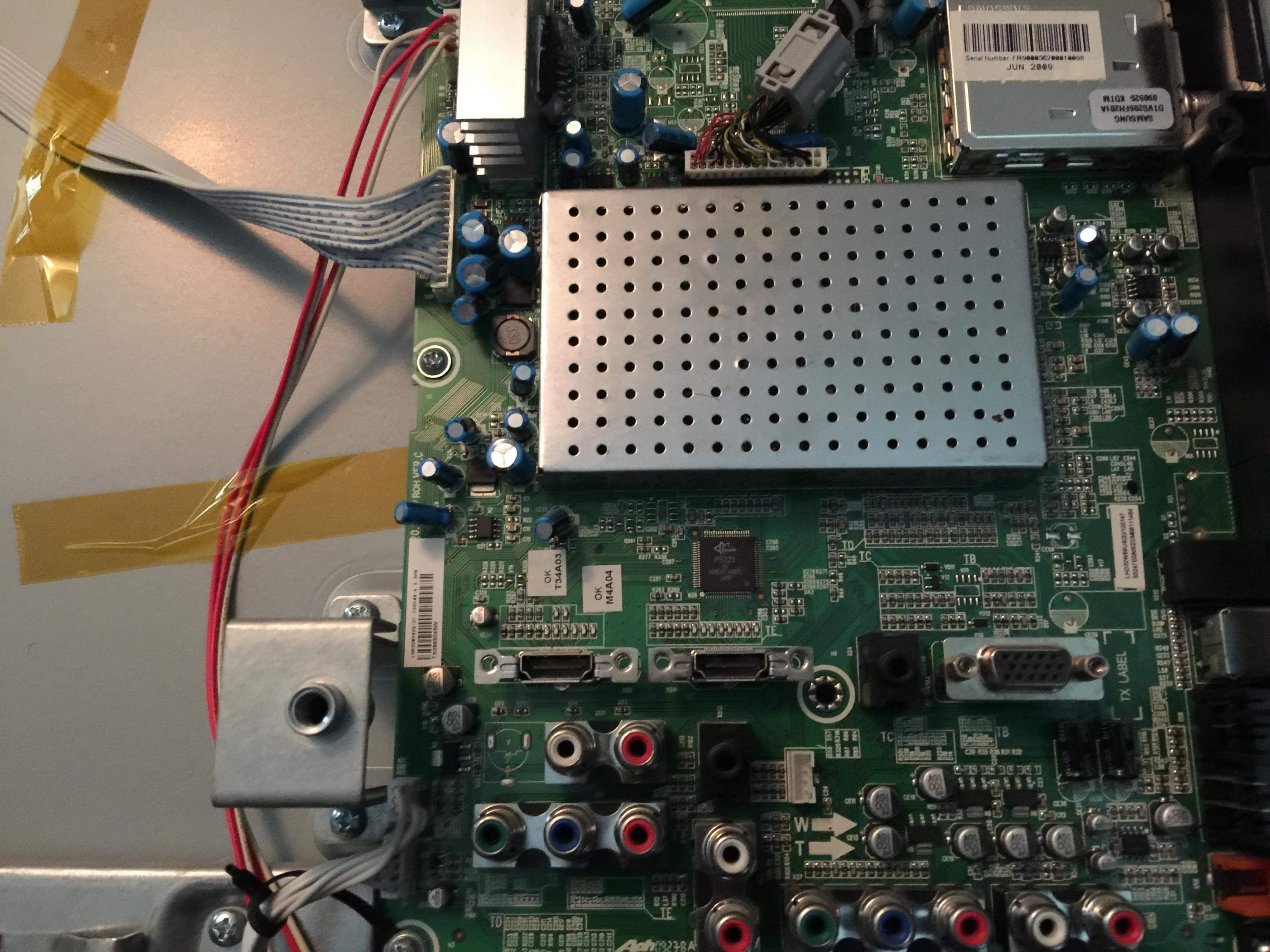

    Re: Element Elchw321 will not turn on
    Have you images of the boards used please ?
      Sorry Reecey. Somehow my initial thread got double posted. There is another thread that contains a picture of one board. I will try to get more pictures up asap. Thanks for the response.

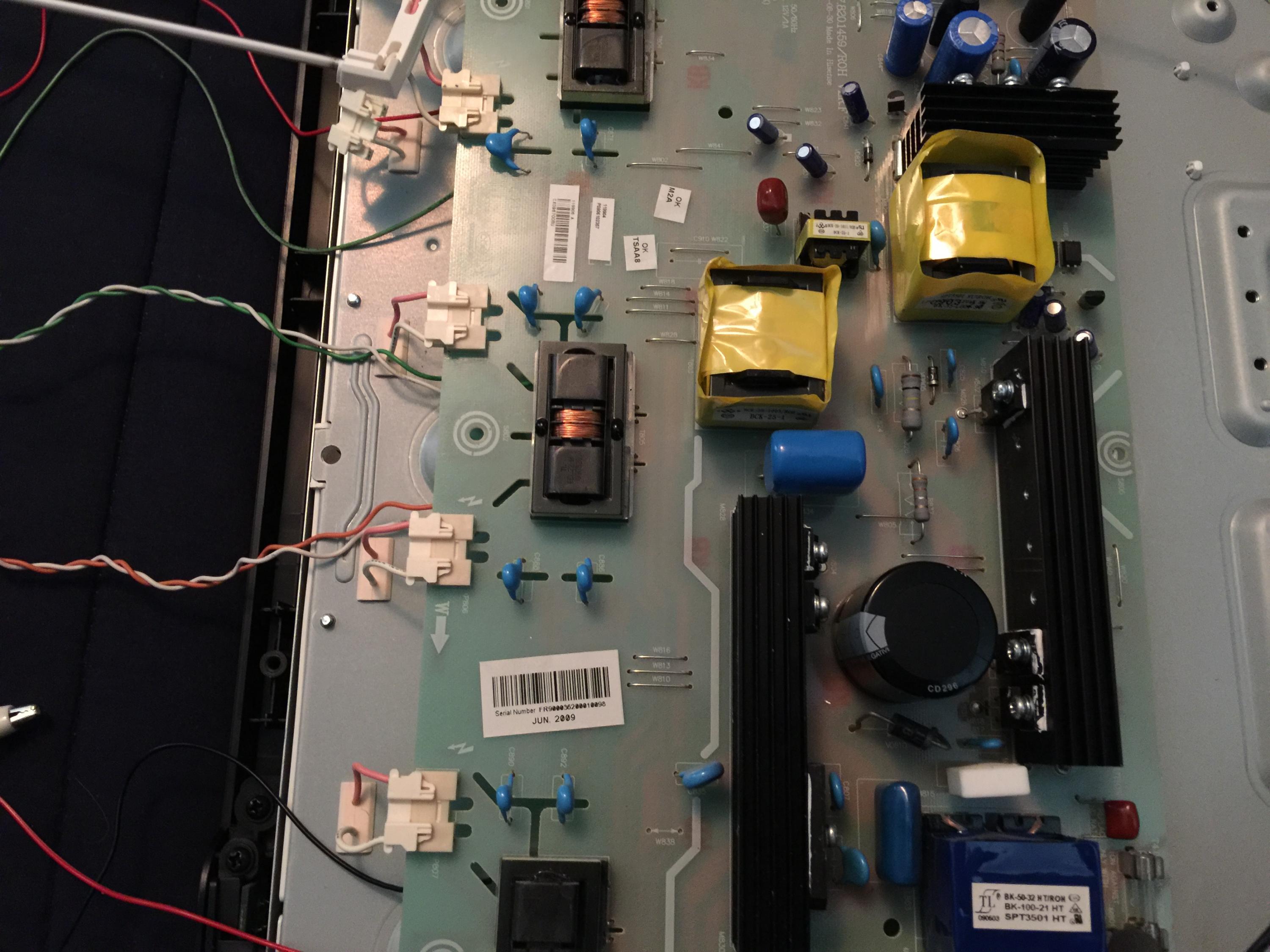

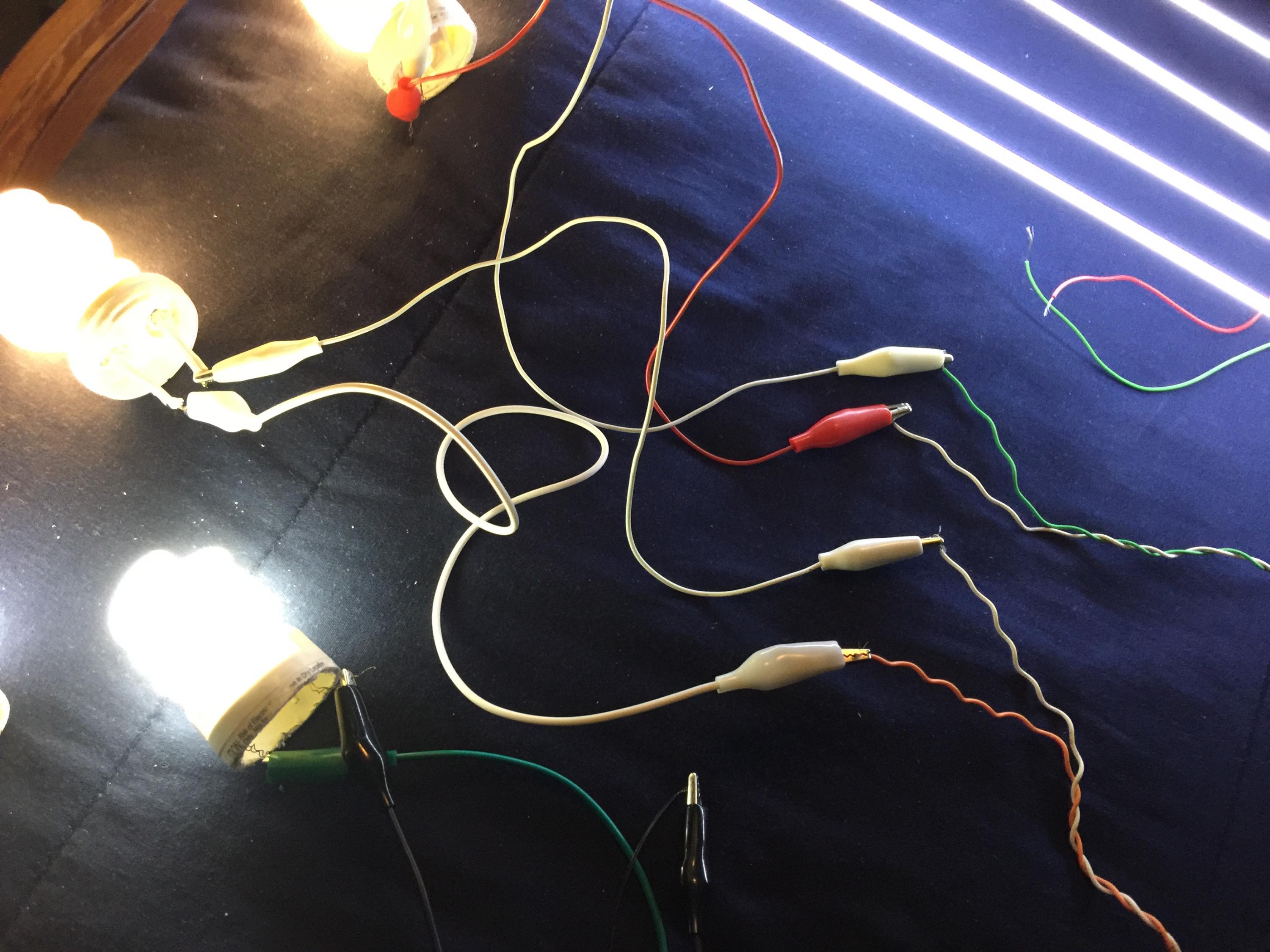

        Here are some pics. SW voltage is still at 3.0 when backlights shut off and the backlight inverter ic is the Fan 7313. All inverters have been checked for tolerance.
              maybe the inverter shuts down because of too much current being drawn (bad CCFLs), or it thinks there is too much current being drawn from the inverter?
              Maybe bypass the protection circuit on the inverter?
                Thanks for the response Capleaker. Will try to see if I can bypass the protection momentarily to see if I can keep the backlights on. Going to lookup the datasheet of the backlight ic.
                  Did you figure it out?
                  I'm working on the same board which also has no backlight.
                  Identified and replaced one dead FETs (V803 on schematic) driving the Backlight transformer but still nothing. The replacement has two times less RDS on though, not sure if it may be a problem
                  Never worked with CFL inverter before. Any help or links to troubleshooting methods appreciated.
                  The schematic is attached.
                    Are you saying you have ZERO back lights, or do they come on for 2 seconds and disappear?
                      Zero backlight. Everything else works - I can see the menu with a flashlight test.
                        What was wrong with the fet? if all leads were shorted, there is likely damage to the gate drive components.
                          Not all, but D-S Vdrop shows 0.15v both ways
                          I did not find any damaged components on the gate side
                            Check the BLon signal from the main board to the PSU, maybe it is missing. If it is missing it MAY be an EEPROM problem.
                            Try forcing the PSU and the back lights on, with the main board unhooked. You need two 1k ohm resistors. Take one resistor and jump STBY to PSon. Take the other resistor and jump STBY to BLon. Plug the set in and the PSU should be on and the back lights on.
                              Was it showing D-S short in circuit or out of circuit? The reason I ask is that is unlikely the fet was shorted and the main fuse did not blow also, If you charged the gate with your meter during testing it would have turned the fet ON, so it would have tested short between D-S.
                                Both in circuit and out. I'm aware of the FET charging.
                                Some strange things happened now. I was about to check the SW ON signal and it turned on and backlight works now.
                                No idea why it did not work the first time.
                                Could be some sort of intermittent problem still present.
                                  Check for poor solder connections on any components on heatsinks and also transformer connections
                                    Could this be the fact that I put in a different FET? So it is disbalanced now?
                                    Original was FDPF7N50U and I used 2SK3569 which I randomly scavenged off some other board.
                                      That could be.
                                        Can't turn it on again. It was just once when the backlight turned on.
