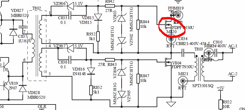

      SW ON signal is persent, and I see no bad joints.
      Circled is the FET I replaced.
      Do you think it must match the one below?
      Which characteristics are important to match?

        FAN7313 17 pin = 3.9v which means BCT/FT Fault-Voltage
        Any ideas how to troubleshoot this?

          If the fets don't operate, I would think the ic detects a fault, likely SCP. It thinks there is a short circuit killing the voltage, so it shuts down.

            If the original FET was shorted to the gate, look at the gate drive circuit.

              Gate drive circuit looks OK
              And it turns on sometimes, the problem is intermittent.

                      V803 and V804 appear to be working together as two halves of a resonant converter. If one failed (V803), you should replace with the same matching transistor (FDPF7N50U) , or replace BOTH V803 & V804 together with a PAIR of matching specs transistors.
                      There is a possibility that you are triggering protection because the gate driving circuitry is driving the two different transistors identically, but the transistors are performing differently and protection doesn't like it.
                      If you already replaced V803 with a 2SK3569, then I suggest you replace V804 with a 2SK3569 also (and keep the other FDPF7N50U for spare). These two transistors V803 and V804 should function as a pair, and should be matching specs.
                      also, double-check the diodes in your gate driving circuits. The fact that you accidentally triggered something by simply touching your probe leads means you may have a damaged component, or bad solder joint.

                        Yeah... I guess I'll wait for original FDPF7N50U to come and see if it fixes the problem.

                          FDPF7N50U fixed it
                          Thanks you all for your input

                            That's good to here, so it was just a mismatch of the two fets that caused the problem. Likely the different on resistance
