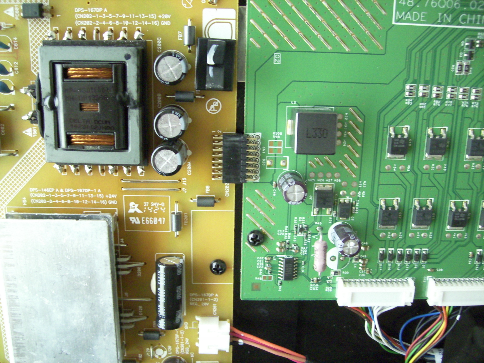

    I recently acquired a 55" Vizio Smart TV with intermittent video (actually, no backlight). The previous owner said that it would work for a while, then NOT work for days. When I brought the TV home, everything was working properly. After a few days, the backlight just went dark. A check of the power supply showed ~21V being properly output - but not getting to the LED driver board - connector CN202 had no voltage on it.
    https://www.badcaps.net/forum/attach...1&d=1461431331

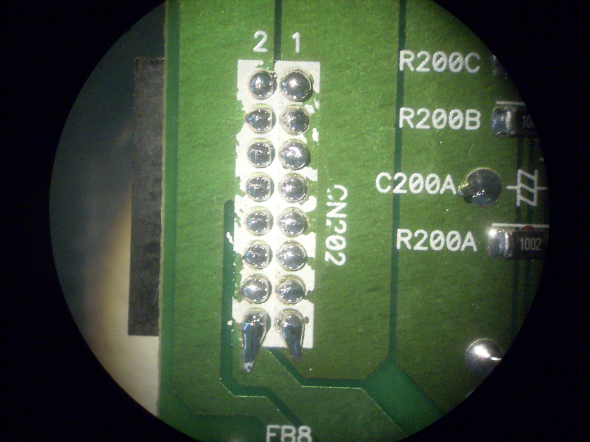

    Removing the PS board revealed that the backside of connector CN202 had EVERY SOLDER JOINT FRACTURED!

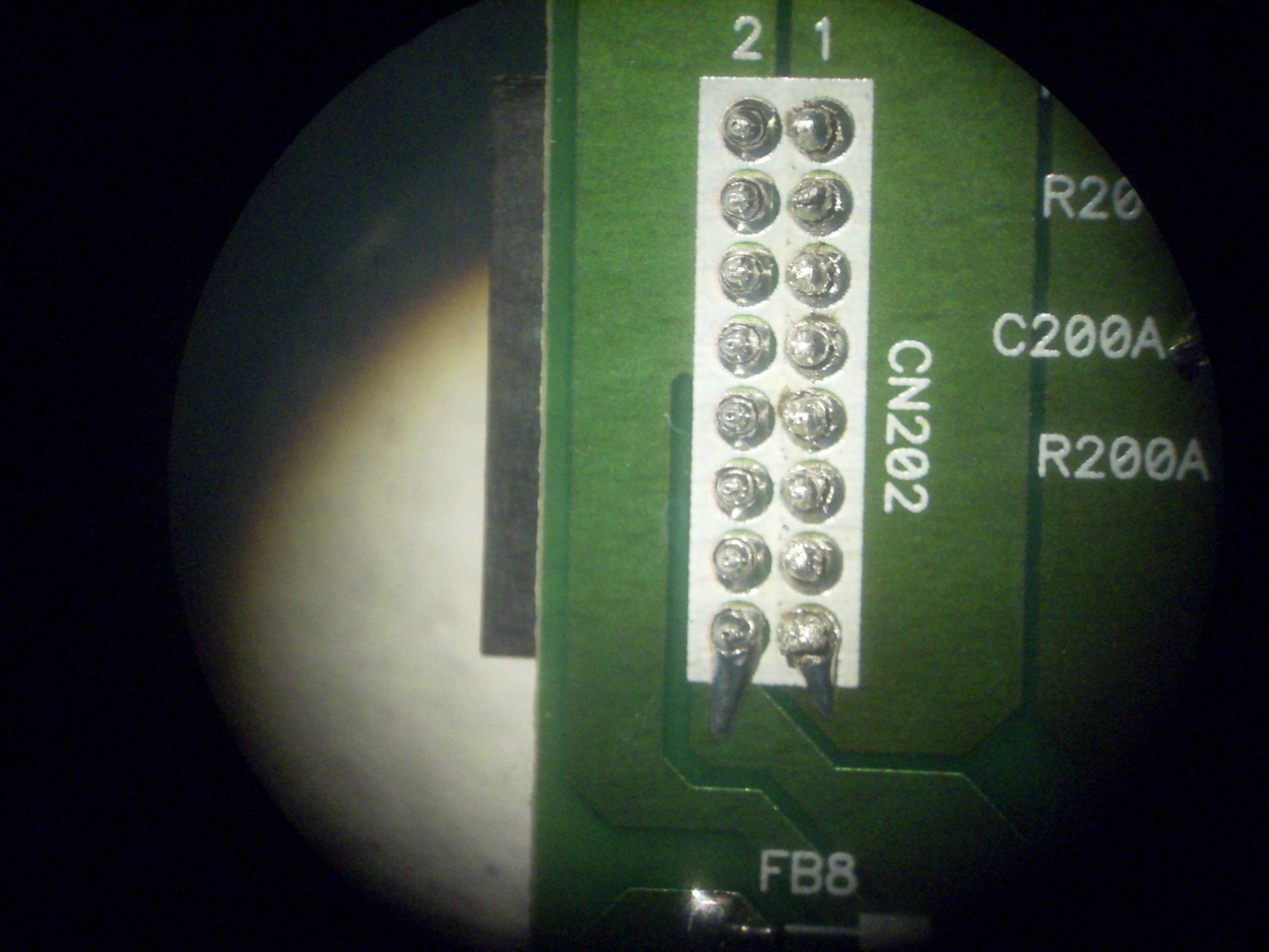

    After some rework of the solder joints to remove the lead-free solder and put down regular 60-40.
    When reassembling the PS board back into the chassis, EXTREME CARE should be observed, since the CN202 connector requires a LOT of force to properly mate. If you do not support the pins during mating, THEY MAY FRACTURE AGAIN! So, do NOT use pressure on the board, but put the pressure on the PINS! The joints are fracturing because the PS board is single-sided and only have support on the metal side.

      Mine also broke on the PS side. The pins on the PS are extremely sensitive to fracturing due to the PCB being only single sided.

                Probably the solder was originally under tension. Since solder will flow under tension, they probably fractured one-by-one until none remained connected.

                      To properly dry the screen, you have to take the panel completely out. Check to make sure no water has wicked between the two glass panels - if not, then you should be okay.
                      The better way to repair the connector is to remove both boards at the same time, resolder the connector, then reinstall both boards as one unit. This keeps the stress on the connector to a minimum.

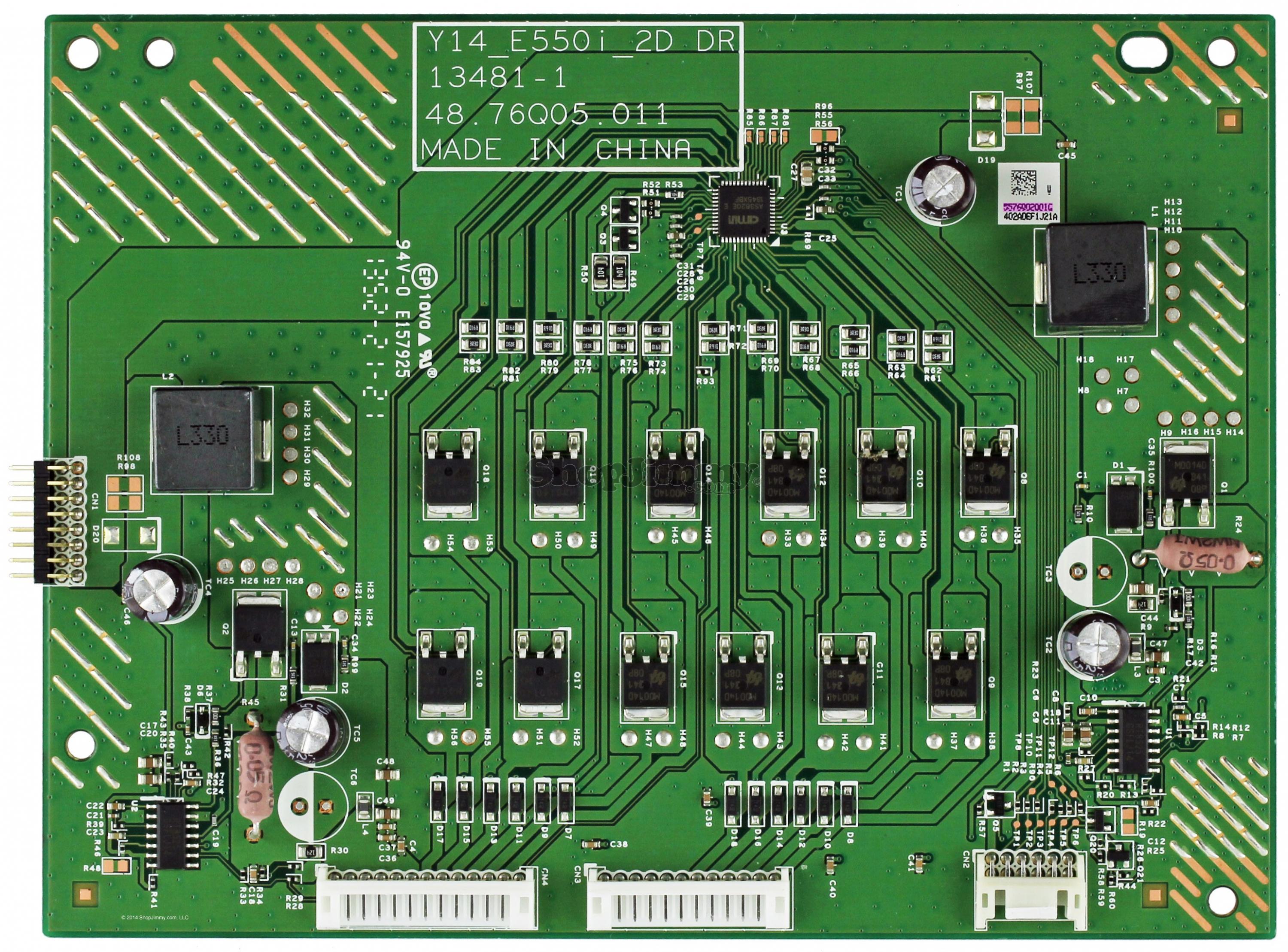

                                Vizio 91.76Q02.001G / 91.76Q10.001G LED Driver for E550I-B2
                                https://assets.shopjimmy.com/media/c...2.001g-top.jpg
                                Check to see if you have boosted DCV between the two pads where cap TC6 is not installed. The LEDs are in the panel which is the common failure for TV with LED backlights.
                                Pictures provided by shopjimmy.
                                BTW, you did do the inspection for bad solder joints per post 1?
