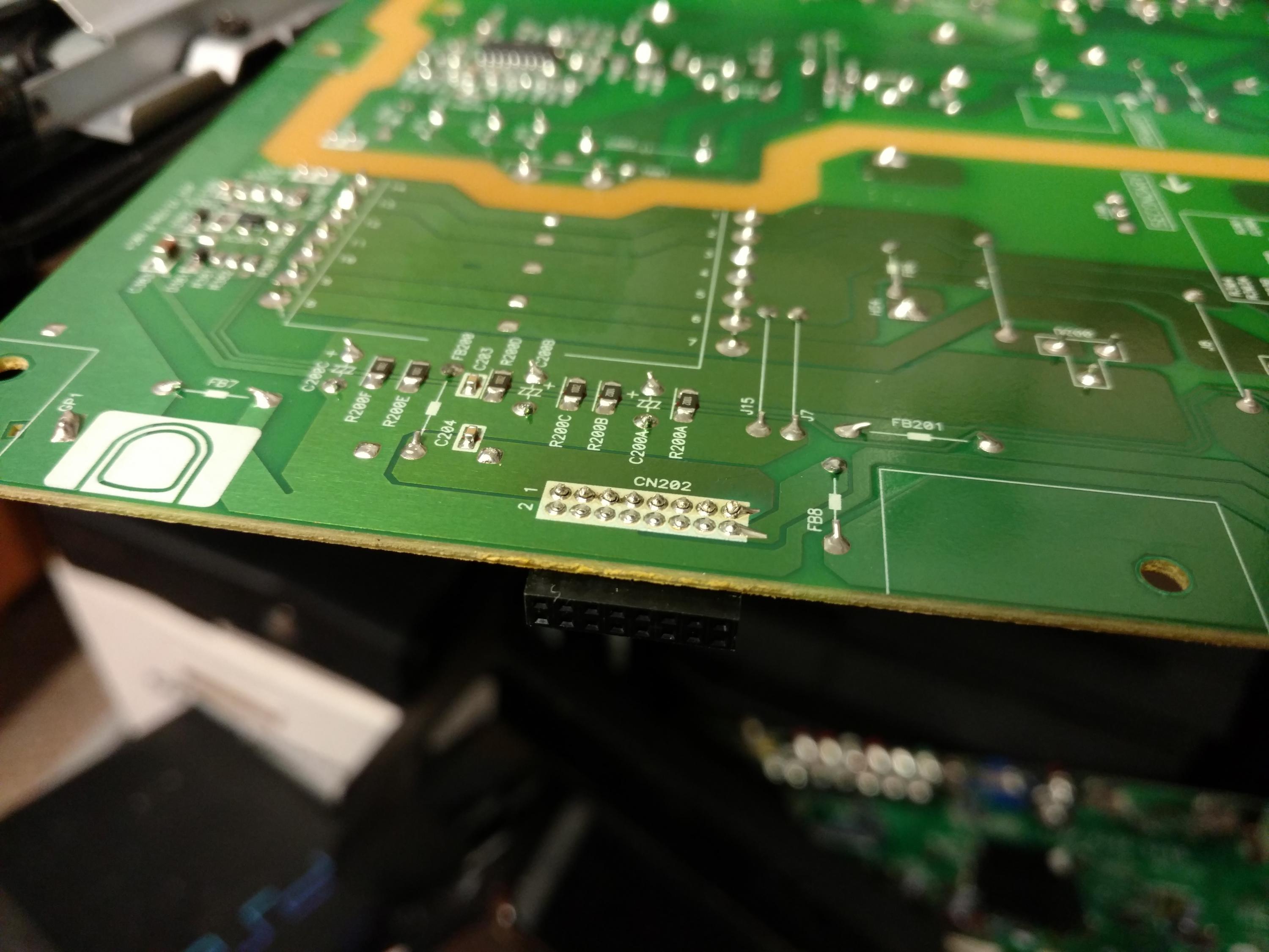

              Add me to the list of people who have had to fix this rather silly issue. Fresh solder on the connections and hot glue on the connector brought this Vizio back up. That connector seems to have been designed to fail just outside of the warranty period .
              In this particular case, it wasn't even powering up at all. The white power light would slowly pulse and then the thing would eventually just give up. Every single point for that connector had broken free.

                Yes, it's a particularly bad design for a board to board connector. You must have a later version of the PS that detects low current going to the driver board and forces a shutdown. My TV would operate just fine with the broken connector (just no backlight), so it obviously didn't have a low current detection capability.

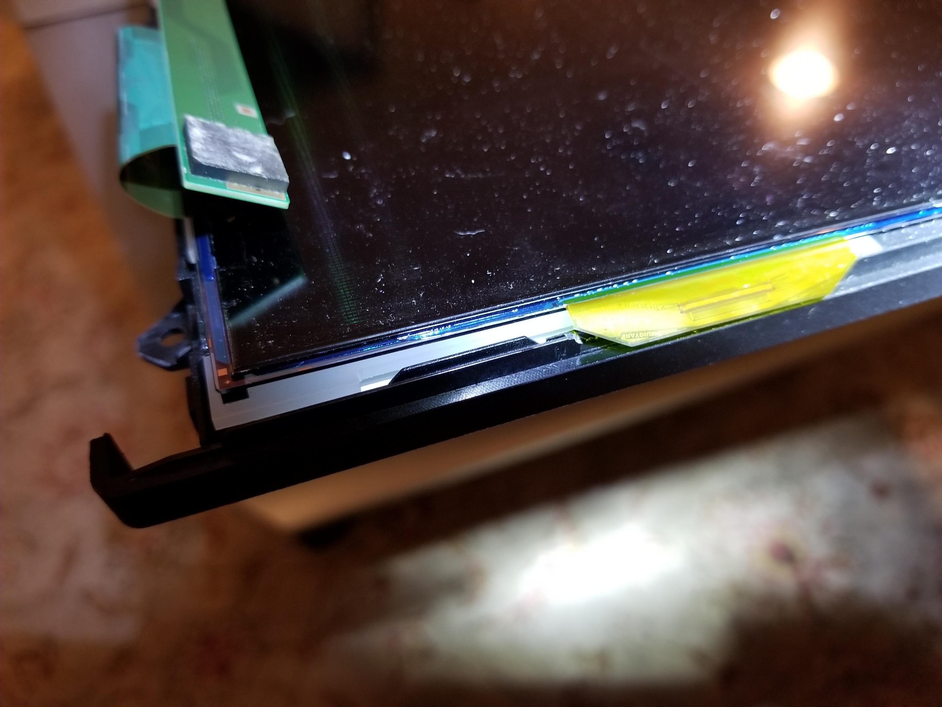

                  Fixed this TV once before for bad solder joints (no backlight), but now it's back with sound, backlight, but no picture. Any ideas?

                      I did the solder joints for the back light problem, now just have no picture but have back light. He said a tried a new t-con board and it didn't help, so I'm thinking maybe the panel..

                        Have you a supply to the tcon?

                          have you got voltage too the tcon fuse? as could be a bad mainboard

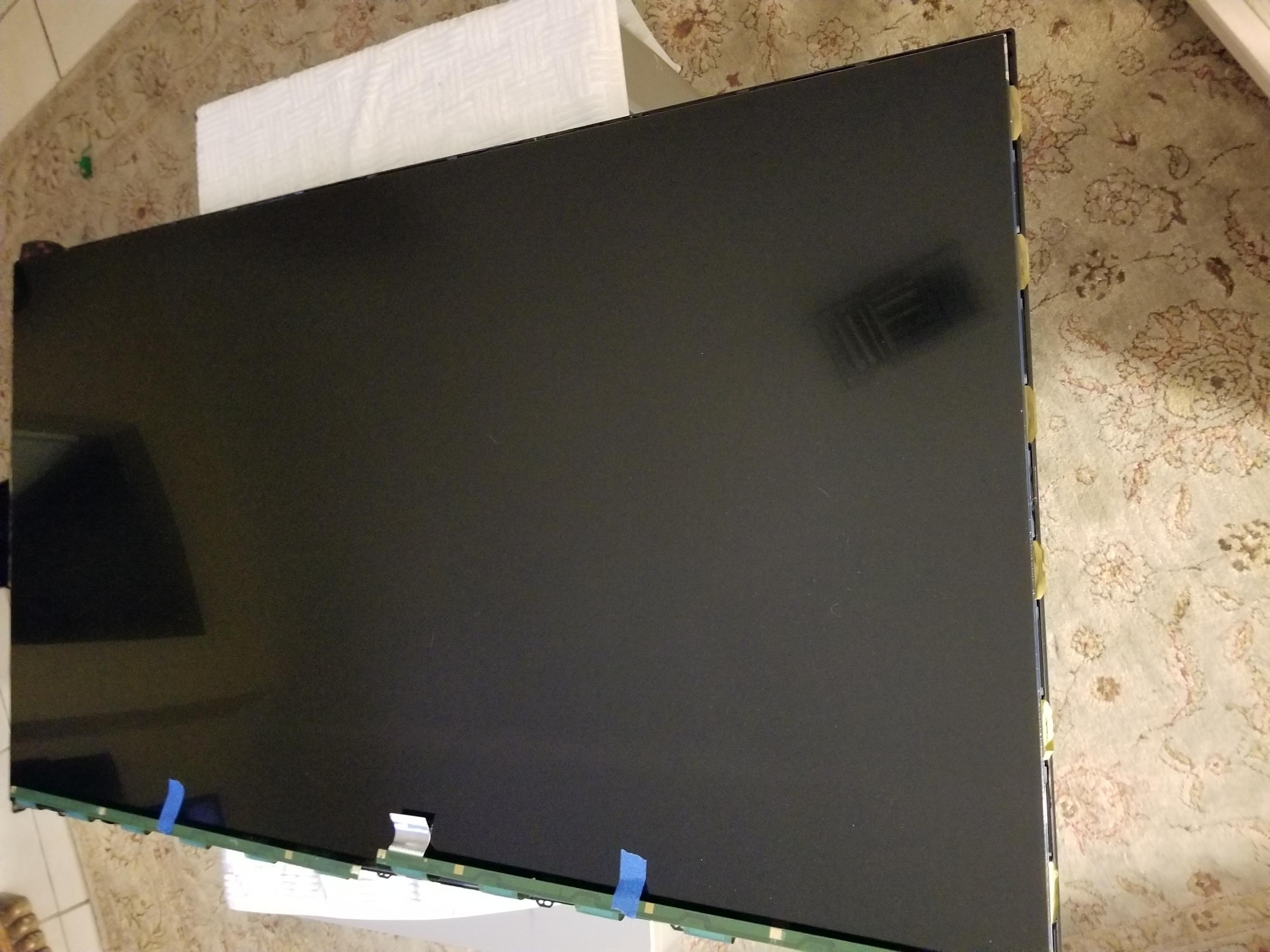

                            Yes OK sorry update is there is 12V to t-con before and after fuse.. I tried a new main board, same problem. So now that main and t-con were replaced, I'm thinking it's a bad panel. Could that be without shorting anything on the t-con?
                            Nevermind, had a brain dead moment forgetting to disconnect each side of the panel from the t-con, and could only see left half the screen come on normally with right side ribbon disconnected.

                              so it potentially can have tabs removed to save it... IF it is has side tabs on each side.

                                Ya i have seen this on the 70" Vizios and some have luck with that. Something about cutting the trace on the tab to the bad transistor?

                                  from your "test" doing the right side disconnected, it would appear your issue is on the right side (assuming your brain dead moment tested the disconnected left and got no picture at all... :-) ). Look on the right side, to see how the tabs are connected and see if you notice anything different amongst them (ie. heat marks, etc). Potentially depending on how the bottom edge boards of the panel are connected and how many there are, you can further your "testing" by unclamping the flex cable interconnecting the edge boards on the right side... if possible. This may give you even more picture, you can go from there.... hopefully.

                                    What should I be looking for, don't see anything abnormal on the main tab bonds..

                                      look at the bottom corner of the panel.... how are the side tabs / sides "tab cables" connected to the bottom edge boards? On 70 in units, there are small unclampable flex / ribbon cables running from the bottom boards to the side boards. On 55 in, their design might not have that "feature" (like some of the 60's).... as the tabs might be interconnected in some fashion thru the panel itself. how many bottom edge boards are there? I assume there is more than one... maybe one per "half". If there is more than one per half, they are interconnected with unclampable flex cabling. You can unclamp the cable on that side. It should give you more picture ... maybe 2/3 and further confirm the "postulation" that the right side is the issue. IF so, then you will have "tested" most of the connection path and only have the last little bit of bottom edge board along with the side tabs. You can then check that portion of the bottom edge board to see if anything "jump" out at you as there might be a component on the edge board that has a problem and maybe replaceable (with some effort). This would be before the "final / last hope" of tab removal which has no "back tracking mode" there after.
                                      you might post a picture of display that you get.
                                      I see from your picture that there is only one edge board per bottom half.... :-( so you need to look at the lower right corner to see what's up with the interconnection between the bottom edge board and the right side.

                                        So it seems there is no connection from the bottom right edge board to the side tab.

                                          :-( that means that the connections are formed somehow thru the panel itself to feed the side tabs. Personally, I have only seen a 70 in. I do believe others on this forum have been successful at pulling the tabs on "lesser models".... 60's for sure but not sure about 55's. Are the tabs, the same on both side of the set?
                                          You still haven't posted a picture of the display showing the resulting screen with the tcon cable disconnected. You might try comparing both ends of the bottom edge boards (ie. right and left sides) and see if you can spot any differences that might point to a bad component that might be replaceable.
