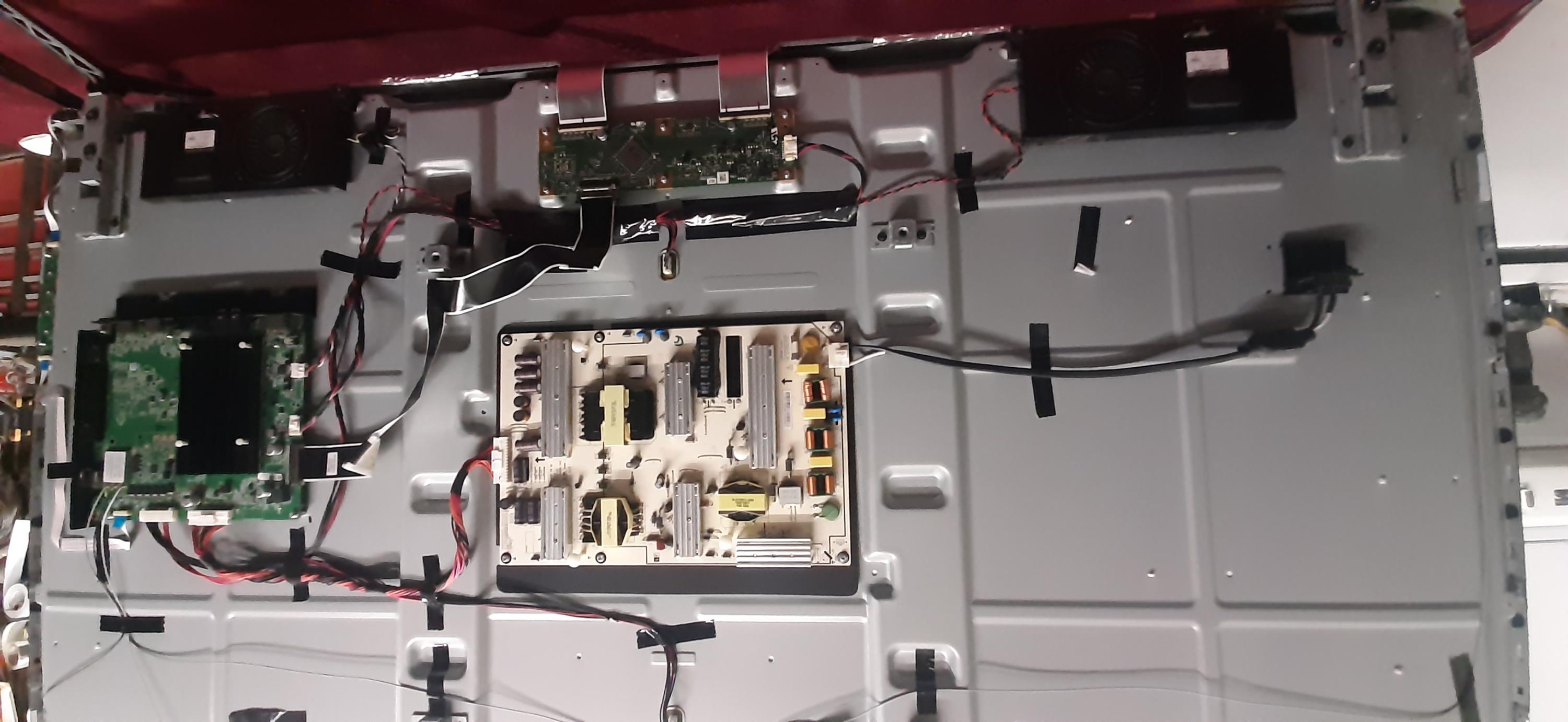

    Have a free Vizio E60-E3 pickup - sound and backlights work. set turns on and stays on for a period then cycles off and back on. NO VIDEO. If I remove left side (from front of TV) of TCON cable - set has pic on right side (from front of TV) with white screen on left side. With right side TCON cable disconnected - no pic on either side.
    Does this mean remove right side (from front of TV) tabs ?
    Like a second opinion before possibly destroying set.

    Re: vizio E60-E3 backlights, sound, no video
    pics

      No don’t remove any tabs.
      Sounds like the panel is the issue but most likely the tape method is your only hope.
      You can check for shorted caps on the buffer boards also. You may get lucky and find something shorted there
          The buffer boards are what lvds cables from the tcon go to. You have to remove the speakers and metal cover
            Indeed, never jump to tab removal before confirming the problem, it being non-reversible, little test: tv UNPLUGGED from power, unhook tcon to panel cables, being careful not to let the cable ends rest on metal, plug power in turn tv on, does it still cycle?

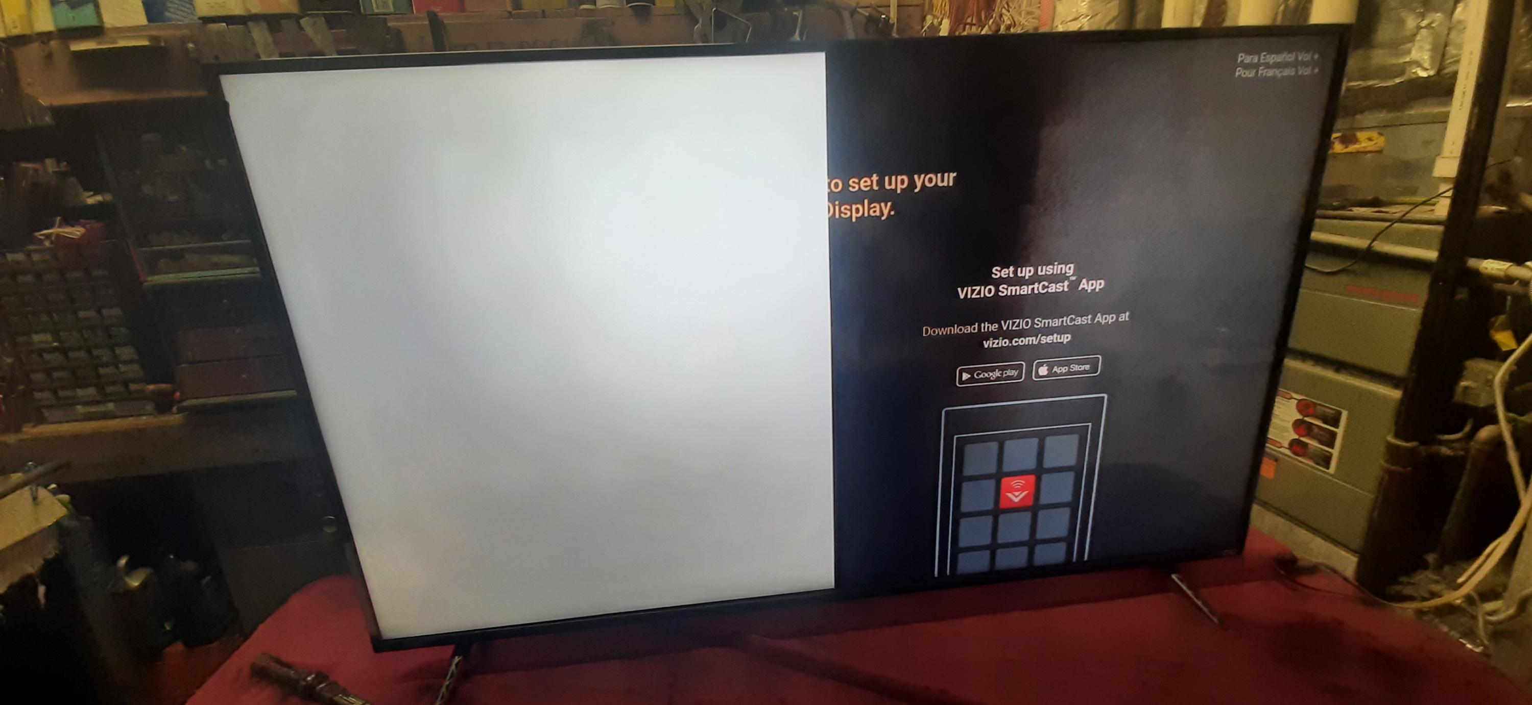

              from reading all the posts on this issue - my right side of screen is good picture with left cable removed from TCON board from front of tv - all posts say to remove left side tabs from side of tv will restore the picture.
                I looked at the buffers at the bottom of the set - they are not connectors - they are bonded onto the board. Not worth removing display screen to check for bad caps or burn areas. I then made a executive decision and removed left side tabs (they removed very easily with pulling) and powered up set - perfect picture. Another tv saved from the dumpster
                  What I said was unhook panel from tcon, I did not say it was not bad side tabs, I said you want to make sure that it is by testing, as a bad side tab can present itself in different ways.
