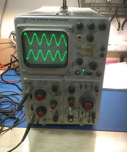

                            #73
                            Re: Toshiba 55ZV650U REGZA sound but no picture
                            I found two oscilloscopes for sale locally .....would either one of these do the job?
                            The first one is:
                            Hung Chang 20 Mhz dual Trace oscilloscope Model: OS-620
                            The second one is:
                            Oscilloscope Tektronix 564B Storage
                            seems to be a 10MHZ

                              #74
                              LOL are you going to buy oscilloscope to repair your TV ?
                              at your pervious posts you wrote you can see TOSHIBA logo sign.. when you push the tv to start many time... is this sign logo of Toshiba show on the LCD ? and i think yes its,, then no need to oscilloscope.
                              change the main boards instead you buy oscilloscope
