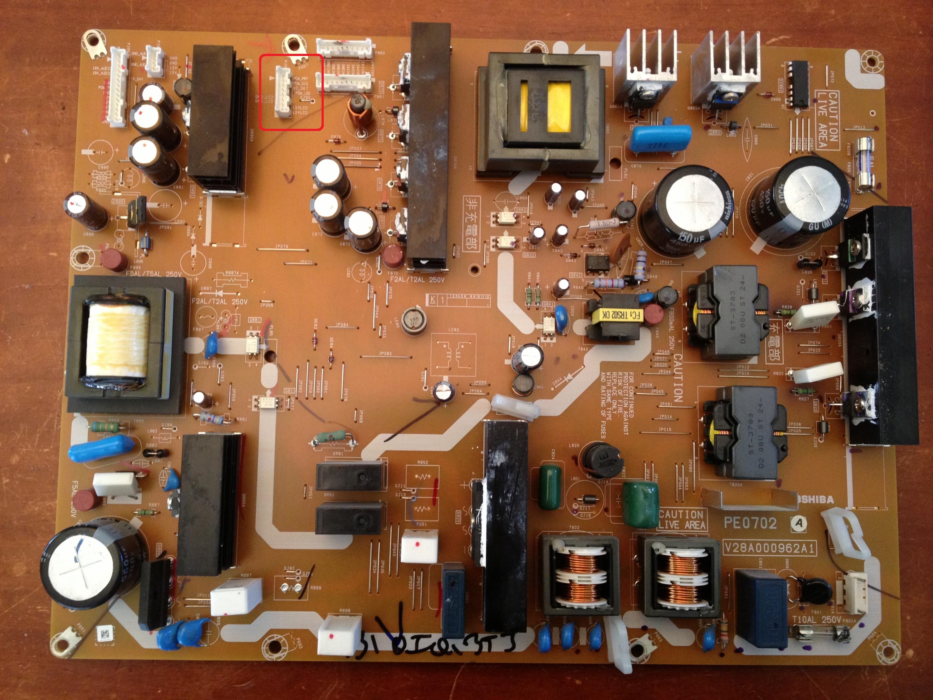

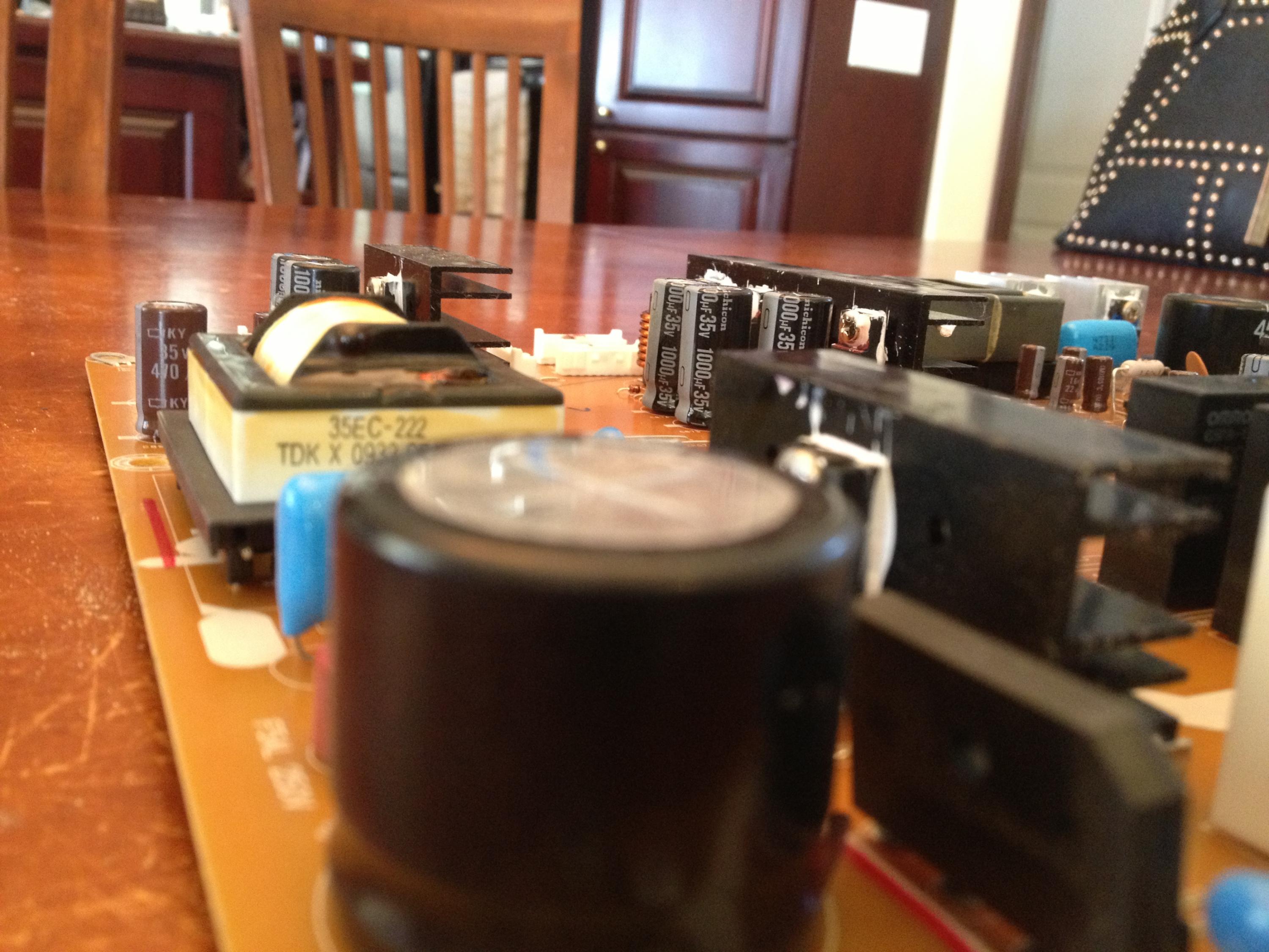

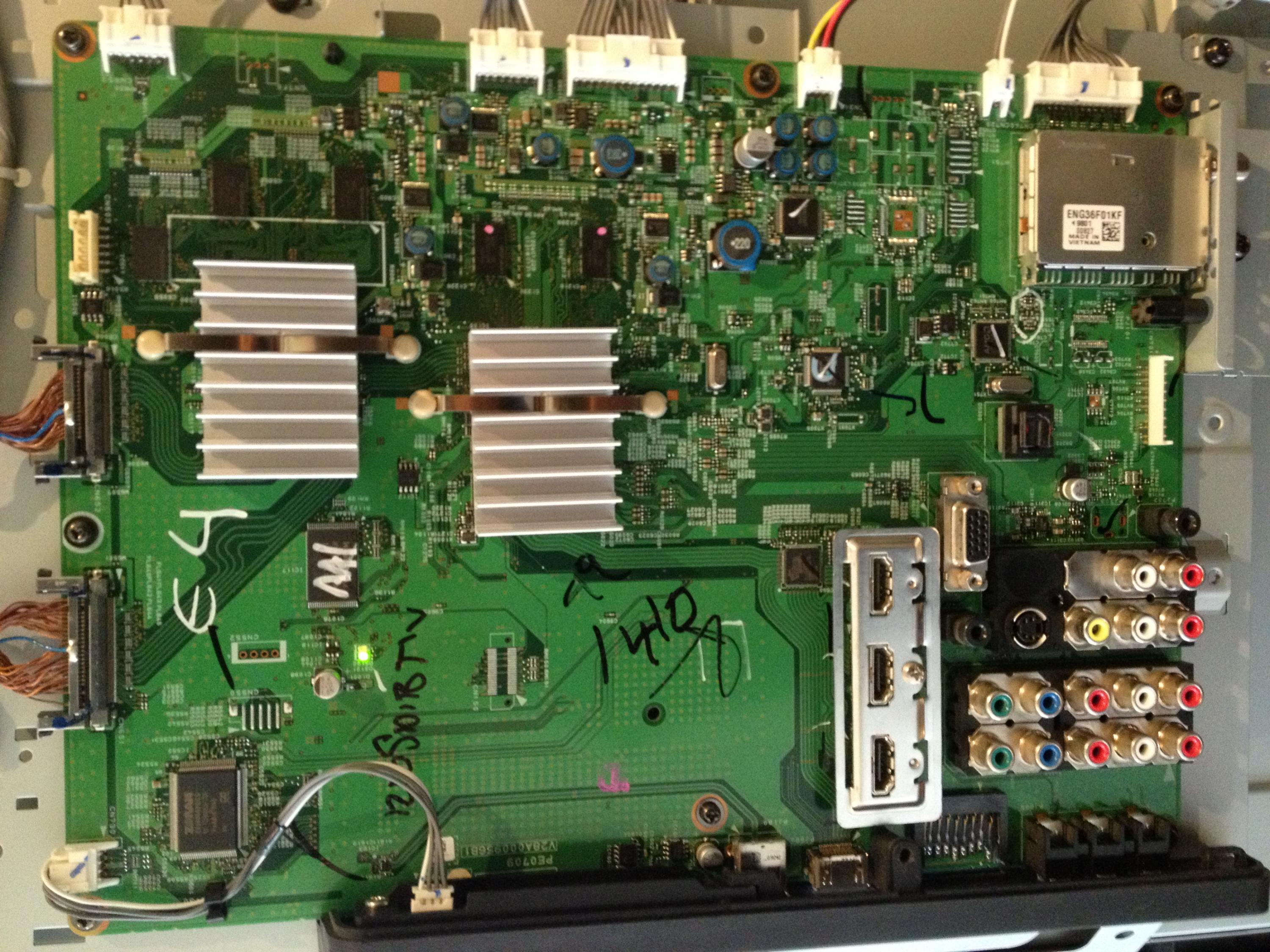

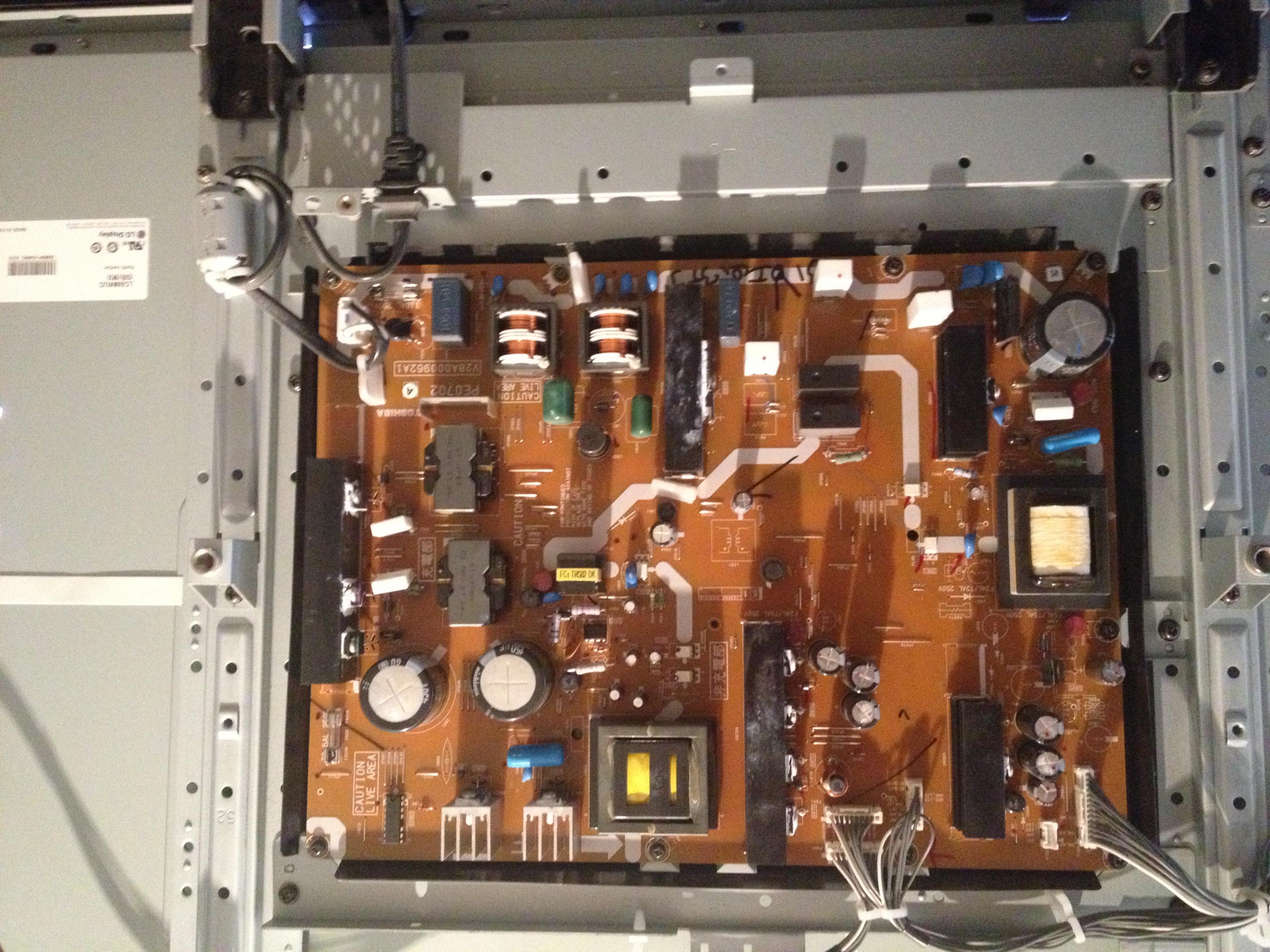

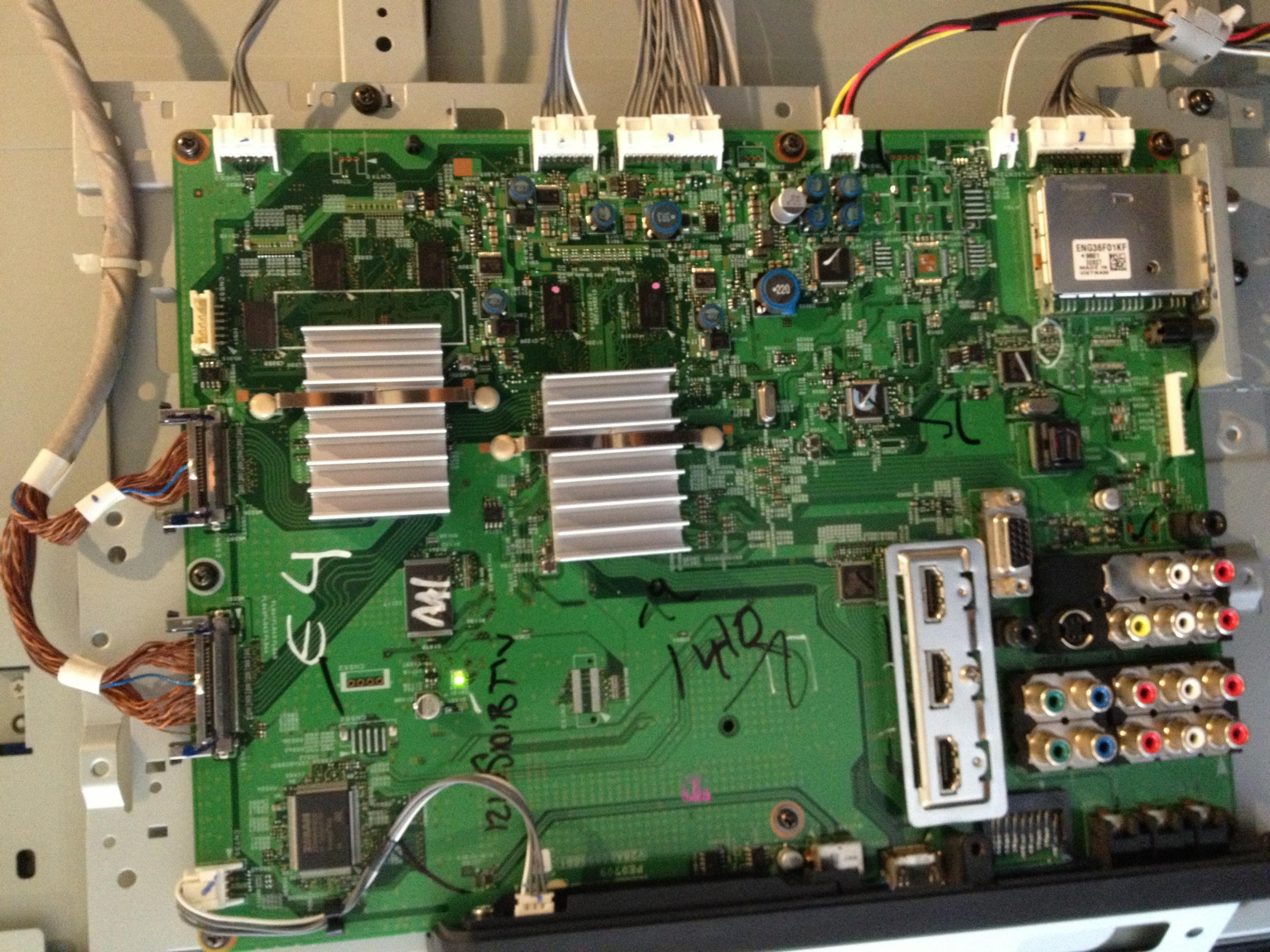

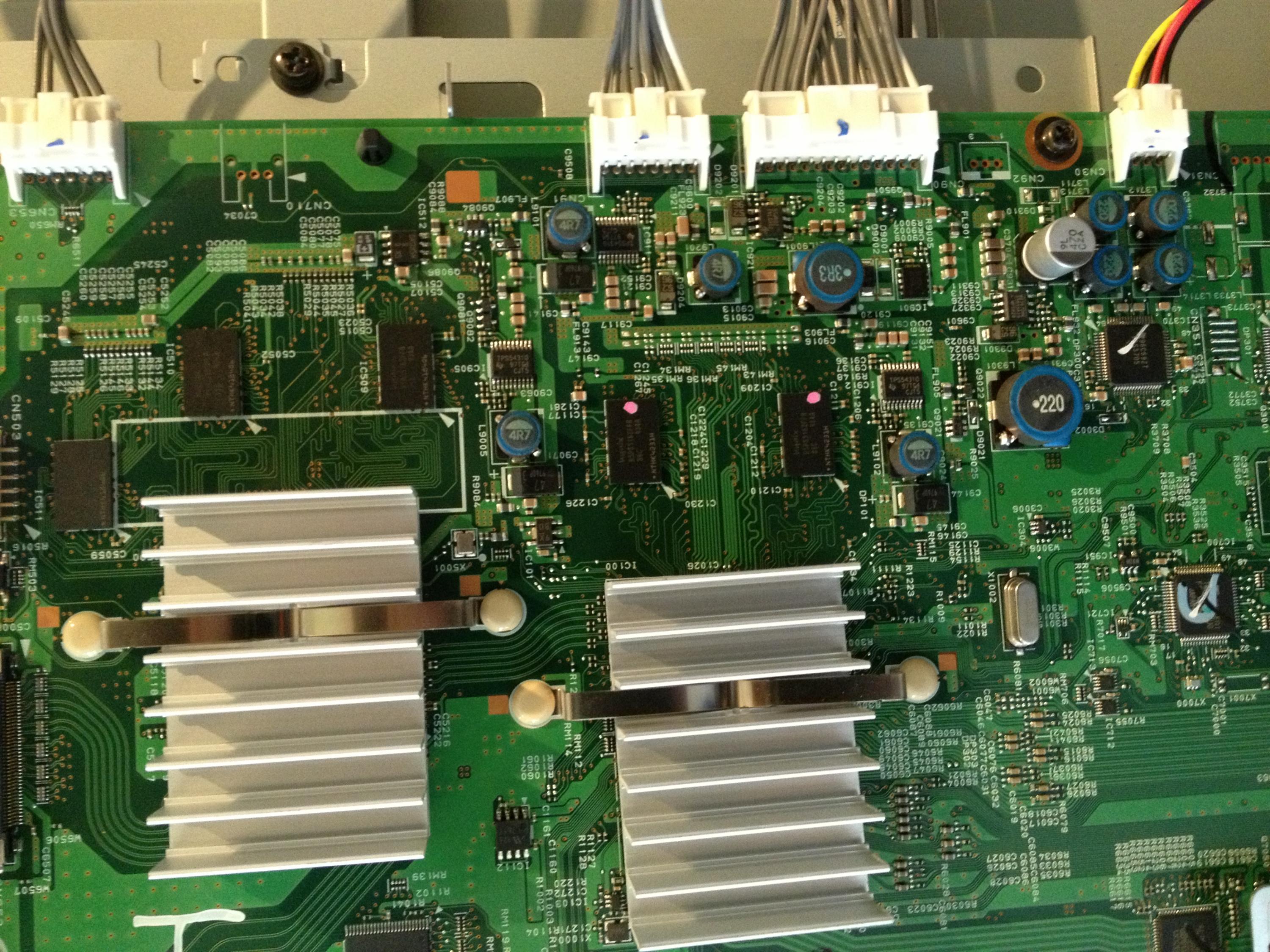

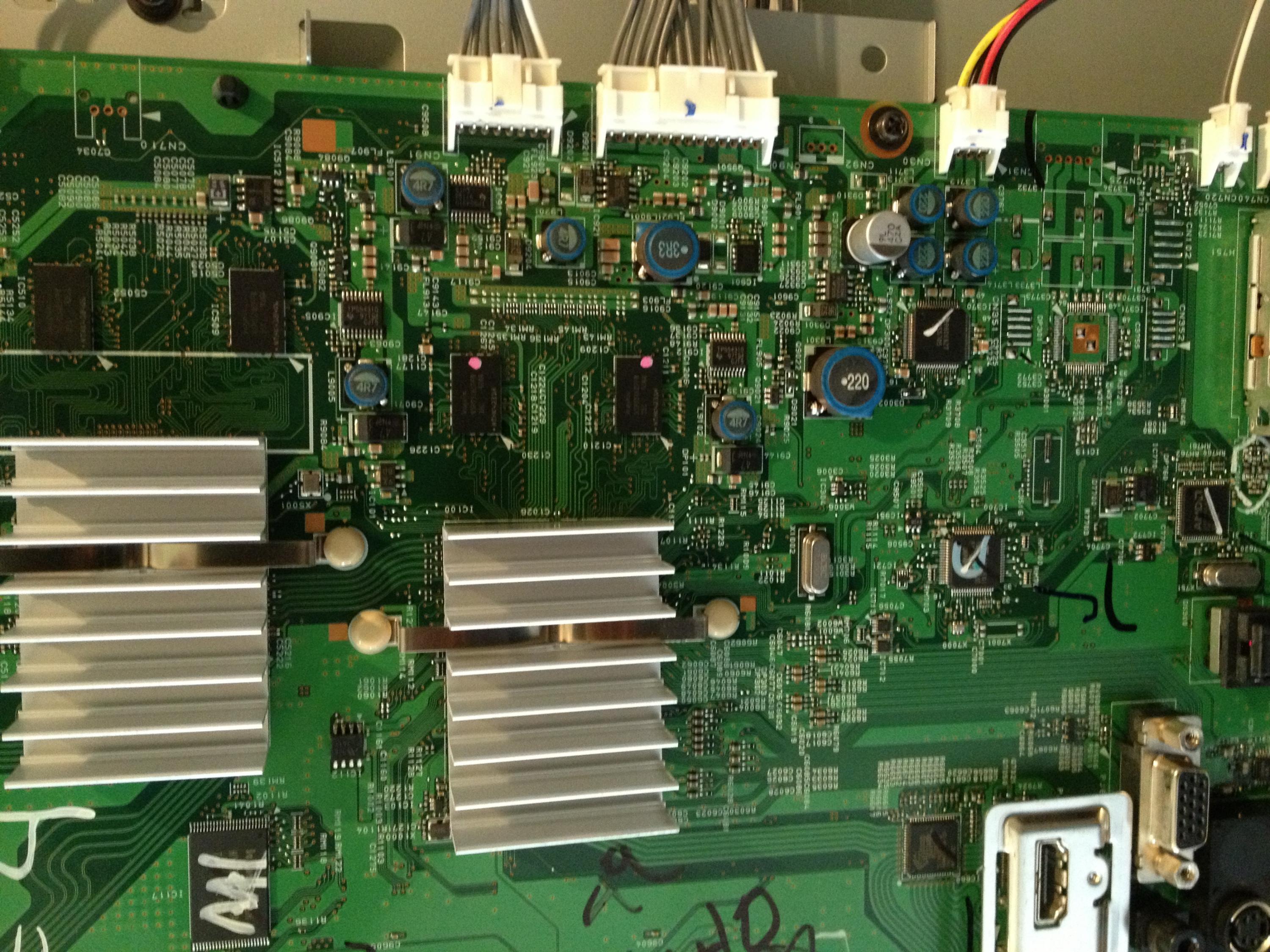

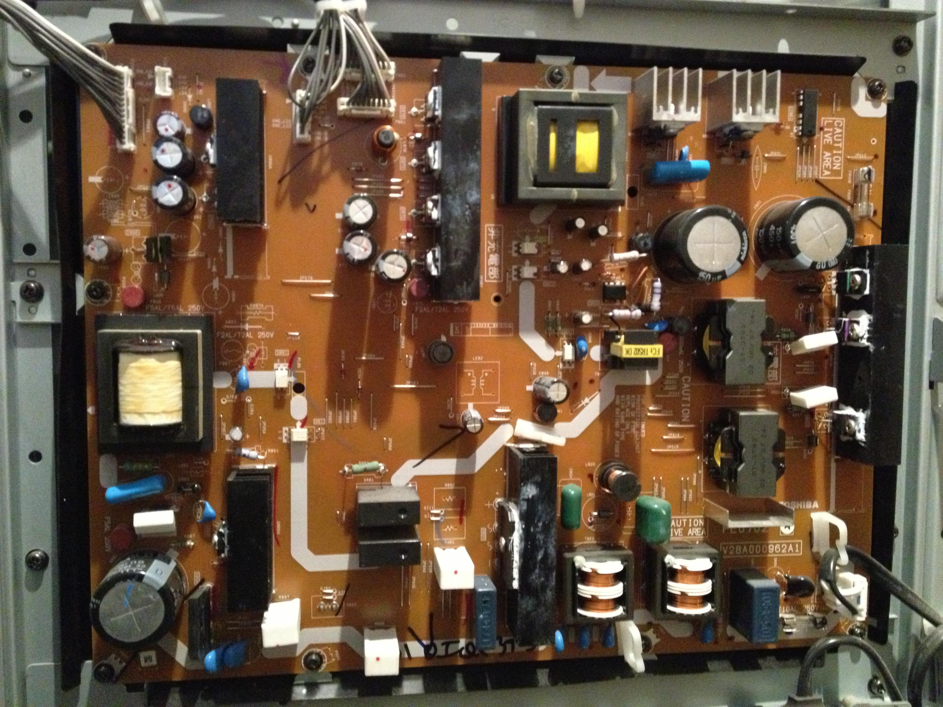

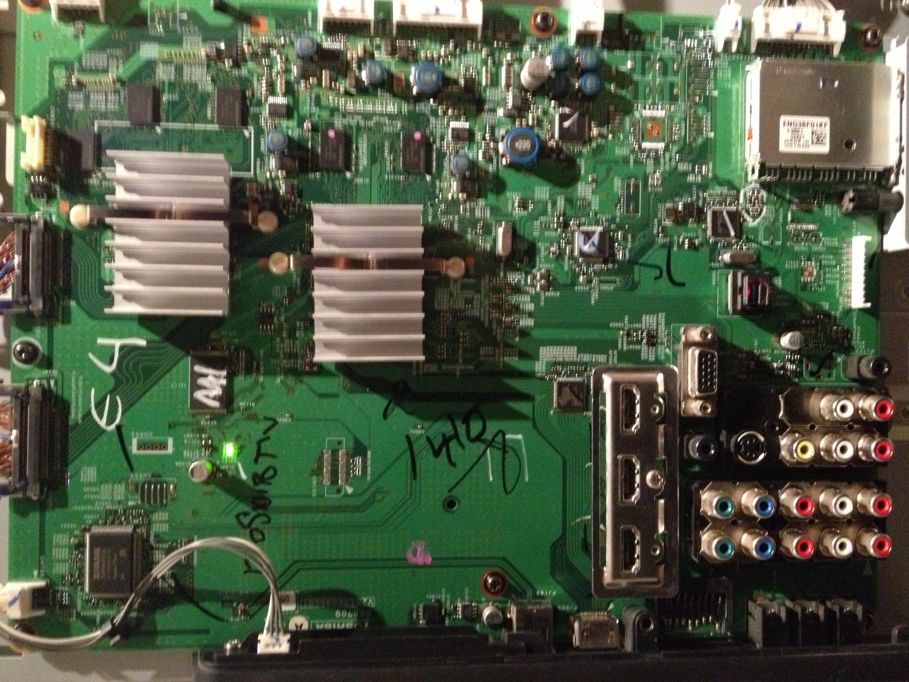

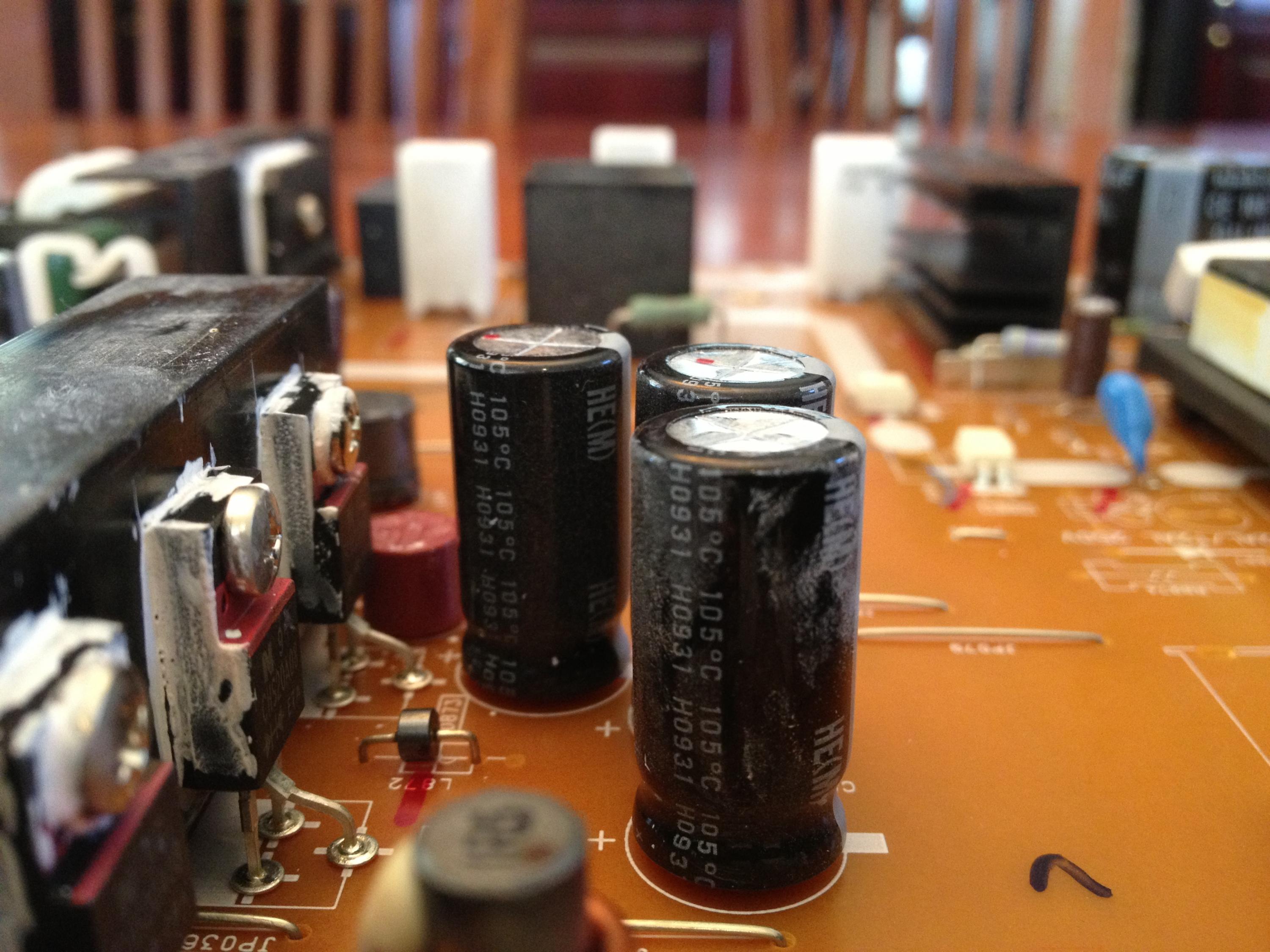

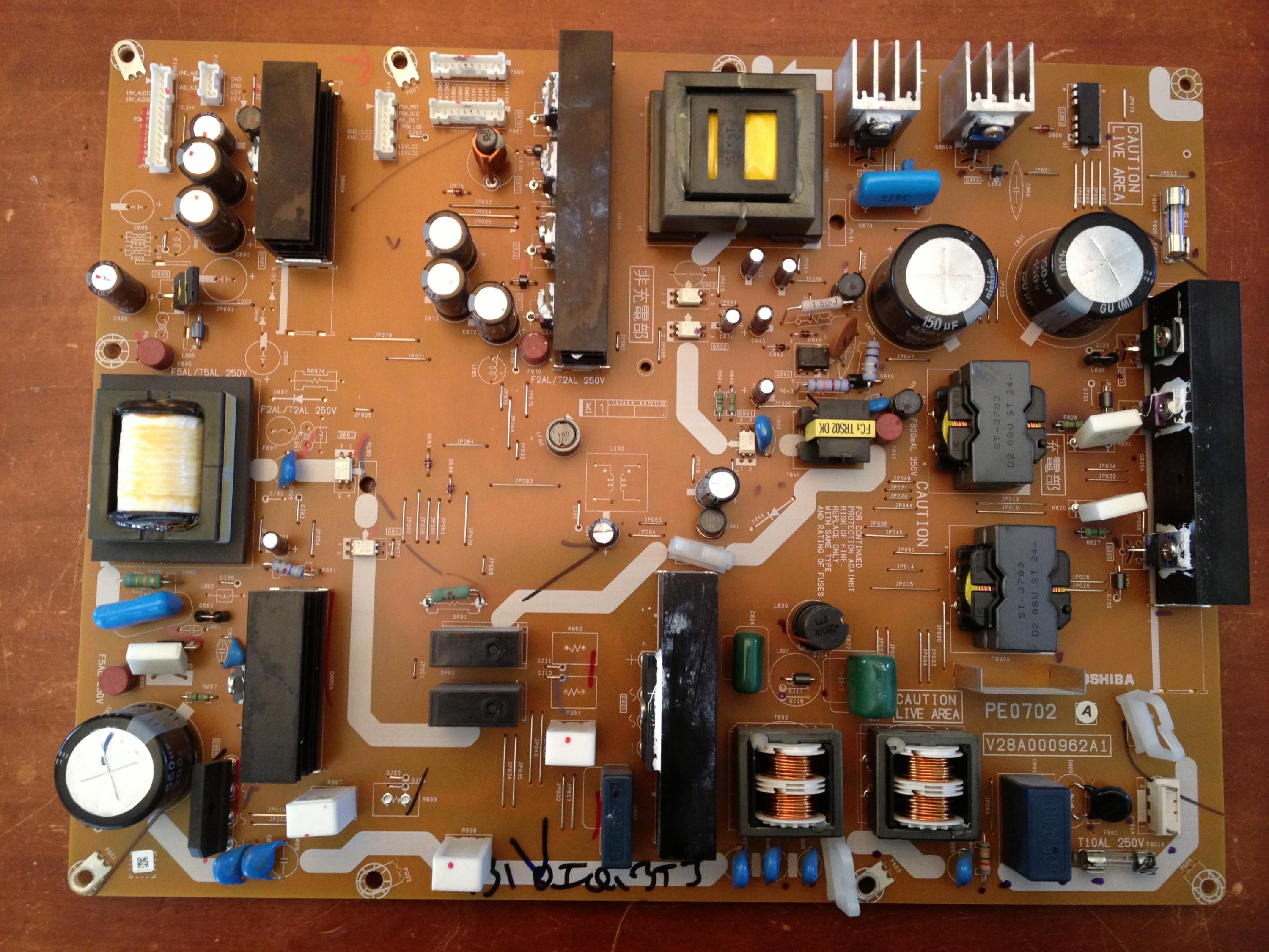

        I have taken several picture and attached them to this post to help solve the problem. I thought I had this one solved and replaced the T-com but nothing doing. I does the exact same thing no change.
        What I have checked so far was the standby light lights up in front of the TV.
        Standby volts is at 5 volts on the multimeter.
        There is 24 volts coming go of the board to the backlight. (I can see the light go on as well once the back cover is off).
        I checked the rectifier output and its at 106.5 steady ( saw on youtube that maybe it should be at 160V but not sure if he was working on the same model).
        Rectifier output for the a/c is 117.8
        I am really hope for everyone input so I can solve this issue.
        I also checked the fuses and they look fine.
        Anxious to get some replies.
        Thanks in advance.

            Re: Toshiba 55ZV650U REGZA sound but no picture
            The set looks as though it's been worked on before looking at the amount of heatsink compound around some of the components.

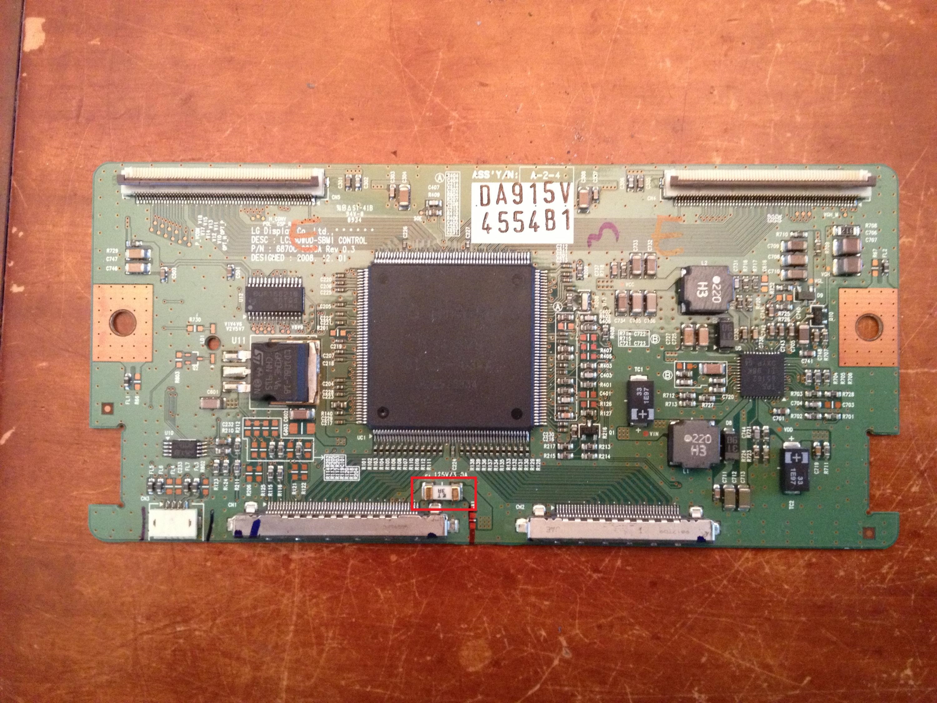

            What voltage do you have on both sides of the white ceramic fuse on the Tcon board
            What volatge do you have on the 12VLCD pins.
              The mains does seem low. Is one of the large caps (C821) starting to bow on top?
              What is the dc voltage across the legs of C820 & C821 which are rated at 450V dc.

                Just wanted to in the title that I have added pictures of my boards in order to get some help......sorry and Thanks
                      "I checked the rectifier output and its at 106.5 steady ( saw on youtube that maybe it should be at 160V but not sure if he was working on the same model)."
                      Where did you put the black probe of the meter, the chassis or at the negative leg of the cap? It looks like you are using the chassis as the GND.
                        To answer Dick Barton ......

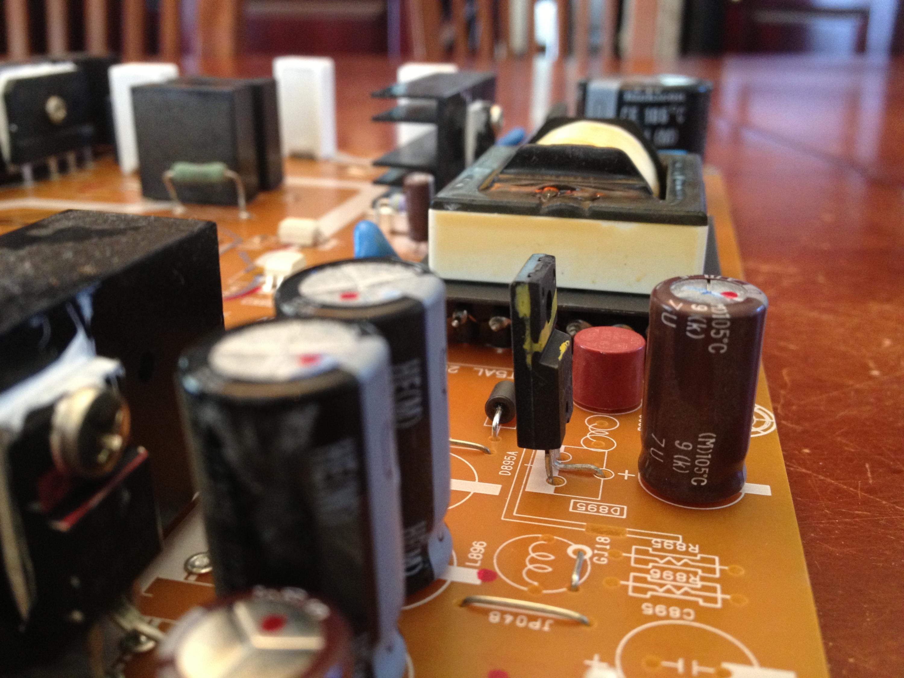

                        if you refer to the 4th picture you can see C821 and I noticed an ever so slight bow compared to the other large ones. But like I said minimal.
                        How do I check this ...."the voltage across the legs of C820 & C821 which are rated at 450V dc."

                        Where do I check the voltage on both sides of the white ceramic fuse on the Tcon board. Where is or which is the ceramic fuse?

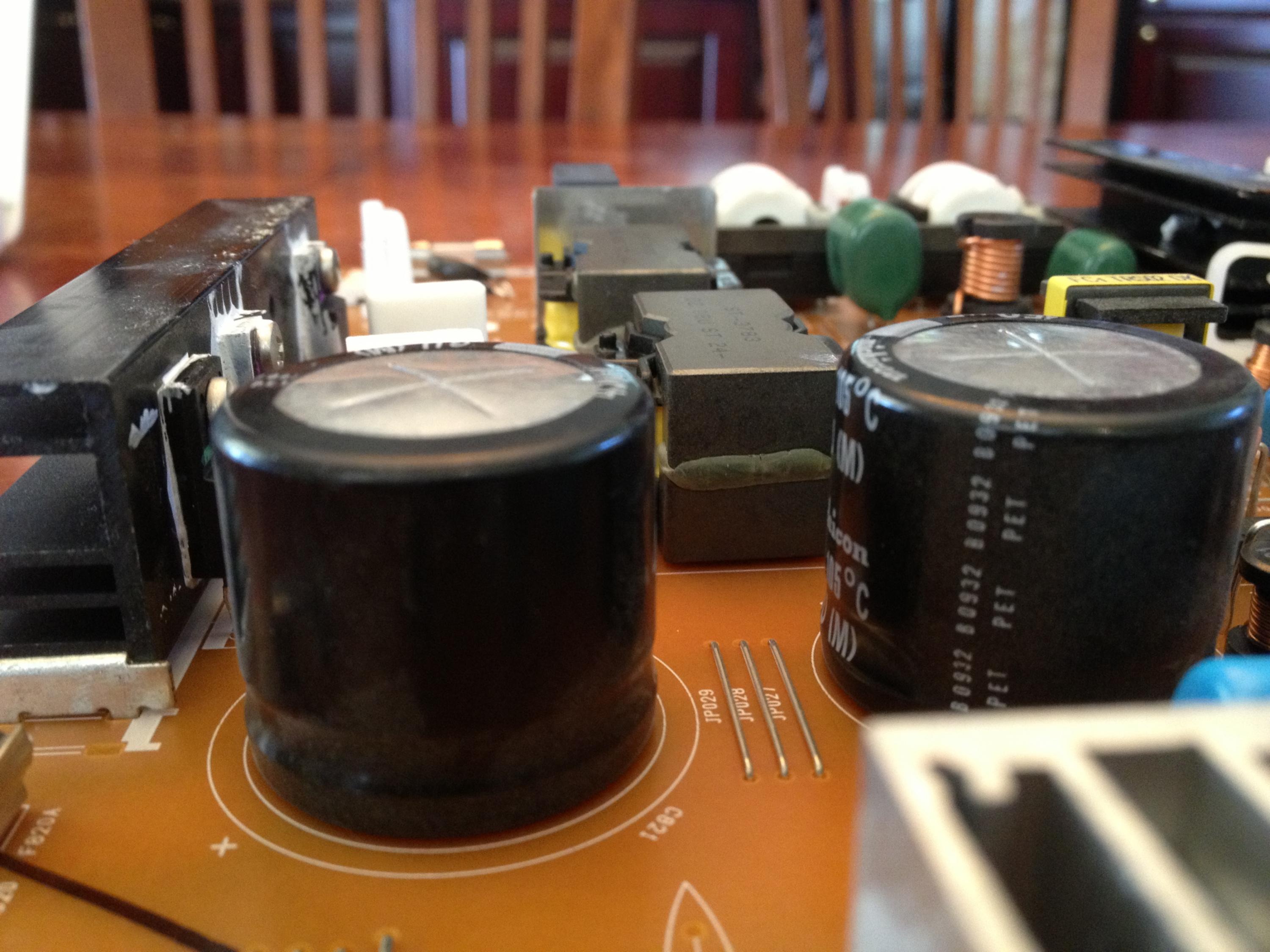

                          If you enlarge image 6 or 8 on the rectifier, I got that reading by putting a probe on each of the squiggle lines ......a probe on each one of those interior legs.
                              The ~ pins are the Line and Neutral AC input pins for the bridge rectifier and it should show 120VAC.
                              • eztiger12
                                • Apr 2016
                                • 44
                                Sorry ....my bad...your totally right. I get a reading of 117.8 on those pins.
                                But I get a reading of 106.5 on the pins just on the outside of those that are identified with a "-" and "+" signs.
                                Sorry about that.
                                  For those you did set the meter to measure DC volage? 120x1.414=169.68V
                                    You should measure right between the +/- legs of the main filter cap.
                                      Yes sir I did .........but I will double check tomorrow but Im 99 percent sure.
