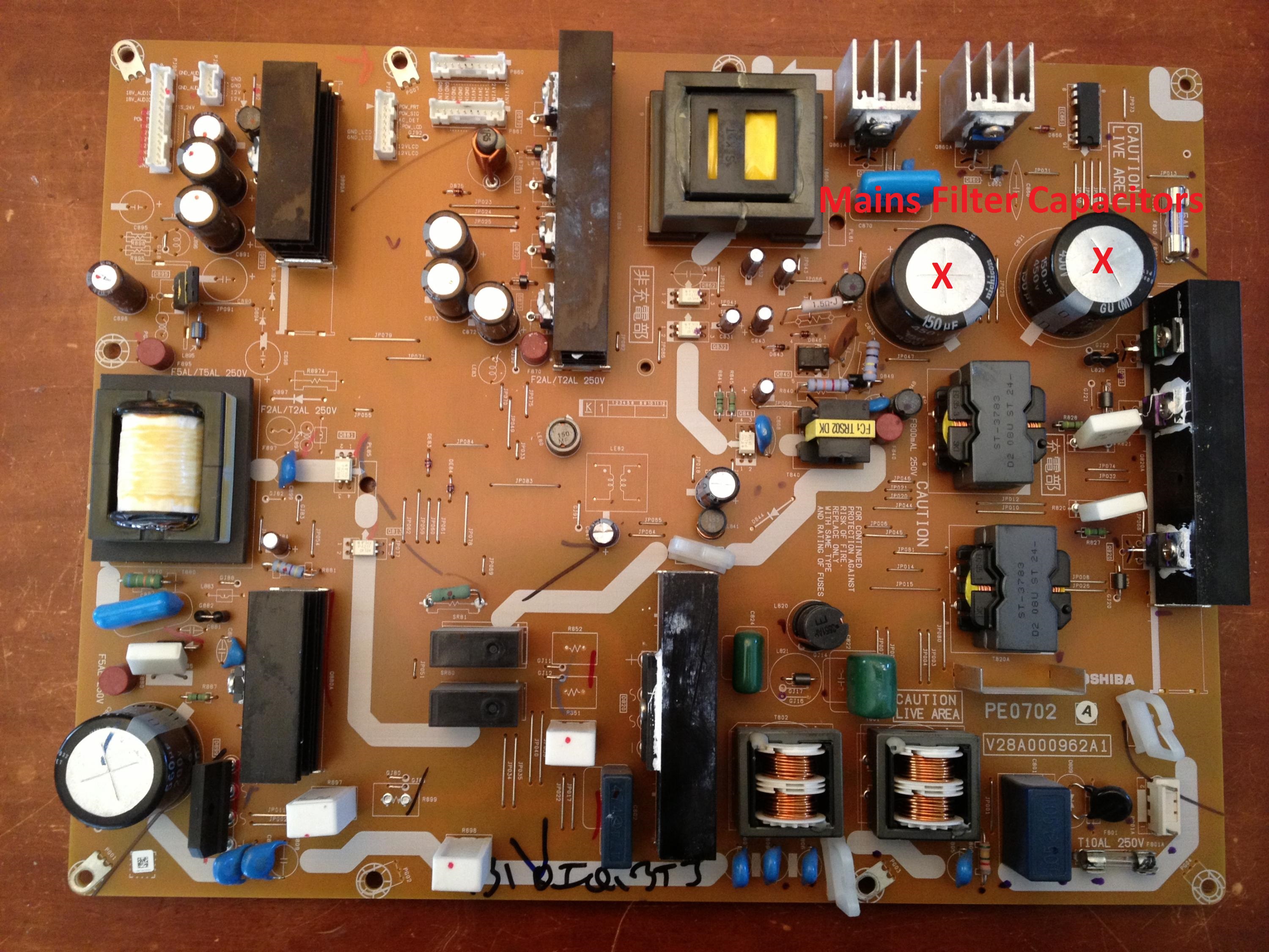

    The wants you to measure the DC voltage direct at the legs of the main filter capacitor. It is the biggest, high voltage capacitor(s) on the primary side of the PSU. Look for some 450V caps. Be careful there can be 400V DC on there when the PSU is up and running. All measurements in the primary side of the PSU, your ground reference point is the negative post of the primary main filter capacitor. The ground reference on the secondary (output rails) is plain GND.

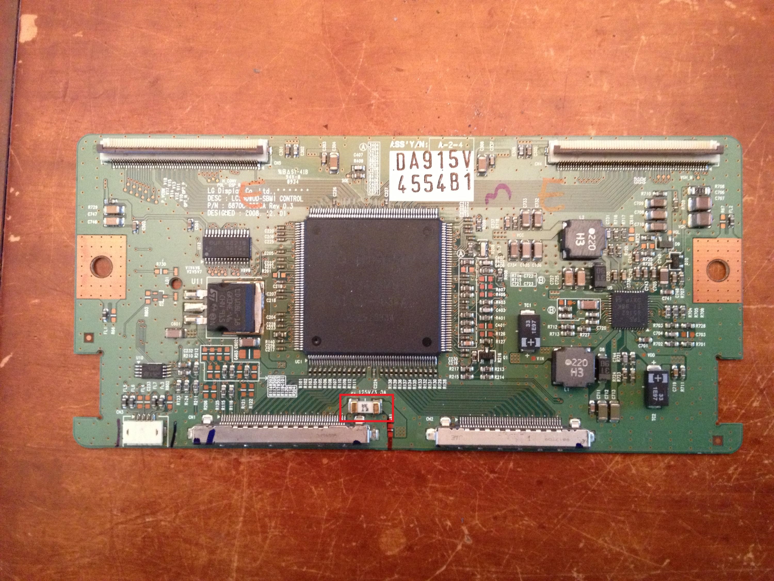

      With the power to the TV off, put your meter on Ohms and place red lead on one side of the fuse and black lead on the other side of the fuse and tell us the reading.
      Fuse is in the red box. See photo. (T 3A written on it)

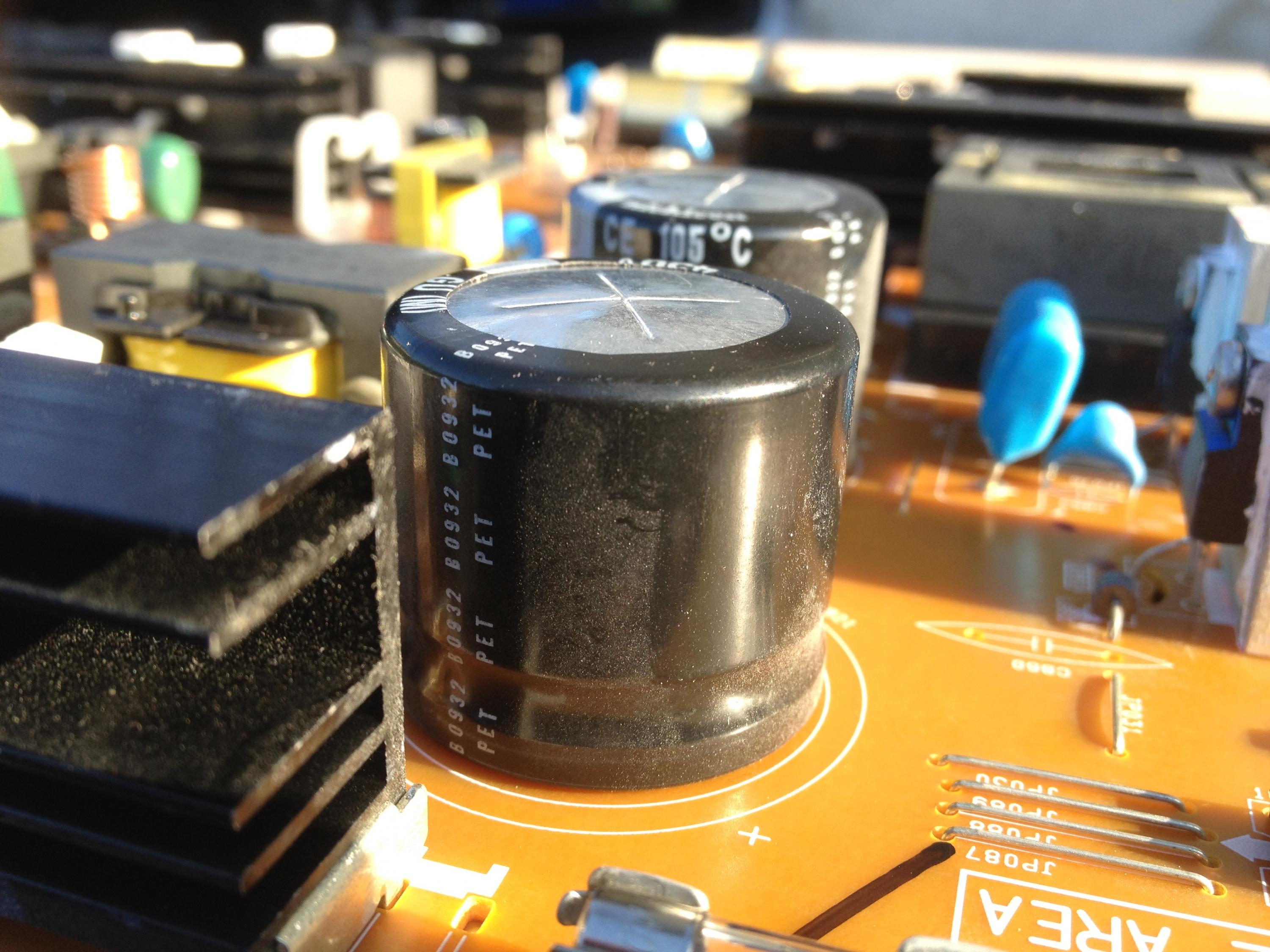

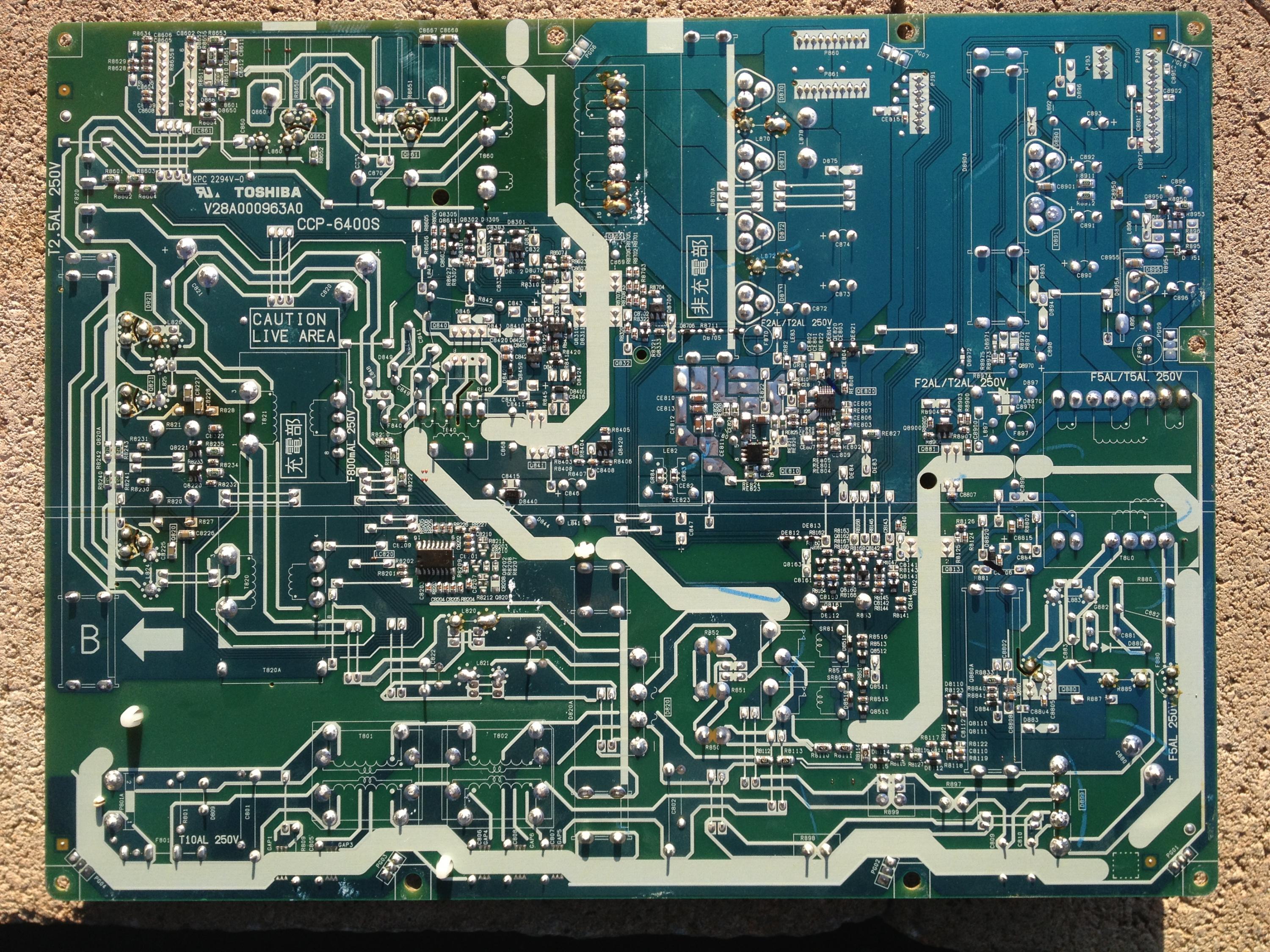

        One of the mains filter capacitors looks as though it's failing!!
        Can you post a sharp picture of the underside of the power supply board.

          Re: Toshiba 55ZV650U REGZA sound but no picture
          Dick Barton
          help me out here plz....
          Where do I check the voltage on both sides of the white ceramic fuse on the Tcon board. Where is or which is the ceramic fuse?
          where do i check the voltage on the 12VLCD pins.
          In Post #6 the area boxed in red on each photo is where you check the voltages.

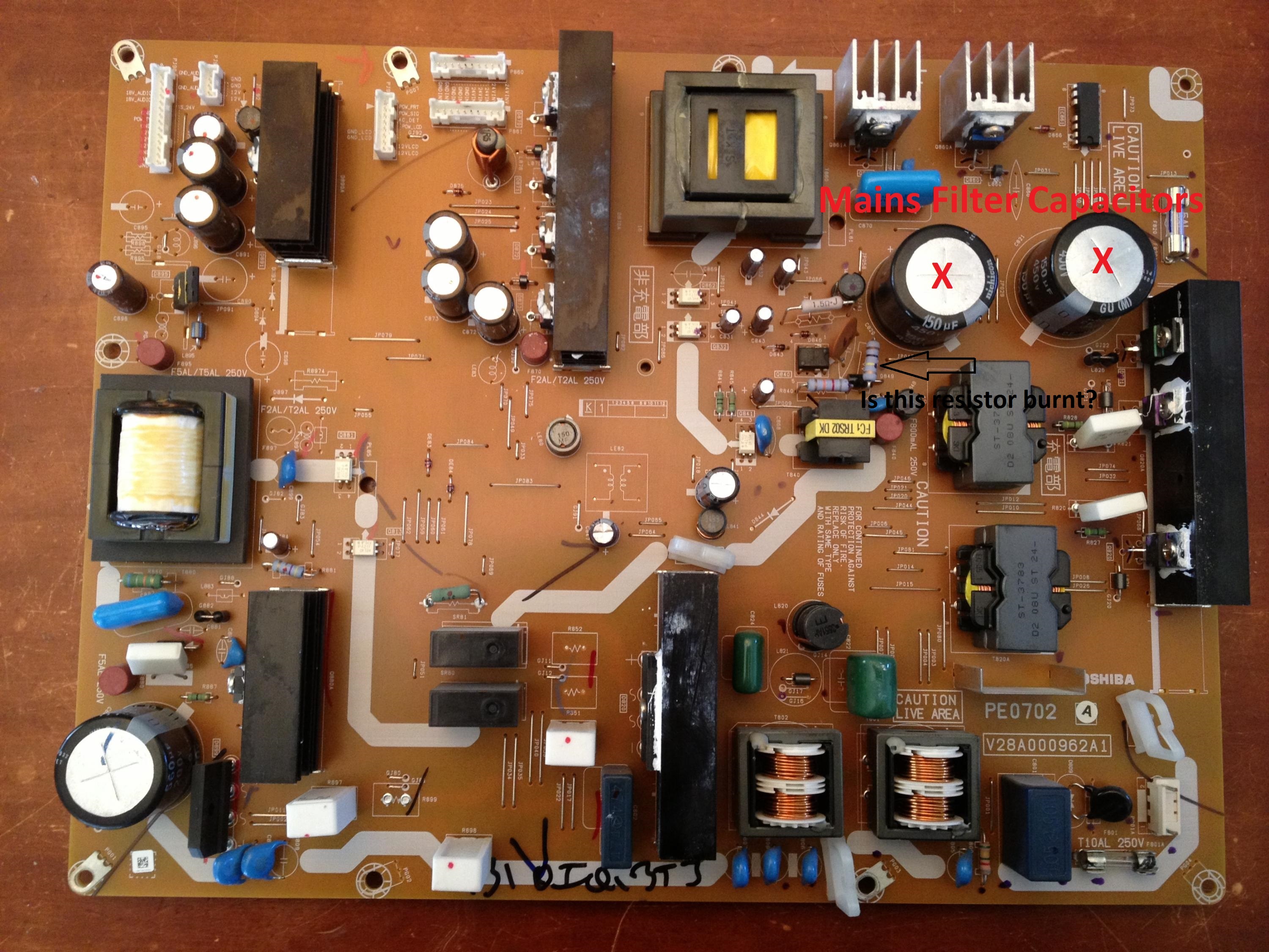

              If you post a clear, sharp picture of the underneath of the board we can show you where to check the main filter capacitor.
                Mains filter capacitors as in photo with X identifying them both.
                  There seems to be a dark spot on the resistor which I have marked. Can you measure the ohmic value.

                    #29
                    Got it you guys are amazing........
                    I checked Caps C820 an C821 with the TV plugged in but I unplugged other plugs to the board in order to get to the back of the Caps. This is the results:
                    DC on the multimeter was 165V for both caps marked with and X.
                    Did I do the test right by unplugging the other plugs in order to get to the back of it and just leave the AC plugged to the TV.
                    and just to make sure I was doing it right to see what kind of reading I would get on AC, I tried it and got 360 on AC on both caps.

                      #30
                      I fairly certian they are the expected readings. Now for that resistor value. And don't forget to also check the TCON fuse resistance.

                        #31
                        See the white line that goes across the power supply? It will indicate the primary vs the secondary side of the power supply. In the picture above, the lower part and the right side is the "hot" or primary side. THe top left is the secondary or "cold" side. Same on the back side of the power supply. Why hot and cold? The primary side is connected to the mains, the cold side is separated.

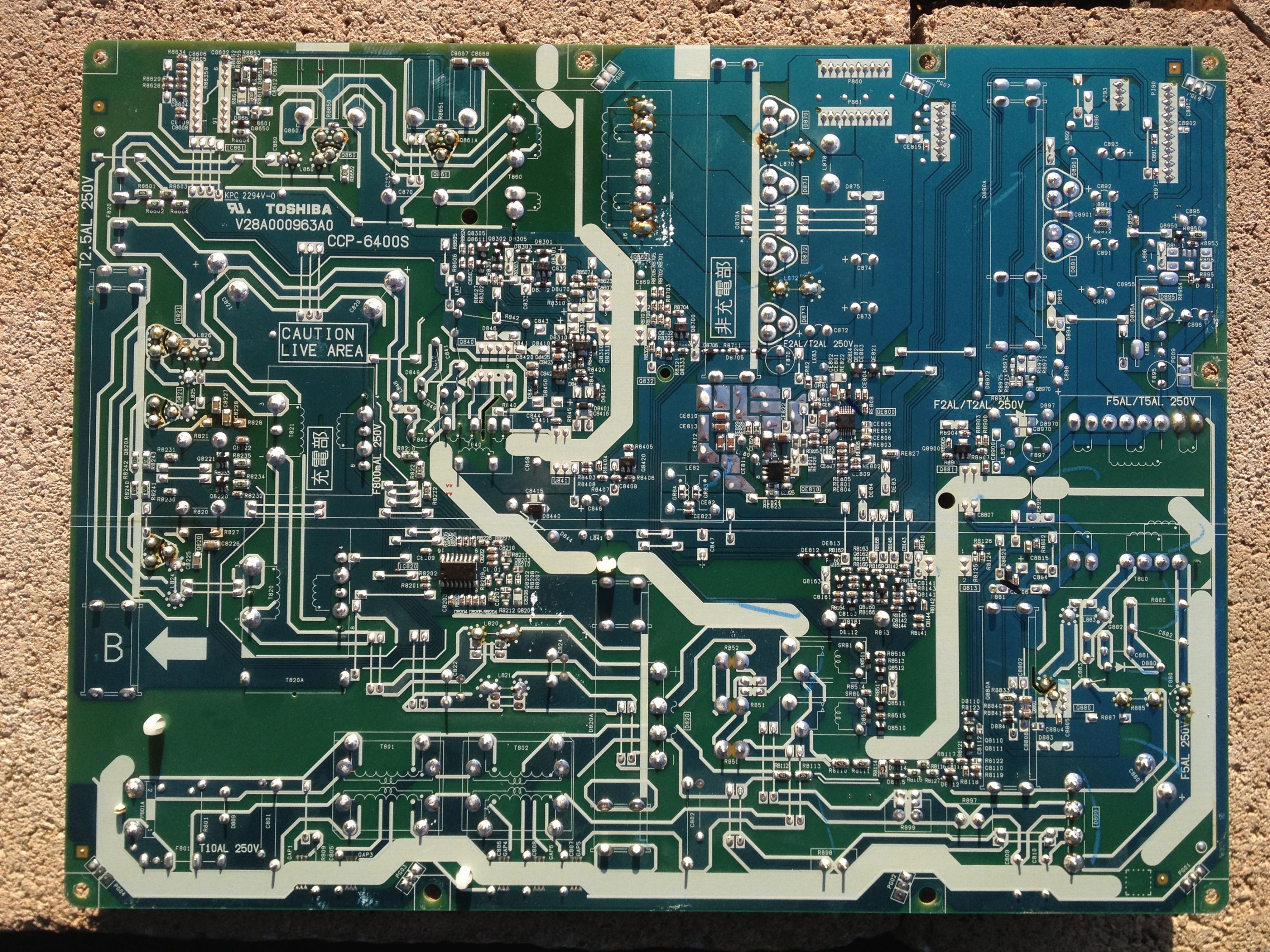

                            #33
                            Hey fellas,
                            Please standby, as soon as I get back home (doing my duty as a son on Mothers Day)......lol.......I'll post:
                            1- picture of the back side of the power supply
                            2- Value for the resistor with the black spot
                            3- The result of the fuse on the T-Con
                            If there is anything else I can test or take a picture of please let me know and I ll add them on my next post thanks.
                            It feels like Im actually getting somewhere with this issue .

                              #34
                              Ok some more results: T-con = .3 is the reading when the TV is off and I also did it with the TV on incase it was of any use , it was 5.0.
                              Value for the resistor with the black spot.......no reading
                              I also add the picture of the back side of the board which I hope will help pin point the culprit.
                              Also add a picture of the Cap C821 in case you can see the ever so slight bow on the top.
                              I hope this info will help.

                                #35
                                I reckon that you should be considering replacing C821
                                The Tcon fuse . You read 5V dc on both sides of the fuse?
                                Did you measure the resistor with the black spot with the set off and you meter leads across each leg (either way) with your meter set to ohms If it read nothing then you need to replace it. Are the colour bands on that resistor brown, black, yellow, gold (100K)
                                There are also fuses marked f870, f895 and f840 which you can check with the set off using your meter set to ohms.

                                  #36
                                  Tcon fuse TV off = .2 both ways
                                  Tcon fuse TV on = 5resistance
                                  Tcon fuse TV on .01 DC volts
                                  Resistor with black spot gives me reading with the TV off set on ohms gives me nothing and when I switch the probe around I get a negative reading starting at around -1600 and kind of settles at -1480
                                  yes the brown black yellow gold

                                      #38
                                      All resistance readings are with the tv off. If you measure DC volts on the cold side, put your meter in DC mode, put the black probe to GND or chassis GND and with the red probe both sides of the fuse.

                                          #40
                                          The resistor is open. Open resistor = bad. Also I would change that capacitor, as it is at the end of it's life.
                                          There may be something else in circuit too that is bad. So more testing has to be done.
                                          Again, in order to measure resistance, turn the TV off, unplug it and put your probes on the component you want to test.
                                          Warning: Some meters will explode if you use them in Ohms mode and connect them to AC mains voltage. Be very careful in the primary, some parts can have 400V DC on there, some heat sinks maybe actual hot (as in power) too.
