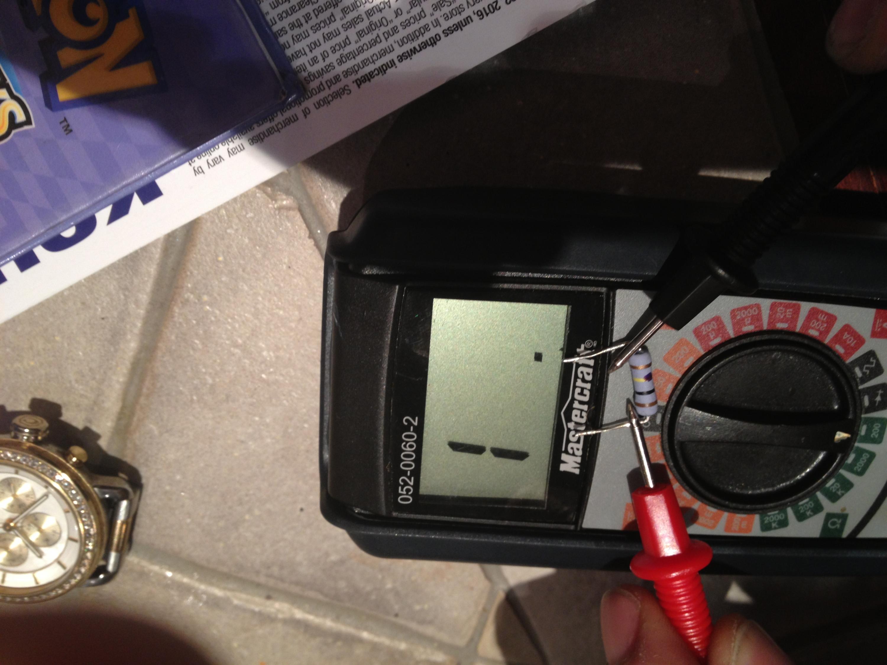

    The 100K resistor is the part of the RCD snubber circuit for the STBY power supply, so measure that resistor off the board, it is very rare to have bad snubber resistor and if it is open the the STBY will not work properly and SMPS IC can be be damaged.
    BTW: 'and just to make sure I was doing it right to see what kind of reading I would get on AC, I tried it and got 360 on AC on both caps.' You need to check in DC not AC.
    So far we have backlights but no pictures on the screen so we need to find out for sure if we have DC on both ends of the SMD fuse on the T-CON board or not.

      Ok, as for the T-con, I tested DC volts and do not have a reading weather the TV is off or on. I reversed the probes and nothing still. The way I checked it was by putting a probe on each gold metal end of the fuse (The fuse that you circled in red on the picture I posted).
      I will soon check the resistance of the snubber resistor and post the results.
      I will hold off in ordering parts so I can do it in one shot (order all at once) in case we discover other needed parts unless you say otherwise.

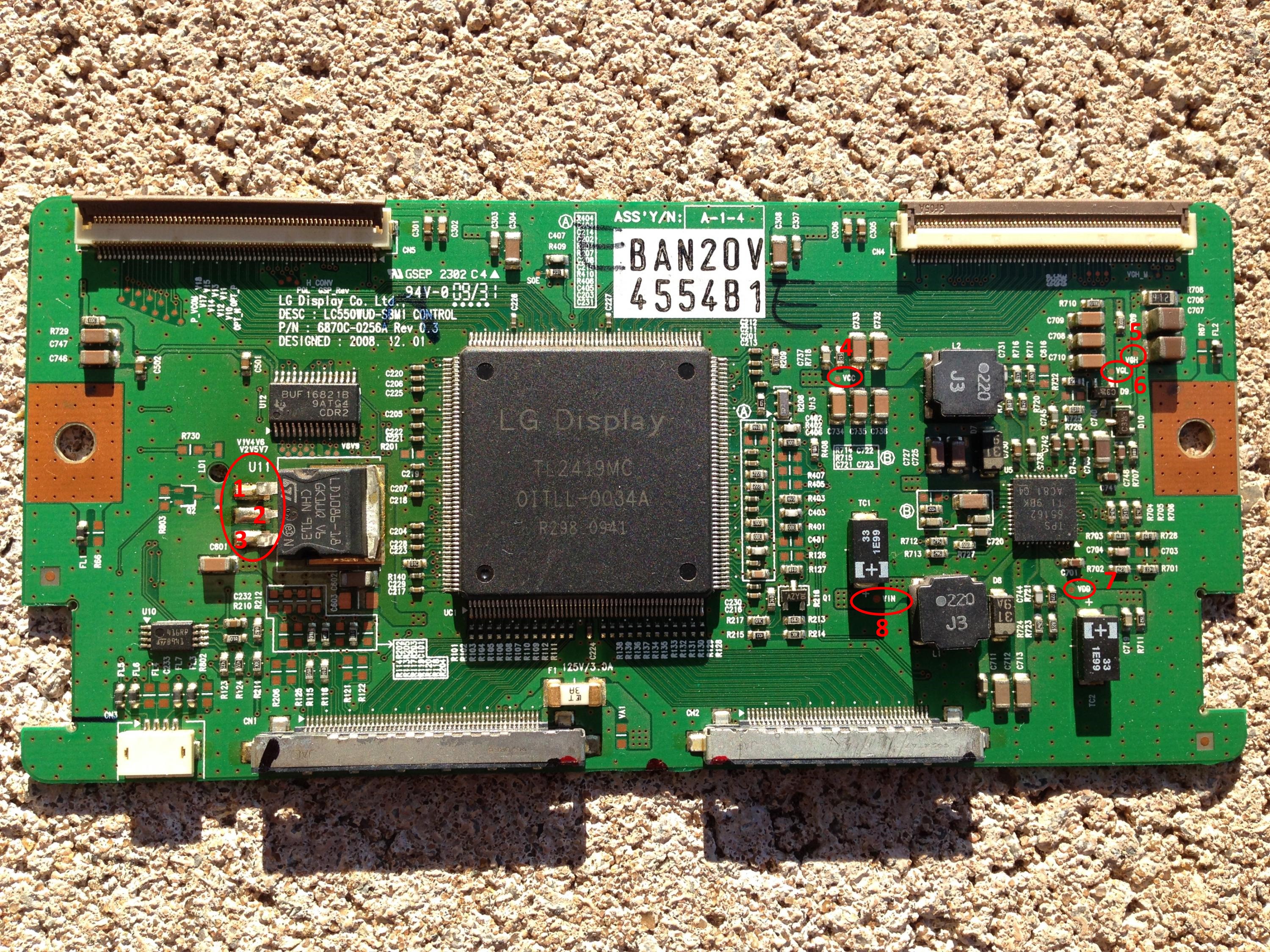

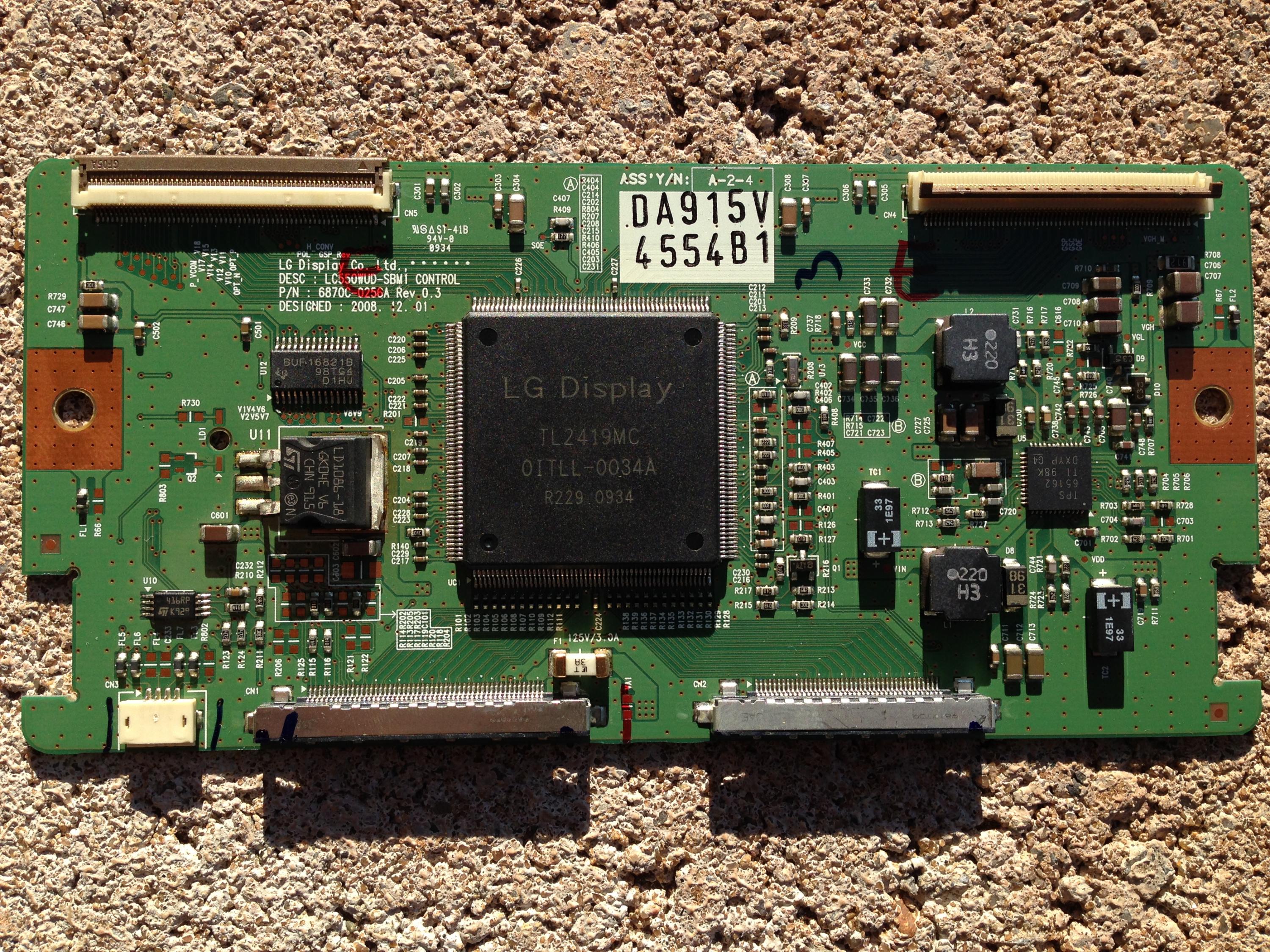

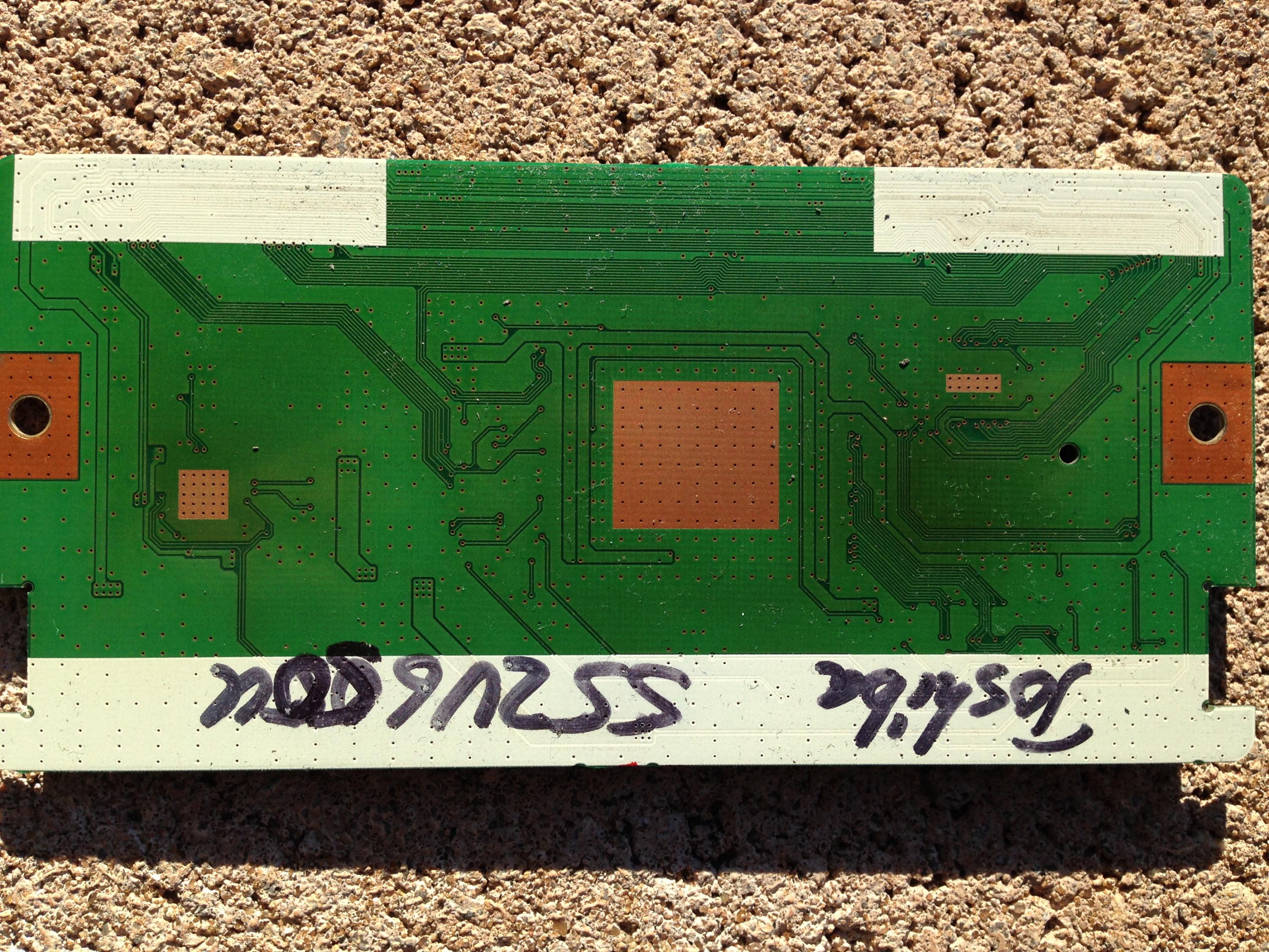

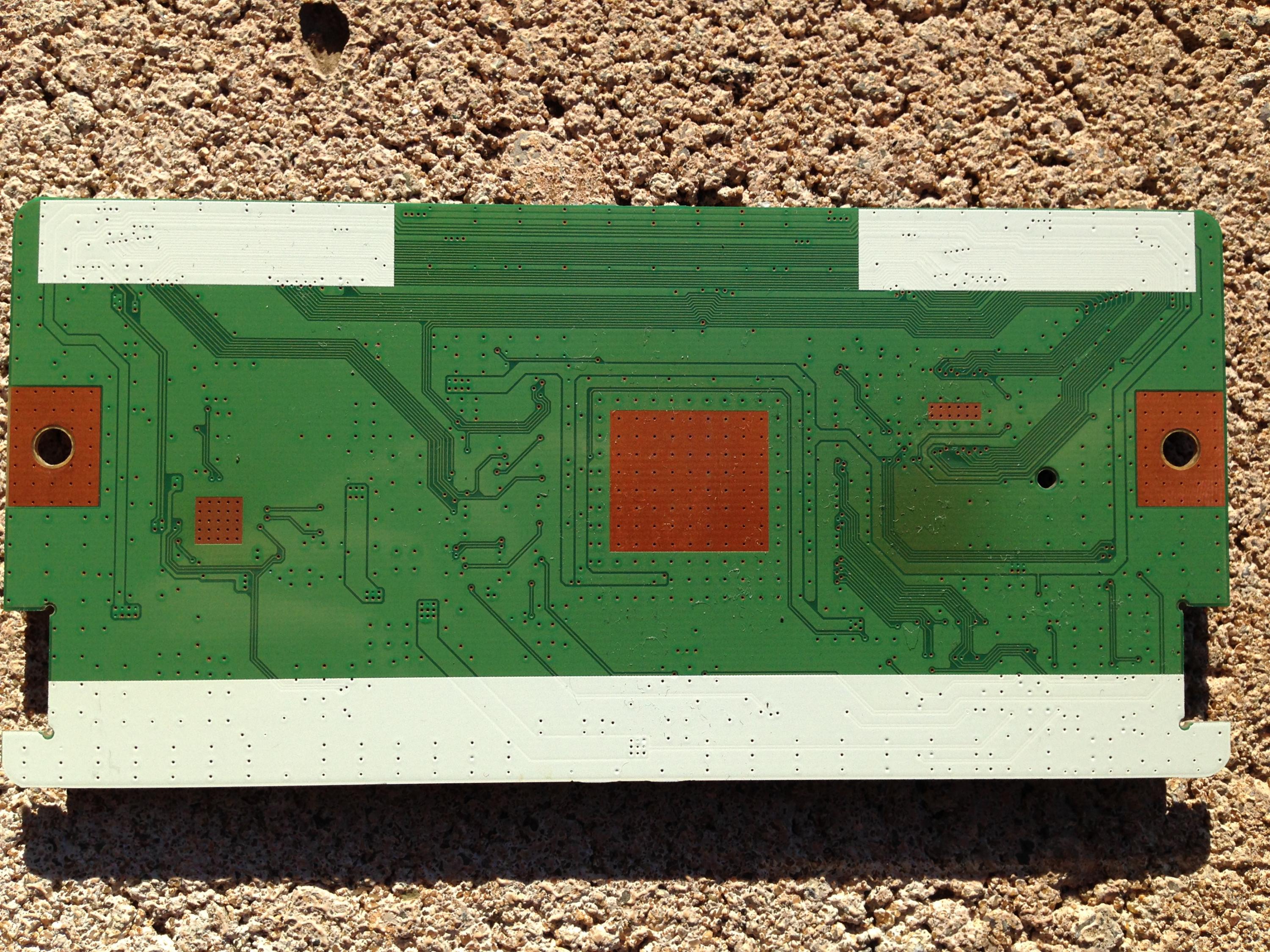

                        Ok here are the pictures of the T-Con. Picture 001 is the front and 002 the back of the T-Con I purchased off the net thinking it would fix my issue. Guess what ......it didn't. Pictures 003 and 004 is front and back of the original that is back in the TV right now. Both T-con's fuses were tested and they both give out 12 v.
                        Hope this helps.....
                        Thanks for everyones patience.

                            OK, lets test DCV at those eight test points I marked on the board. Black probe on the chassis.
                                1 - 0
                                2 - 1.8 on the chip 0 on the board...it does not have a leg connecting chip to board.
                                3 - 3.3
                                4 - 3.3
                                5 and 6 - 0 if your are referring to the white dot that you circled on the board.
                                7 - 16.3
                                8 - 12
                                all done DCV with blk on chassis
                                just hope Im touching the right place with the red probe .......the one I m not sure of is # 2, 5 and 6

                                  5 and 6, the copper circles.
                                    #57
                                    Re: Toshiba 55ZV650U REGZA sound but no picture
                                    I redid the test .......
                                    number #5 I get 26.9 v
                                    number #6 and I get -7........did it 3 - 4 times blk on chassis red on dot.....I finally saw real small dot

                                        Well the Voltages seem to be present.
                                        So as capleaker suggested, now you need an Oscilloscope to see if the signals from the main board are being fed to the T-CON or not.
