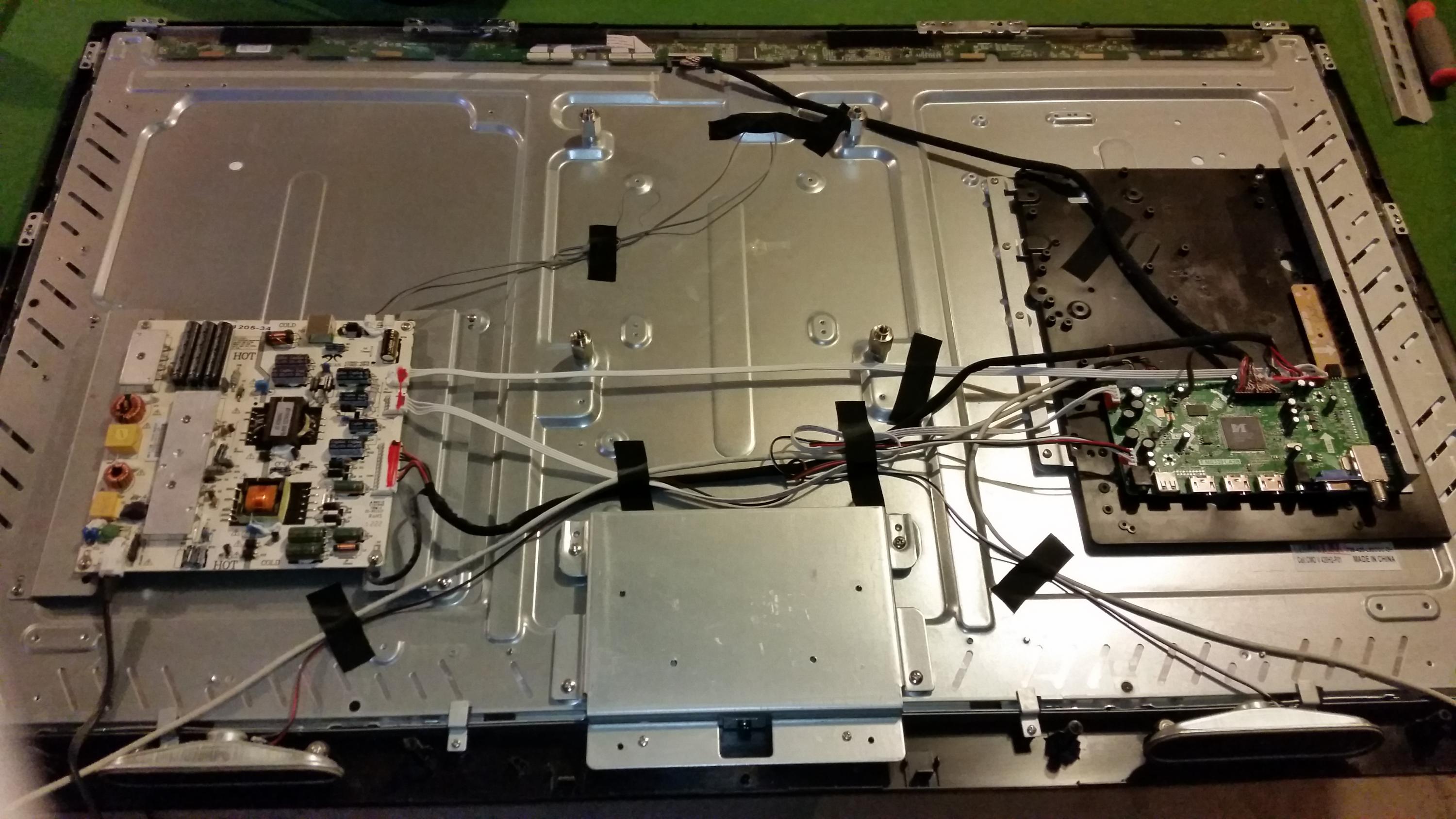

      Re: Proscan PLED4274A-B
      it has an integrated tcon.
      sorry pic of whole tv attached.
      is there a fuse I could replace or jump just to see if it is that causing the problem?
      I haven't seen one with in integrated tcon before and by the sounds of it this tv is scrap if thats the case correct?

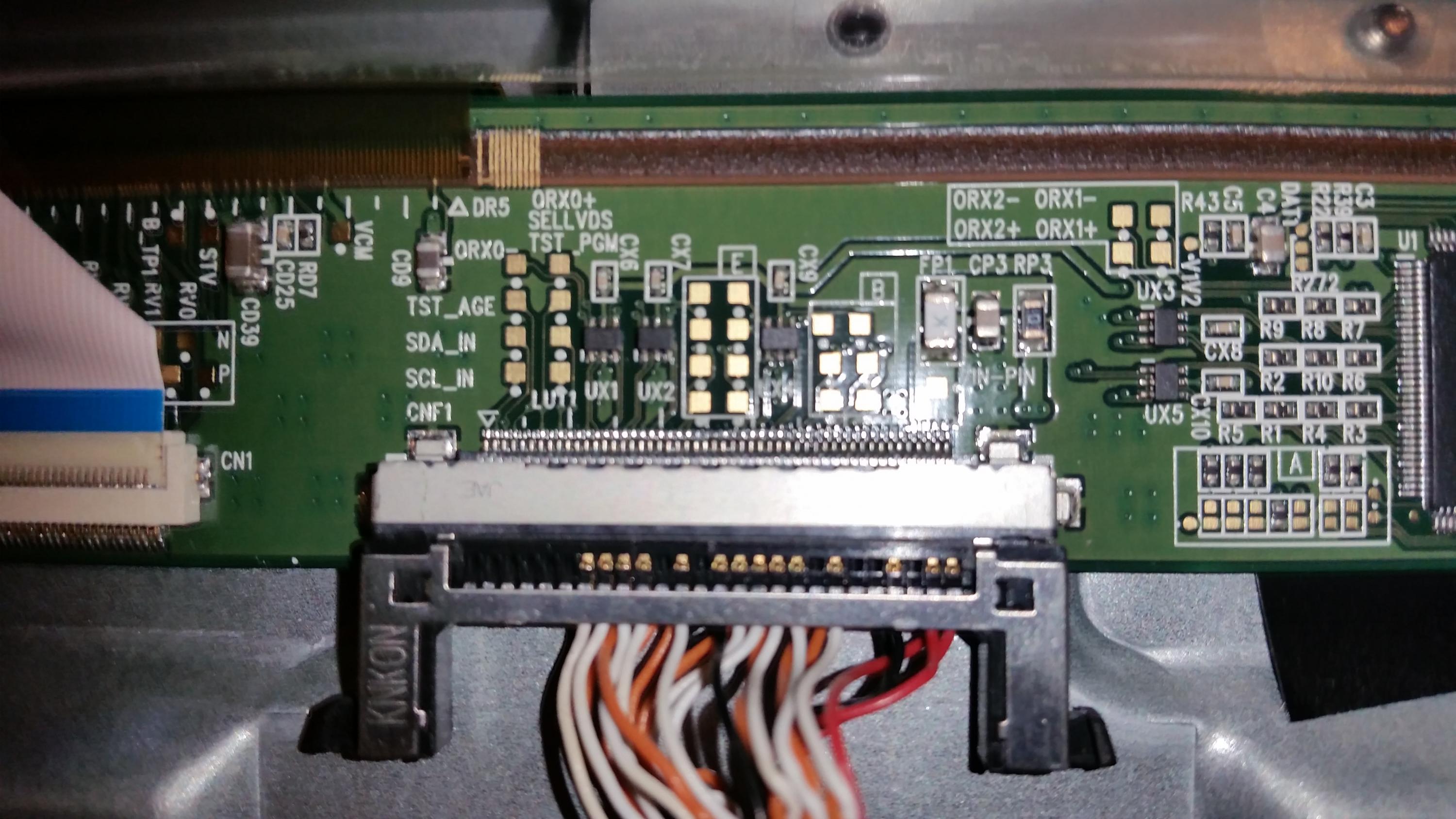

              Please take good clear closed up pictures around the LVDS connector, the fuse should be closed by the connector.
                here is the requested pic. the fuse is the one with the K on it? if so i tested it with multimeter and it shows to be fine.
                is there anything else i can look at on this integrated tcon that could be the problem and could be replaced inexpensively.
                    yes thats the fuse what dc voltage do you get on each side of the fuse
                      I bet you the fuse tests good and all the other voltages do. I had same panel with shorted tab bond driver causing no image at if thats the case not fixable Pure modern junk !

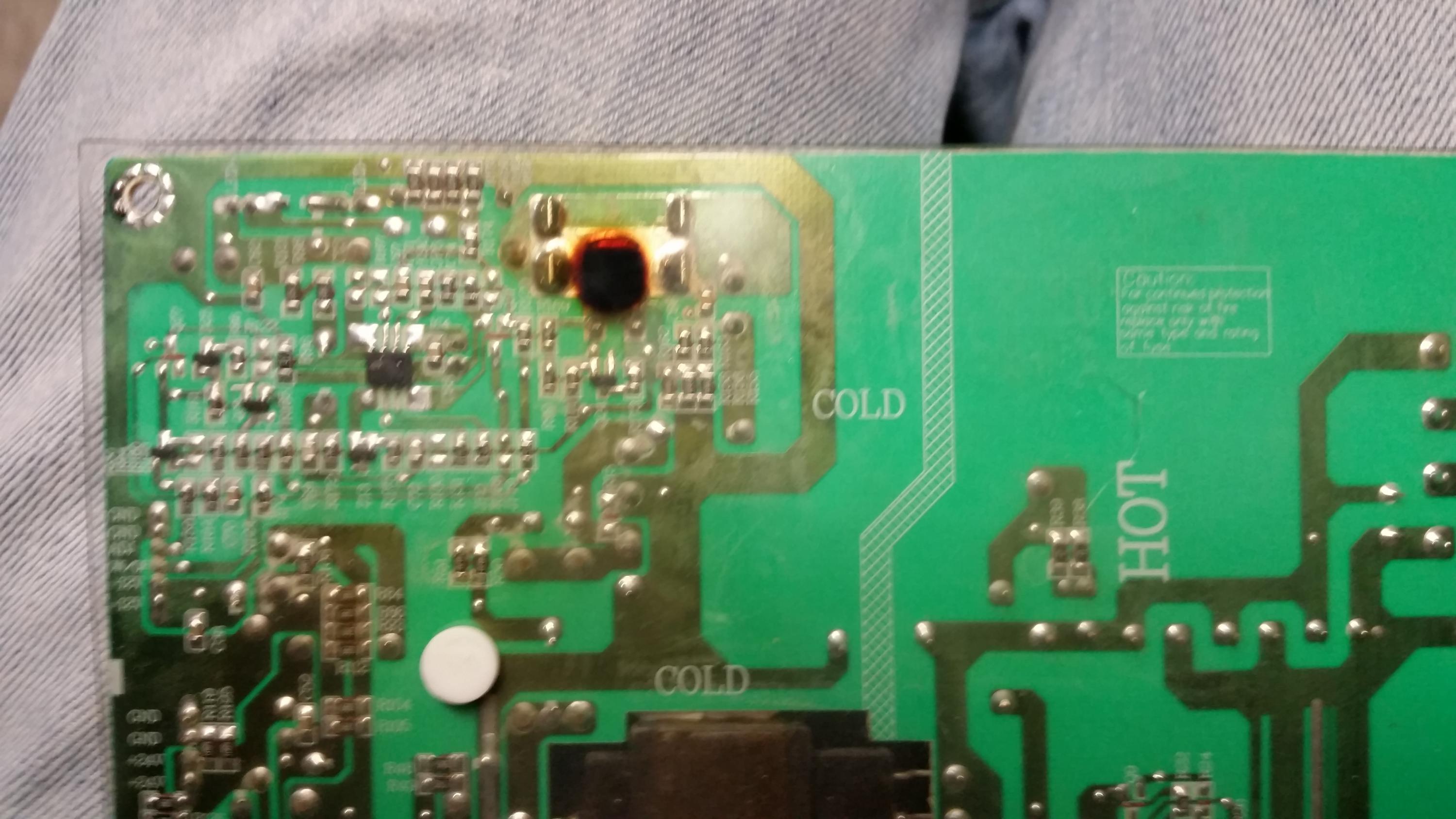

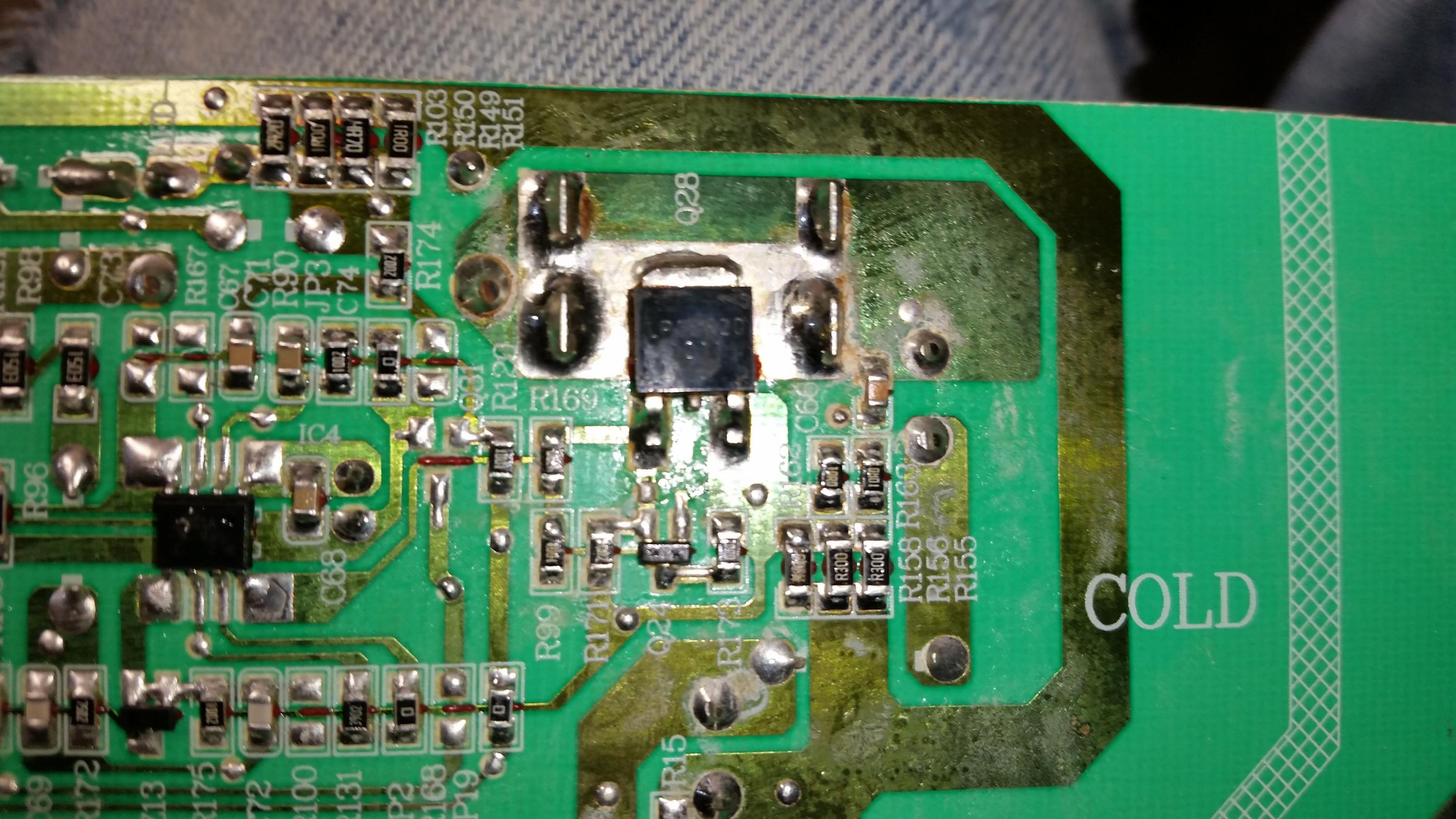

                          upon further inspection i noticed a small burn mark on the plastic beneath the power supply above a fet listed as LP18n20 1211.
                          could this be the problem here?
                          • dick_barton
                            • Aug 2015
                            • 6642
                            • Wales
                            Can you check the resistance of the Mosfet. It looks as though it may well be damaged.
                                      You can find out if that MOSFET is functioning or not in the circuit by checking the DCV on each pin of the MOSFET when TV is off and when power switch is activated.
                                      • smuddge
                                        • Feb 2012
                                        • 96
                                        just wanted to update this for anyone else with this tv. it was the mosfet. changed it and it is working great. thanks for all the help here.
