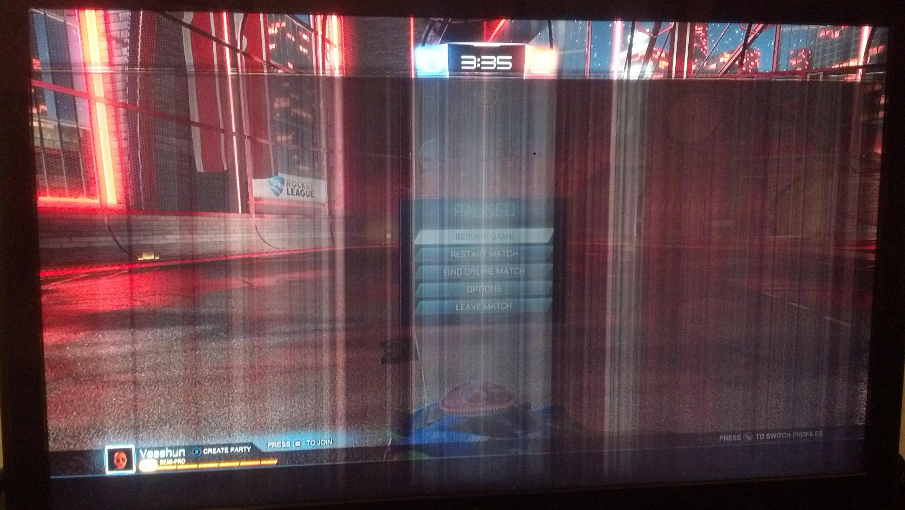

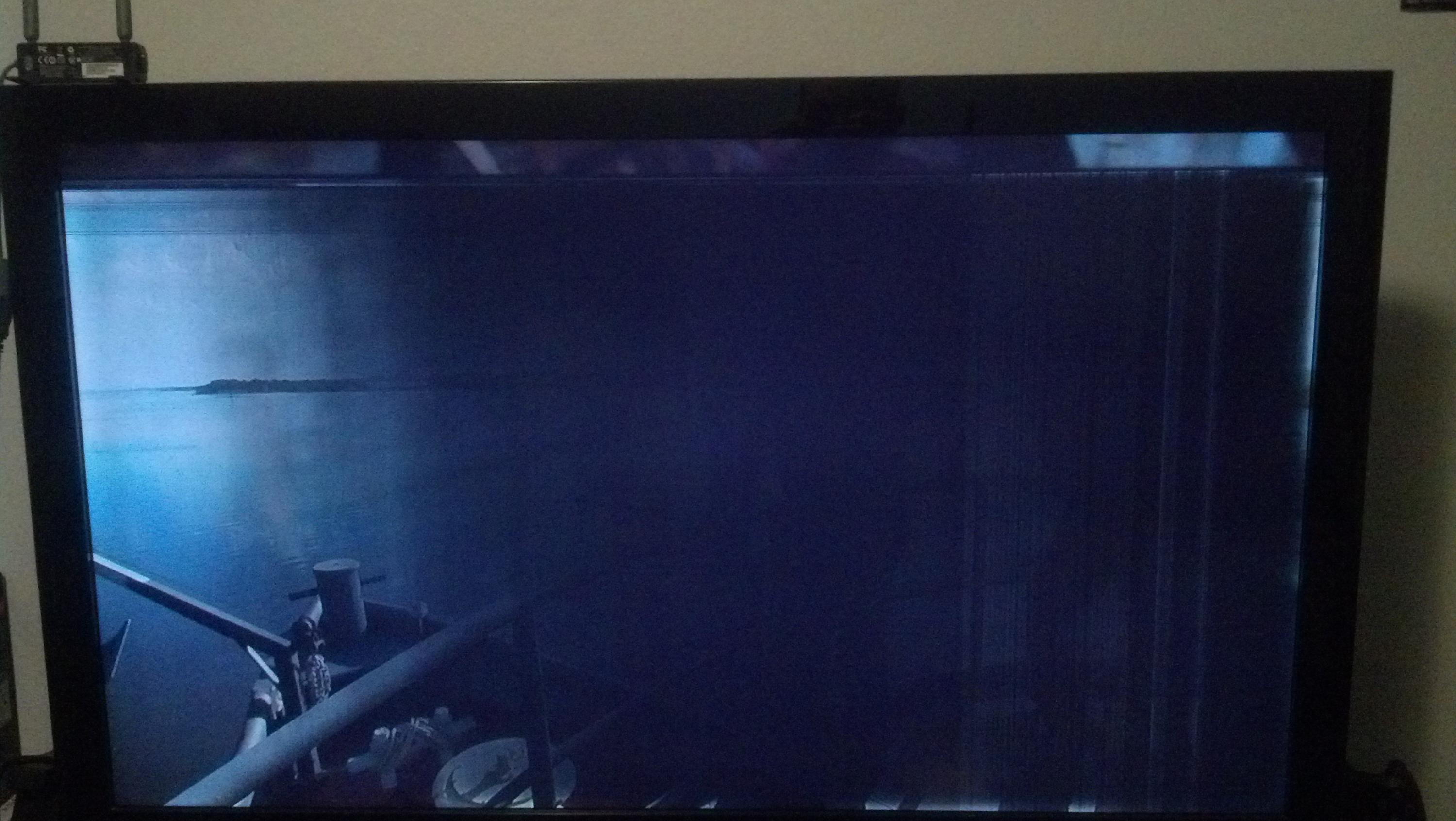

    For the last couple of months I've been dealing with an issue that I cannot seem to find anyone else having. I bought the 42LD550 exactly 5 years ago, this TV is not in the living room so it does not get as much use as the other TV.
    The first time it did this was last winter (2014) but it only did it once and never again. About the middle November this issue started up again, I noticed it was always in the morning or at night when the TV would be off for awhile. I haven't been able to fully prove it but it seems to happen when the room is cold. I'll turn it on, it will be fine for about 5-10 minutes then about 95% of the screen will freeze, fade with lines on top and the image will refresh in which the process repeats again (see videos below for example). The top 5% of the screen is fine with no issues. The sound works fine. If I turn the TV off for a couple minutes (sometimes I can just turn it on and off) it will be fine with no issues at all for the rest of the night/day. Tonight was the first time I just left the issue alone, it landed up stopping after about 2-3 minutes and was fine. Some days it won't do it at all for a few days then it'll come back randomly.
    I also noticed after I power cycle it that sometimes it'll blink to a black screen very quickly about every 60-120 seconds. This will go on for about 5-10 minutes then stop. The blinking is very quick with no issues with the sound. Just like the issue above after it stops it doesn't come back.
    I've been searching weekly since November for answers, I've looked all over google and Youtube. I haven't found any pictures or videos that match my issue. I've also asked for help at other places with no luck. I just want to know if I can actually fix this or should I be shopping for a new TV (which I hope isn't the case )
    I've included pictures and below is two video links. The first was from last year and the second is from tonight.

    Well being an LCD this will be easier to diagnose then a plasma. From my experience this does NOT look like a bad or failing panel which is pretty much the kiss of death and replacement is cheaper then a panel!! That leaves us with
    -power supply
    -TCON board (timing control)
    -digital main board
    Best step for you at this point would be to unscrew the back cover and snap a few pics. Some knowledgable folks can chime in. Inspect the capacitors on the power supply board. Have any of them bulged or popped their tops? There is a very good chance this could be a TCON board that needs replaced. If that's the case, they are fairly cheap for this make/model.
    Does this symptom occur on all inputs? Aka: hdmi 1, hdmi 2 etc....
    Looks at times, out of sync to me, in which case the timing control board handles a lot of the processing
    Just my 2 cents

      I worry that it's the tcon because if I'm not mistaken, it's attached to the panel and cannot be replaced . I also noticed that the parts for this TV are very hard to find and the ones I found have insane prices.
      It happens on all inputs. I will work on getting a picture with the back panel off.

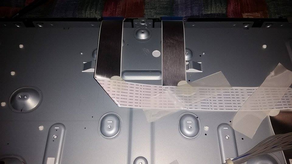

        reseat the LVDS cable and try the tab bonds.

          Actually your partially right. The Tcon attaches to the panel through LVD cables as "cap leaker" mentioned!! Still.....very easy to replace!! 2small screws hold the TCON board in place, you simply lift the tabs up and the cables detach from the board. Very easy to replace!! As cap leaker mentioned being your problem is intermittent, it's worth a shot of undoing the cables and re-seating them
          Not an expensive board

            In my opinion, the fact that there is a narrow strip at the top of the screen that looks relatively normal compared to the rest would lead me to believe it's a bad panel.

              Also what do you get if you have ribbon cables between the T-CON and the LCD panel connected one at a time?

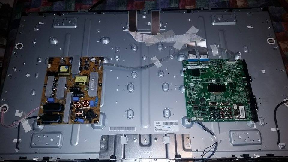

                    I've looked up the model number and SVC number, I've read that the TCON is integrated. On SJ there's no TCON listed for parts.
                    I forgot to add info to my initial post:
                    Model: 42LD550-UB
                    SVC Code: 42LD550-UB.CUSTWLHO
                    Is it normal for it to be fine after a few minutes with no issues for the rest of the day? Some weeks it won't appear for 2-3 days then all of a sudden show up for 5-10 minutes then it's gone again. I think I'm just really hoping that this is not the case, took me awhile to find this TV and I really like it.
                    Originally posted by budm
                    If it uses the same panel as this one then it uses integrated T-CON.
                    https://www.badcaps.net/forum/showthread.php?t=34539
                    It is so important to provide the pictures so we do not to make a guess.
                    Sorry for the delay, had a very busy day at work. I will be removing the back panel this weekend and will take pictures to post on here.

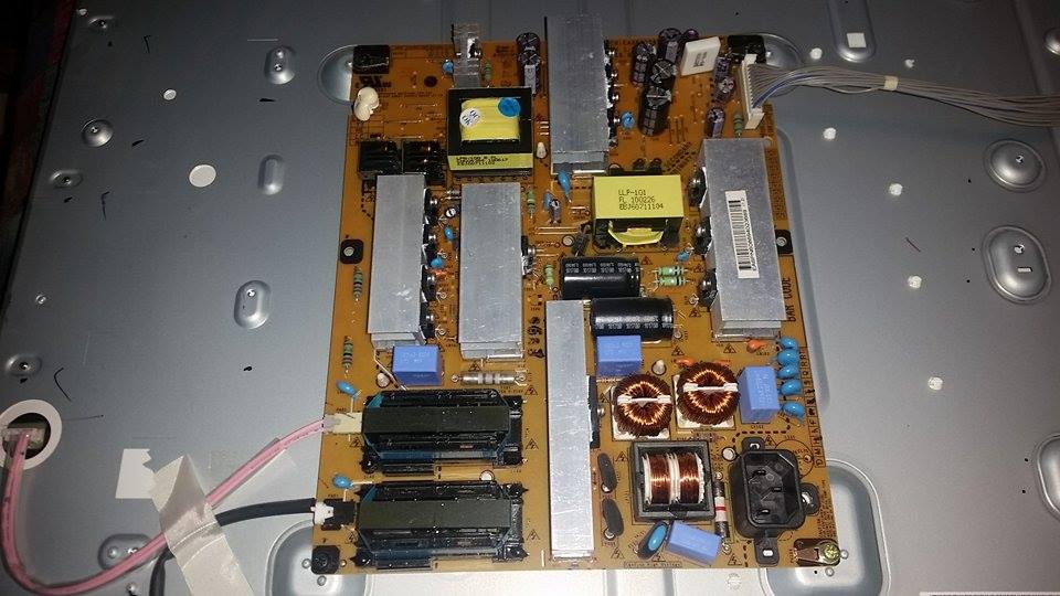

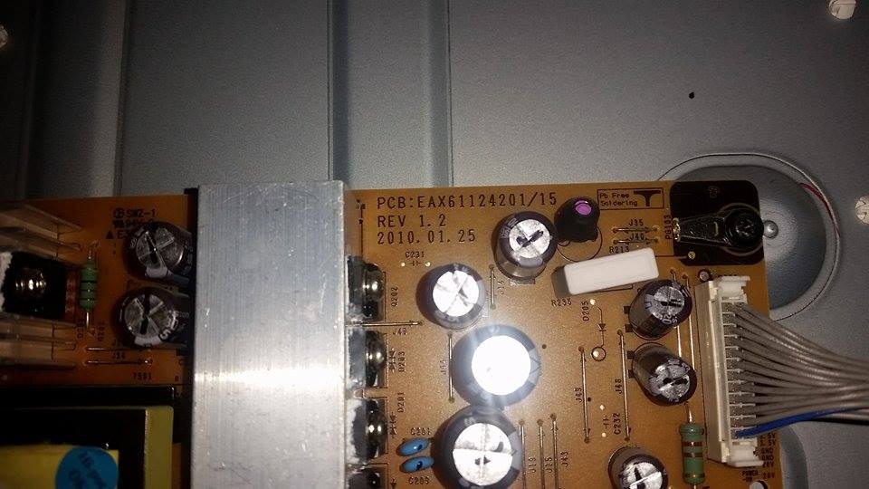

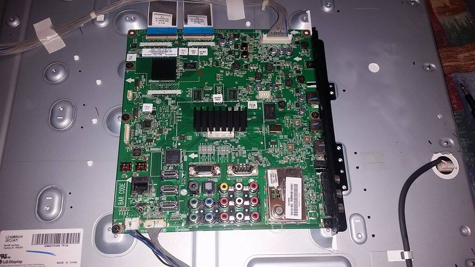

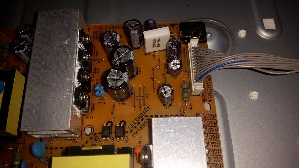

                      Sorry for the delay, been really busy with work. I don't have much experience but the only thing I really saw were two caps looked crooked in the last two pictures. Here are the pictures I promised:
                      • CapLeaker
                        Leaking Member
                        • Dec 2014
                        • 8352
                        Re: LG 42LD550 issues
                        Don't pay any attention to crooked standing or laying caps. They still function the same.

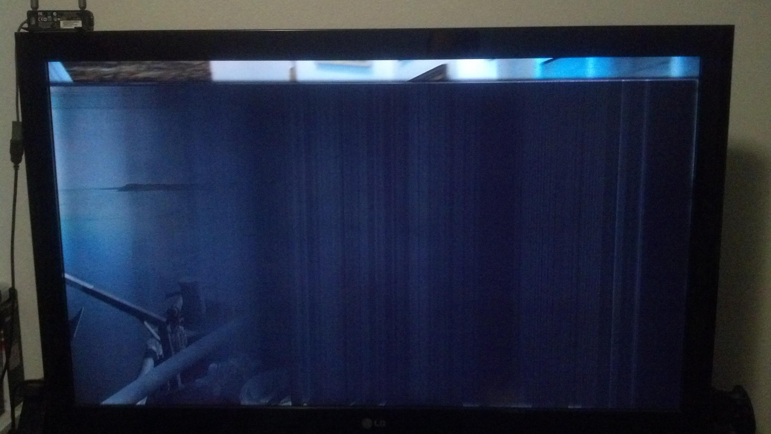

                          Oh okay, just making sure. Does anyone have any idea what the problem might be? Like I said, this TV doesn't have the average amount of hours on it that the average 5 year old TV does. I just hope I can fix it, I really like this TV and researched it for awhile. It's just a shame that these things happen.

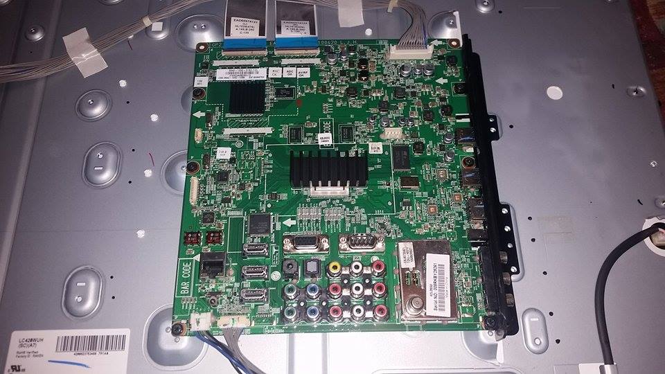

                            which version of Firmware you have on your TV. ?
                            42LD550 suffer from main board bad soldering, main control board Model EBT60955753 LG MAIN (3642-1052-0150)
                            baked the main board in the oven for about 10 minutes at around 385 °F and It will be fine
                              My firmware version is 08.03.06. My main board model is EBT60955753 (3642-1092-0150 (1D)).
                                same source board , baked the main board in the oven never move it out until its cool down
                                  lol so I did what DIAH SAID TO DO AND IT WORKED REVIVED 2 BOARDS THANK YOU SO MUCH.
                                    I used my hotair rework station and just heated the chip along with it's heatsink nearest the lcd cables, I used 285c moving constantly around the heat sink, (I have a small nozzle installed currently)
                                    It's now working fine and if it fails again, I'll try to remember to post back here as to how long the repair lasted.

                                      I use 350C every time and while the heatsink is still on. No damages and no components falling off.
