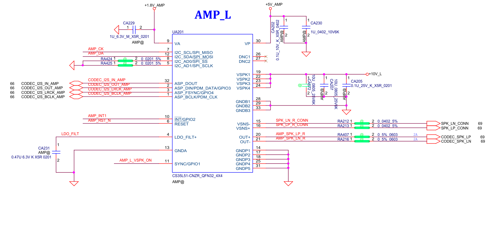

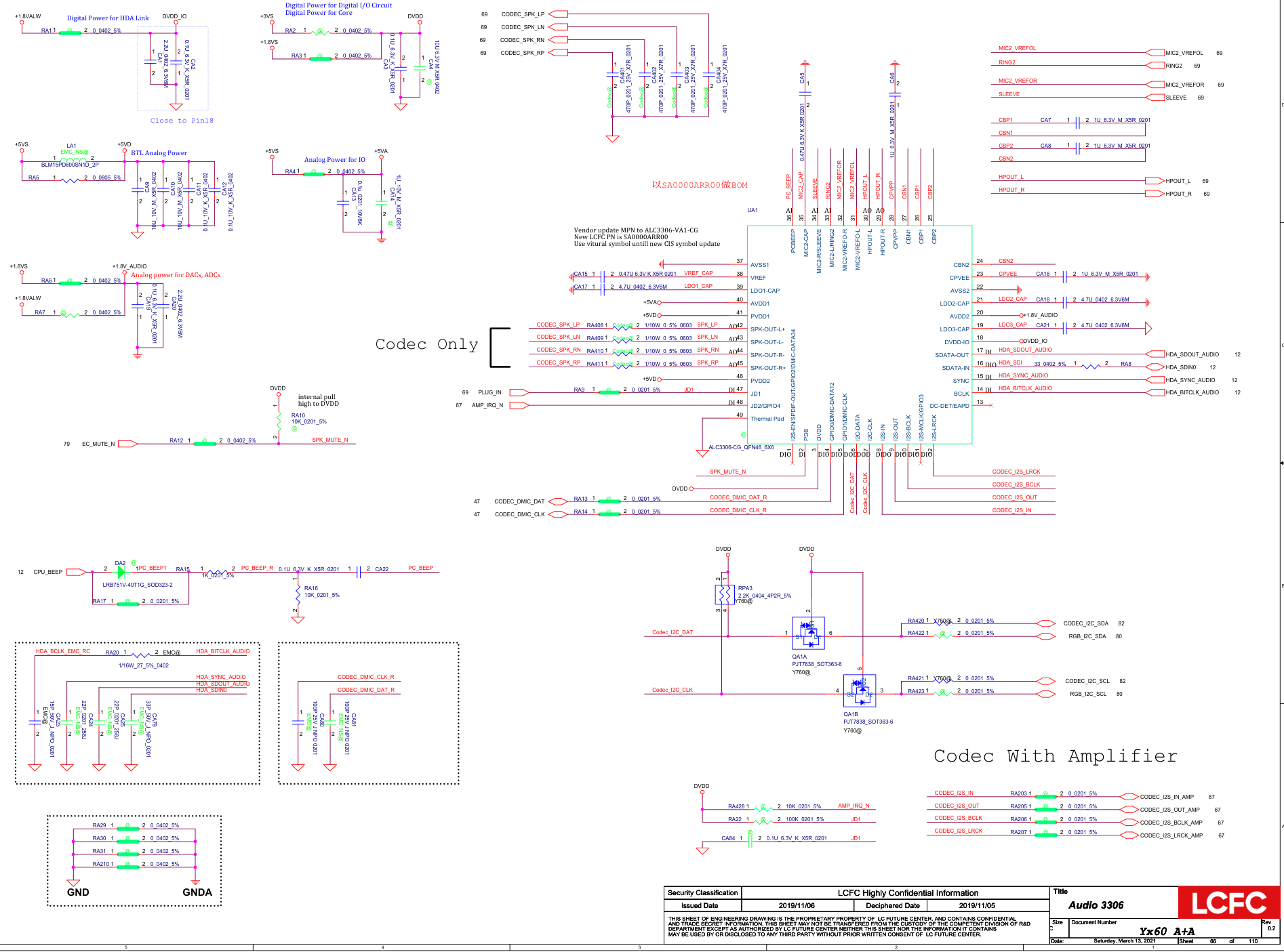

    I found a schematic from a Lenovo Legion 5 (15ACH6A) that has the same codec chip.
    I have some questions. In the legion 5 there are 2 amps, driven by the ALC3306. In my laptop im assuming its just one amp, driving the bass speakers, from measuring with a multimeter, seems the high freq speakers are attached directly to the chip, so are the headphones.
    My question is, in this legion 5 diagram, it says CODEC ONLY on the outputs for both speakers, what does this mean, is this a digital signal? it looks like those signals (CODEC_I2S_**) go directly to the CS35L51 AMP.
    Does the ALC3066 have an ability to switch between analogue and digital from the output pins?
    If thats the case then my hypothesis is
    A. The chip is just not switching to analogue output, resulting in the whitenoise/buzzing from the earphones
    or
    B. The ALC3306 Analogue section is causing the issues, either through bad AVDD power rail. or just he chip having a faulty analogue section.
    Since the fault is intermittent and audio degradation occurs from heat in the rare occasion that it does work makes me lean more towards B.
    Also the fact that the audio is perfectly fine from the internal speakers connected via the amp, but not the ones wired directly to the chip + headphones, points to the idea that the chip has no problem delivering a digital signal to the amp. but only when switching to its internal analogue amp does it have issues.
    All this rests on my hypothesis that the alc3306 has both analogue and digital output capability which can be interchanged on the same pins, and that there is an internal amplifer powered from the AVDD power rail.
    I am not very experienced with how these codecs work so kindly correct me if im wrong and looking forward to anyones ideas.
