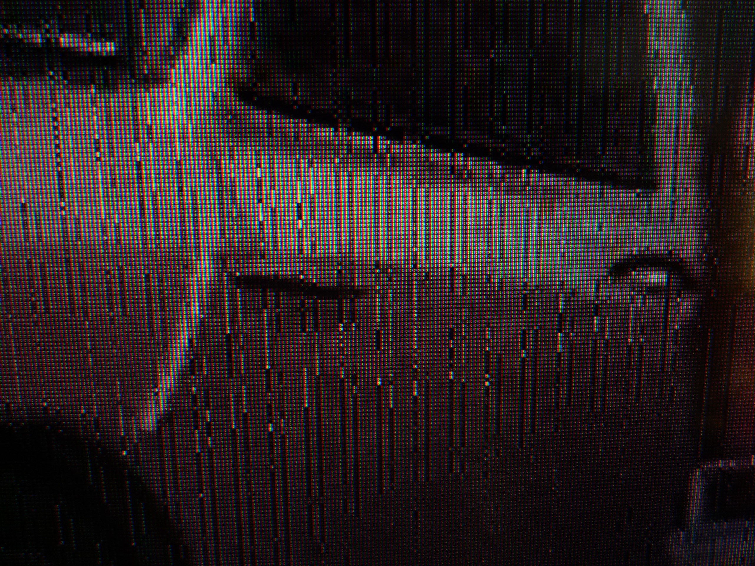

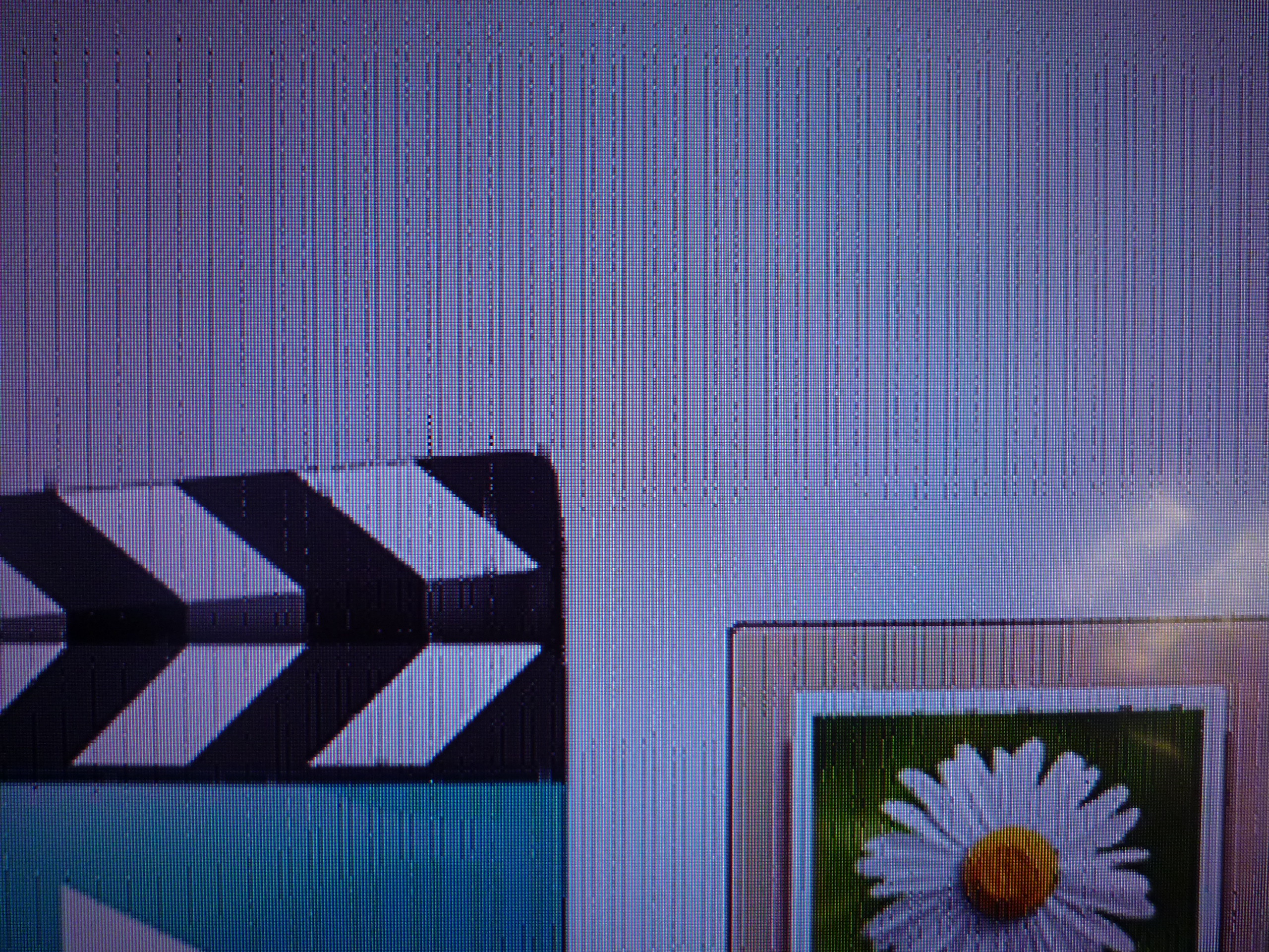

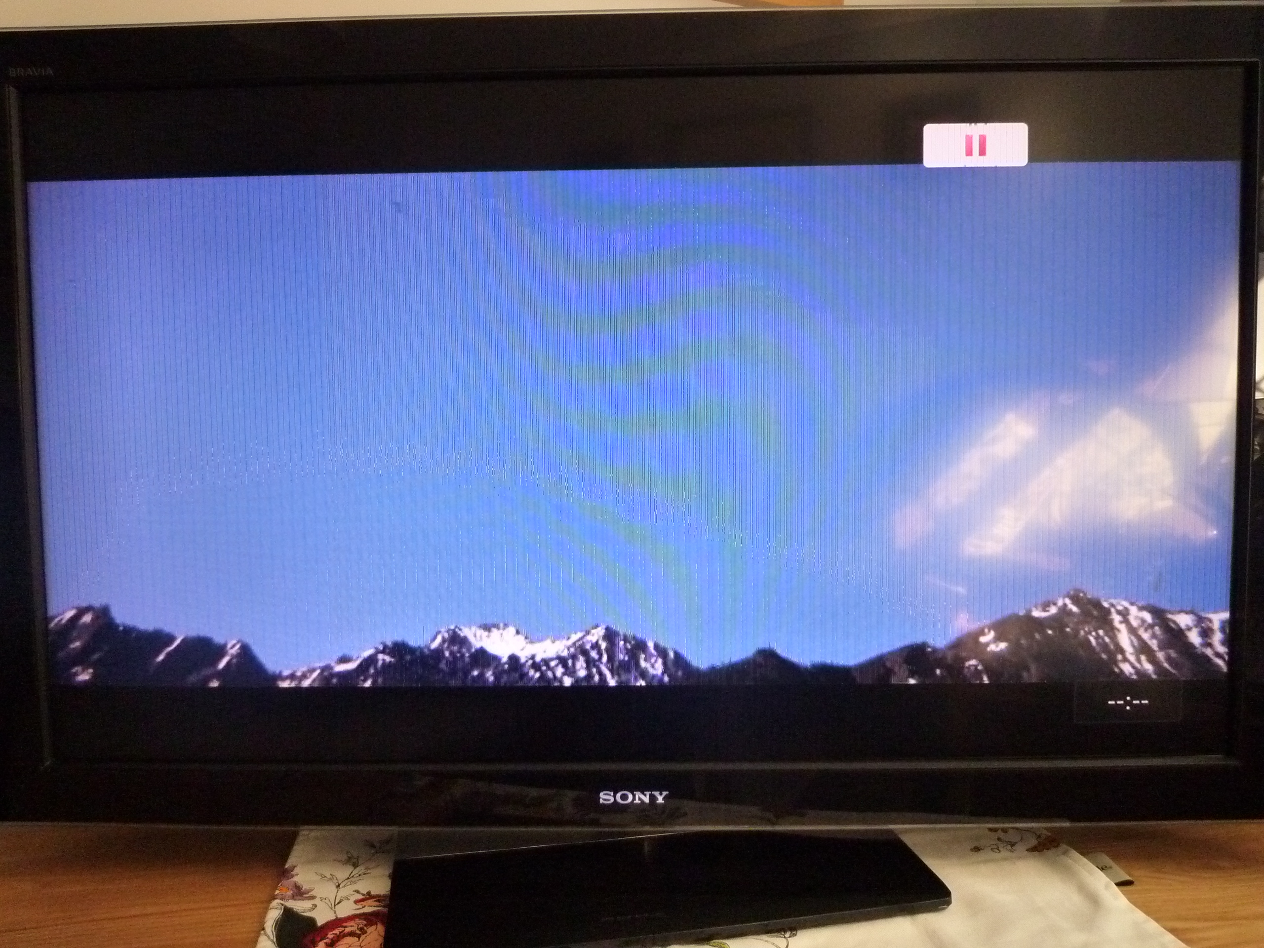

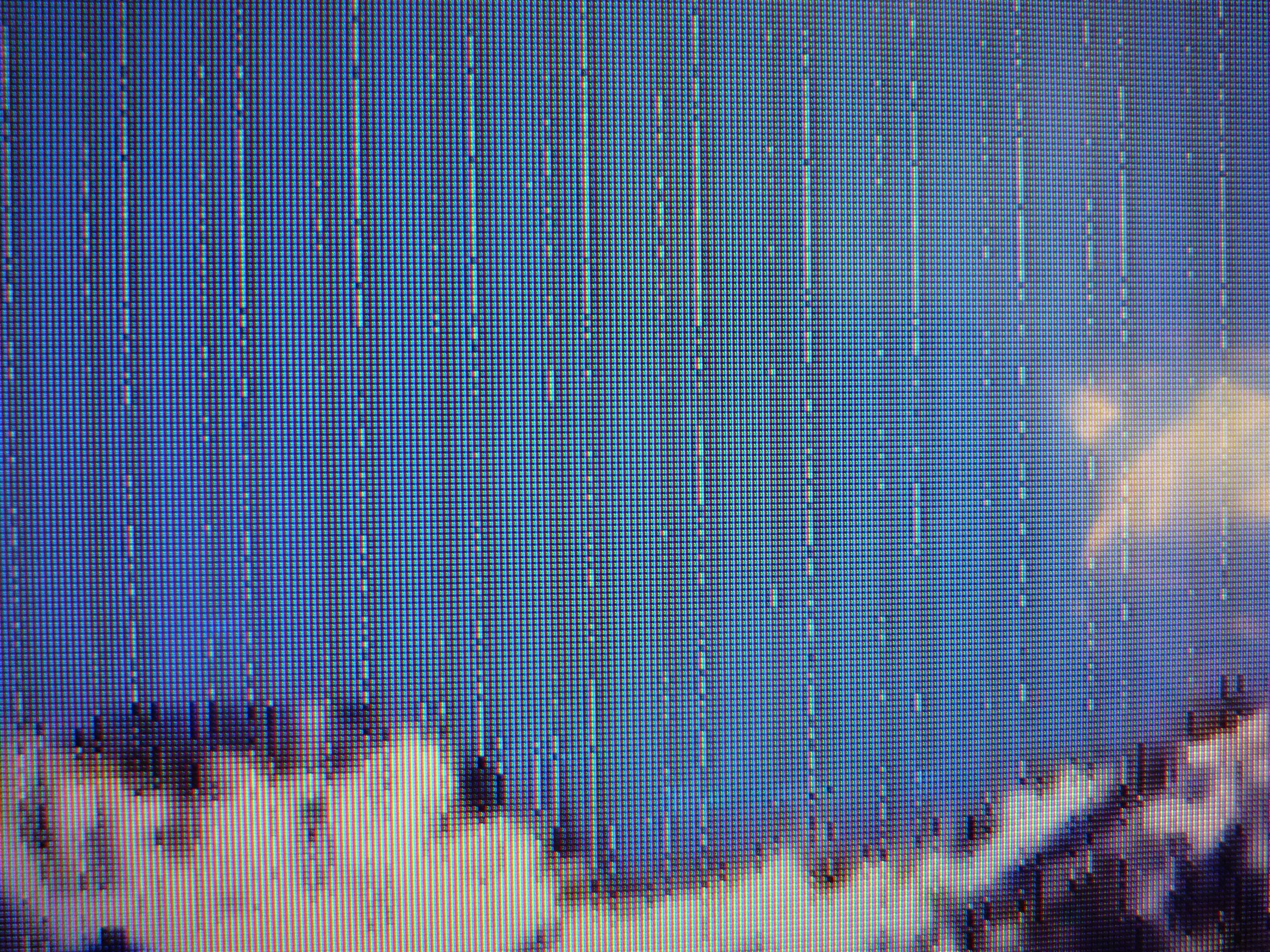

                        #51
                        Re: Sony KDL-46X4500 - 6 LED Blink Code
                        EERRMM.. Just when you thought it safe to go in to the water.
                        Just dragged this TV from outside as I was repairing it in my shed. Now have it all connected up but have vertical lines appearing all across the screen?
                        As you know, I only replaced the inverter board so was not able to see any image until now, any ideas, possible t-con maybe, hope it's not the panel?
                        Thanks.
                        • vinceroger69
                          • Mar 2012
                          • 6714
                          • uk
                          #52
                          Maybe clean and reseat all ribbon cables from the screen to tcon and also the lvds lead from t con to main board, maybe if your shed was a little damp etc its got some moister/corrosion on the cables etc.
