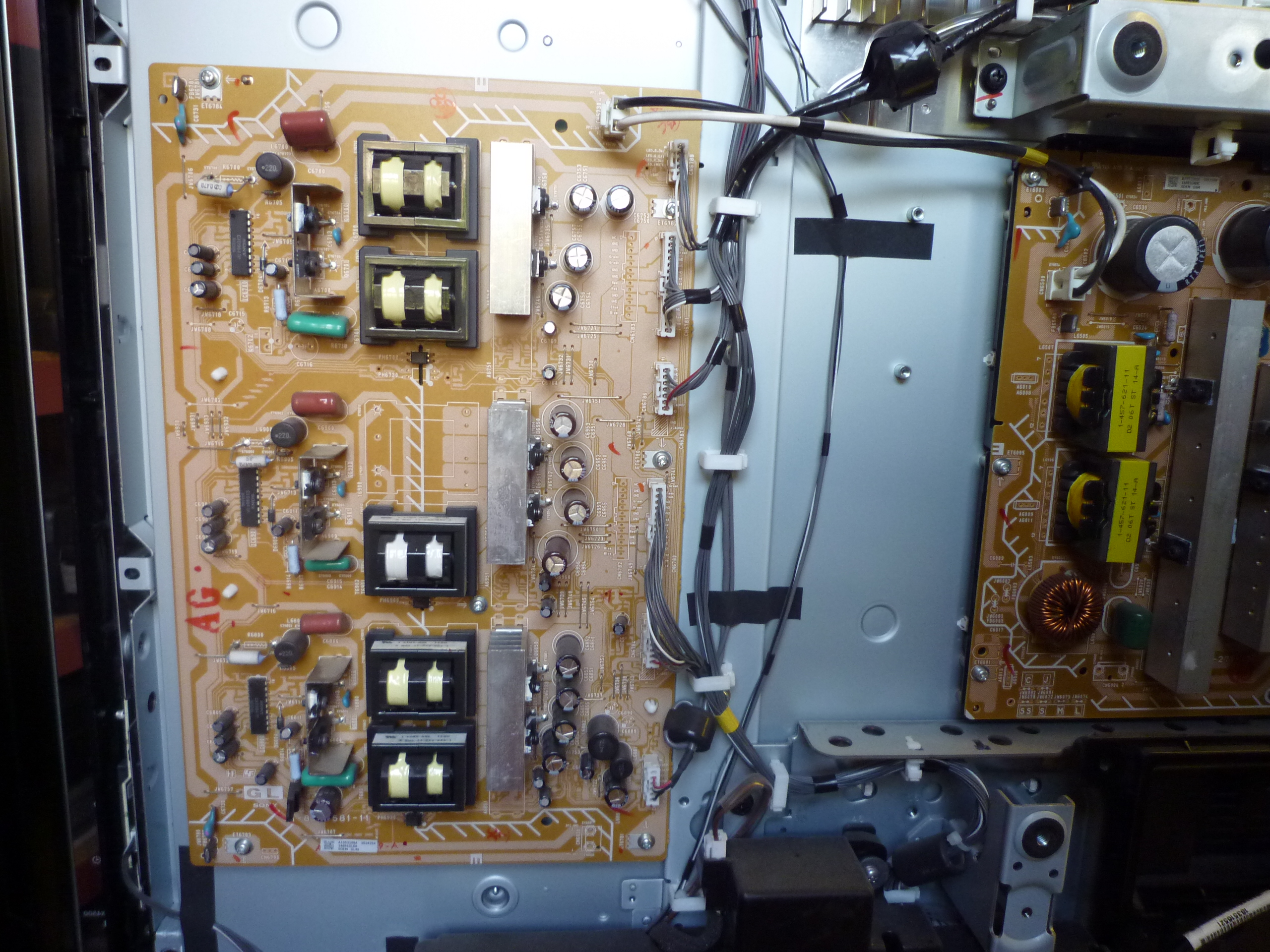

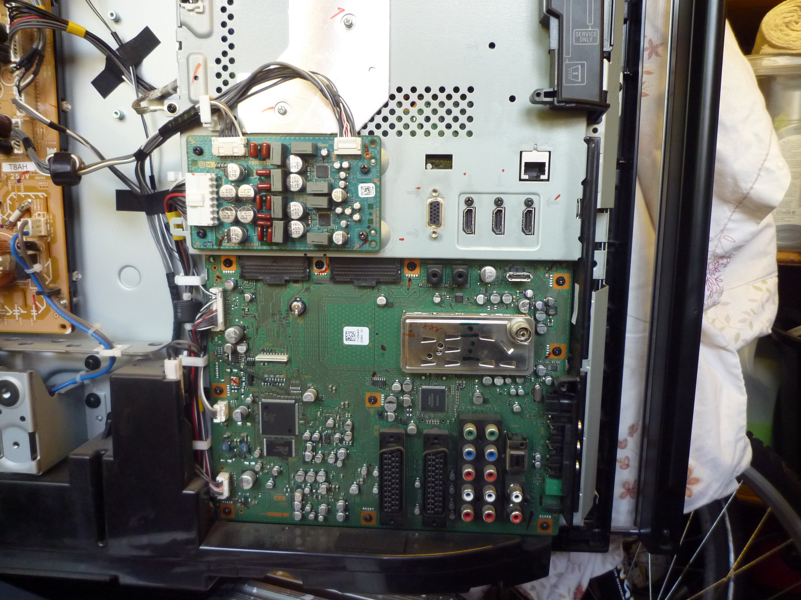

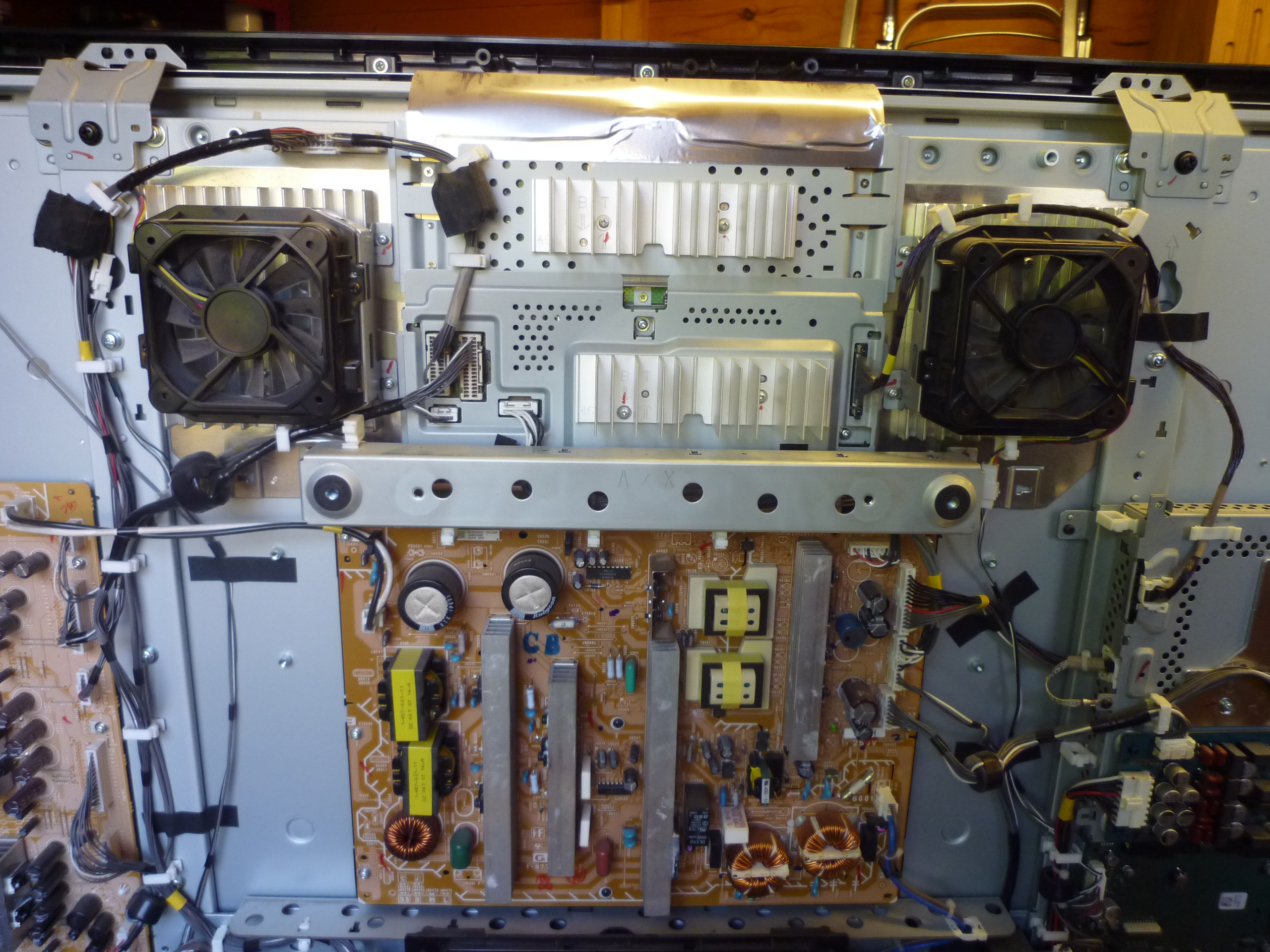

    Hi, have a Sony KDL-46X4500 with a 6 LED blink code, no picture or sound. So far, only checked STB voltage, which is 03.37V. There are no other voltages on same connector as STB?
    Did a quick google and found that the 6 LED code could be either the main board, power supply board or inverter boards, not sure which one or what to check next? Thanks.

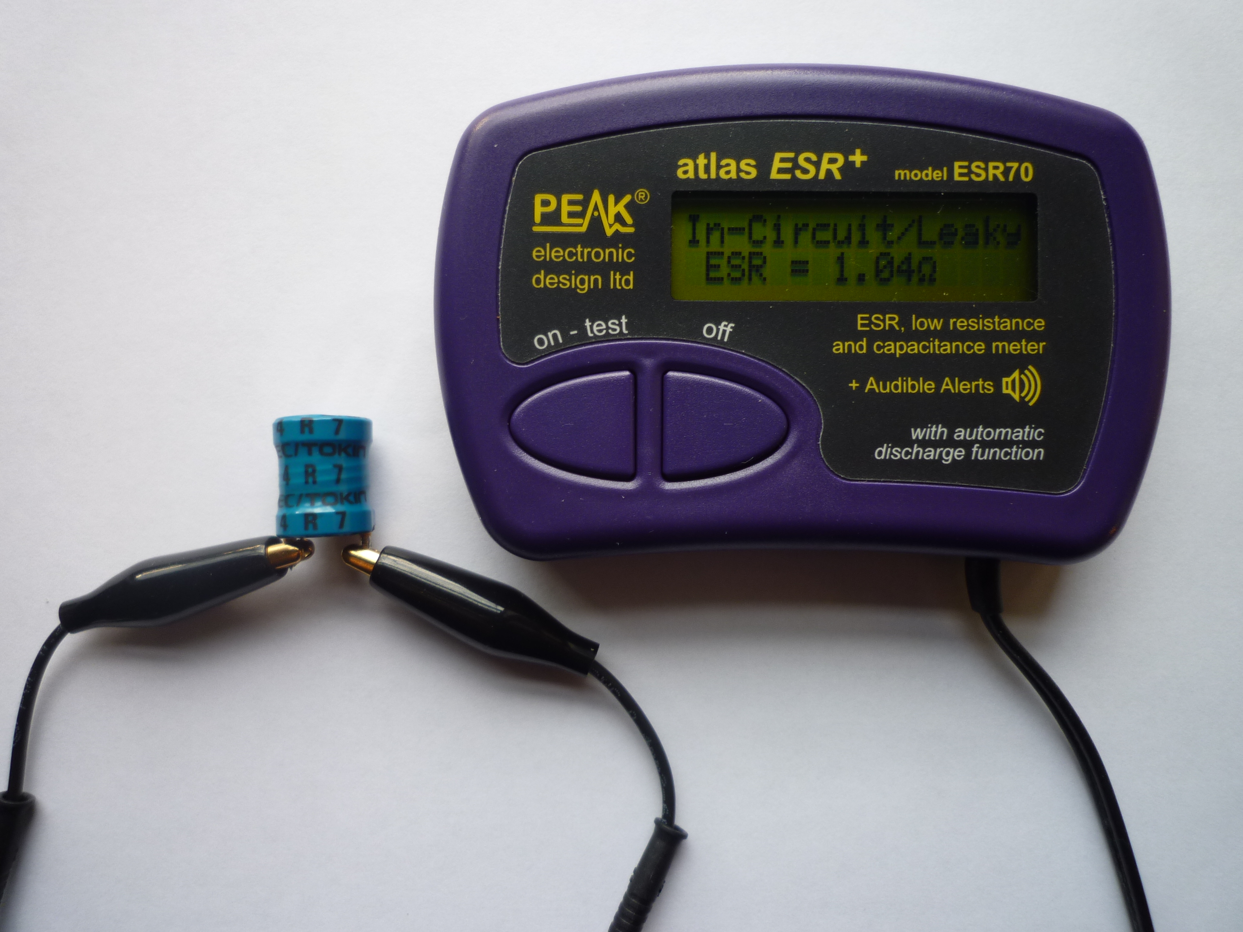

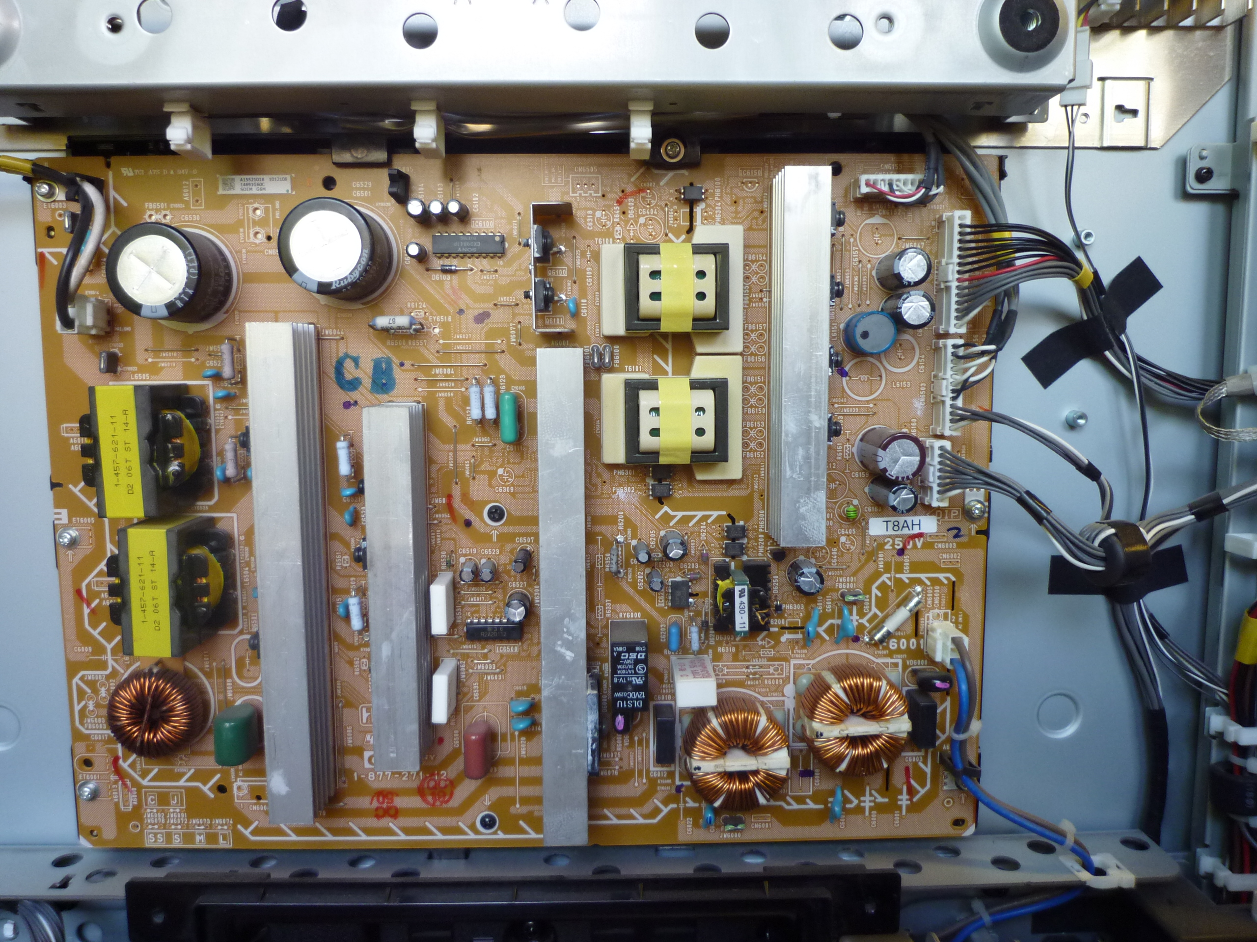

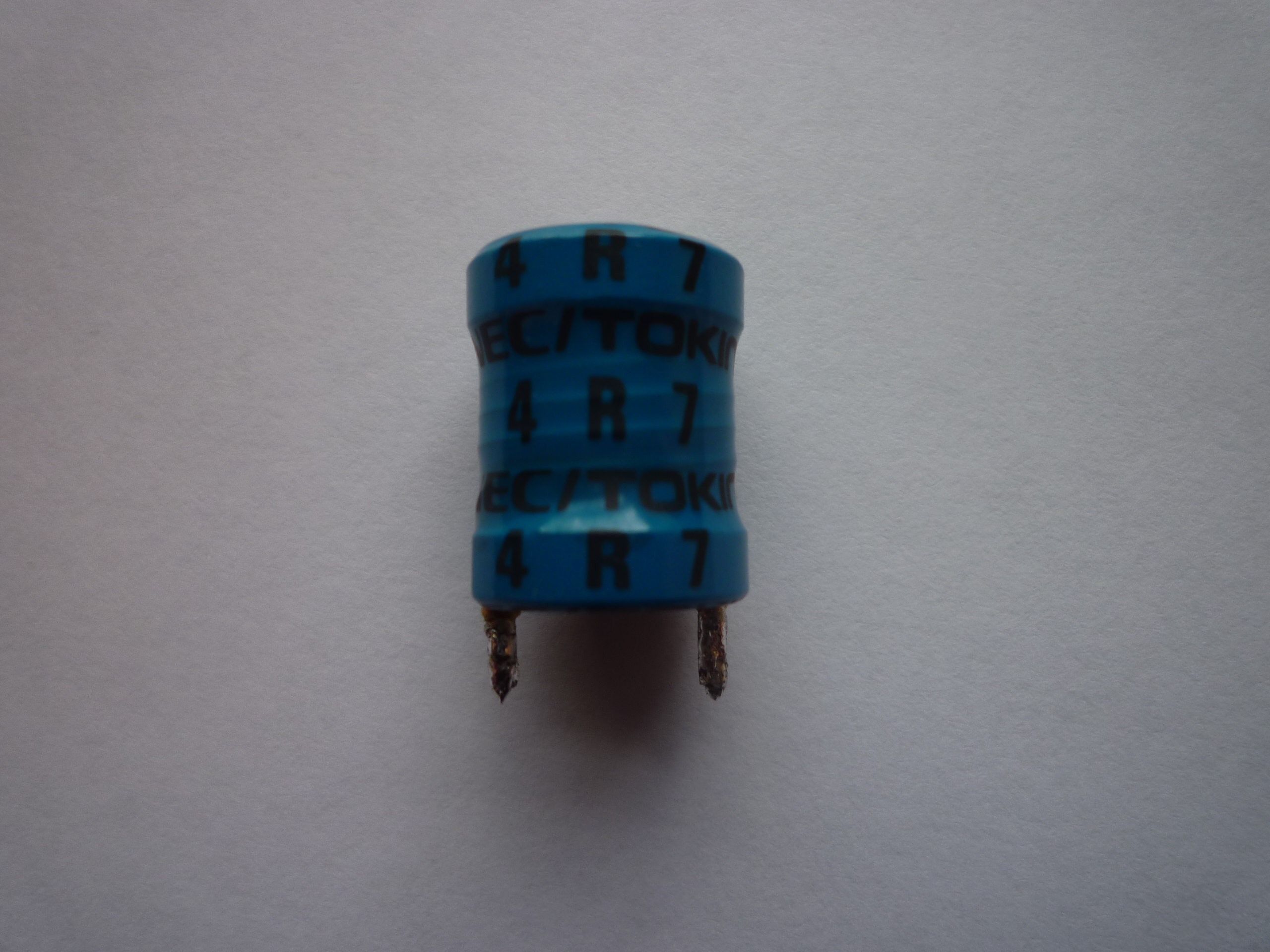

    Picture 2 , the blue capacitor/coil? ( with the black dot showing negative side ). Cant really see what it is. It looks like a swollen cap?
    What brand of caps are in that psu?

      The blue capacitor/coil, as far as I can see is TOKIN R7? Seems as if the capacitors are all Rubycon?

        Can you check these type of capacitor/coils using a ESR meter, if so, I obtain - in circuit/leaking, ESR 1.87 ohms?

          Removed NEC/TOKIN 4 R 7 capacitor/coil from board and checked with ESR70. Reads same either way around.
            Re: Sony KDL-46X4500 - 6 LED Blink Code
            That is an inductor for the pi filter.
            You have problem in the inverter circuit. You do need to make sure you do have boosted Volatge of around 400Vdc to run the inverter section, also need to check fusible resistor that feeds the 400Vdc to run the inverter circuit.

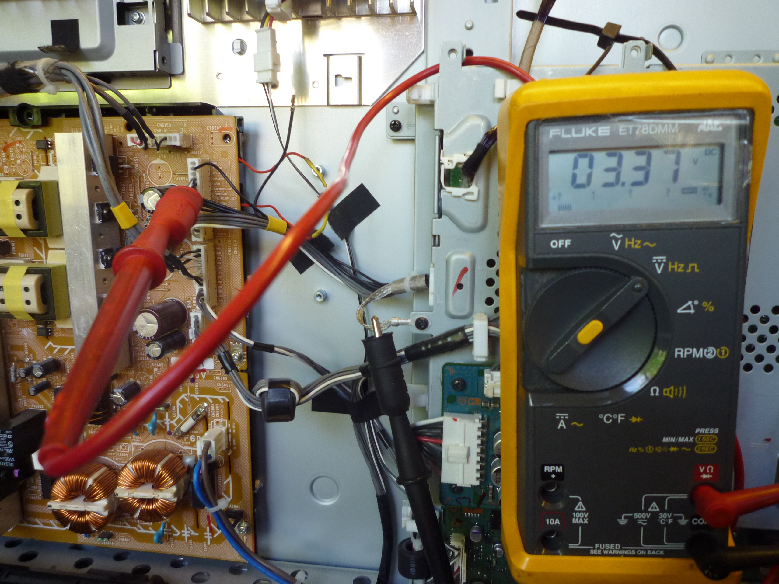

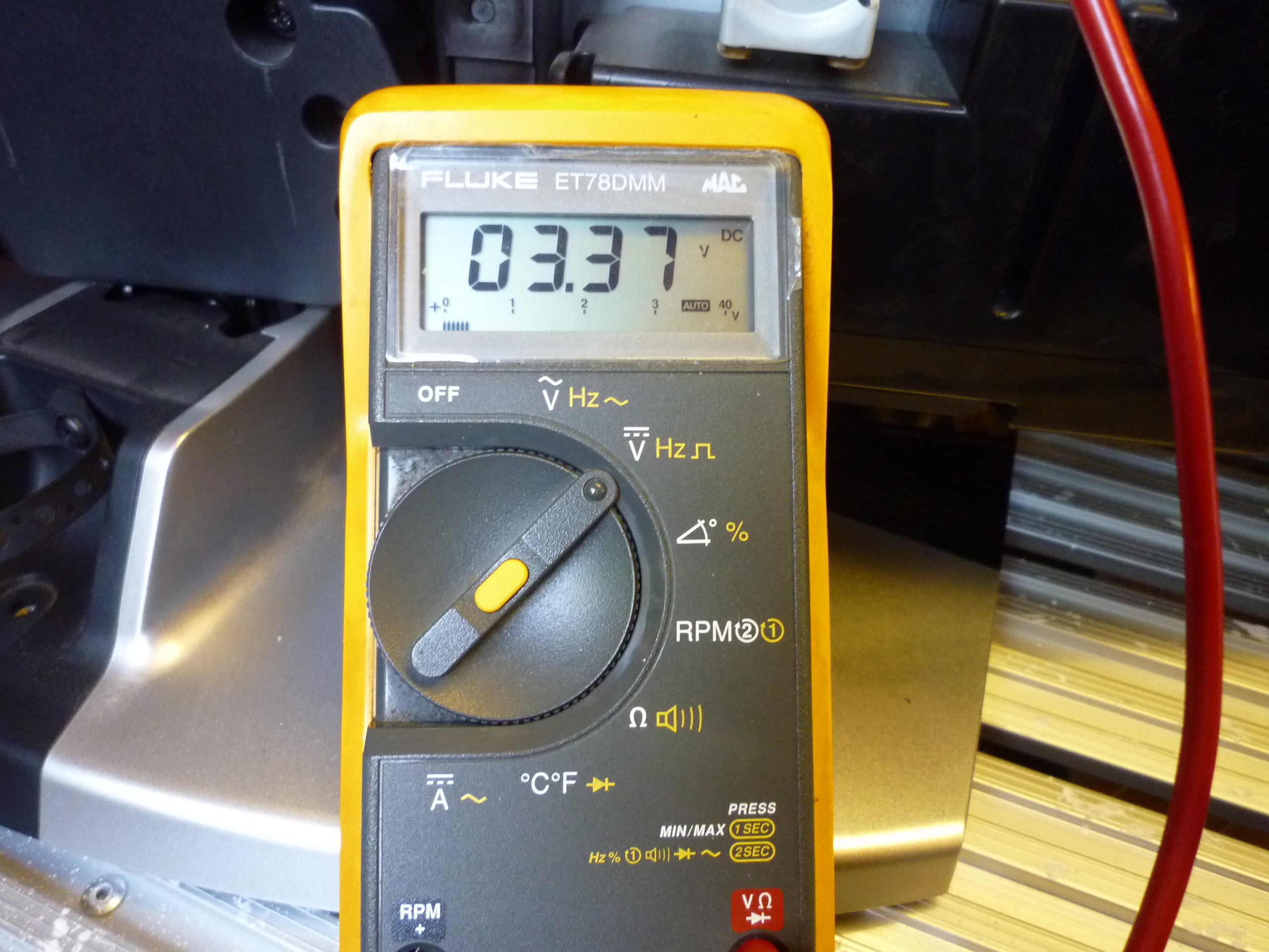

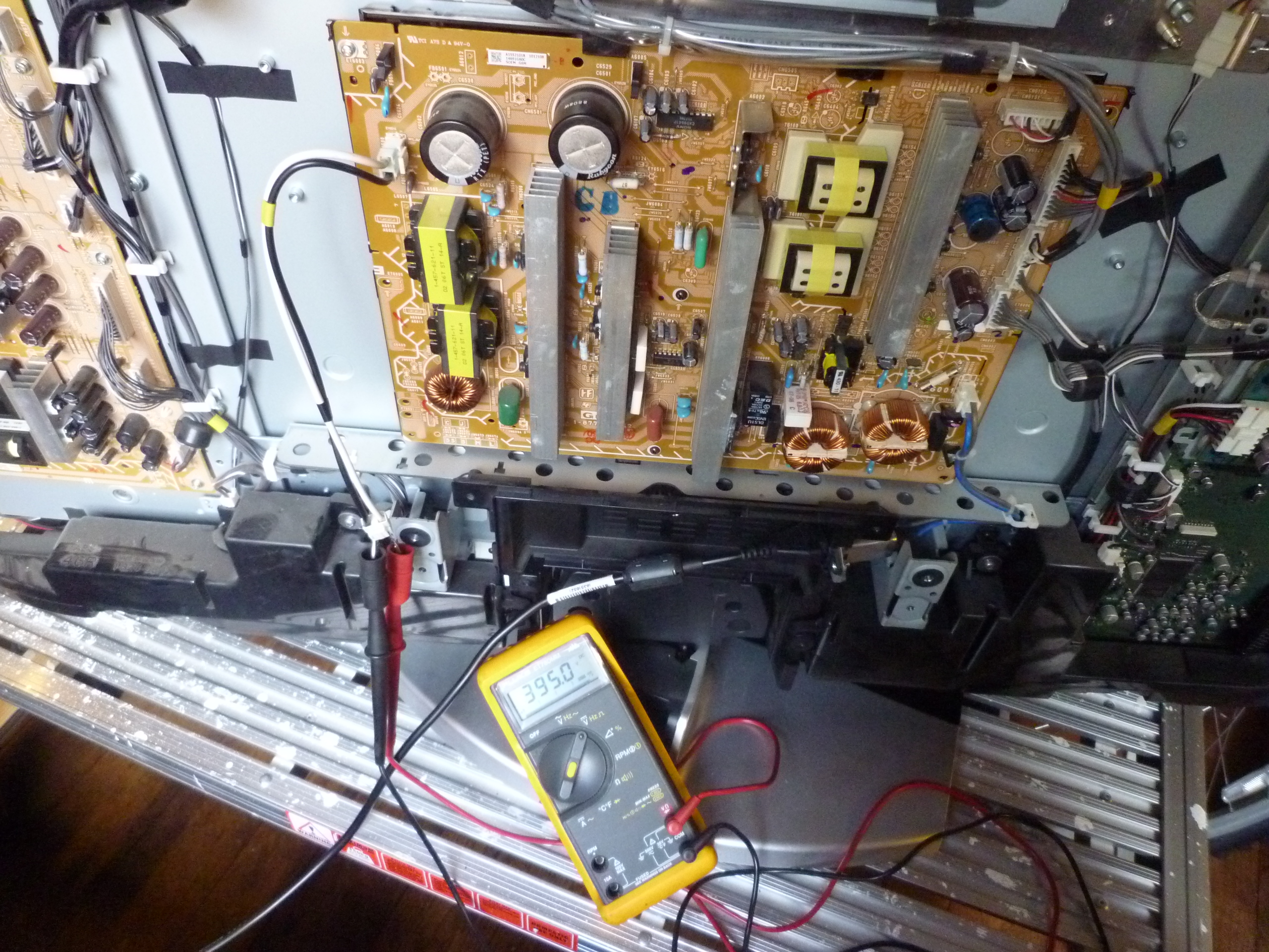

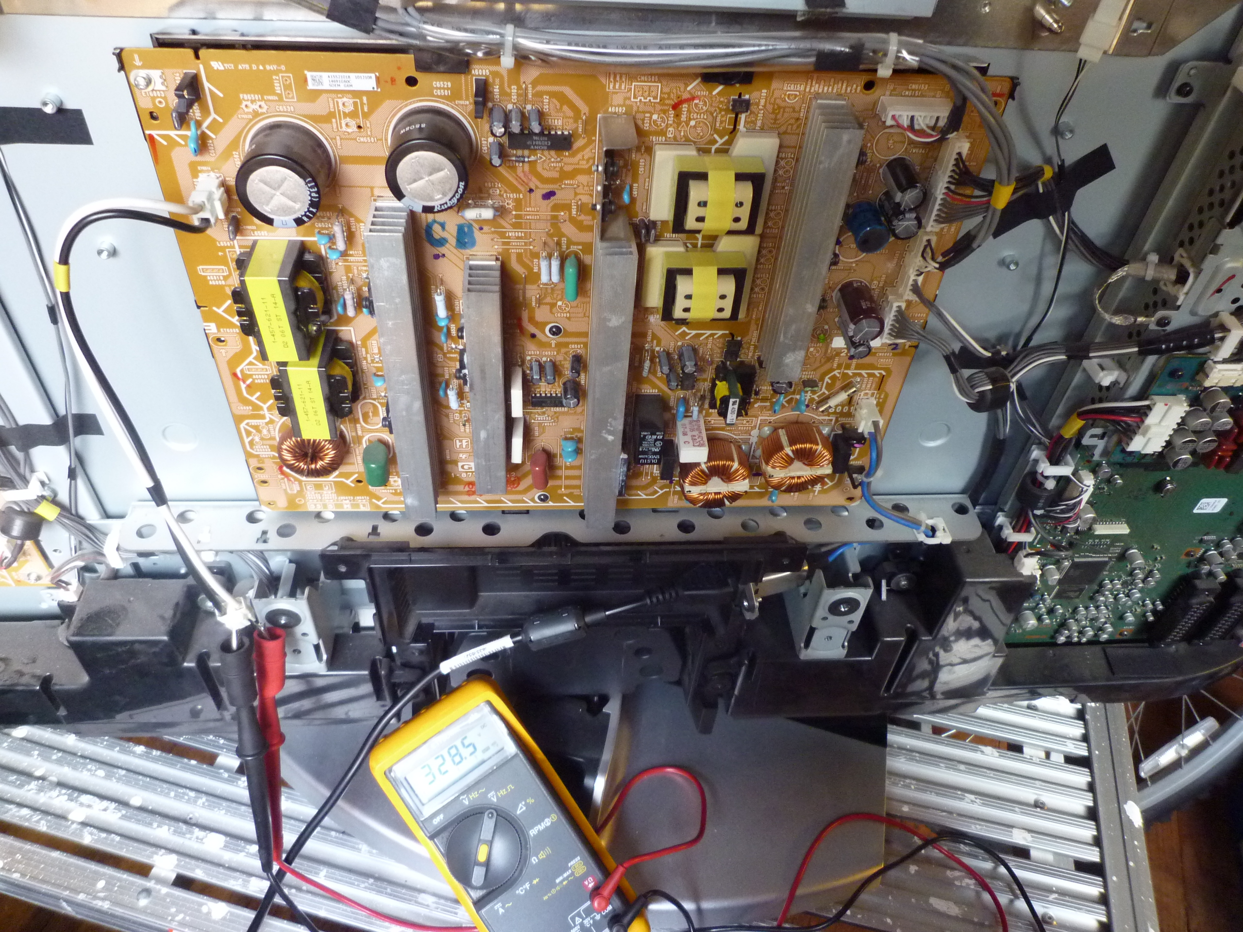

              When TV on standby (red led) I obtain 395.0 VDC, switch on TV, green led stays on momentary and then changes to red 6 led blink code, at this point I have a reading of 328.5 VDC?
              • CapLeaker
                Leaking Member
                • Dec 2014
                • 8071
                328.5V means the PFC is off, no boosted voltage, no power for the inverter.
                395V means the PFC is running and you have PSon signal and the STBY voltage is there too. So the inverter should get sufficient power, from the power supply. Next check the BLon pin to see if the inverter gets turned on too.

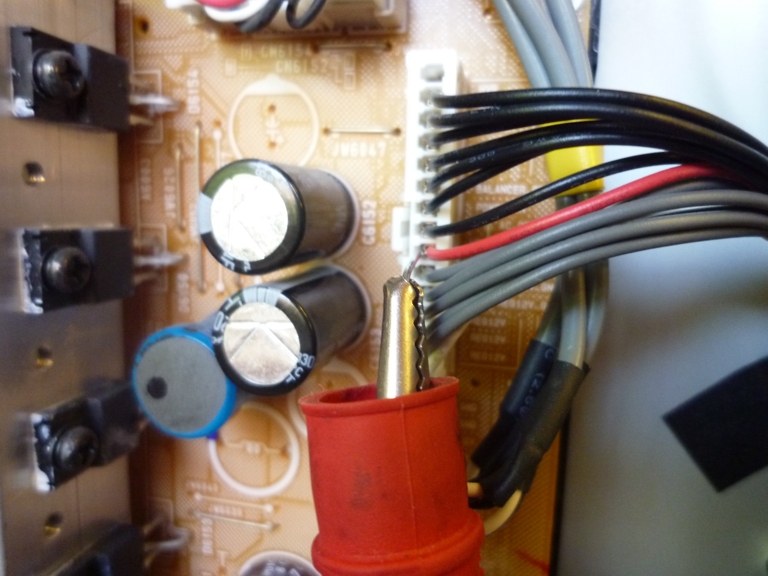

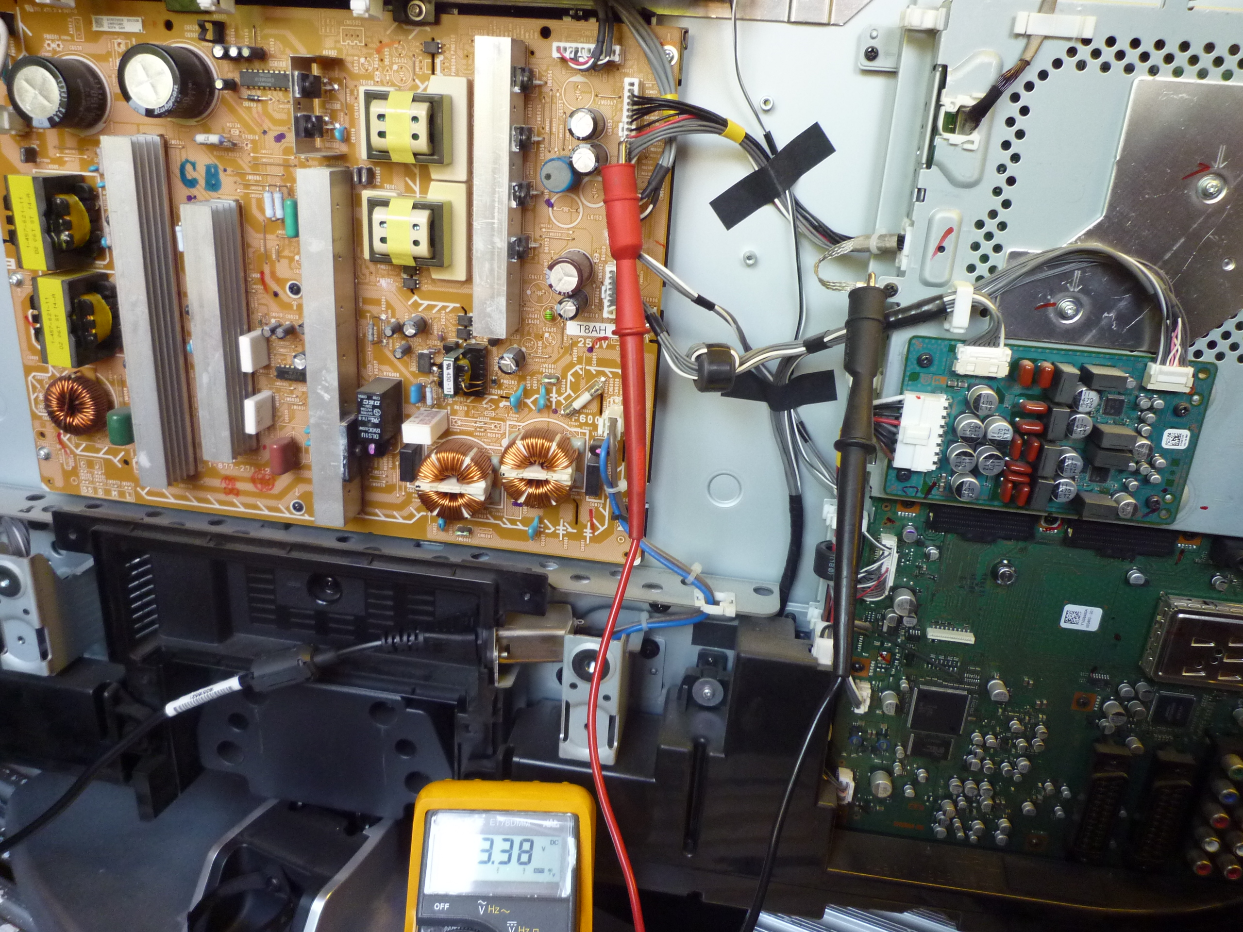

                  Only had around 3.35 VDC on BLon pin for about 2 seconds when TV switched on, then went in to blink code? What I did notice was, the SONY logo on the center front panel lit up momentary?

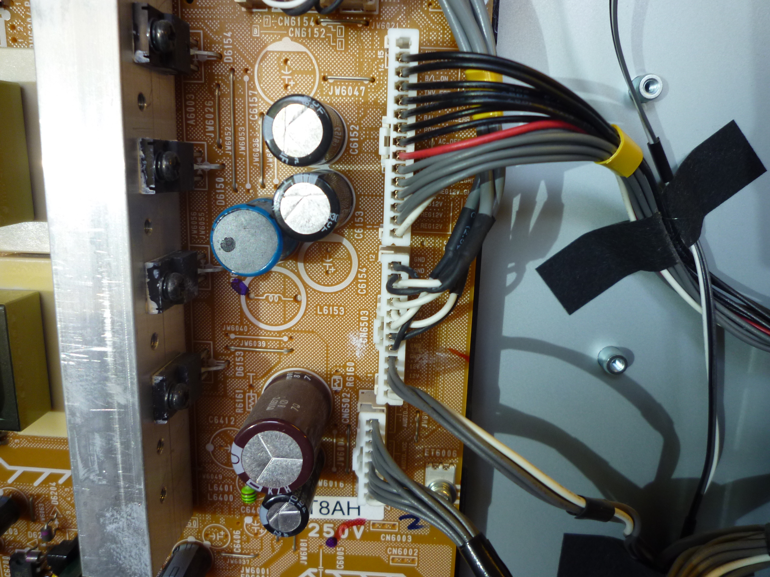

                    Measure up the all pins on the connector and report back with the pin out name and voltages measured.
                    Sounds like an inverter problem.

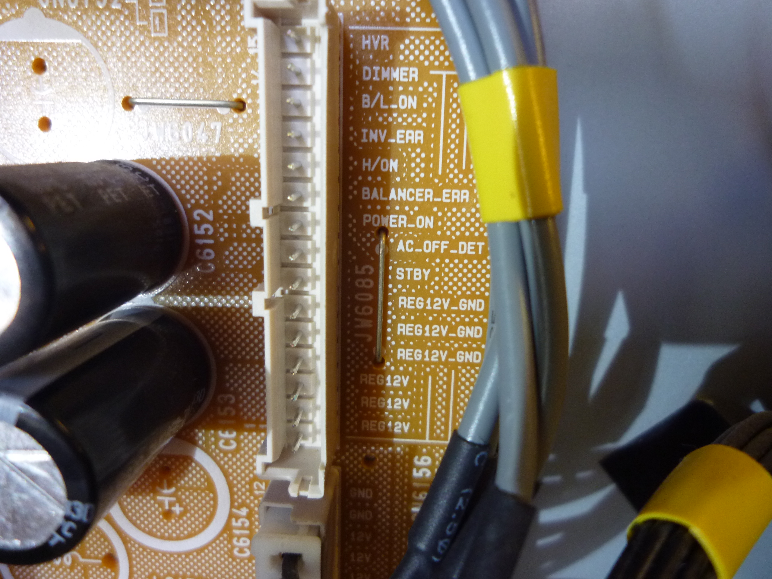

                      HVR - Not Used
                      DIMMER - 01.04V
                      B/L_On - -00.06V
                      INV_ERR - 00.00V
                      BALLANCER_ERR - 00.00V
                      POWER_ON 00.00V
                      AC_OFF_DET - 3.13V
                      STB - 3.37V
                      REG12V_GND - 00.00V
                      REG12V_GND - 00.00V
                      REG12V_GND - 00.00V
                      REG12V - 00.00V
                      REG12V - 00.00V
                      REG12V - 00.00V

                            Readings taken just before TV goes in to blink mode:
                            HVR - N/U
                            DIMMER - 00.98V
                            B/L_ON - 01.00V
                            INV_ERR - 00.00V
                            POWER_ON - 03.31V
                            AC_OFF_DET - 03.13V
                            STB - 03.37V
                            REG12V_GND - 00.00V
                            REG12V_GND - 00.00V
                            REG12V_GND - 00.00V
                            REG12V - 11.98V
                            REG12V - 11.97V
                            REG12V - 11.98V
                            • CapLeaker
                              Leaking Member
                              • Dec 2014
                              • 8071
                              BLon sitting at 1V isn't enough to turn the backlights on. I should have more than 2V.
                              So you may have to do following:
                              Unplug TV. Remove the BLon pin out of the plug that comes from the main board back to the power supply (we dont want to feed back power). Next solder a 1k resistor from STB to BLon on the powe supply. Plug the TV back in and turn it on and check those voltages again.

                                  Removed BLon terminal from plug to main board, soldered 1K resistor from STB (rear of board) across to BLon. TV on - 03.37V, after a couple of seconds, TV went in to blink mode, voltage dropped momentary but then went back up to 03.38V.
                                  • AlbertRoss
                                    • Jul 2012
                                    • 181
                                    • United Kingdom
                                    I have now checked all voltages again because before I had 00.00V on INV_ERR. With TV on (green LED) I have 00.00V, just a split second before TV goes in to blink mode I get a voltage of 03.08V but then drops to 00.00V?
                                    • CapLeaker
                                      Leaking Member
                                      • Dec 2014
                                      • 8071
                                      When the TV is on with a green LED, you have 0V on the INV_ERR pin.
                                      But then there is a short blip to 3.08V and the main board goes to blinking? No backlights for 2 seconds or something?
