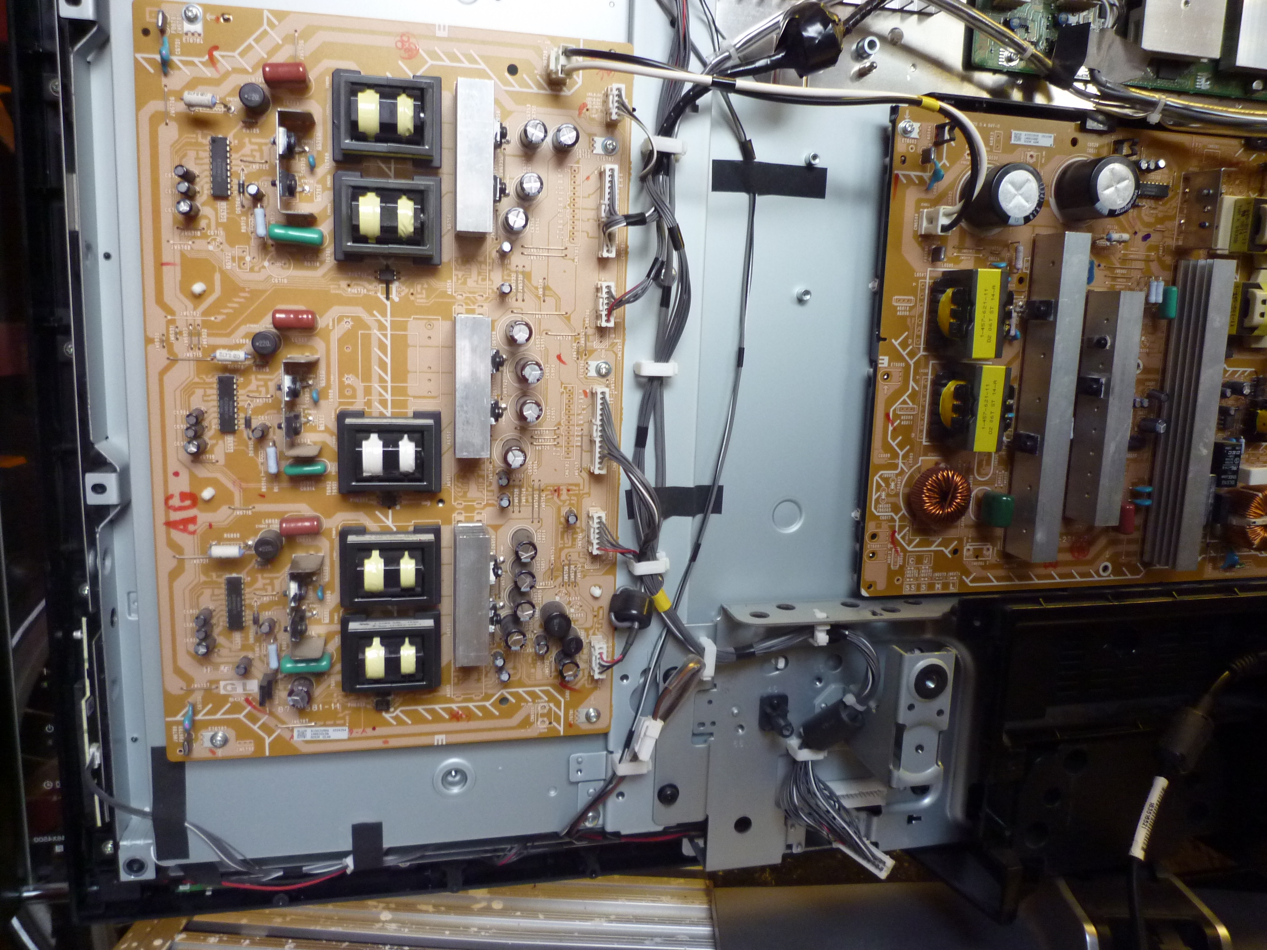

        I have disconnected the lower connector that I presume operates the backlights? The top connector that I also presume is for the backlights, is still connected. The TV now stays on with green LED showing and doe's not enter blink mode. I'm now able to turn the TV on or off using both the remote and the TV switch but there is still no picture or sound?
          Re: Sony KDL-46X4500 - 6 LED Blink Code
          Can I see the pictures of the whole back side of the unit that will show how all the boards are connected together?
          My mistake to think that this model uses CCFL, it uses LED backlights so it does not have HV Inverter circuits.

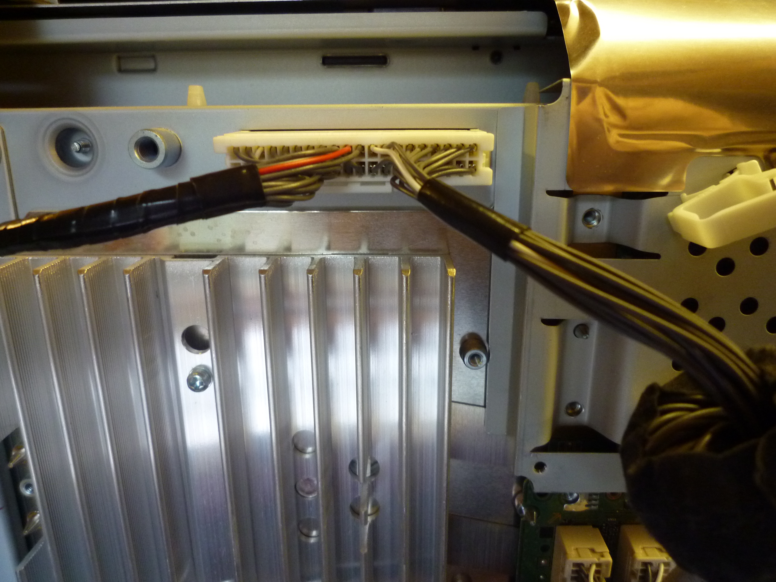

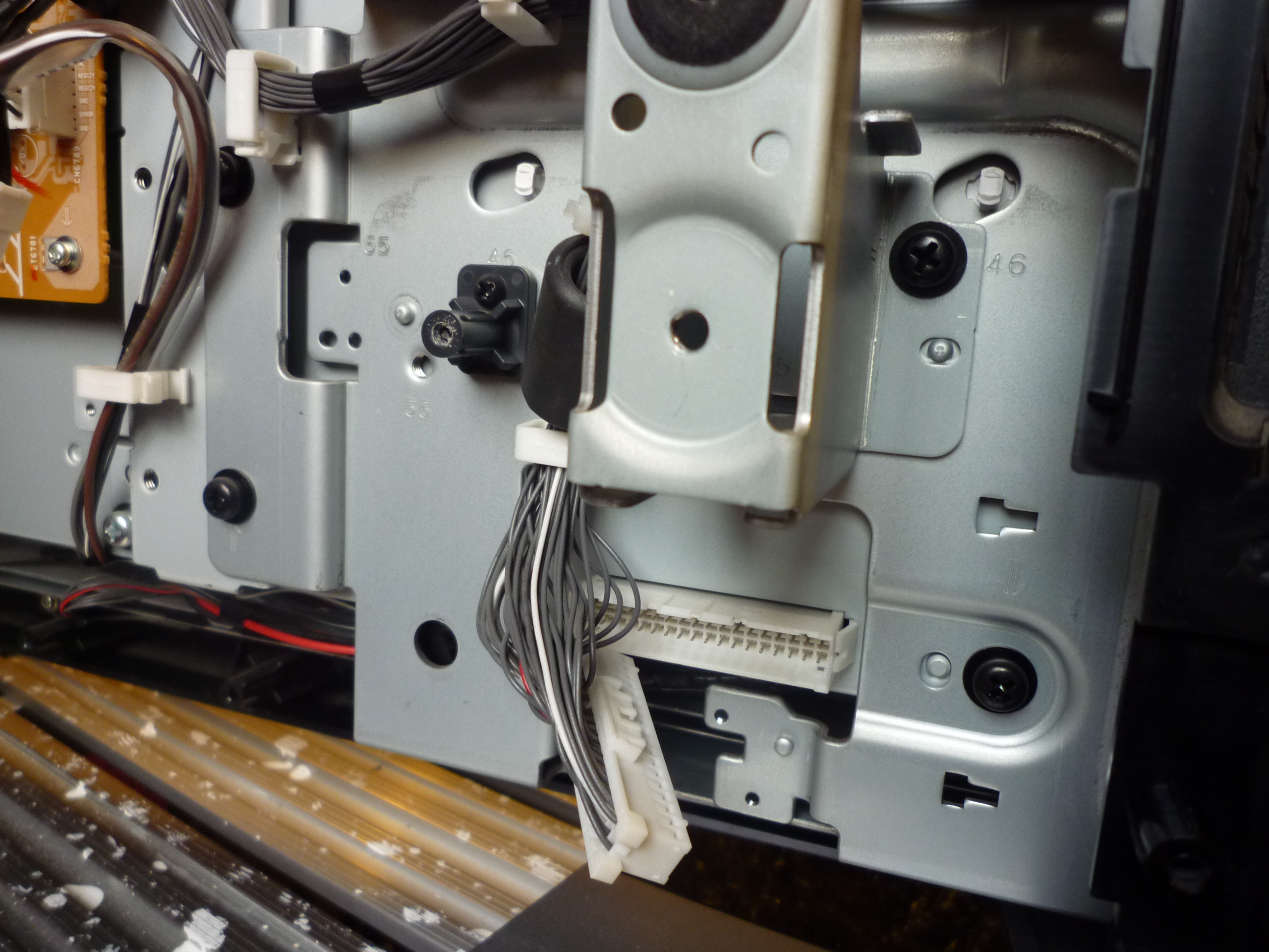

            Disconnected lower wiring connector which I presume operates the backlights?
            The top wiring connector, just above the heat sink is still connected.
            The TV will now stay on with green LED light showing and the center SONY logo on the front panel remains lit. The TV is able to turn on/off either by using the remote or TV switch, it doe's not enter blink mode but still no picture or sound?
            Not sure if I should now remove the 1K resistor and then try again?

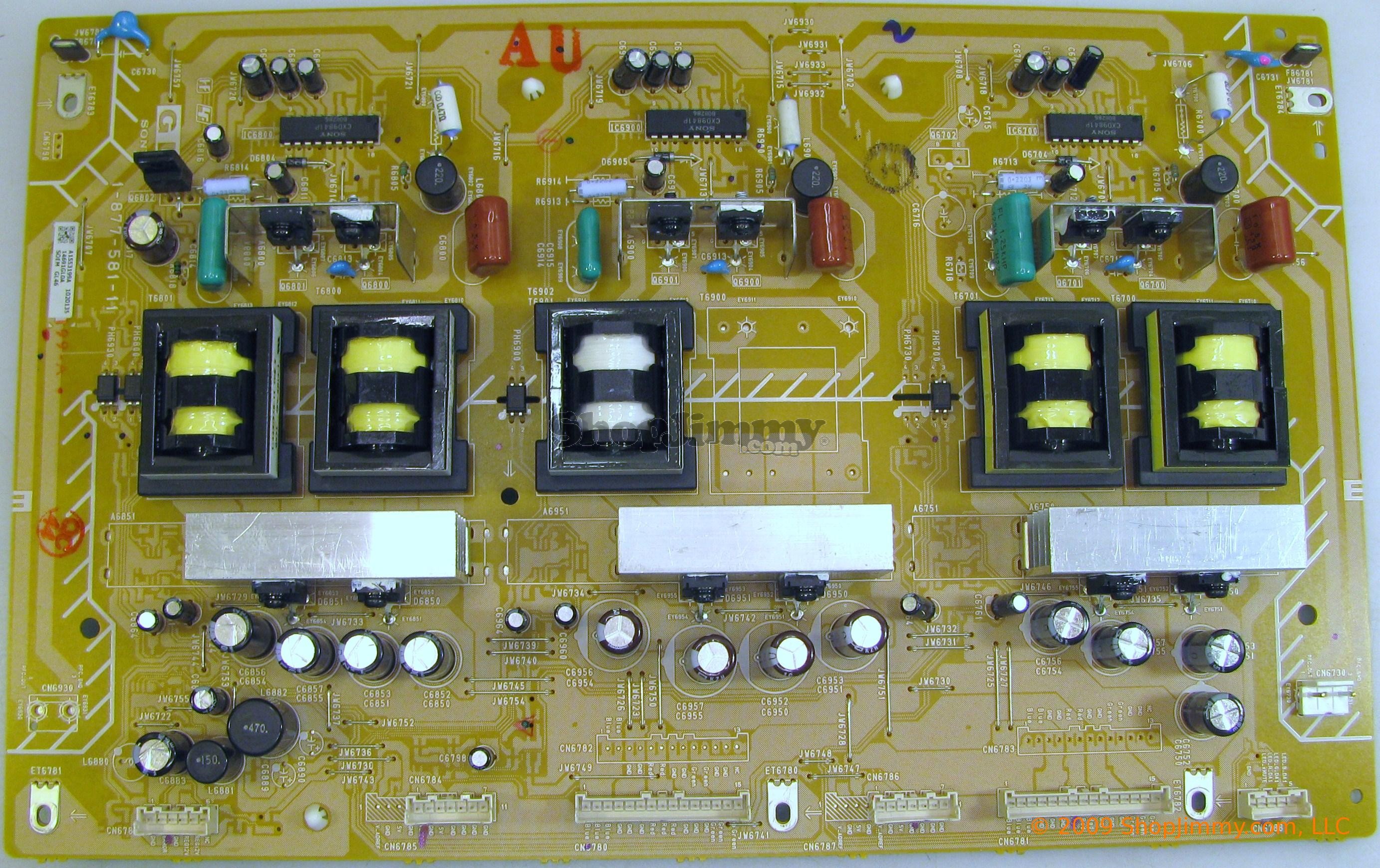

                      P/N for the LED driver is: 1-877-581-11.
                      A1553199A.
                      I've only disconnected the lower connector that enters into the rear panel which I presume goes to the LEDs?
                        #31
                        OK, I found the picture of the board at shopjimmy (you may not be able to get the website in UK.
                        http://www.shopjimmy.com/sony-a-1553-199-a-gl-board.htm
                        Picture provided by shopjimmy.
                          Correct board but as you said, we are for some reason unable to get the website for shopjimmy here in the UK?
                          So do I take a chance and tear down the panel or go for a new board?

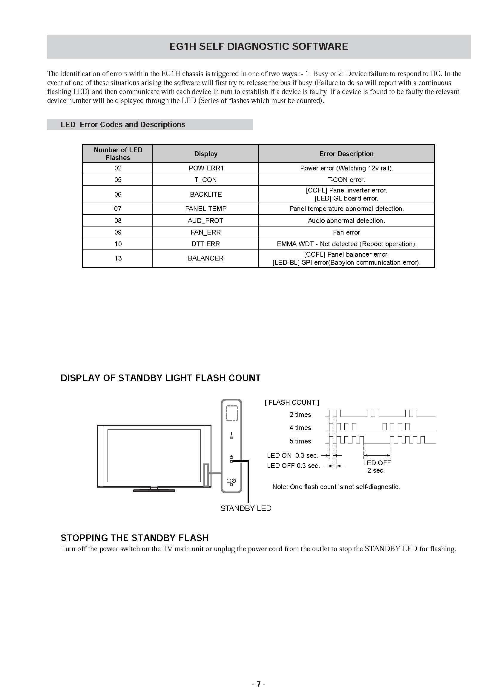

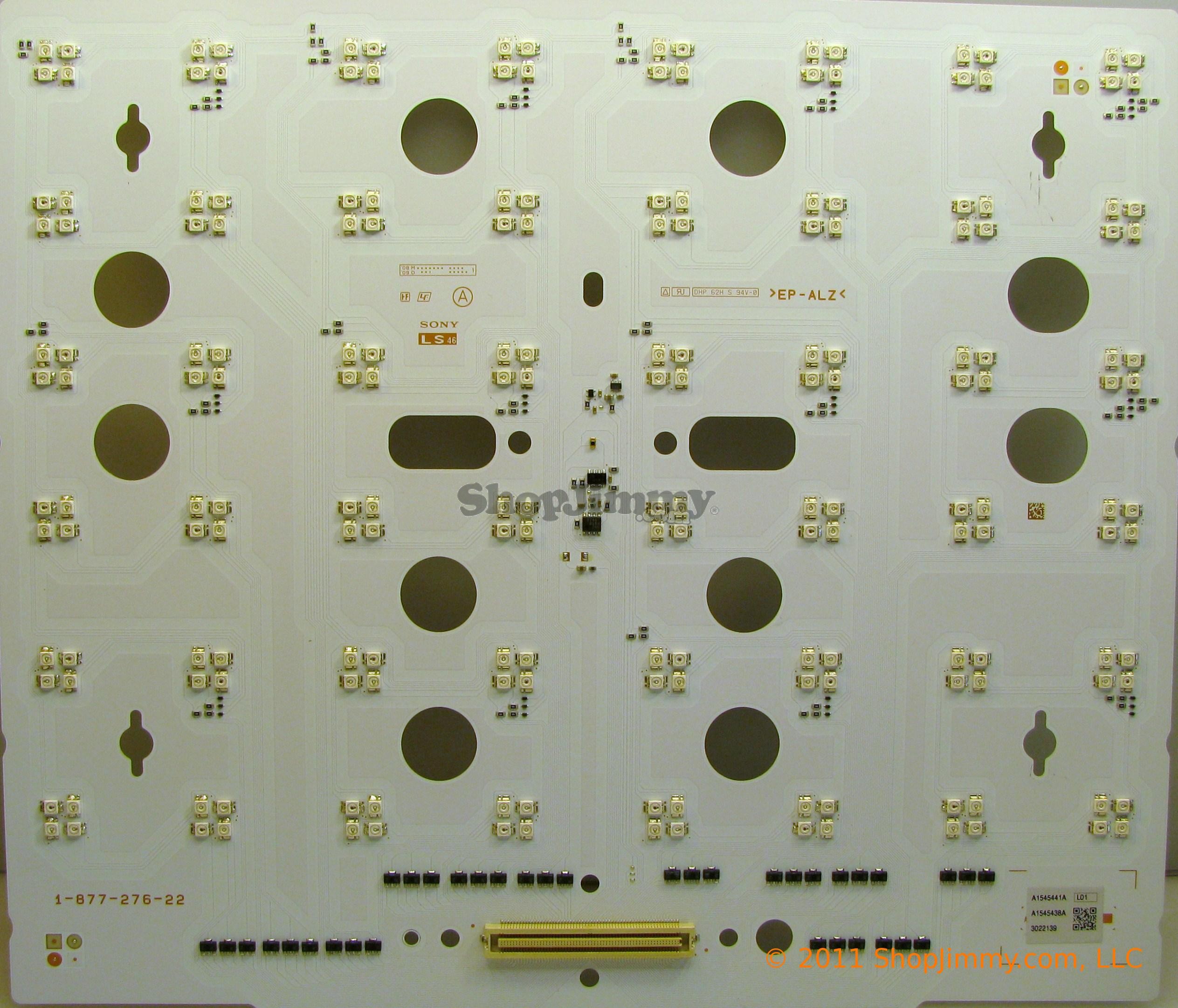

                            Looking at the service manual for the 46'', this TV uses RED, BLUE, and GREEN LEDs for Lights source, not the typical WHITE LEDs.
                            This is not going to be easy troubleshooting.
                            I will not do the panel tear down yet.
                            Thed LED board may look something like this.
                            http://www.sony.co.nz/article/358578...ct/kdl-46x4500
                            RGB Dynamic LED
                            BRAVIA X Series can display the widest range of colours through the use of RGB LED backlighting which has a unique arrangement of red, blue and green LEDs.

                              Thanks for the information and schematics.
                              Starting to get a bit complicated now, especially looking at the schematics. Having looked at the LED Error Codes for 6 flashes it seems as if we are going in the right direction i.e. Backlight - (LED) GL Board Error?
                              So am I to concentrate on troubleshooting the GL Board first? I had previously removed this board, checked a few caps, resistors, fuses etc. maybe I should have another look at it tomorrow?
                              Having said that, why do I not have a picture or sound as I'm unable to see why the backlights would have an effect?
