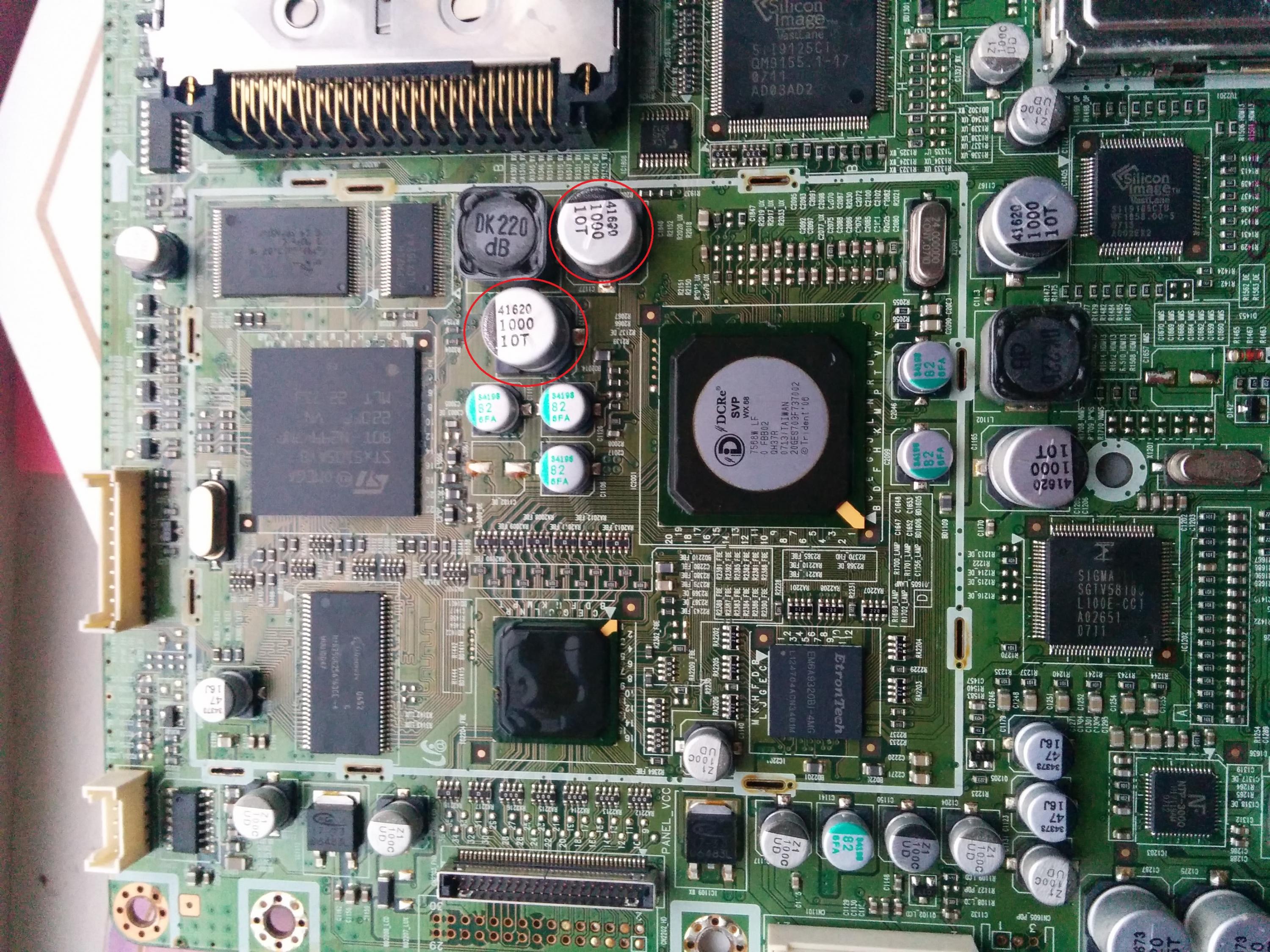

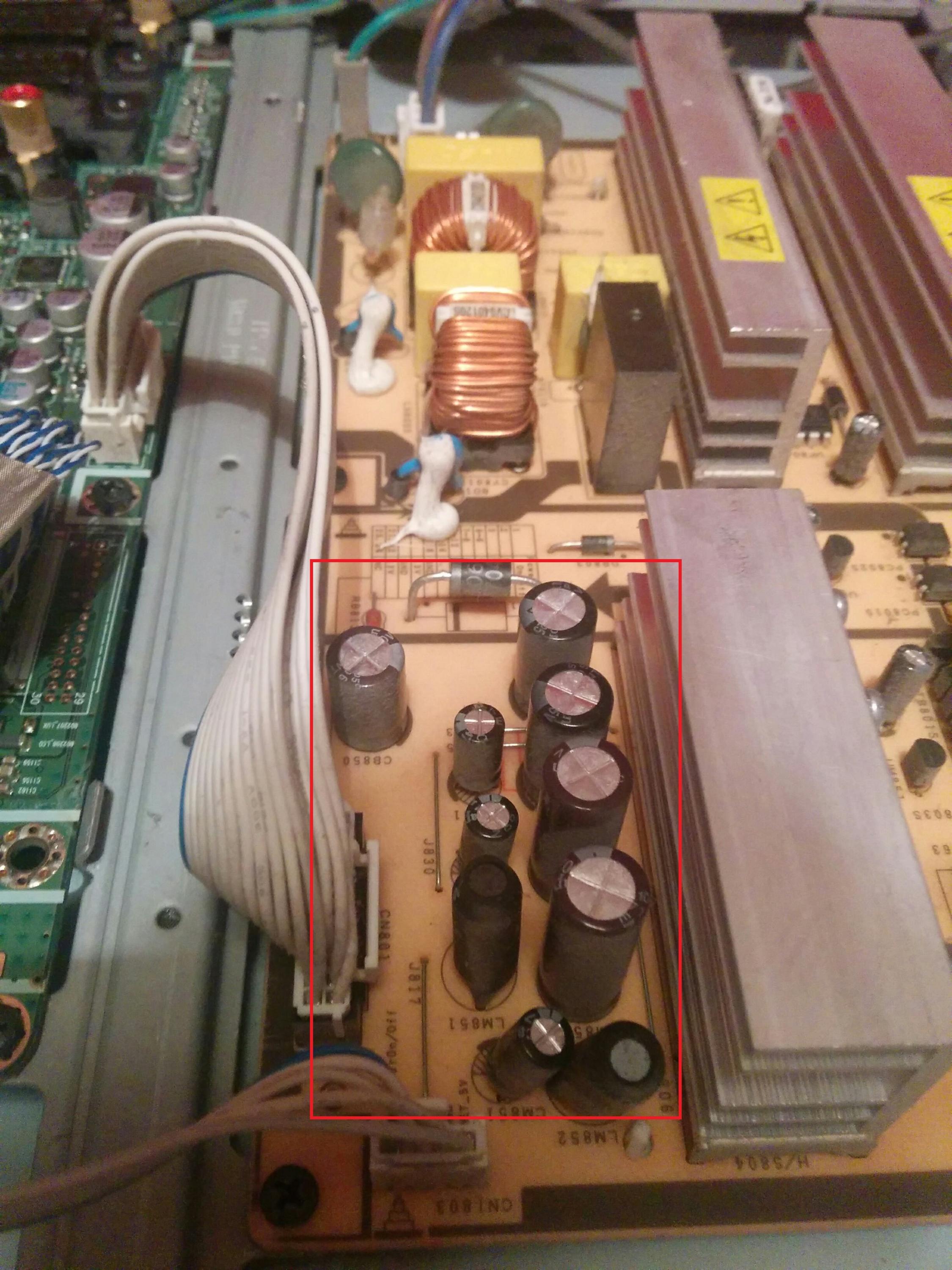

        I tested all the caps on the power board in this picture:
        and I replaced the two in this picture:

        When the tv is cold , turn the tv on and use a hairdryer to heat up the power supply. Try to aim just at the power supply ( capacitors location ) and see if the tv stays on. Tv tries to turn on but its missing that little bit of power to turn on.
        If heating up the power supply does not work then aim the hairdryer at the metal shield on the mainboard. I see you already removed the shield? Those small caps underneath that shield on the board get hot , they fail easily. I see that a lot on those lcd tv's. My bets are on the mainboard!
        Thanks, I gave this a try and it doesn't do anything. I was hoping it would show a particular spot was at fault but the TV just keeps switching off and on.
