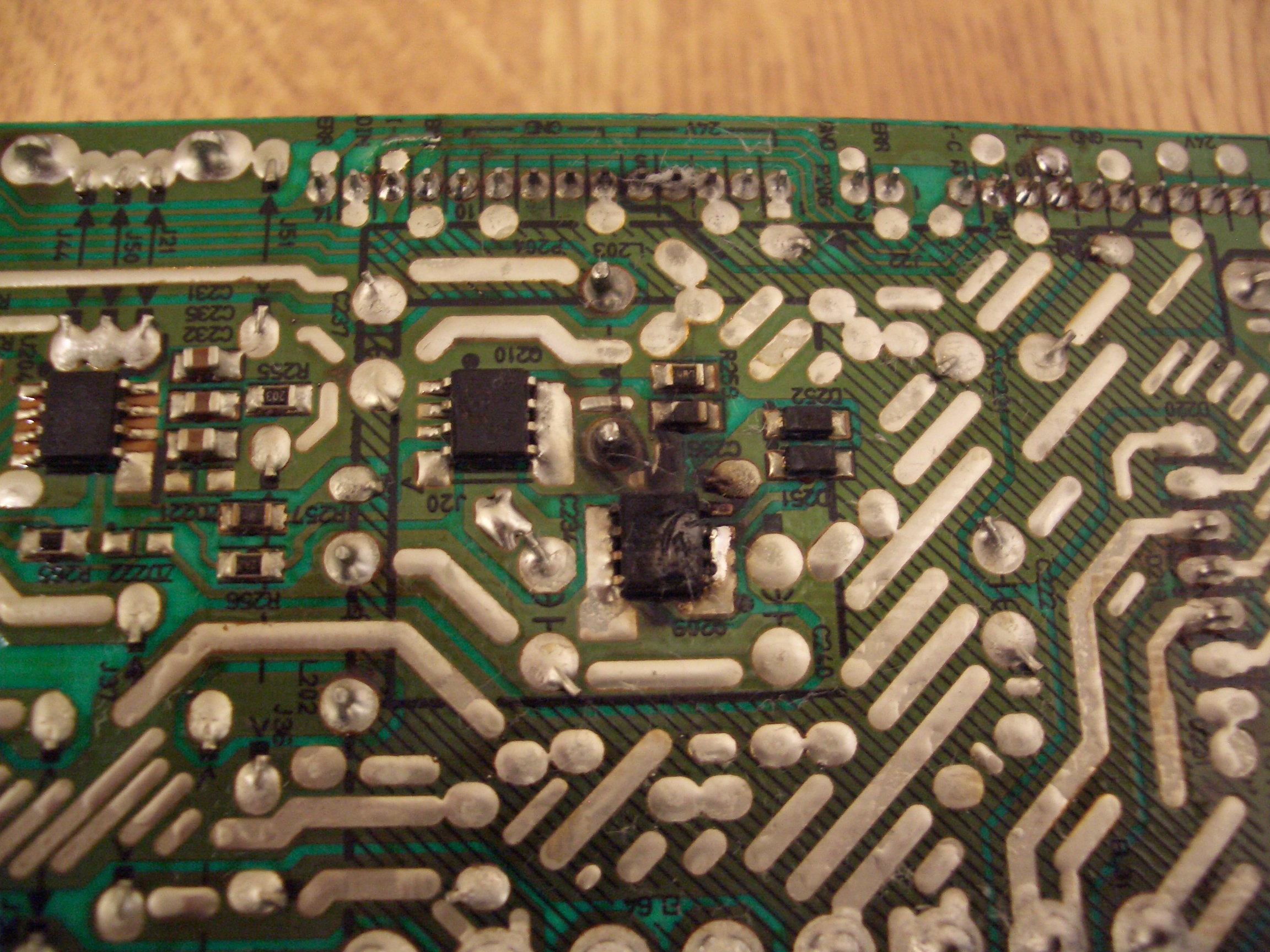

    Hoping that it may be a simple case of replacing some bad capacitors, I took the power supply board out - Many of the main capacitors are bulging, just as I suspected but looking on the back of the board has revealed something nasty.
    (See photo)
    It looks like one of the surface mount ICs relating to the power has burnt out.
    My question to you now is . . . is it worth attempting a further repair of this board, and replace the bulging capacitors (and the IC), or should I just try to get a replacement power board?
    Also, could the blown IC that is visible here have caused damage to the other boards?

    I think I have had this fault before and the 8 pin chip you refer to is a MOSFET that is just used as a power switch to switch off the rail to the sound output stage , however a photo of the other side of the board would be very useful in identifying the psu .

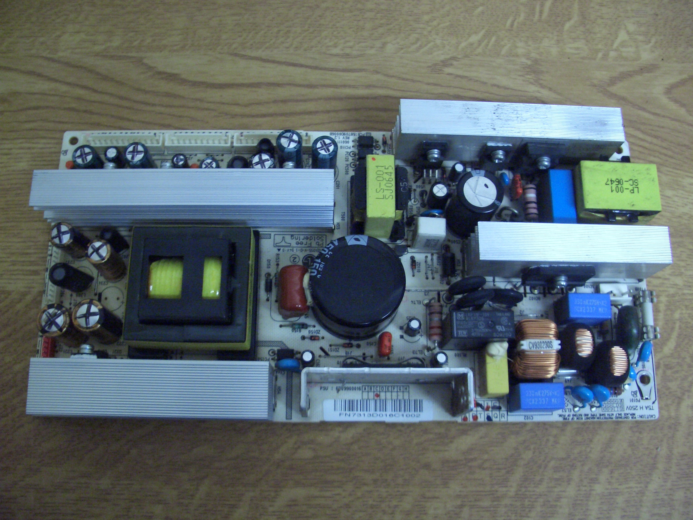

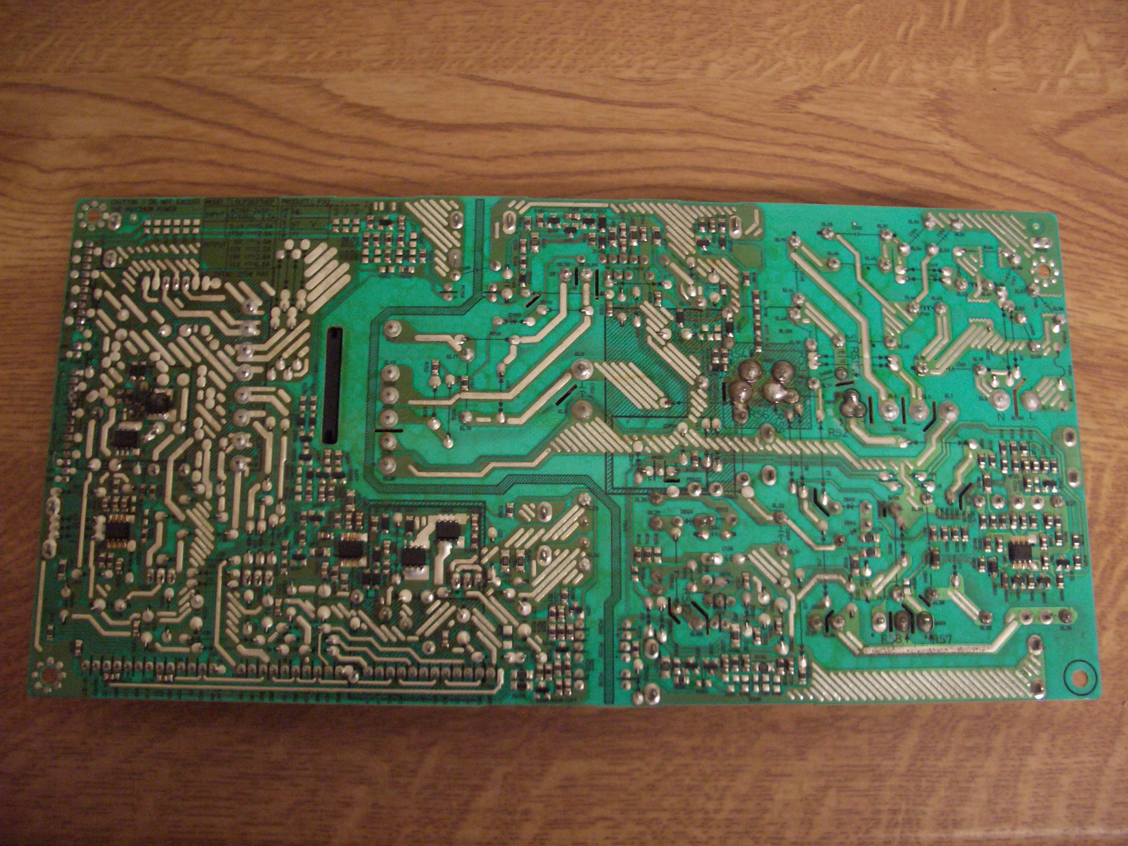

      As you request, a few more photos of the PSU board.
      I marked all original capacitors with an X for my own purposes.

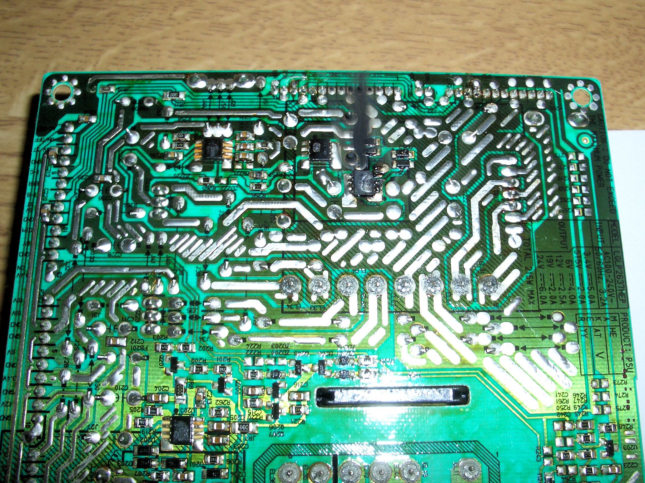

      I cleaned up the burn mark off the board.
      I would not trust the other IC next to the one burnt out either (another MOSFET perhaps?), as it looks like it may also be damaged due to heat. Some of the plastic is raised up off the top of it.

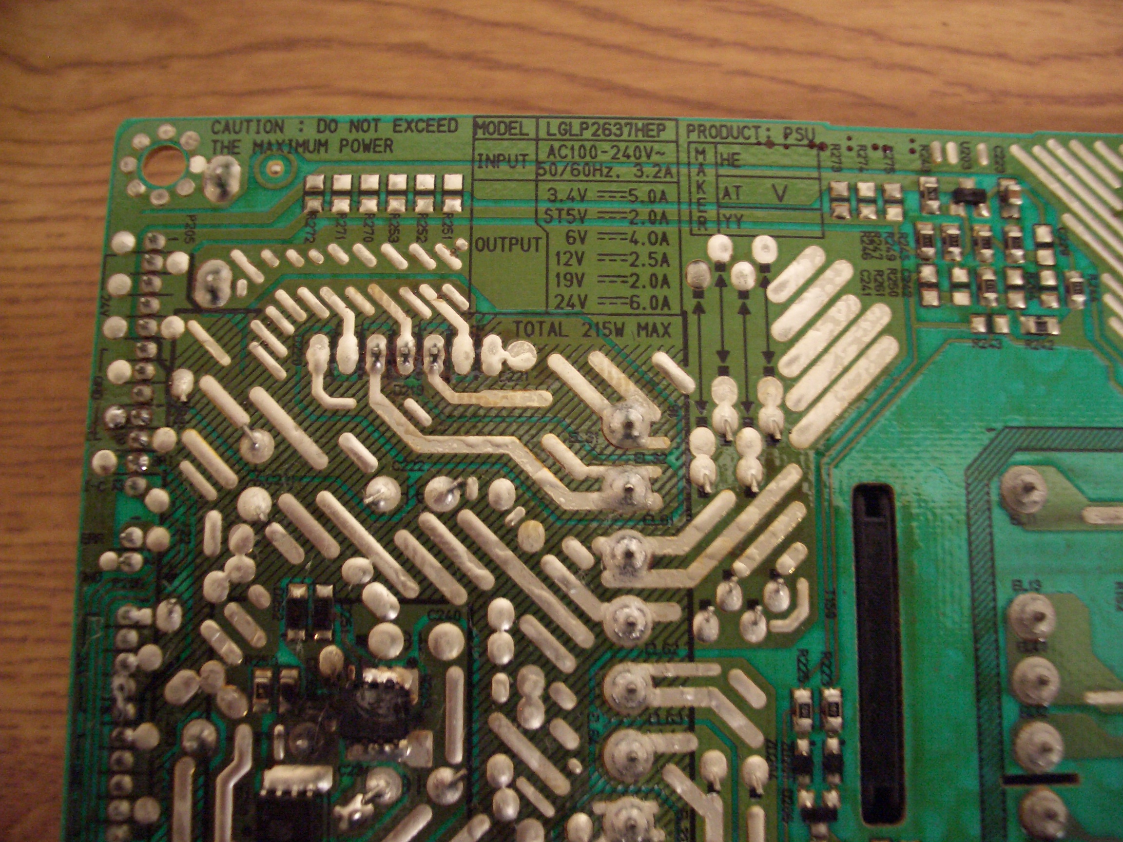

      The power supply board model number reads LGLP2637HEP.
      PCB number stamped on the top reads 68709D0006B Rev 1.2

        You need to replace every cap on that Psu apart from the primary units. Also whats the circuit ref of that Ic ? I would say it burnt up because of the badcaps letting too much ripple current through thats why you never ignore badcaps.

          My searches reveal that the burnt-out IC at position Q209 is a IRF7807, 30V N-Channel Mosfet. The suspect one next to it is Q210, IRF7807z Mosfet.
          Chris
            Re: LG 32LC2D - Power supply with burnt IC
            You should also do the resistance test between the output Voltage pin and GND that goes to the sound output power amp ICs to see if it shows very low resistance otherwise you will be blowing the parts due to shorted parts in the main board.

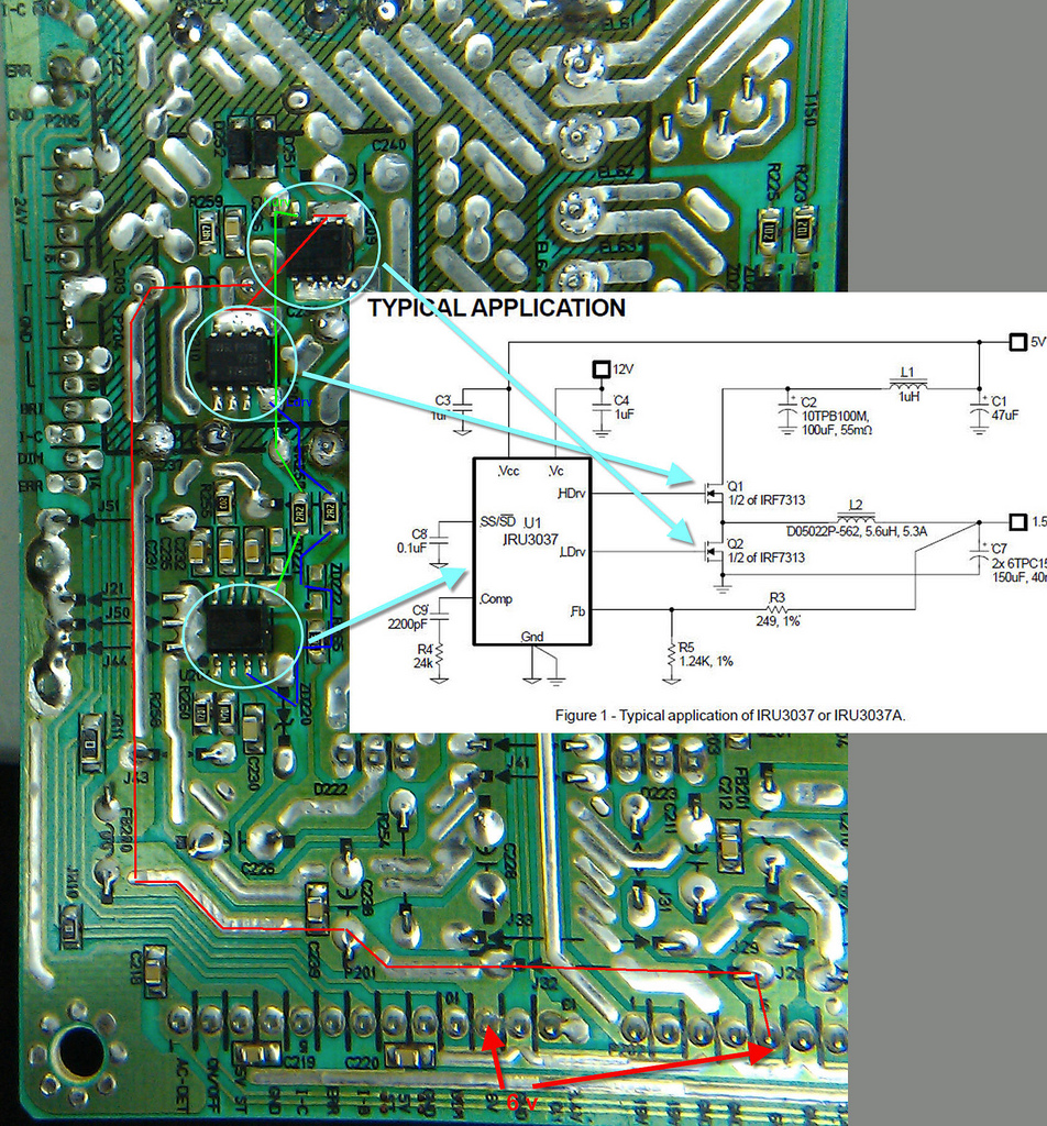

              In my travels, I found this very useful image.
              I also had my jaw drop at the price of 130C capacitors (£5 each).
              Chris
                    hallo,
                    i have the same problem with my LG
                    the 6 V is missing!
                    i got a advice to replace Q209 and Q210= fet s
                    and U 204 =IRU 3037?
                    i have doubts about the last one?
                    anyone has experiens with it??
